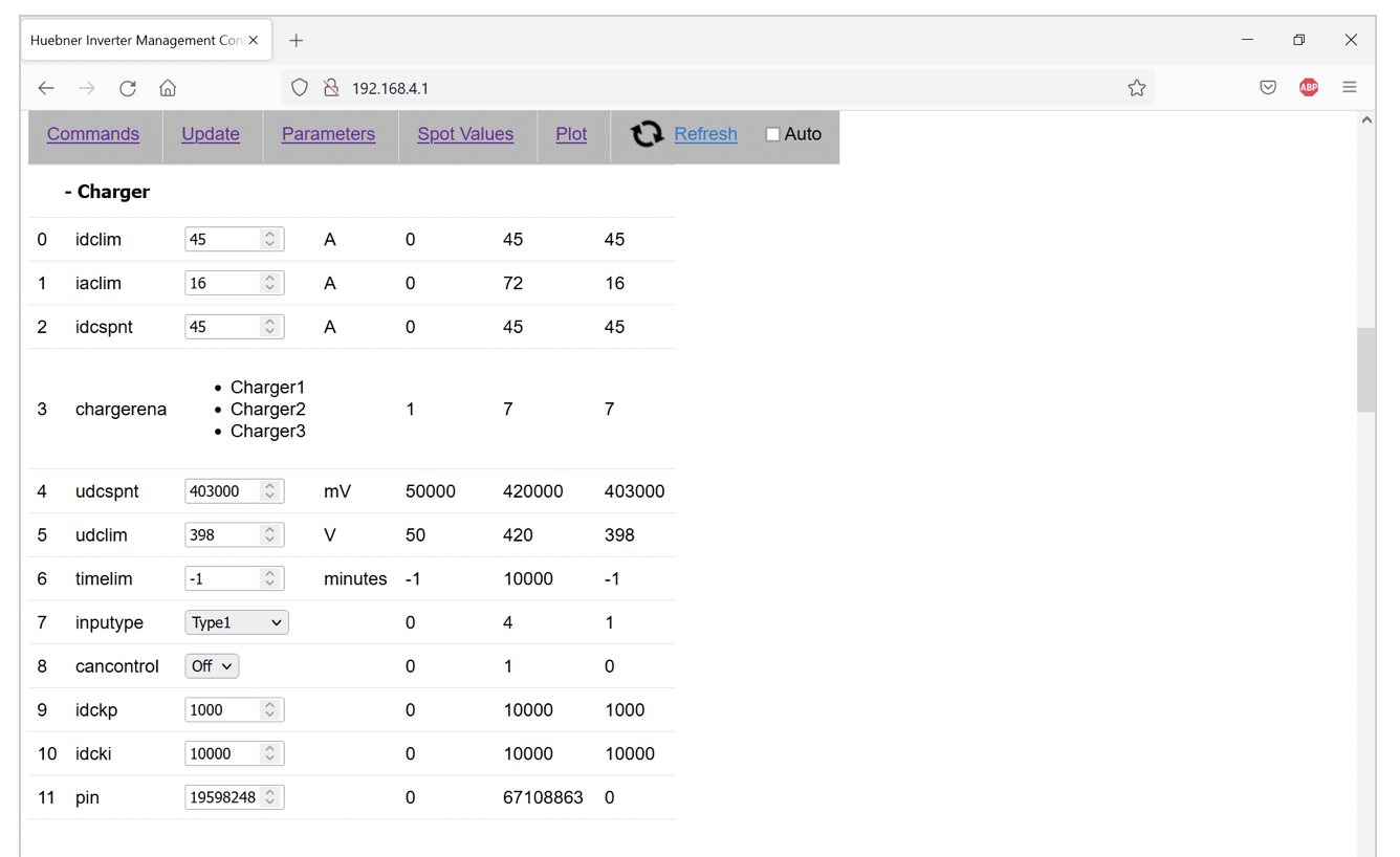

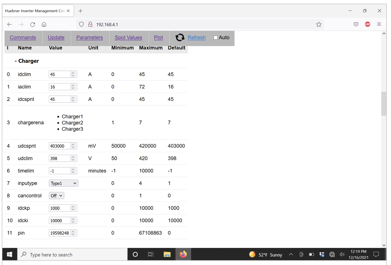

It seems that if udcspnt > udclim then udclim is ignored?
I had the following settings:
udcspnt: 403000 mV
udclim: 385V
And found my pack charged to 390V where I unplugged it.
Bug or feature? Let me know and I can update the wiki either way.

Certainly shouldn't be that way. Strange, as I had tested that. What are your other settings?

JSON with params attached, only stripped serial and pin before upload.
I will test the limit again next week.

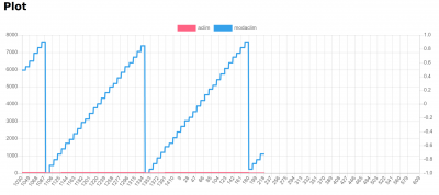

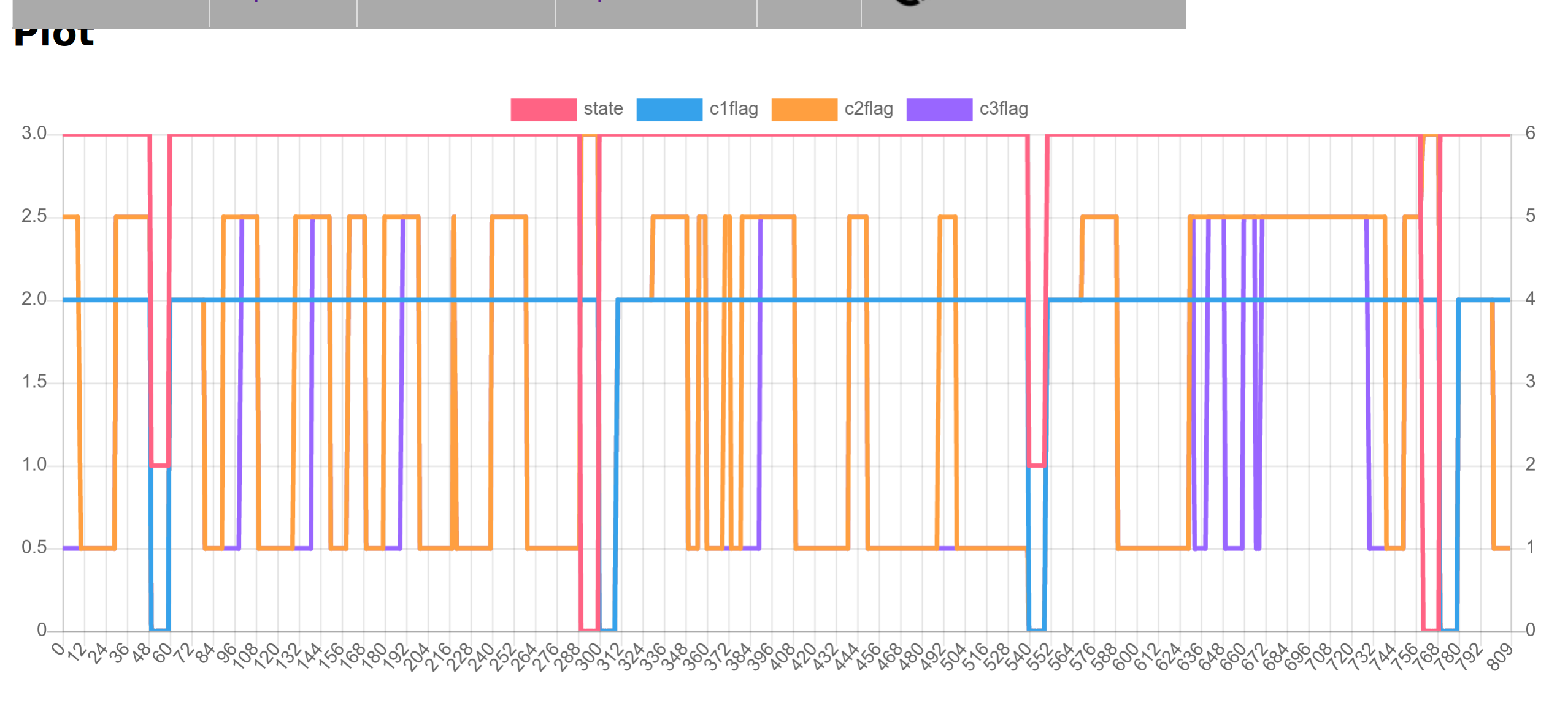

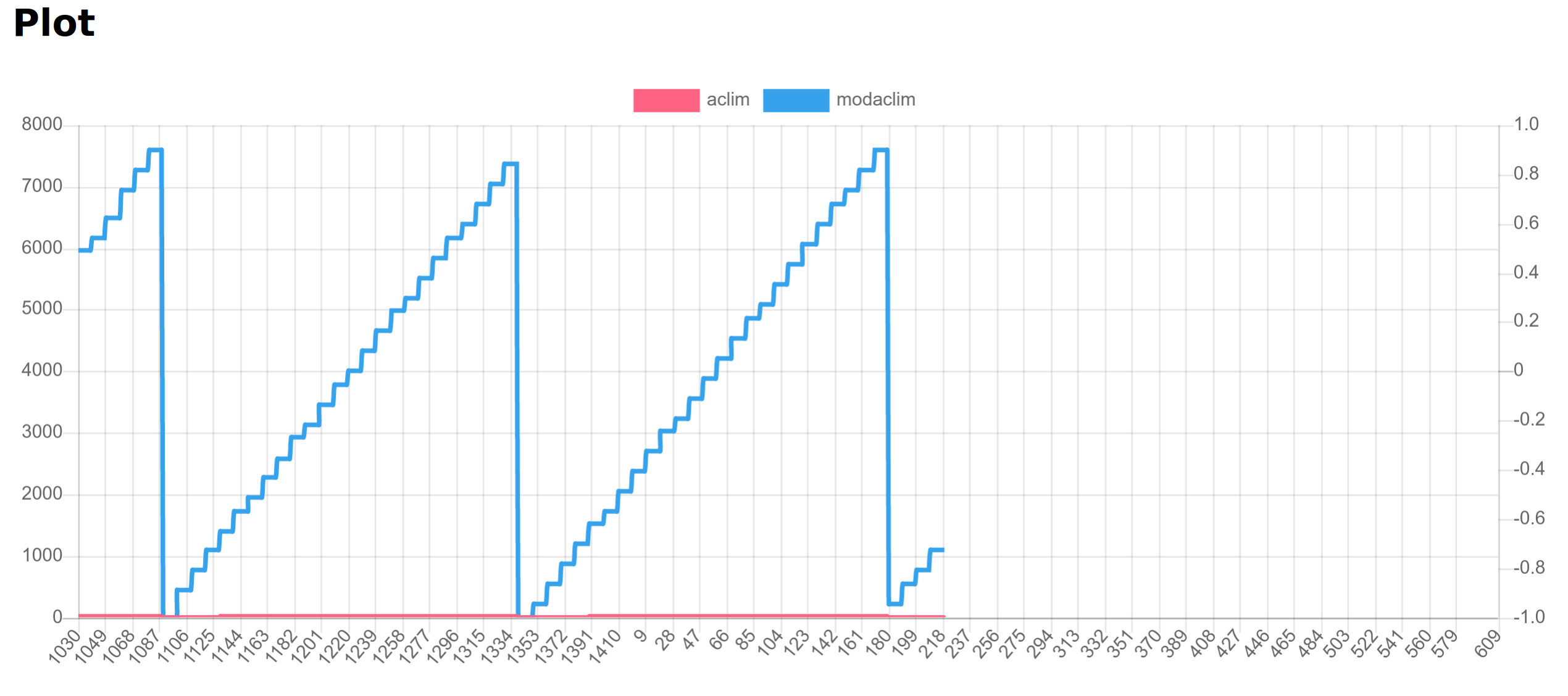

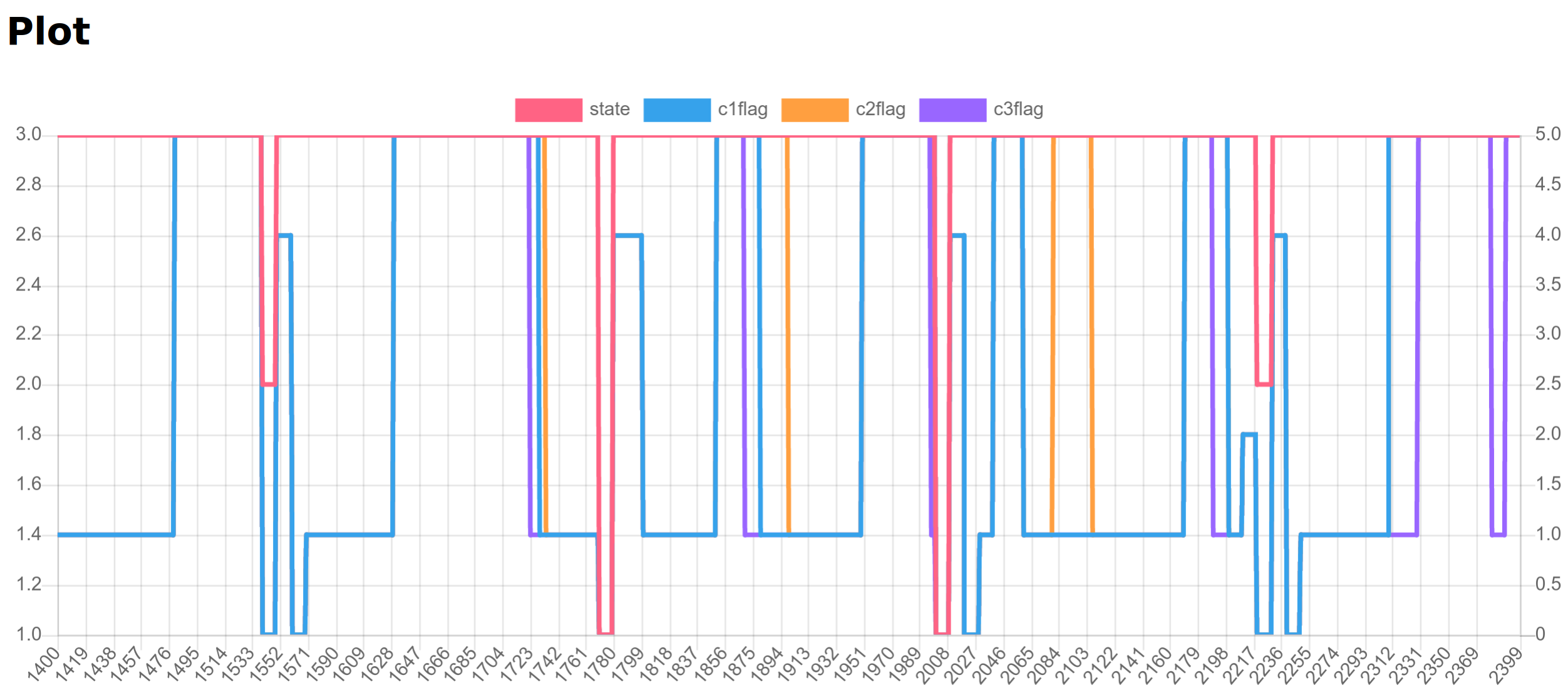

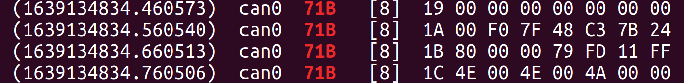

I have a charger here that is dropping out. It worked previously. (Fun fact, it is the X-rayed patient).
Some plots below, it looked like charger1 was dropping out, so I set chargena to 6 to run on 2+3 only, same behaviour. I can hear the EVSE clicking in and immediately dying, no current drawn on AC side.
modaclim is ramping up, then drops.
all chargers enabled, c1flag going to 0
only 2+3,c1flag still goes to 0?

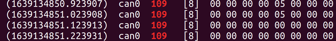

I took a CAN log at the same time, did a quick grep and 0x109, 0x71B are in the log, so I am cautiously optimistic that CAN is not the issue.

janosch wrote: Fri Dec 10, 2021 11:34 am I have a charger here that is dropping out. It worked previously. (Fun fact, it is the X-rayed patient).
Screenshot from 2021-12-10 11-41-44.pngScreenshot from 2021-12-10 11-42-07.png
You’ve probably already checked this, but whenever I’ve suffered with an EVSE spasm, it was due to the charger ground not being clean enough.

Boxster EV wrote: Fri Dec 10, 2021 1:03 pm
janosch wrote: Fri Dec 10, 2021 11:34 am ... my charger drops out before drawing AC amps ...
Very good shout, I hadn't tightened the charge cable earth to the case properly. However, something else seems to be amiss. I took it off the CAN and just gave it its own 120 Ohm resistor too, but that didn't change the behaviour yet.
It will be one of those little ones I hope, but I can't find which one it is. Noticed udc is reading 0V! Investigating, although I measured 360V earlier with the multimeter at my measuring point. Maybe I will add a "common errors" section to the GEN2 charger wiki.
Edit: Found it! 20A PV fuse has died quietly in the loom. Regular automotive 20A fuse is still intact (makes sense that PV pops first), no bang though, and surprising that the charger went up and down on the EVSE like that.

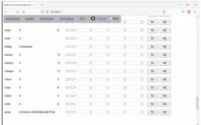

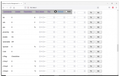

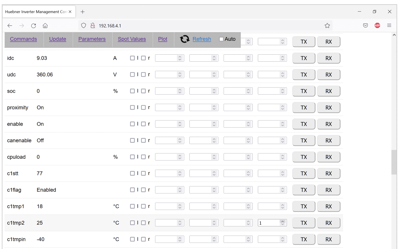

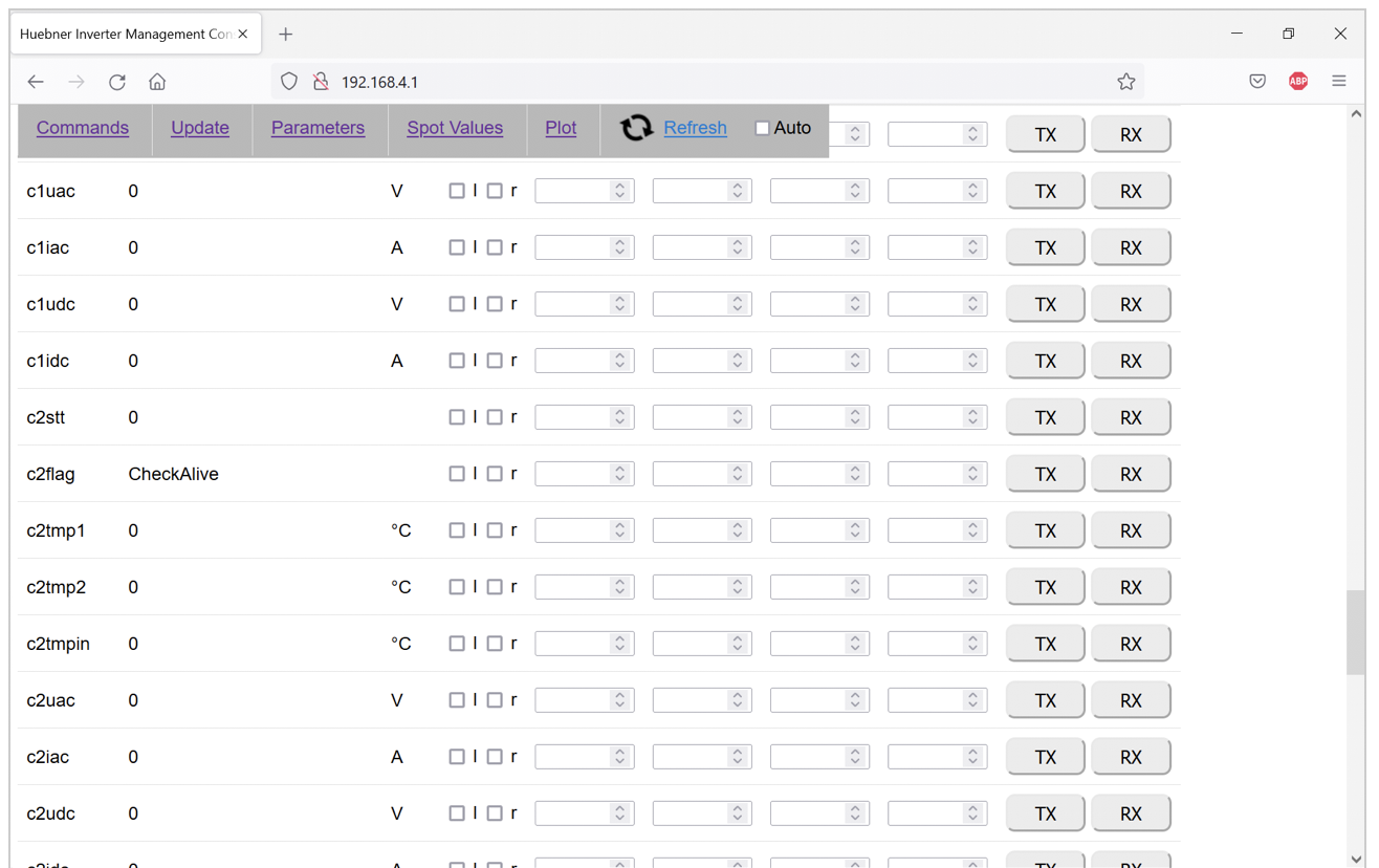

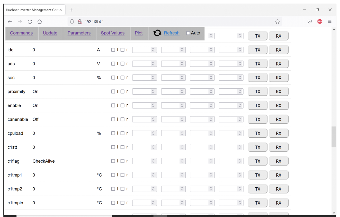

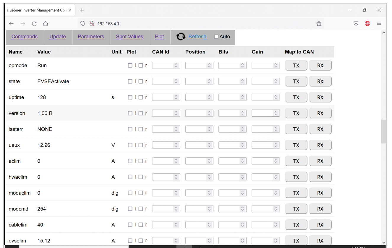

I set up the new Gen 2 charger today and it seems everything is working but no charging, no out put. All 3 leds come on when plugged in, My wall charging indicator even blinks saying it's charging but the voltage stays at 365 volts. with no increase. I do not hear relays turning on although the 3 leds are on. I've checked connections and grounds so I'm a bit at a loss. I've attached settings. Running 240 volt single phase setup. USA.
Posts: 6754
Has thanked: 382 times
Been thanked: 1575 times
Re: Tesla Charger alternative firmware
There is no CAN communication. Close the solder jumper underneath the wifi module to close the 120 Ohm CAN termination.

johu wrote: Wed Dec 15, 2021 10:48 pm There is no CAN communication. Close the solder jumper underneath the wifi module to close the 120 Ohm CAN termination.
First of all thank you. Is that necessary when I'm not using can to control it? Thought it works both ways? Just a power on/off switch for now, brand new board from Damien. Just curious as I don't want to make any mistakes.

Roadstercycle wrote: Thu Dec 16, 2021 12:22 am First of all thank you. Is that necessary when I'm not using can to control it?
The charger uses CAN internally. It's necessary to close this jumper when you are not using CAN to control it. A CAN bus must be terminated with a 120 ohm resistor. If you are not extending the CAN bus beyond the charger, it must be terminated inside.
Thank you catphish, That's where I was confused. Didn't know it used canbus internally. Again thank you.

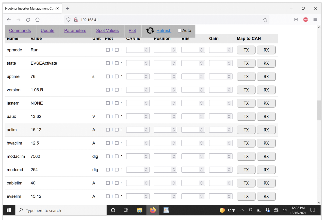

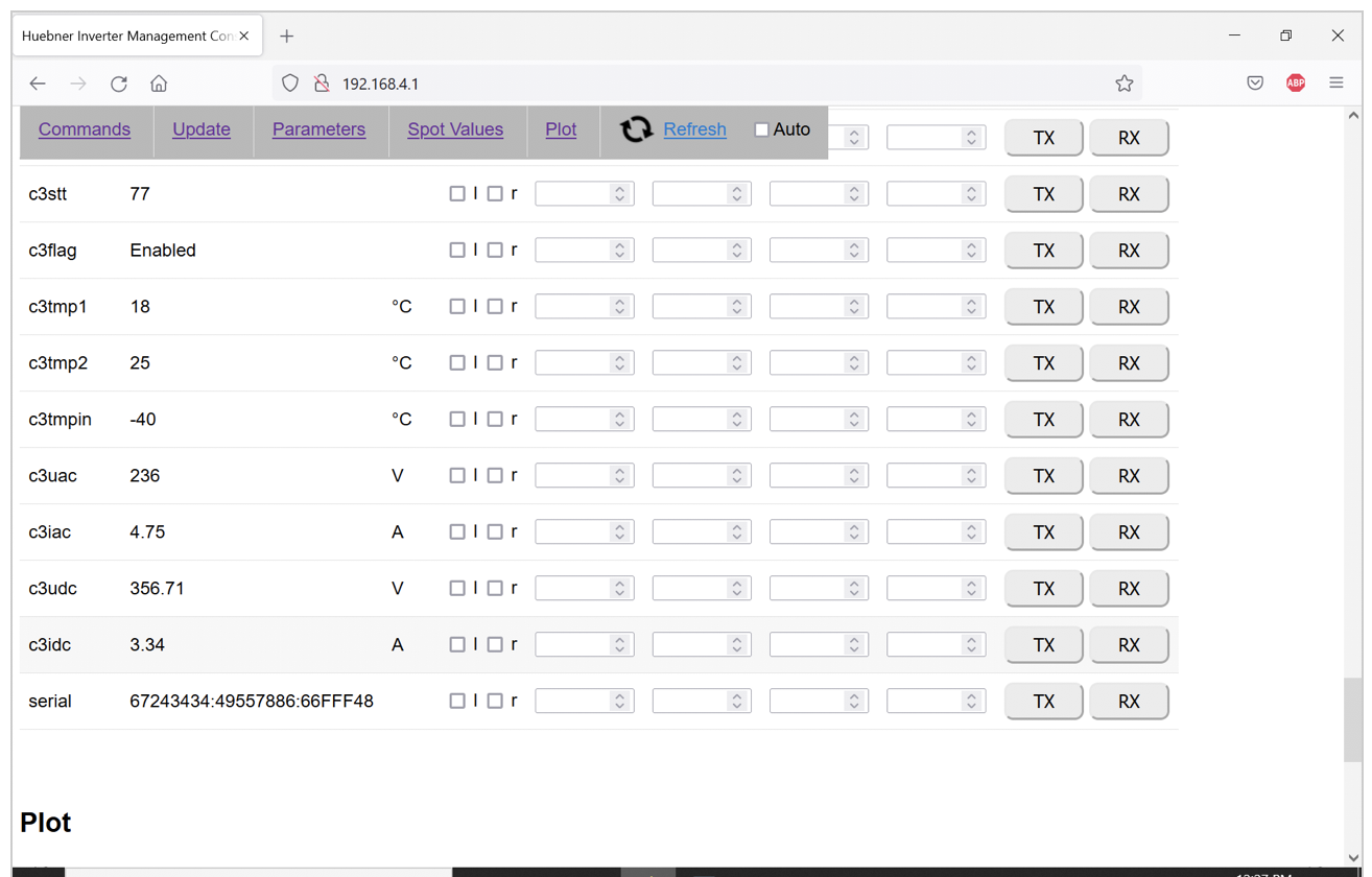

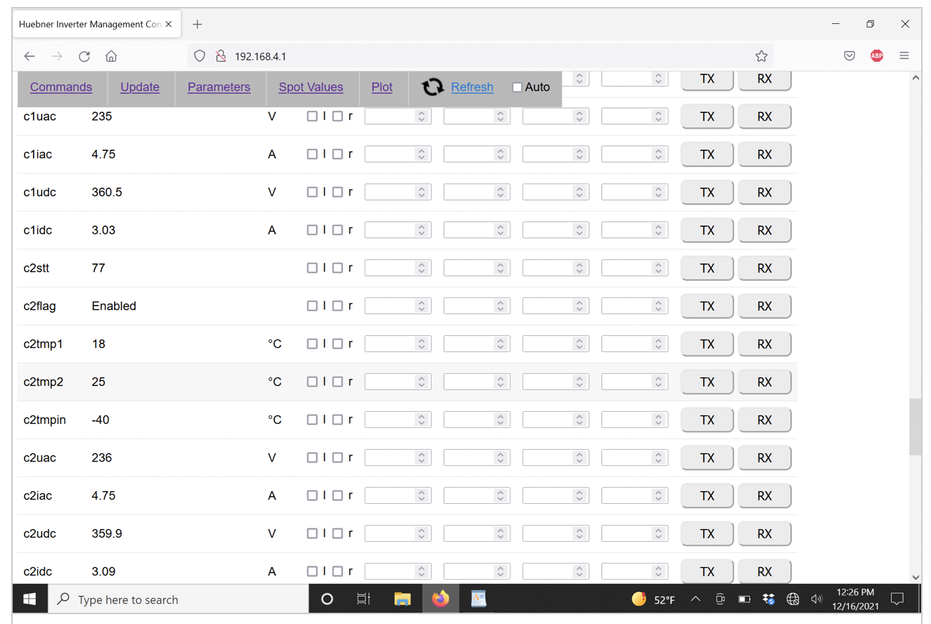

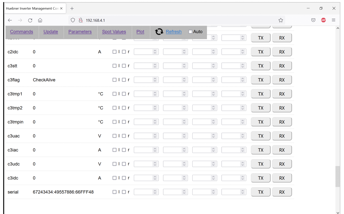

Hi again, Sorry for being a pain. I wish I was a double EE but I'm not. So I closed the 120 ohm jumper pad. Now I do get a click then a few seconds later another click. Still no charging. All 3 modules leds light up. I've tried switch on first then plug in the charger plug. I'v tried charger plug first then turn on 12 volts. Same results. I've sent the new settings and log. If someone sees anything that it might set incorrect please let me know. Again I've checked power, grounds etc. It has to be something simple I'm missing. I'm at 365 volts, is there a low voltage turn on? Meaning it won't start charging until it gets to say 350 volts?
Posts: 6754
But it is charging :) 9A total, 3A each. You can bump the iaclim to 45A to get more power.

Roadstercycle wrote: Thu Dec 16, 2021 9:01 pm Still no charging.
Definitely looks to me like it's working. It seems your EVSE limit is 15A, and the 3 modules are pulling 5A each. 9A is going into the batteries. Success!

I guess I was basing it on no raise in voltage. I thought the voltage would go up as it starting charging. Thank you guys.

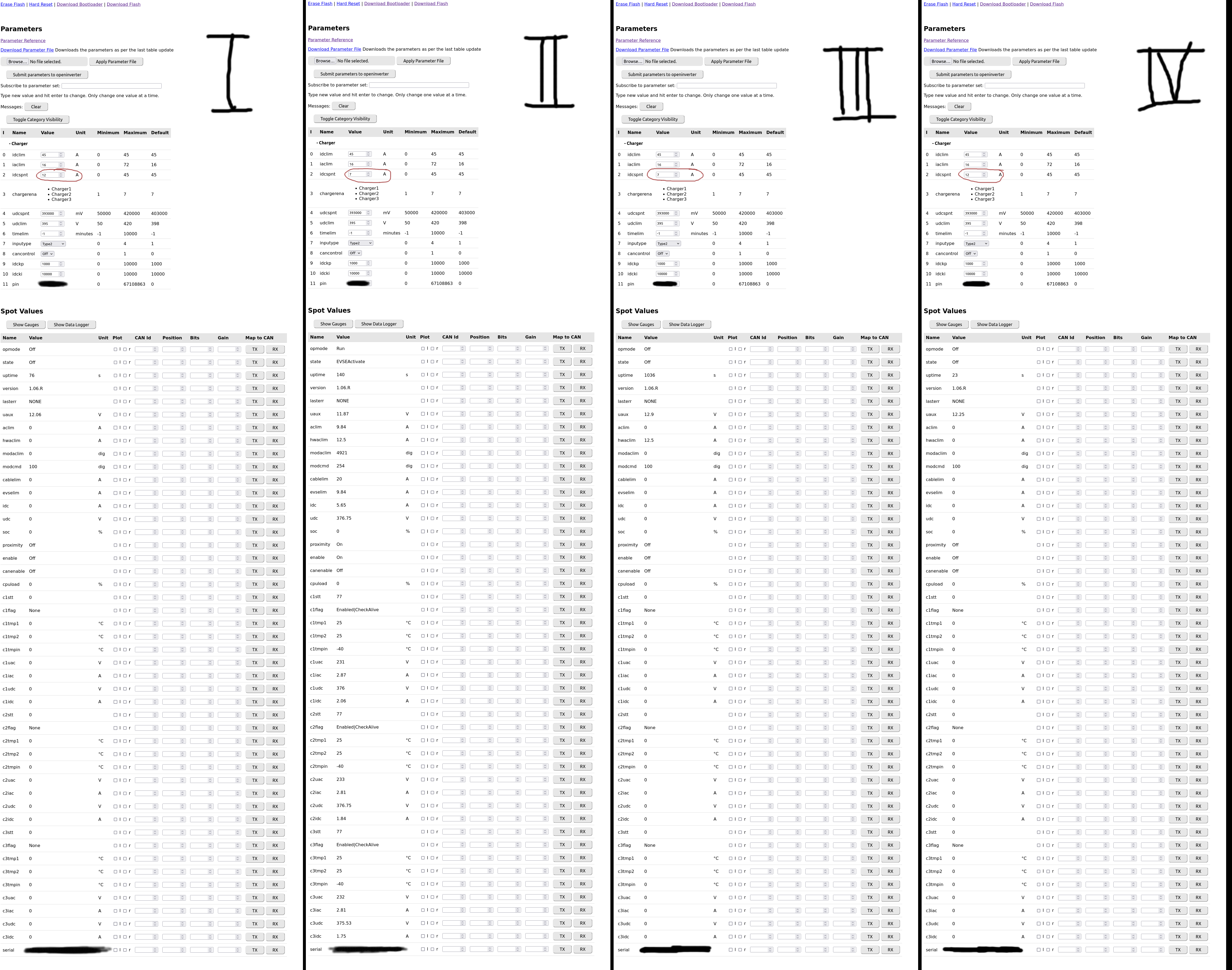

I have an odd one:
idcspnt drops to 7A when entering opmode "run", even though it was set to 12A before. I can set it to 12A but it jumps back to 7A! It changes itself.
Below are screenshots:
  • I) Just started: opmode off, idcspnt 12A, uptime 76s, (started up like that, so loaded the 12A from flash)
  • II) Charging : opmode run, idcspnt 7A, uptime 140s, idc 7A (changed itself)
  • III) Unplug EVSE : opmode run, idcspnt 7A, uptime 1036s (stays at 7A)
  • IV) After restart : opmode off, idcspnt 12A, uptime 23s (idcstpnt is reset after reboot)
EV_Builder
Posts: 1205
Location: The Netherlands
Has thanked: 18 times
Been thanked: 37 times
Post by EV_Builder »
Cable limit =20Amps
/3 = approx. 7

EV_Builder wrote: Fri Dec 24, 2021 5:56 pm Cable limit =20Amps
/3 = approx. 7
That makes sense, I will try different cables and report back!
