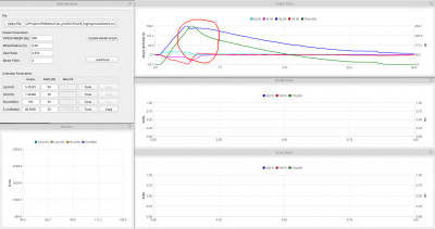

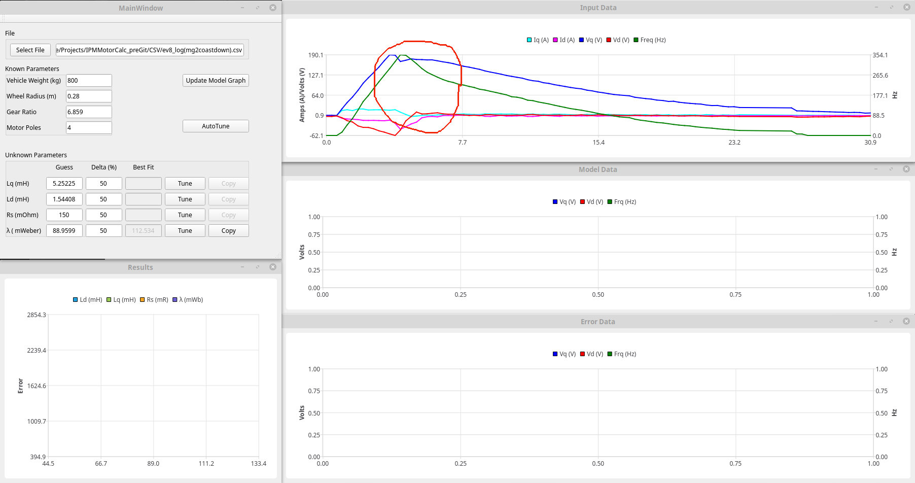

Re: Project RX8 , Prius gen2, Lexus transaxle to rwd
Just had a look at your logs using the calculator, if you change to a comma delimiter rather than a semicolon they will load right in, you can then select the region you want to analyse and it works out the numbers for you (although only flux linkage for these logs). It gives 112,5mWb for MG2 and 64.0 for MG1.
I think the wobble on the graph you mentioned is just the control loops settling at the start of the coast down. Just ignore that bit.
Ud looks fine on those, no problem with it at all. Just need to adjust it with scynofs not syncadj
Edit - plot from the calculator, wobble ringed can be ignored:
