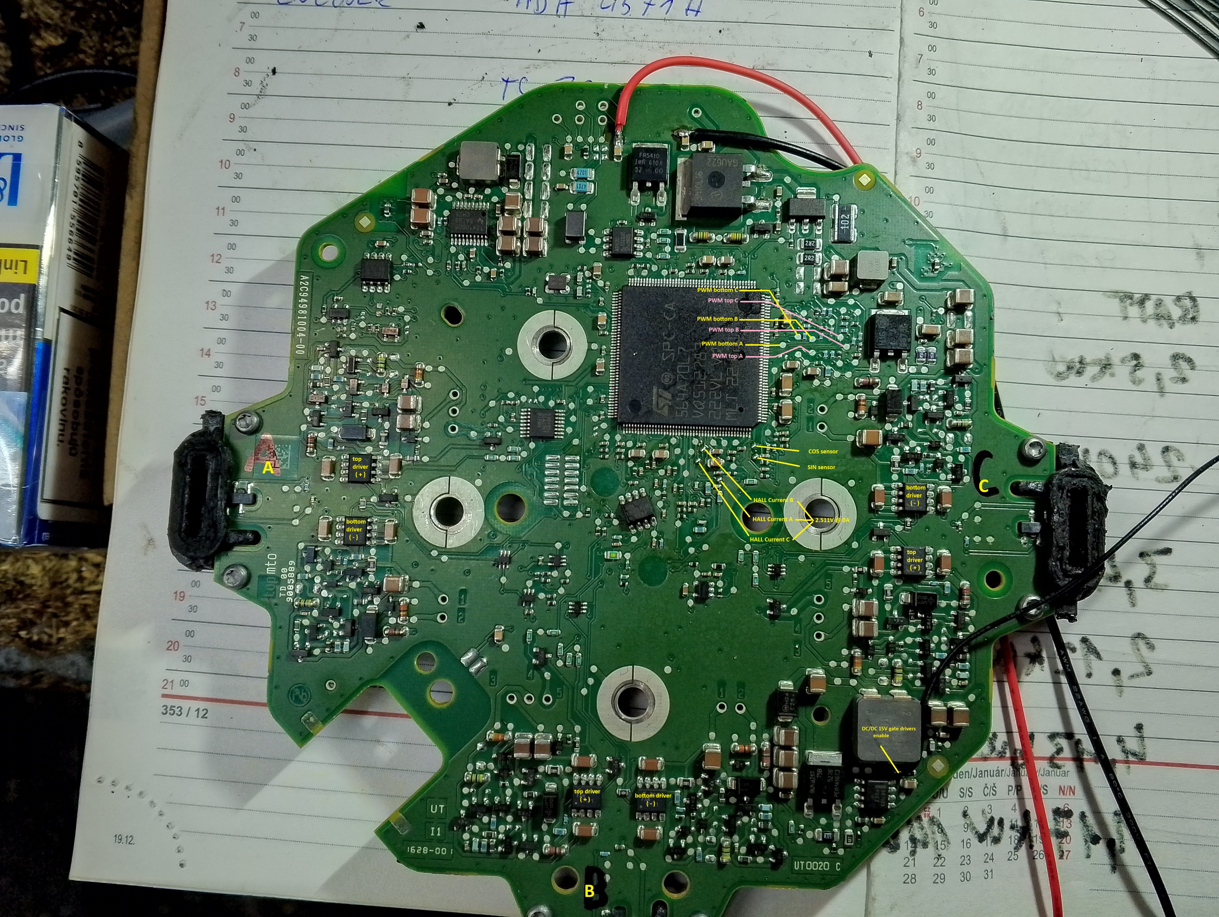

Hello everyone,
I hope some people are still around on this subject, I've got myself into reusing on of these iBSG alternators from Valeo as the main motor for a small EV.
I've got my hand on a 415005 / IBSG4W025 starter-alternator from Valeo (official product link : https://www.valeoservice.com/en-com/tec ... country=DE). The package seems to say that this was mounted on a MHEV Jaguar XE X760 1.5.

Adrianbb
Posts: 7
Joined: Thu Feb 26, 2026 11:12 pm
Been thanked: 6 times
Re: VW Mild Hybrid Starter Alternator
Post by Adrianbb »
I had some time today, so I looked at the board. I think the processor could be replaced... I unsoldered the processor and measured the functionality of the drivers, current sensors and encoder. More later
bananaman
Posts: 17
Joined: Tue Aug 26, 2025 5:38 pm
Been thanked: 13 times
Post by bananaman »
CuriousCat wrote: Fri Feb 27, 2026 5:35 pm I am manually encoding the messages but unpacking using cantools and the DBC. Here are my two python files for setting the parameters and packing them. (You can check the attachement)
For the recording, I'll have to do it again, looks like I've done too much cleaning in my files ...
The exact issue I have is that I'm sending a bunch of messages to the motor. The messages are explicitly declared in the encoder file shared. But I'm not getting any results : no spinning, the inverter doesn't seem to turn on HIGH side and the reply I get from the motor don't help me much.
The questions I have are :
- Am I sending the right messages ?
- Am I listening to the correct parameters ?
- Did I miss something about the messages or does the motor need more environment messages (such as BMS, motor ECU, ...) on the bus to turn on ?
The firmware on the github looks like it's for an ESP32 with MCP2515 CAN transceivers. I'm going to try running it and comparing the CAN messages with ones I get from your code. It will likely take a few days though.
bananaman
Posts: 17
Post by bananaman »
Adrianbb wrote: Fri Feb 27, 2026 10:30 pm I may have thought of something stupid, but hasn't anyone thought about the alternative of using an openverter mini controller board instead of an oem MCU? Or if anyone has any other ideas...? Because from a realistic point of view, this playing with CAN won't hurt anyone, but it's a huge waste of time that no one will pay for or we can use it more effectively. If we want to use it as a compact motor with a regeneration function, then with a little skill, maybe we could use a lot of the original HW like gate drivers, encoder, current sensors... The power stage doesn't look completely useless, but maybe I'm wrong. And with a little luck, the compactness and functionality would be preserved with the benefit of easy control and some functions on top, such as the ability to operate at slightly higher voltage and current. Yes, I know, the 63V capacitor is the limit, and I don't know the current. No one has any idea what kind of oem transistors are used there.
If this is off-topic, I apologize :)
That's indeed another valid approach, just replacing the whole board may be easier than replacing the processor though. I was also wondering if it would be possible to flash custom firmware on the stock board. I could not really find any open source motor controller projects that support AC induction motors though. I was looking at the VESC and found this: https://vesc-project.com/node/872 but have not looked at it further.
Adrianbb wrote: Sat Feb 28, 2026 6:15 pm I had some time today, so I looked at the board. I think the processor could be replaced... I unsoldered the processor and measured the functionality of the drivers, current sensors and encoder. More later
It may be interesting to also keep track of which pins on the processor those connect to. You should be able to find the datasheet with pinout by searching SPC564A70L7

bigmotherwhale
Posts: 125
Has thanked: 17 times
Been thanked: 25 times
Post by bigmotherwhale »
Many of these are dying because the mosfet stage fails, if your replacing the mosfets and the controller it might be better to start with an external controller, Keely induction motor controllers would probably run this motor with the addition of only an encoder.
