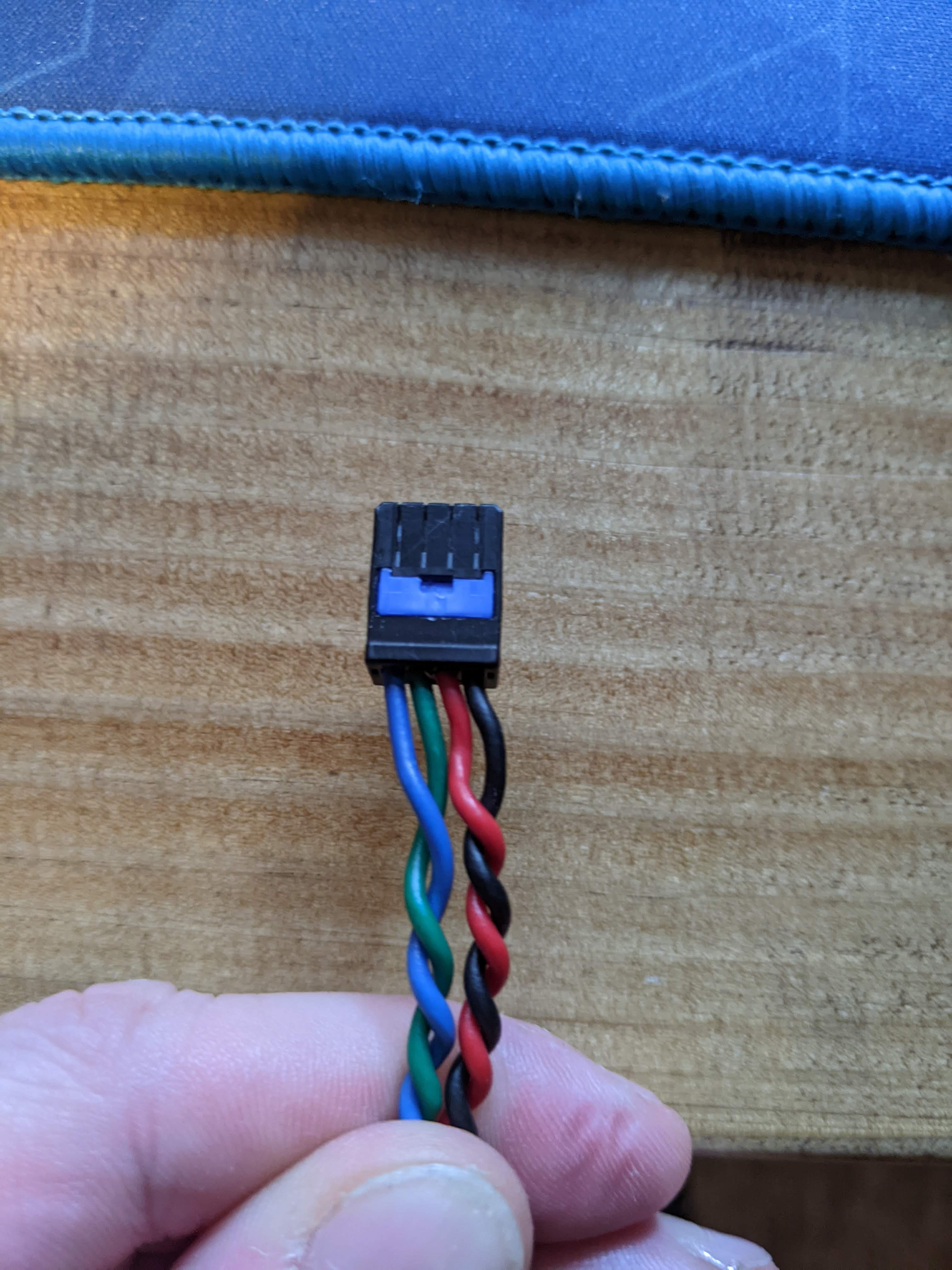

Re: New BMS for bq76PL455A based batteries
In this photo, the plug is upside down (release tab on bottom), and green/blue are the data pins.

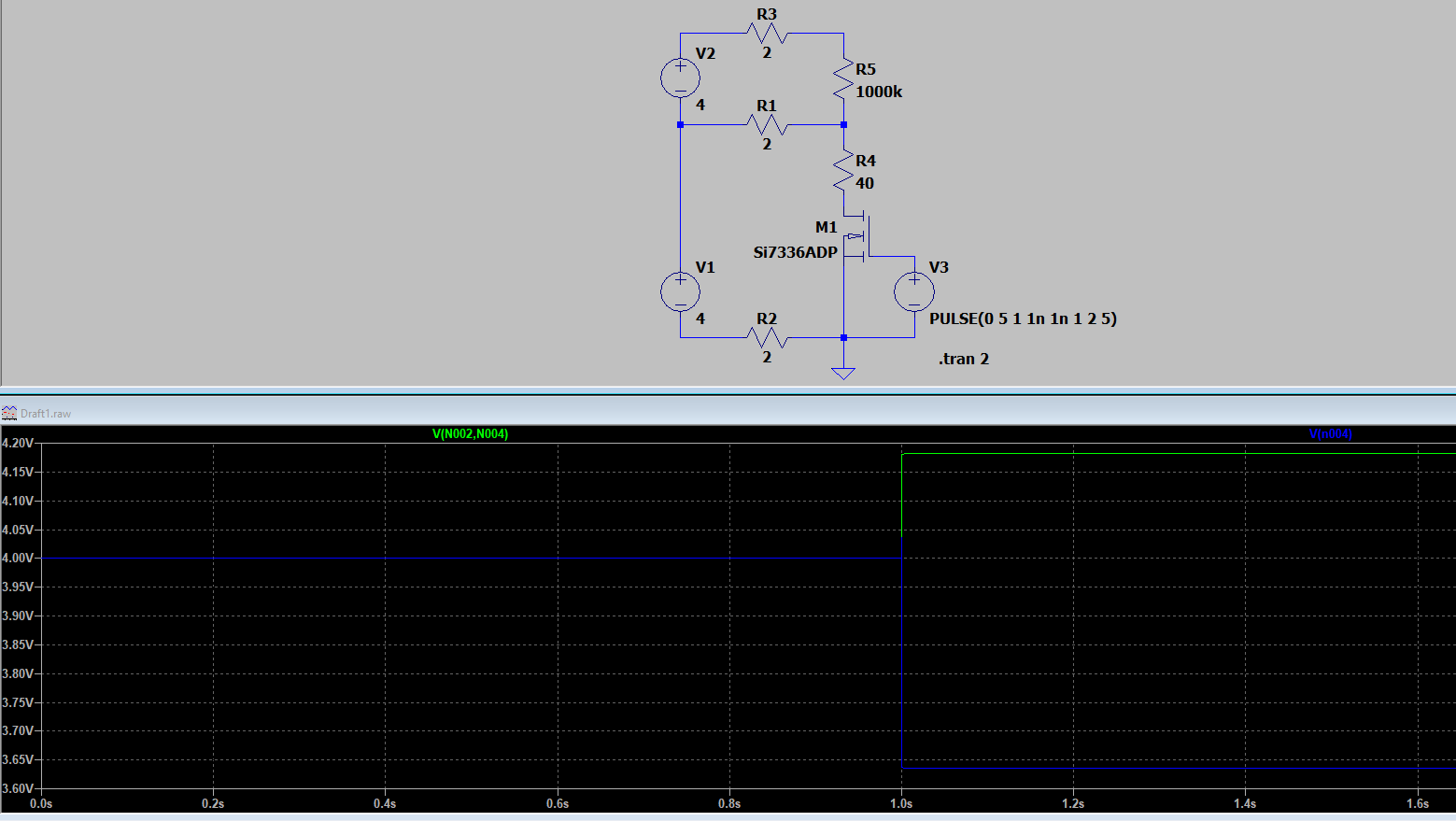

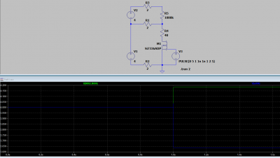

First of all, thank you Catphish for the great piece of equipment.
I've tested the balancing by sending the balance_threshold via CAN and noticed that some of the cell voltage measurement values started to fluctuate quite heavily. at first I was somewhat alarmed by the fact that the maximum cell voltage jumped from 4080mV to 4180mV, but I soon realized that something had to be off with the measurement and not with the actual cell voltage.
I managed to simulate the phenomenon with LTSpice (screen capture included). The Mercedes EQC modules that I am using have very long FPCs to route the individual cell voltages to the TI chip. As the balancing is enabled, the balancing current induces a voltage drop across the resistance of the copper track on the FPC. While the measured voltage of the balanced cell drops, the measured voltage of the adjacent cell actually goes up! This introduces a problem, that on the next measurement round this "high voltage" cell is erroneously chosen as the next one to be balanced.
Now wait a minute... in the code, the balancing is disabled before sampling the cells so why is this happening?
Well, apparently there is some delay in the hardware (maybe some low pass filtering on each channel).
Anyway, I inserted a busy_wait_ms(10) right before the sampling command and the balancing started working without any spurious back and forth switching of the balanced channel.
This all might be highly hardware related and I have not even checked (as of yet) how small a value for the delay I can actually get away with, but just wanted to share my finding. V1=4V and V2=4V are the simulated cell voltages. Resistors R1, R2 and R3 represent the series resistances of the FPC copper tracks. As the balancing is enabled across V1 at 1s, the measured V1 drops below 3650mV while the measured V2 rises above 4180mV.

Thank you for the information! I have no such delay in my own code and have not noticed this problem in the form you describe, but I do notice that the choice of cell to balance usually changes on each pass, so it certainly seems that adding a longer delay between disabling the discharge and measuring the voltages would be a good idea. A 10ms delay certainly isn't going to have a detrimental impact on anything, so that seems ideal.Kelju wrote: ↑Mon Jan 02, 2023 9:55 pm Well, apparently there is some delay in the hardware (maybe some low pass filtering on each channel).
The slave modules I use have very short PCB paths between the cells and the discharge resistors, so I suspect the effect isn't as dramatic.

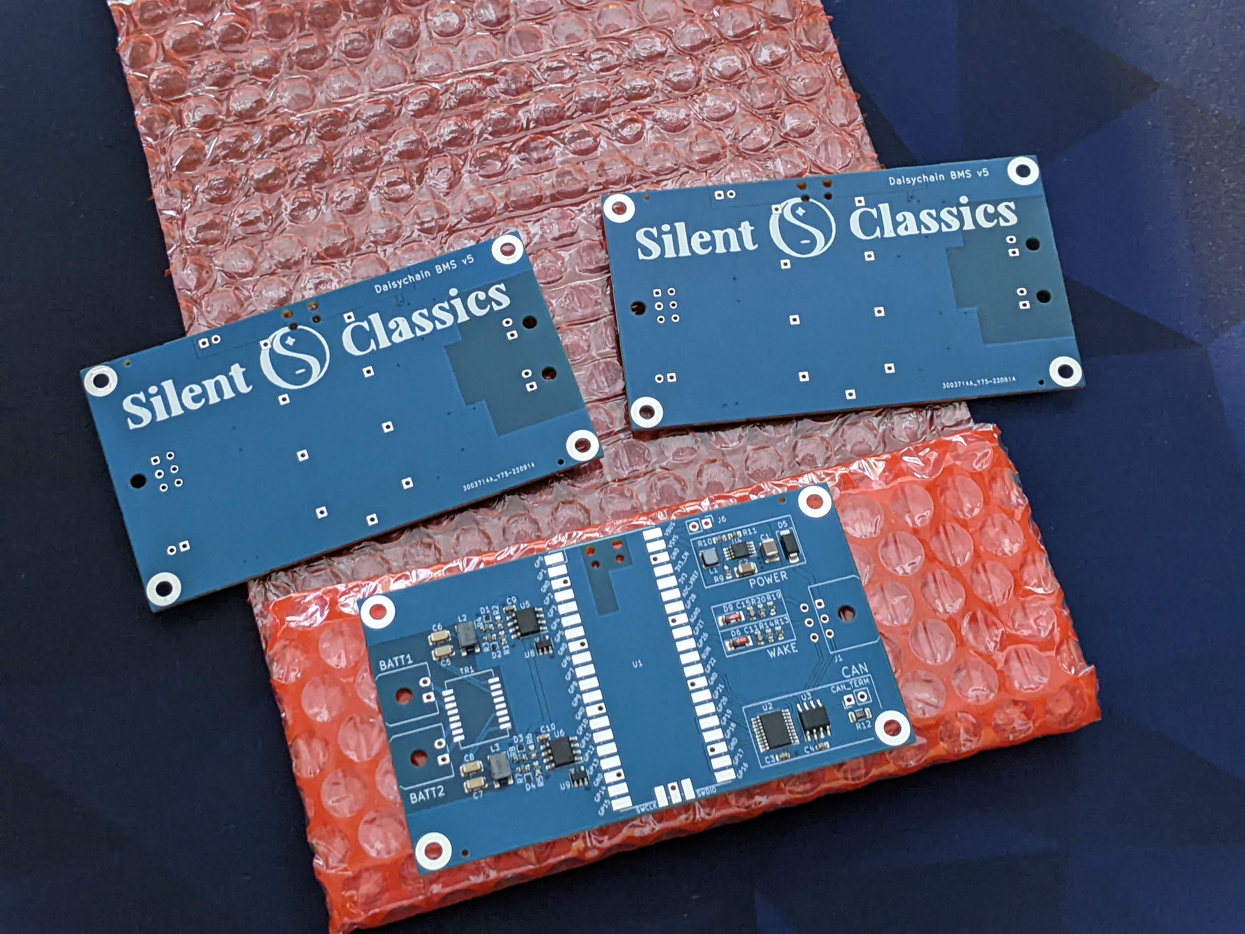

I just got my boards ealier this week. I all new to the pico workflow, how am i supposed to use the firmware folder ? I've read that you can setup visual studio to compile the firmware, i that what i need to do ?
I'm not that handy with the fimware/code side of things if you couldn't tell.
Hi Folks!
I have ordered the master boards, and they have arrived. I uploaded the UF2 file, and behold, I get a reaction... unfortunately, it's the wrong one... countless CRC errors. So, thinking that I might have made a mistake in the configuration of the UF2 file due to my lack of coding skills, I hired a freelancer to obtain a correct UF2 file. But unfortunately, the CRC errors persist.
Unfortunately, I am unable to verify whether it is due to the board... perhaps I ordered the wrong one, or it could be the UF2 file. I am at a loss and have no idea what to do next...
I have already tried the following, but nothing has changed the CRC errors at all:
Used shielded and unshielded cables.
Twisted and normal cables.
120-ohm resistors at the beginning and end of the daisy chain, and both simultaneously.
Shortened the cable length from the master board to the daisy chain to just a few centimetres.
What if the new boards were ordered incorrectly, or the UF2 file is still not right? I have no idea.
Perhaps someone could send me an already functioning UF2 file or create one for me. My battery configuration is as follows: 2 parallel strings with 6 modules each.
I really hope someone can help me, and I thank you in advance!
Best regards,
Volkmar
Best regards,
Volkmar
Update:
After a Long Night with several tries, I can tell you…THE MASTER IS ALIVE!
As conclusion I can tell you what I did, that the master is running:
I compiled the code once more, now with ninja. I think there was a fault in the uf2 file.
Changed all cables to new one.
120 ohm resistor at the end of both battery strings.
Nex step: I need the communication cables to the master board with a length of about 1.5 meters. I will try how long they can be without errors and a stable communication.
After that I can implement the BMS into the CAN Bus network with the Zumbie VCU and hopefully charging will work with the BMW LiM.
I keep you updated
UPDATE:
I tested different cable lengths. There are no problems up to a length of about 1.5 meters. I measured a resistance of about 0.2 ohms. It becomes problematic as soon as there are plugs in the cable. Here I found out that a resistance of around 0.5 ohms leads to problems and CRC errors occur.
Since I have two battery blocks, I will now try to use a master BMS board for each block and establish communication with the ZombieVCU via CANbus.
Can someone tell me whether I have to assign different CAN IDs to the two master BMS boards?
I keep you updated
UPDATE:
