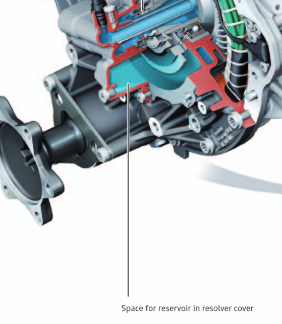

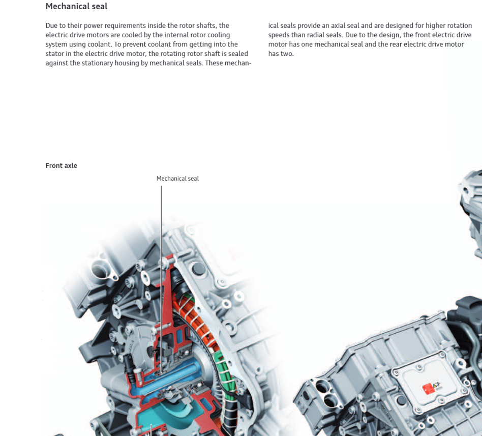

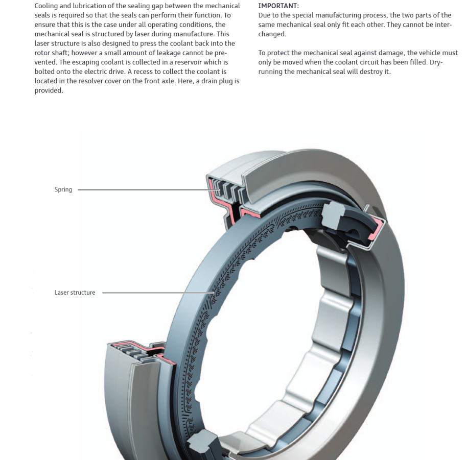

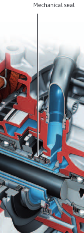

BTW, just discovered Audi e-tron has coolant cooled rotor. Many reports of coolant leaking into electronics. Not much details yet (fairly new car so mostly warrantee motor replacements) and dealers describe problem as a failed "gasket". More mechanically inclined are chiming in the rotary shaft seal is suspect. I was curious to see what seals others use to solve this problem.
https://electrichasgoneaudi.net/models/ ... ain/motor/
One diagram shows the motor (1 of 3, looks like not exact same design) uses 2 slip ring seal (presumably PTFE) on both sides of the rotor shaft coolant tube. Don't know if that has better longevity. The motor could also be unidirectional if gear box provides reverse. This would probably give the seal better chance at preventing leak.
Here is a paper reviewing all EV motor cooling methods. Table 1 listed e-tron and Mercedes EQC as coolant/water cooled rotor.
https://d-nb.info/1232812978/34

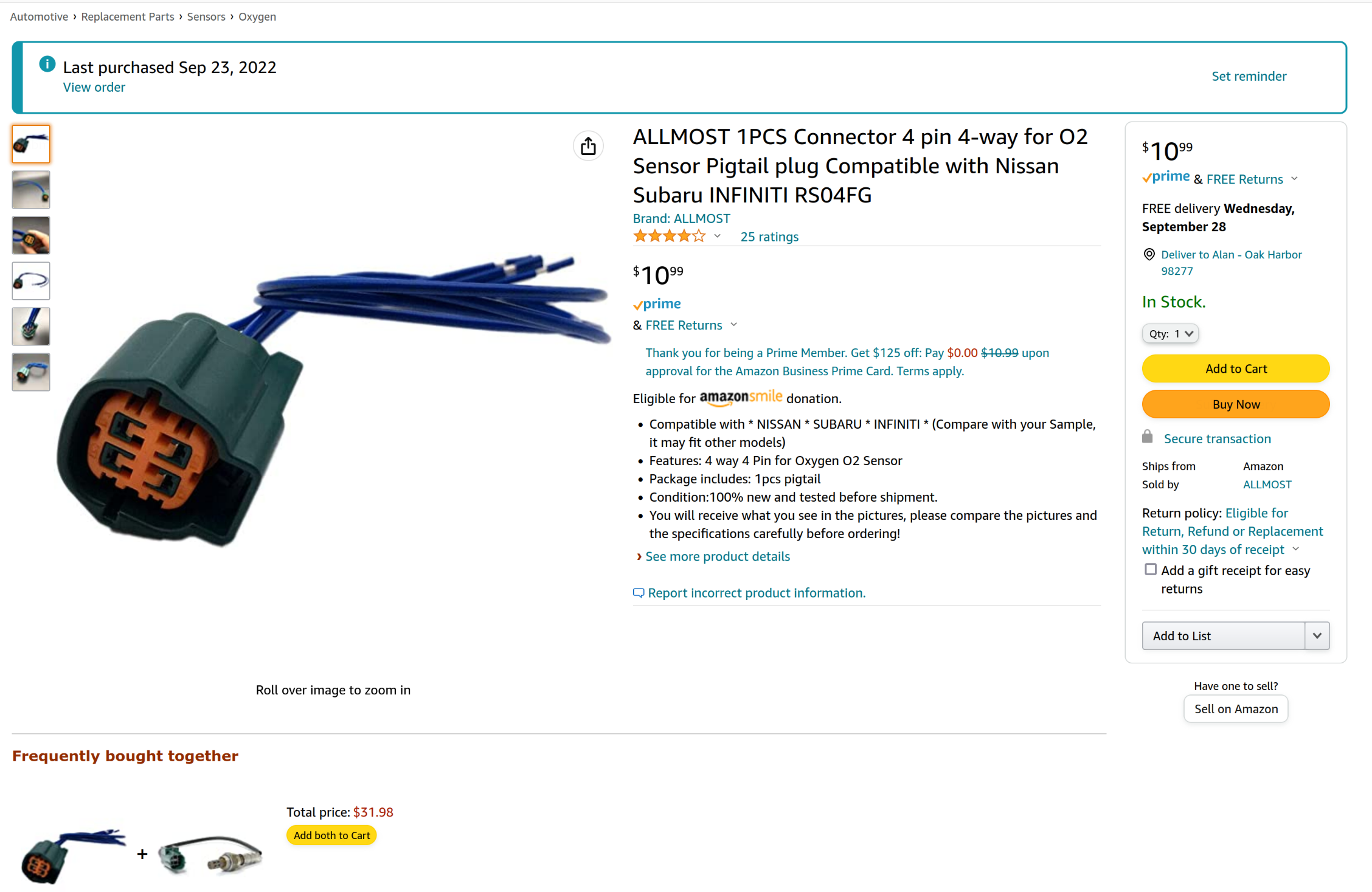

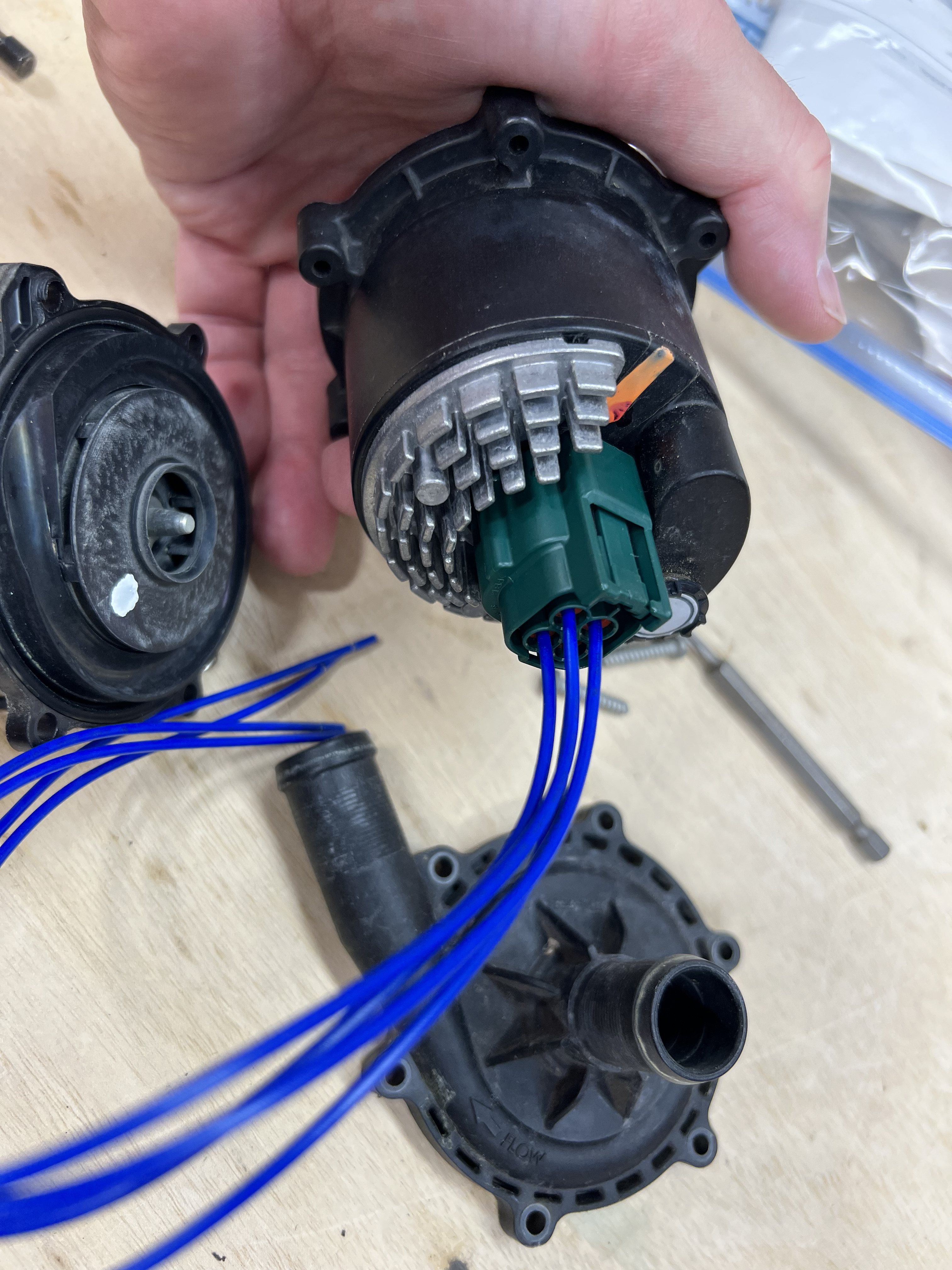

Didja know that Nissan/Subaru O2 sensor connectors fit this Tesla Model S coolant pump. I just received one from Amazon, $11, and it snaps right in place.
https://smile.amazon.com/dp/B07Z5ZRBY5
Amazon: Nissan/Subaru O2 sensor connector/harness.
Tesla Coolant Pump w/Nissan/Subaru O2 connector/harness.

howardc64 wrote: Sat Sep 24, 2022 3:58 am BTW, just discovered Audi e-tron has coolant cooled rotor. Many reports of coolant leaking into electronics. Not much details yet (fairly new car so mostly warrantee motor replacements) and dealers describe problem as a failed "gasket". More mechanically inclined are chiming in the rotary shaft seal is suspect. I was curious to see what seals others use to solve this problem.
Interesting that the E-tron also used a cooled rotor induction motor. Can't see anywhere that this special 'laser' seal is available separately - many other seals are available but it looks like it would be a new drive unit if this seal ever failed! These are between £3,000-4,000.
Also interesting to note that Audi specifically say "however a small amount of leakage cannot be prevented"! and also designed a small reservoir in the resolver housing - with a drain plug!!
I have also found that this 'drip container' has a 24 month service requirement!

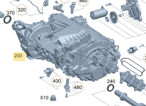

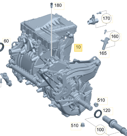

The EQC also used induction motors.
seems they also have some issues with coolant sealing (only recalled in China though!)
https://www.autoevolution.com/news/merc ... 81994.html
https://www.laitimes.com/en/article/34nq8_3ld7t.html

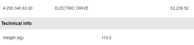

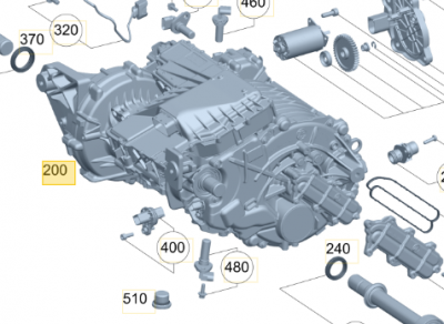

surprised by the low RRP for a new ELECTRIC DRIVE - which includes the inverter and reduction box!:
Front (10):
rear (200):
howardc64

SuperV8 wrote: Mon Sep 26, 2022 9:46 am Interesting that the E-tron also used a cooled rotor induction motor. Can't see anywhere that this special 'laser' seal is available separately - many other seals are available but it looks like it would be a new drive unit if this seal ever failed! These are between £3,000-4,000.
SuperV8 wrote: Mon Sep 26, 2022 10:34 am The EQC also used induction motors.
3 designs 3 failures
Nice find! 3 fails on 3 different attempts by 3 different teams on keeping back the coolant. On the e-tron seal, pink color is probably PTFE seal. Wonder what the dark grey material with the laser etching is?
Other diagrams also say its a slip ring seal. My understanding is such seal is in 2 parts. Each part pressed onto the shaft and the round tunnel respectively and they mate in the middle with the sealing material. But looks like no better than keeping back the coolant.
