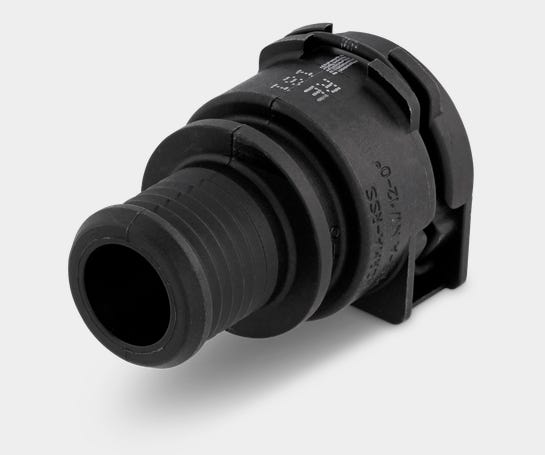

evMacGyver wrote: Mon Aug 12, 2024 7:03 am Is anyone familiar with VAG parts, cooling connections are Normaquick NW12 which is not so easy to find.
Reverse image search of a Normaquick NW12 image
with something like "vag coolant connector" finds a bunch.
Straight,
https://www.pelicanparts.com/More_Info/ ... 0-9858-INT
110°? With little bleeder hose,
ACROPIX Engine Coolant Hose Connector Fit for Volkswagen Golf MK7 - Pack of 1 Black https://a.co/d/eDVF2FE
There are a lot of options.
I'd suggest getting it from a reputable brand / reseller though. Use these to find the VW, Mercedes, etc. part number.
*Edit*
There's also this,
https://www.fcpeuro.com/Parts/?keywords ... 0Connector
Just be aware there are smaller ones for heater hoses and might be a couple sizes for radiators / hoses.

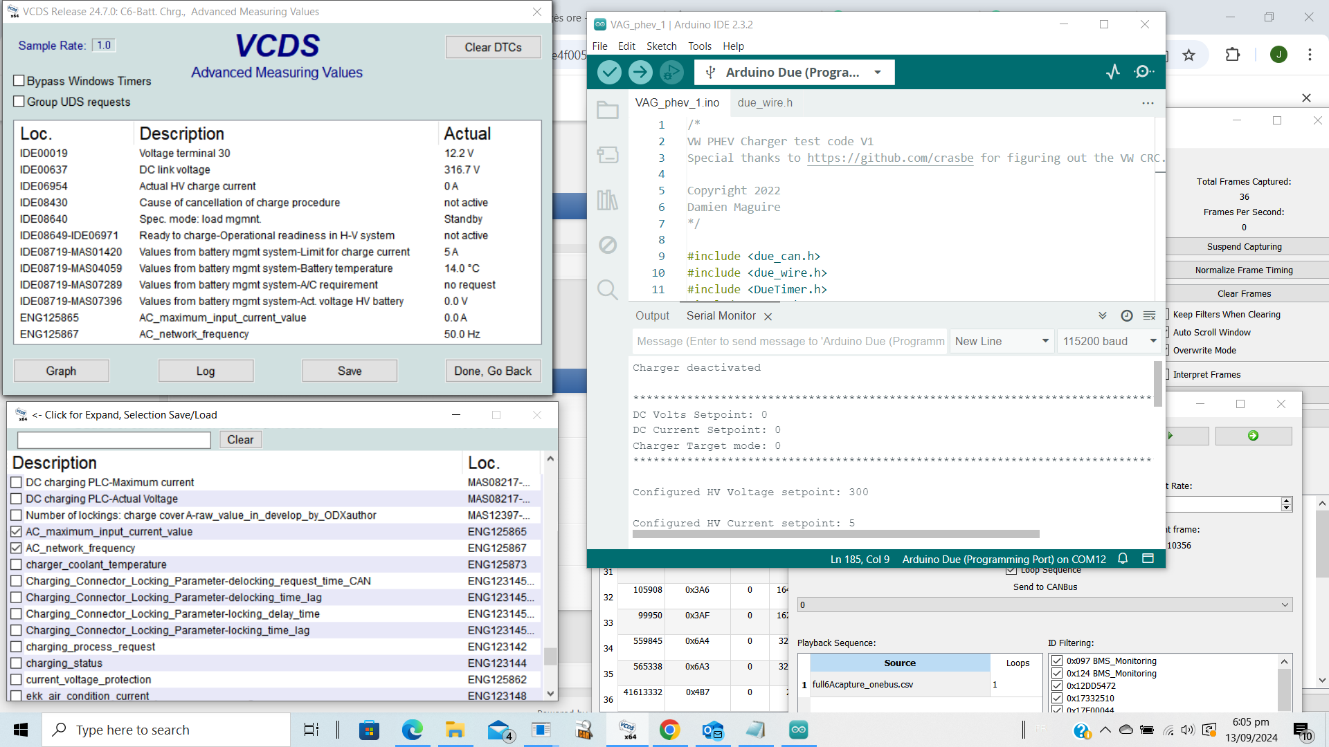

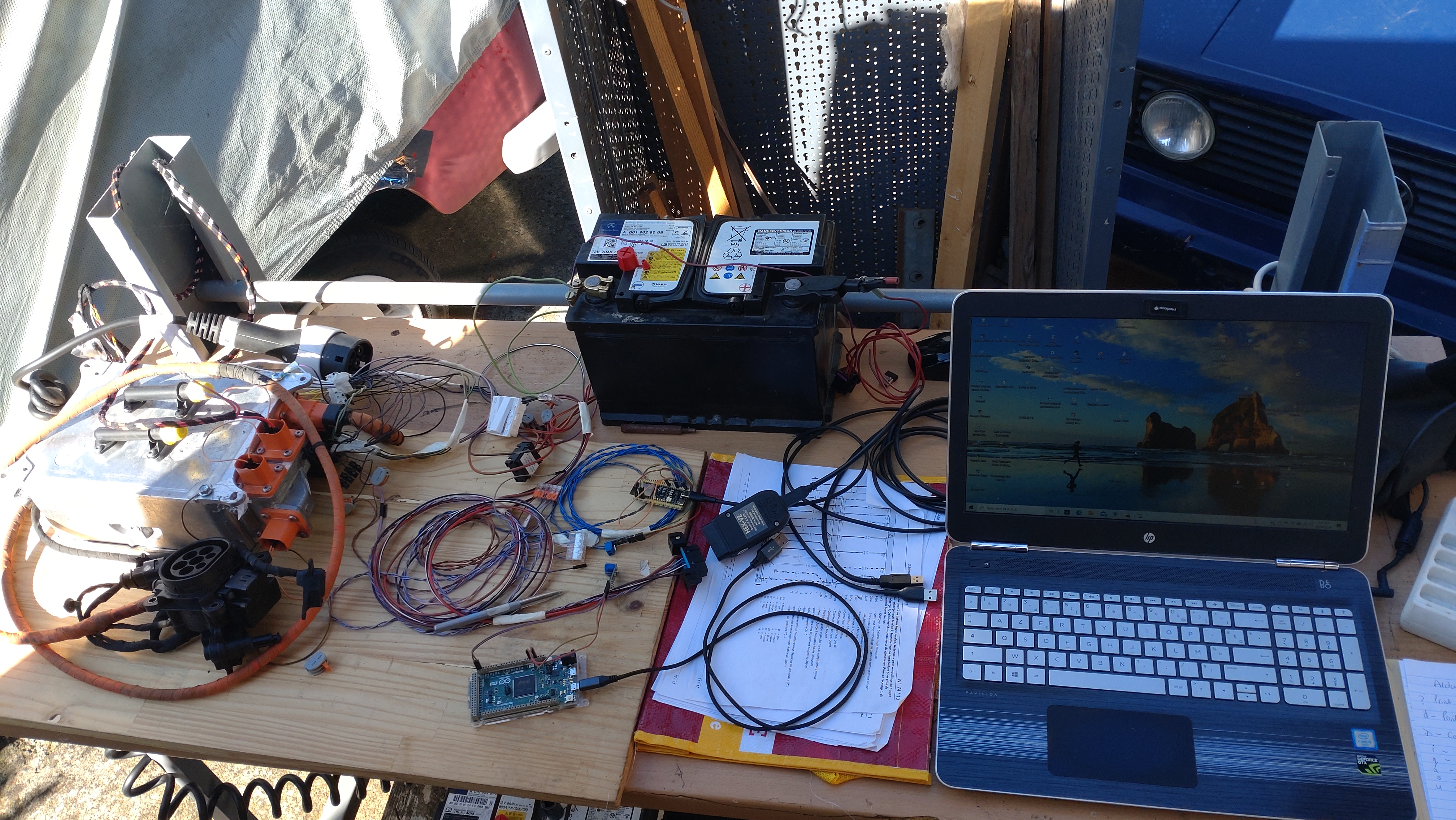

Finally had a go at getting the charger running on Damien's code after getting myself a Due board. Code uploaded but I have faults with the locking mechanism along with communications fault on PT can. Could this block the 'Damien crude code' from running?

jrbe wrote: Mon Aug 12, 2024 11:18 am Reverse image search of a Normaquick NW12 image
Ordered some 3B0122291B and sadly those was larger NW16. One from amazon with bleeder seemed to be physically much larger on pictures. So hunt continues ;)

evMacGyver wrote: Tue Aug 27, 2024 7:57 am Ordered some 3B0122291B and sadly those was larger NW16. One from amazon with bleeder seemed to be physically much larger on pictures. So hunt continues ;)
That's unfortunate.
I started a couple pages for cooling components.
https://openinverter.org/wiki/Coolant_Fittings
https://openinverter.org/wiki/Water_Pumps
https://openinverter.org/wiki/Coolant_Valves
As you dig for fittings, if you add info in the chart in the coolant fittings page it may help you and others work through this.

Back at poking the charger into life. In terms of coding, did you remove all options, even the type/brand of charger? The more I code options out, the more faults I get, but charger just sits there not charging.....

I'd really like to get this charger working. I have the vw charger port with lock etc. How did you get around the lock feedback issue without the charger port? The lock I have on the charger port has an electrical and mechanical fault in VCDS... I've taken it apart and ckeaned it. It locks then unlocks, but goes into fault mode. Since its outside of the donor vehicle, I have a doubt about faults. I have engine and hybrid CAN busses connected together as well.
Arduino code seems to change data (confirmed via Savvycan).

I managed to clear the lock faults. It locks when I plug in a type 2 granny cable. It then locks and unlocks when I connect the arduino board to run Damiens code..... sound familiar?

I uncoded everything possible. I hooked up 12v to the HV side , but there's no change to actual values in VCDS. I'll keep to banging my head against the wall :-).

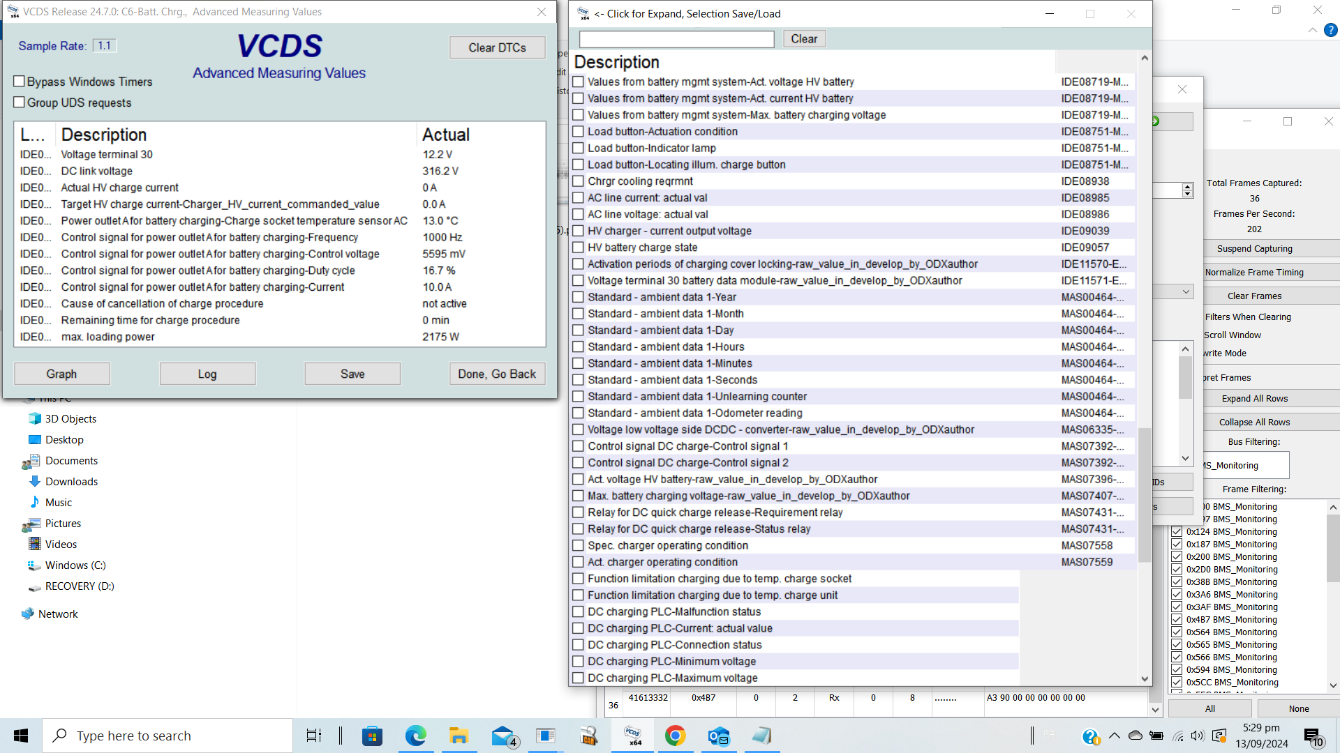

yes, I tried the charge log. With my VCDS hooked up, I see that the charger sees the type 2 plug, ramps up HV to 315VDC and starts a duty cycle and then switches off. Plug temp is around 20 degrees, LEDs don't switch on. In the fault memory there are plenty "missing messages" codes etc, along with charger lock mecanism. it's not happy with some parameter , so a confirmed working log is my first goal so I can validate my bench setup. I'm going to try and get another charger plug assembly as the lock did have signs of humidity. The LED on the charger buttons don't work either,so I coded it out, but the faults keep returning (like Bigpie).

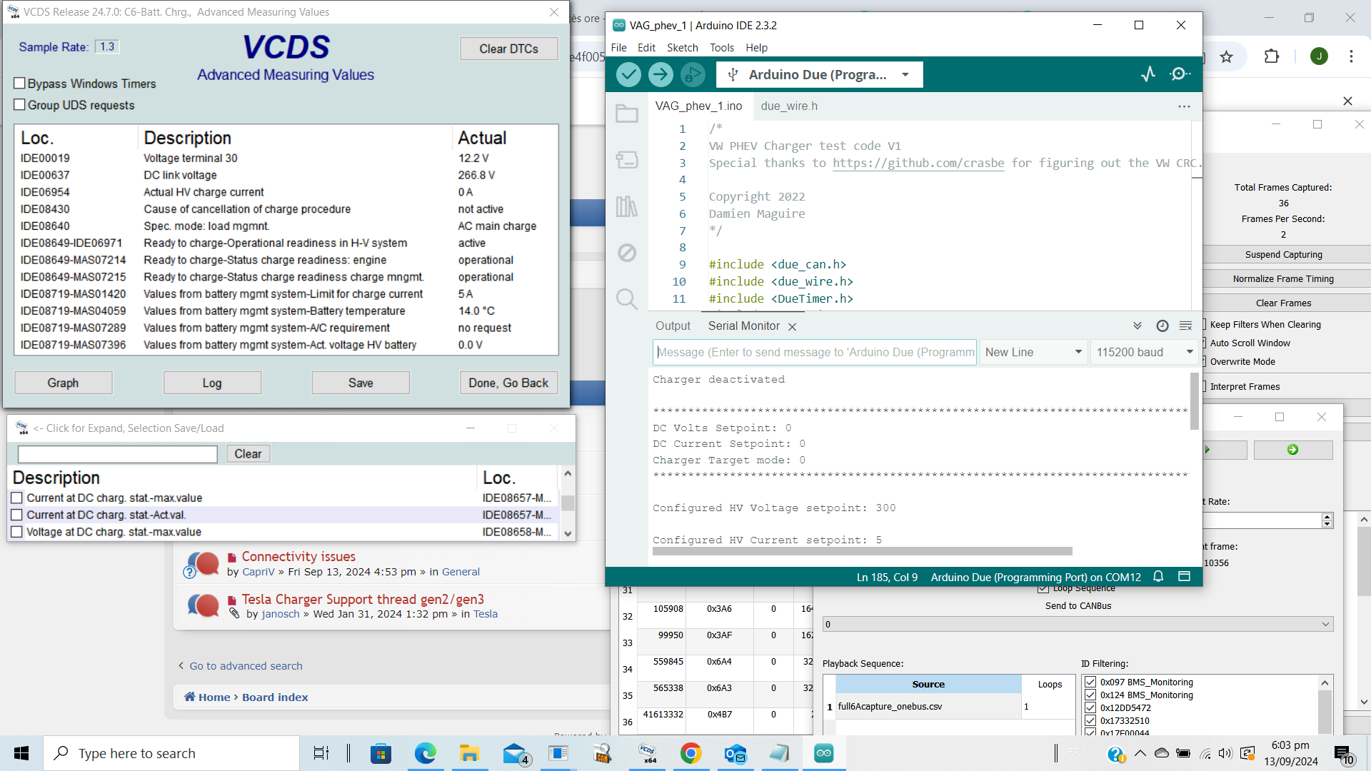

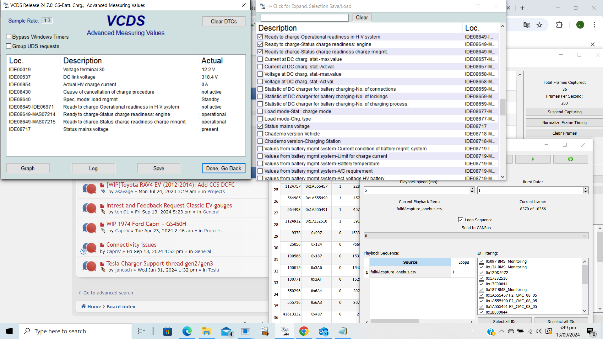

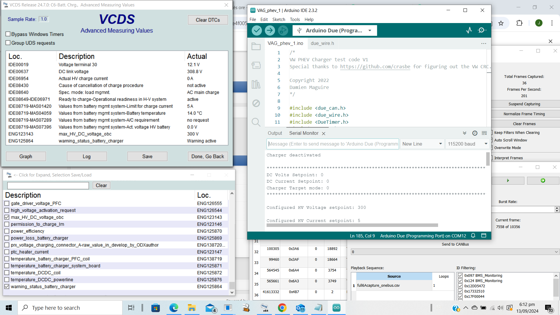

Another day of the "Damien Head-Wall Special). I've tried Dom's logs in differnt versions, but SavvyCan just shuts down each time I upload them. For now I'm playing Damiens 6A charge log back in Loop Mode and scrolling through VCDS Values. A couple of sreen shots showing diferent values, but the charger just sits there 'waiting'. I'll get a bigger heat element tomorrow as I took the iron element off when I looked at the specs tag (230VAC - 24VD!!).
But I still don't have another verifiable working log to run.
RetroZero
Posts: 885
Location: France
Has thanked: 558 times
Been thanked: 53 times
Re: MEB Chargers
Post by RetroZero »
Couple more hours spent digging through CAN logs. Managed to activate a few values using VCDS to monitor.
ID-187 Byte_1_Bit_15_SET=IDE08649-IDE06971_Ready_to_charge_Operational_readiness_in_H-V_system-ACTIVE
ID-3A6_BYTE_5_BIT_40_SET-IDE08649_MAS07214_Ready_to_charge_Status_charge_readiness:engine-OPERATIONAL
ID-5EA_BYTE_3_BITS_25,26_SET,BIT_27-FUZZING-ENG126544_high_voltage_actiation_request-REQUESTED
The last one however is adifficult one for me. I have to toggle bit 24,25,or26 to get the Actual value to change, However I cannot maintain the REQUESTED value permenantly....some kind of rolling ID? Could it be linked to the famous Magic Bytes?
Hope this sheds somelight on going forward. If this info is somewhere else, please let me know so I don't go re-inventing the wheel.

There's no thread for these findings, I've only started to document my findings now.
I've taken Damien's 6A charge log and sorted the log by IDs in descending order.
With my vcds hooked up, I selected what I think should be active for the charge process to work.
I ran the log through SavvyCan and saw a few values didn't change in vcds.
I then started taking rather big sections of ID's and "fuzzed" them.
When I saw one of the values changing, I broke down the logs untill I found the one that was related to the signal I saw on vcds.
I then compared this back to the 6A log and found that the ID was in it, so it must be related to running the charger.
So far I found 3 ID's. I forgot that some of the ID's are already cracked in the Arduino code that Damien wrote, so I need to go check that out and not reinvent the wheel, as there are quite a few ID's in that log.
Regarding ID 5EA, I can get the value to toggle, but never keep it happy in REQUEST state. I assume it does some kind of check and that there's other parameters that are required for it to remain in Request State.....
I hope that theres an ID or 2 that is needed to complete Damiens code (as it apparently doesn't work anymore). Then we can move on to polishing up a working solution...

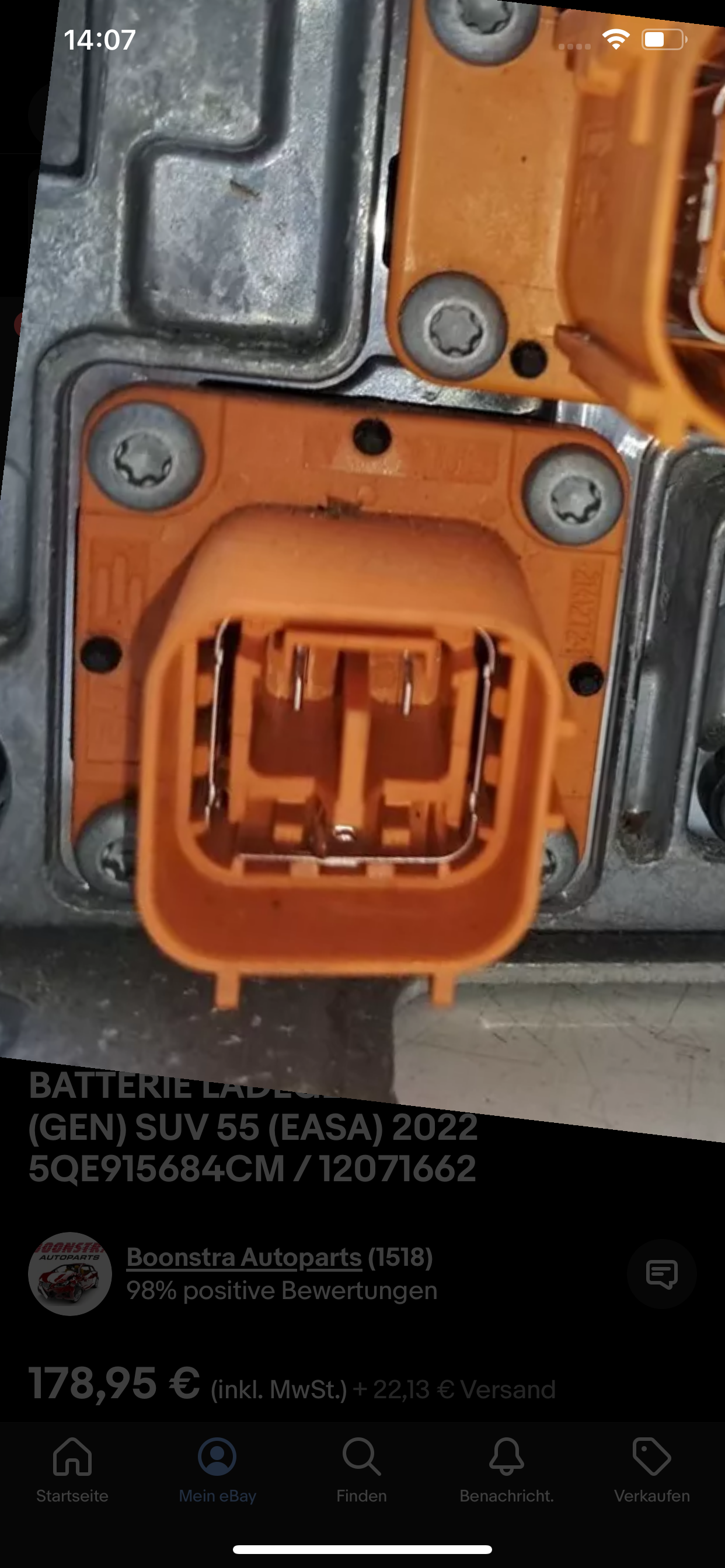

Did anyone found out the part number or the hv connector and the number of the VW harness ?
