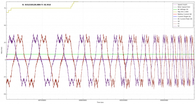

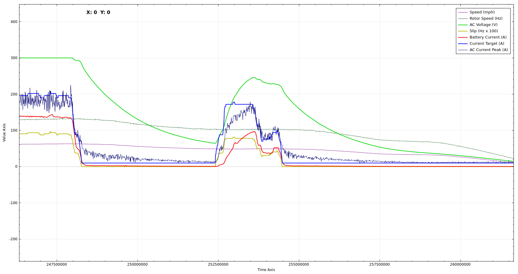

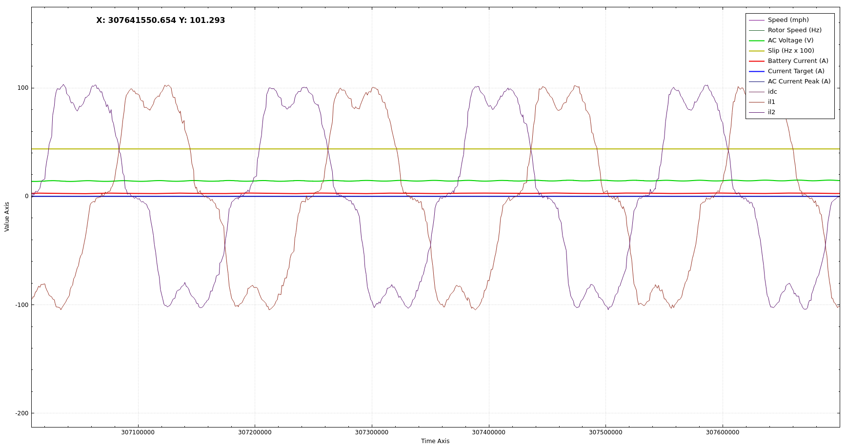

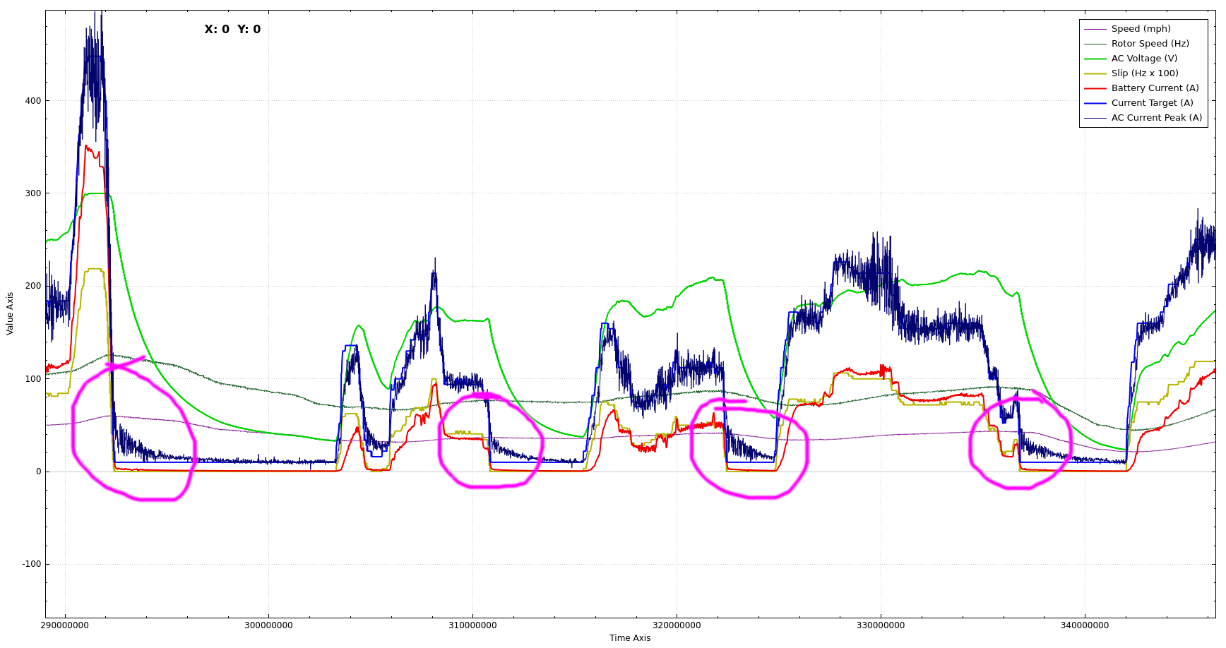

Taking a fresh look at the data, here are a couple of observations:
Looking at the charts, every time the throttle is released at slip returns to zero, the current immediately drops to 40A. No matter how much current was commanded before, it always falls to around 40A. I have a parameter imag designed for precisely this purpose. It sets the minimum current (applied at zero slip), and it seems clear from my drive today that this parameter is set too low at 10A. I don't know exactly what this means, but it seems to me that there is something in the motor (rotor field?) that is slow to react, and we're better off following it rather than trying to force it to change.
Second, why does current sometimes instantly rise to meet throttle (slip) demand?
But other times fails to do so?
It would seem to me that we want to try to operate as much as possible in a region where voltage does not need to change in order to meet instantaneous torque/current demand.
And of course the big problem I keep coming back to. What is the root cause of the oscillation?
And the weird waveform that probably causes it:
Putting aside this oscillation, the direction reversal in this chart is very cool. This is me using the throttle to come from a reverse to forward movement completely smoothly.
Apologies for thinking out loud excessively. I find documenting all my findings and ideas here helps a lot. :ugeek:

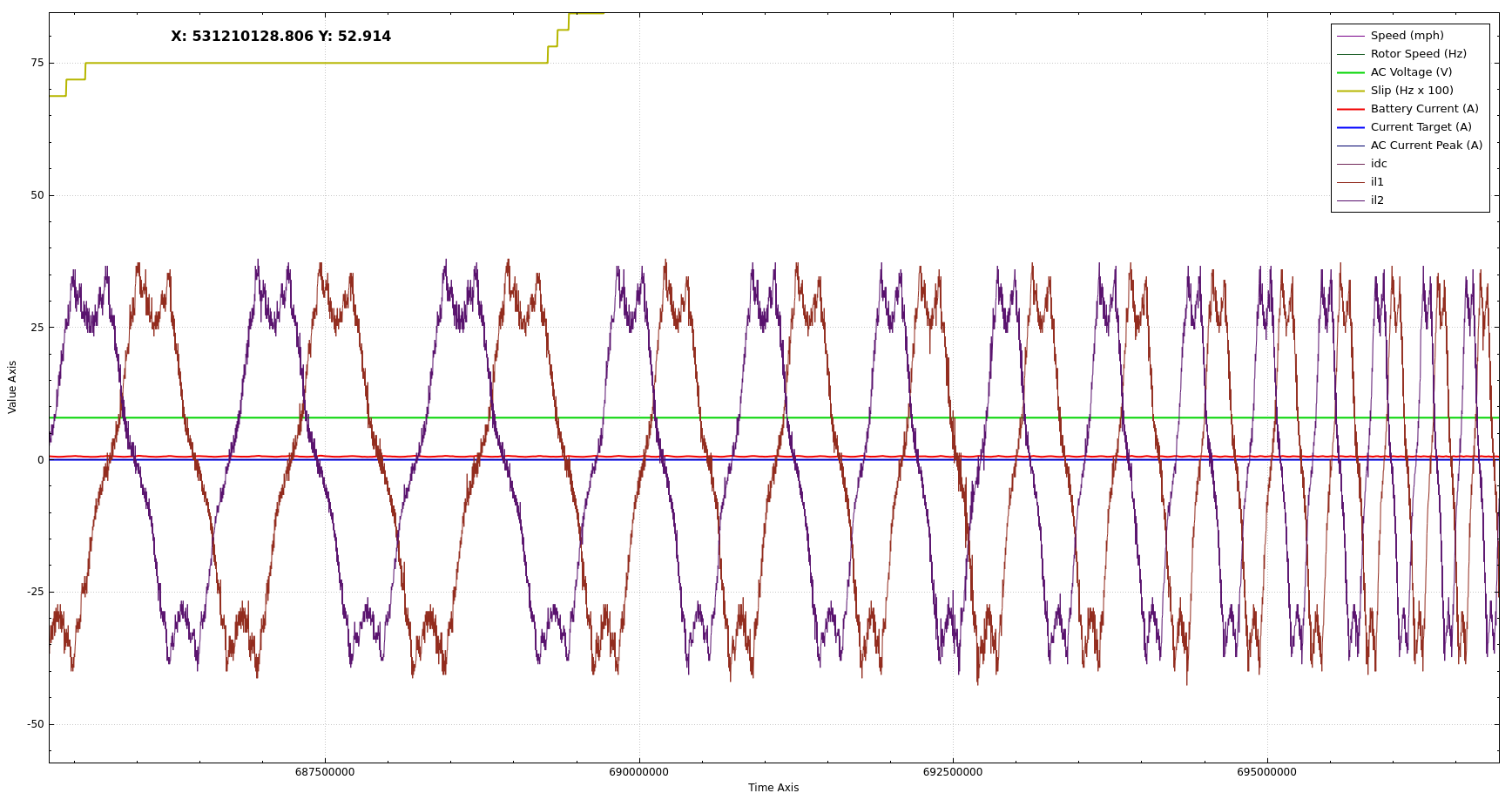

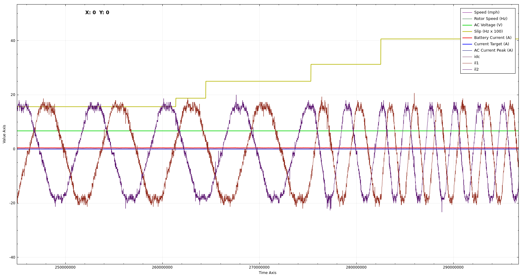

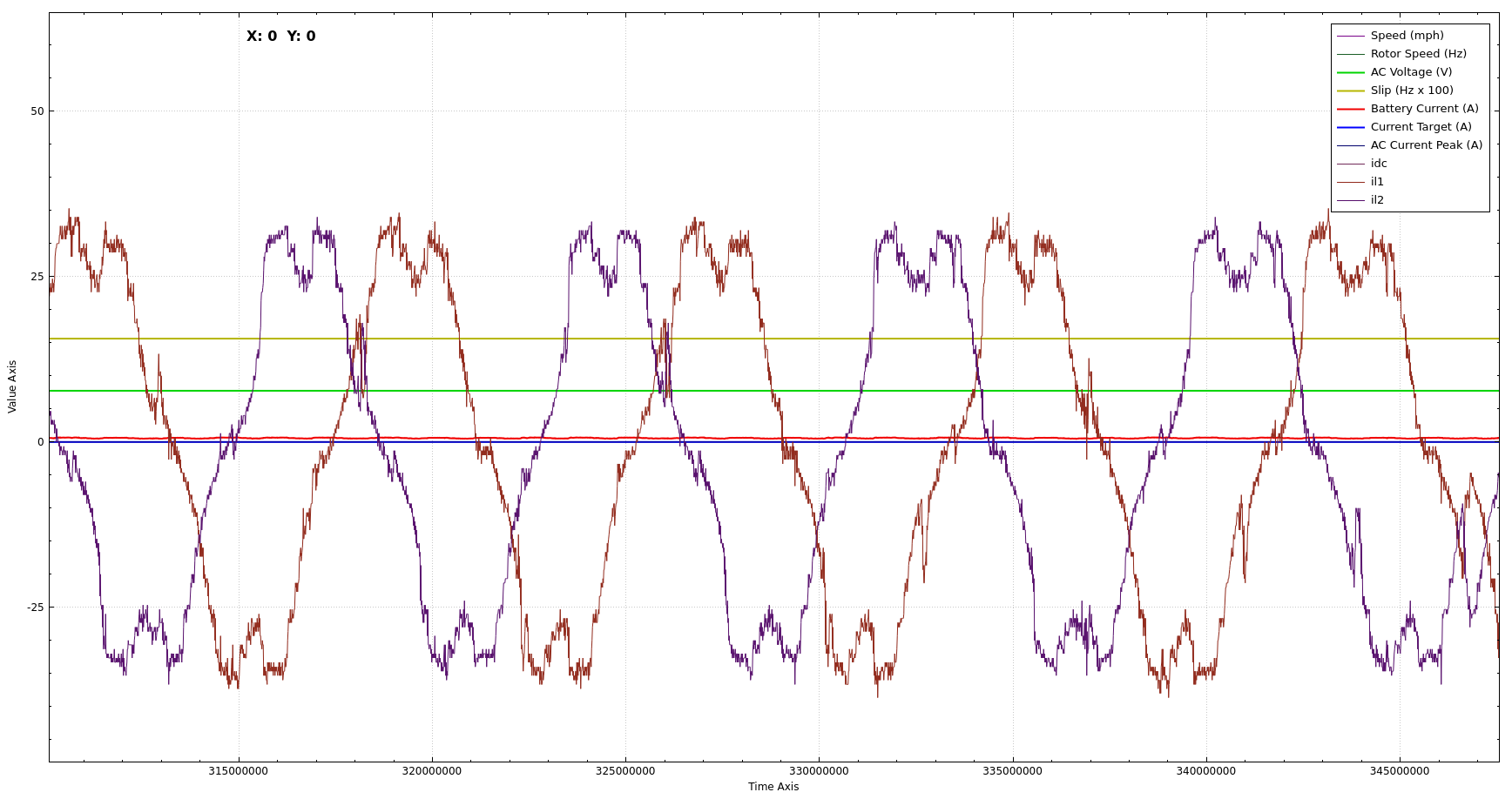

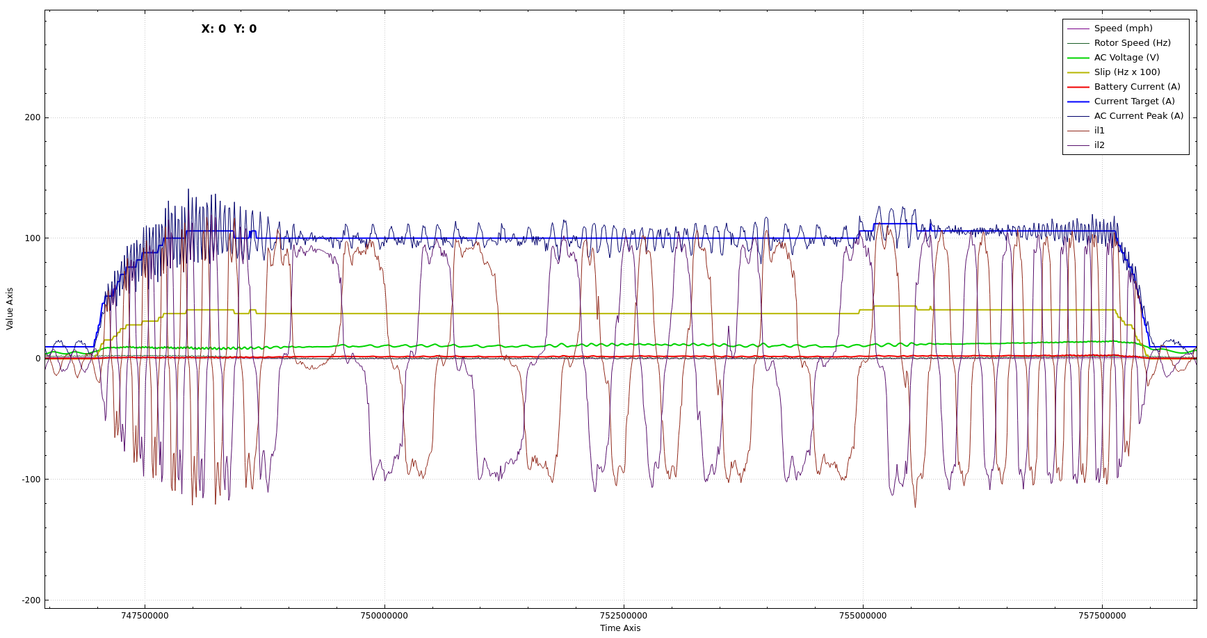

I'd prefer to be working on more exciting things like field weakening, but I can't get my mind off this weird current waveform problem. Specifically I am now quite sure this is a negative 5th harmonic at around 20% of the main signal. But where's it coming from?

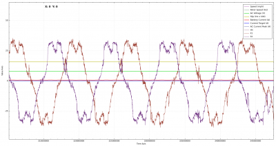

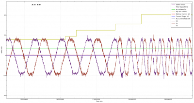

I did some tests today with higher resolution logging. Here is a test supplying 8V to the motor at current sweeping from 0.75Hz up to 3Hz with a stationary rotor. About 40A current
Here's an example with more current (around 100A at 6Hz, only 0.4Hz slip):
Interestingly this happens pretty much all the way down to DC. Here's 30A at 0.15Hz:
By reducing current to 15A the problem, while still visible, it much less pronounced:
What on earth is this? I suppose the next obvious step with this is to see if it happens on my bench motor with the same code. If so, I will be able to get a scope on it and better diagnose.

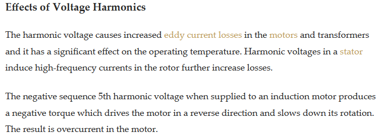

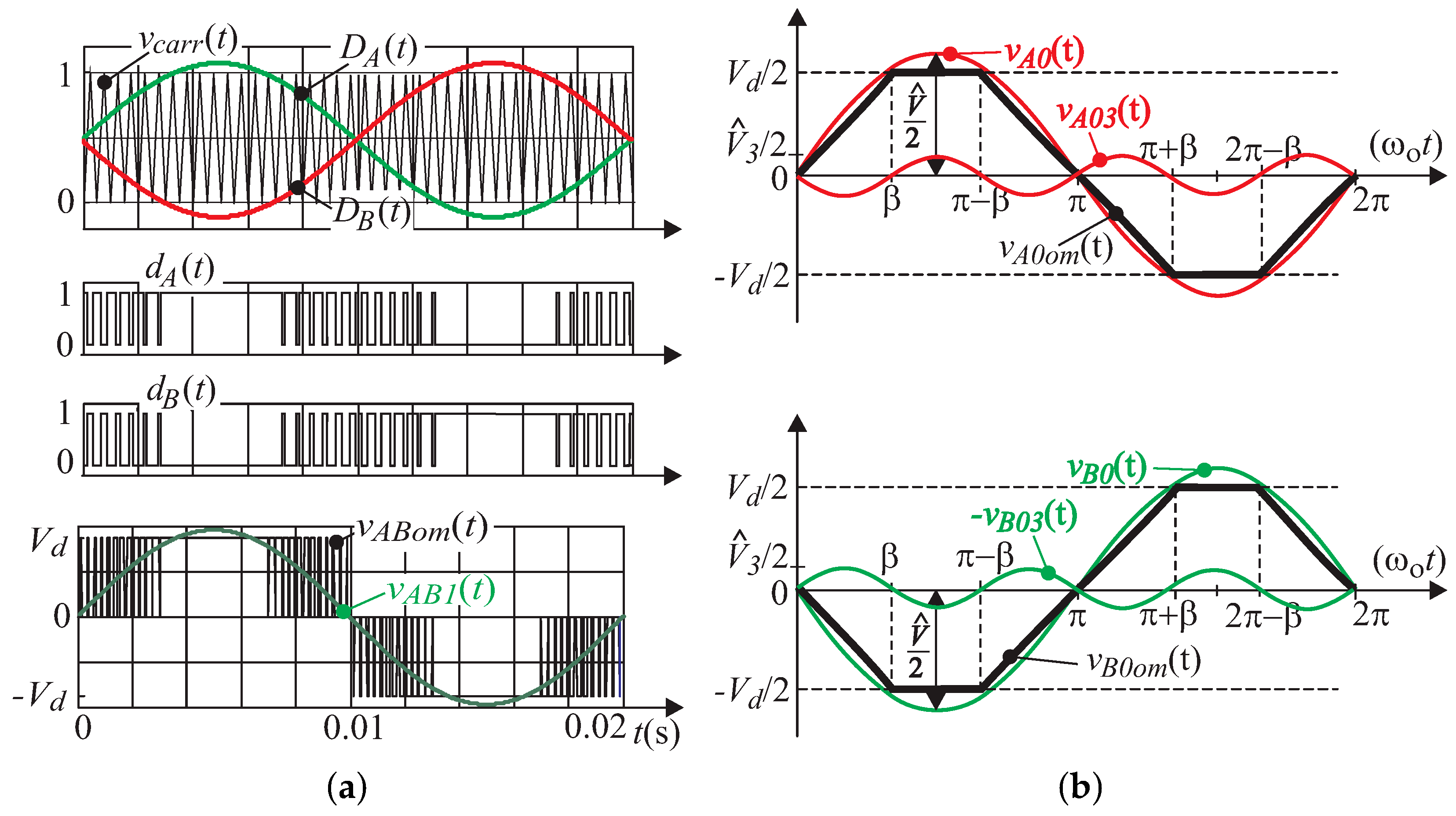

catphish wrote: Wed Feb 01, 2023 1:41 pm What on earth is this? I suppose the next obvious step with this is to see if it happens on my bench motor with the same code. If so, I will be able to get a scope on it and better diagnose.

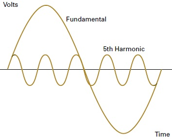

Could it be this ;)
catphish wrote: Wed Feb 01, 2023 1:41 pm Specifically I am now quite sure this is a negative 5th harmonic at around 20% of the main signal. But where's it coming from?
Seriously though, harmonics generation is inherent in the way the magnetic flux moves between segments of the stator/rotor and non-linearities in the B/H curve of the cores. Most of the maths is for an ideal motor and ignores this (and assumes that the fields are all nicely homogeneous without individual segments) but unfortunately ideal motors don't exist! That web page you linked above explains it pretty well, and in particular the way closed loop FOC is able to compensate for it at low speeds. Your control is open loop so can't do anything about it so whatever harmonics the motor produces is what you see in the waveforms.
Also suspicious that something is getting close to saturation (best guess would be the rotor) which is going to move away from the linear region of the B/H curve which heavily increases their non-linear behaviour and so increases the amount of harmonic content generated. That would explain why the effect is reduced in your 15A plots.

Pete9008 wrote: Wed Feb 01, 2023 3:10 pm Seriously though, harmonics generation is inherent in the way the magnetic flux moves between segments of the stator/rotor and non-linearities in the B/H curve of the cores. Most of the maths is for an ideal motor and ignores this (and assumes that the fields are all nicely homogeneous without individual segments) but unfortunately ideal motors don't exist!
Thanks. I was hoping for easy answers :cry:
Pete9008 wrote: Wed Feb 01, 2023 3:10 pm Also suspicious that something is getting close to saturation (best guess would be the rotor) which is going to move away from the linear region of the B/H curve which heavily increases their non-linear behaviour and so increases the amount of harmonic content generated. That would explain why the effect is reduced in your 15A plots.

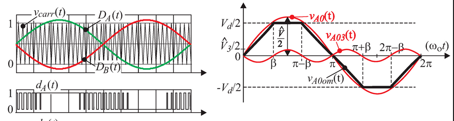

I'm going to stop guessing and properly read the paper I linked on Adaptive Feedforward Cancellation and see if it will help me. Bear in mind my algorithm *is* closed loop (at least in terms of overall amplitude, on which these oscillations show up very clearly) but my adjustment gains are far too small to squash them in time. Note that I've been intentionally disabling my current feedback and outputting a fixed AC voltage in order to make these charts, as the algorithm compensates enough to make it less clear what's going on.

Pete9008 wrote: Wed Feb 01, 2023 3:10 pm That web page you linked above explains it pretty well, and in particular the way closed loop FOC is able to compensate for it at low speeds.
I think I understand this AFC algorithm, but looking at the pseudocode, I don't understand what "thetadot" is.
Edit: never mind, I clearly missed a paragraph that explains it very clearly.
The simple fix for this is to divide the error by angular velocity before integrating, and then multiply by angular velocity at the end of the AFC calculations.

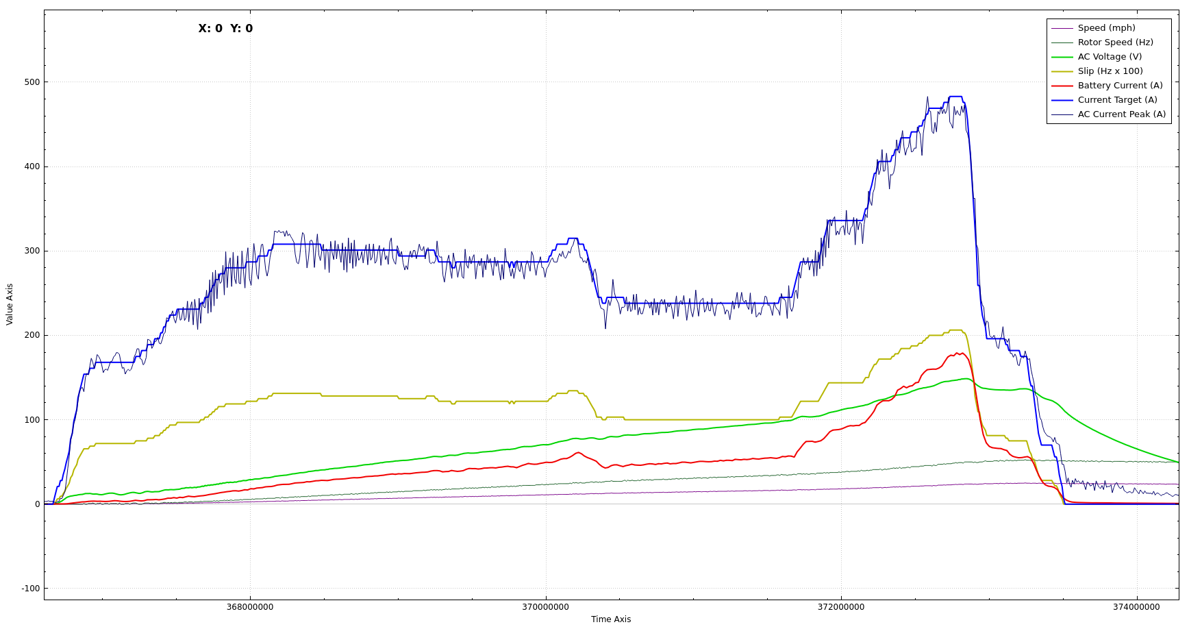

Today I added automatic field weakening. Essentially all this does is when voltage runs out and there is still a demand for additional torque, it increases maximum slip up to a defined limit When current no demand no longer exceeds current, it steps it back down again. Here's a 0-60 with fslipmax=3 and fslipweak=4:
I'd say that's a pretty big success, though the gain is clearly a bit too high.

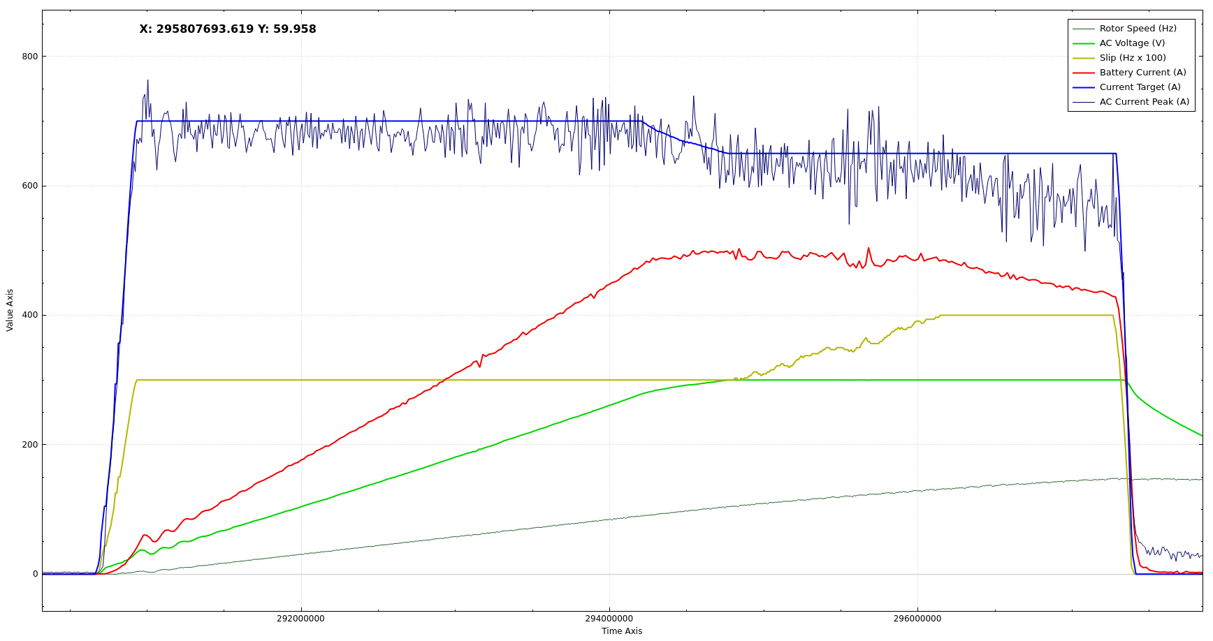

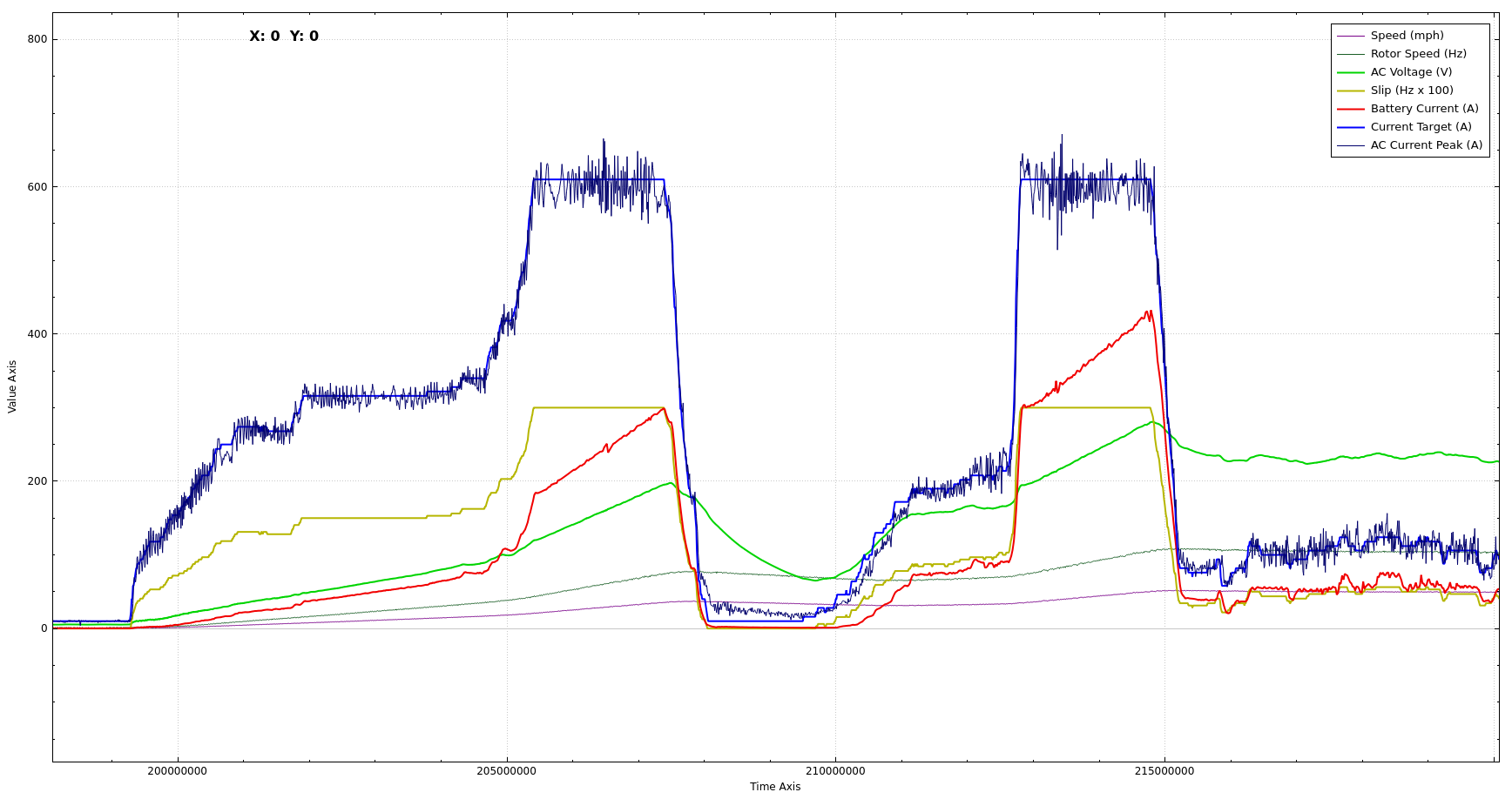

So here the final (hopefully) release (5.26.Z) and SDU config. We now have:
* AC current control and limiting
* DC current limiting
* Dynamic field weakening

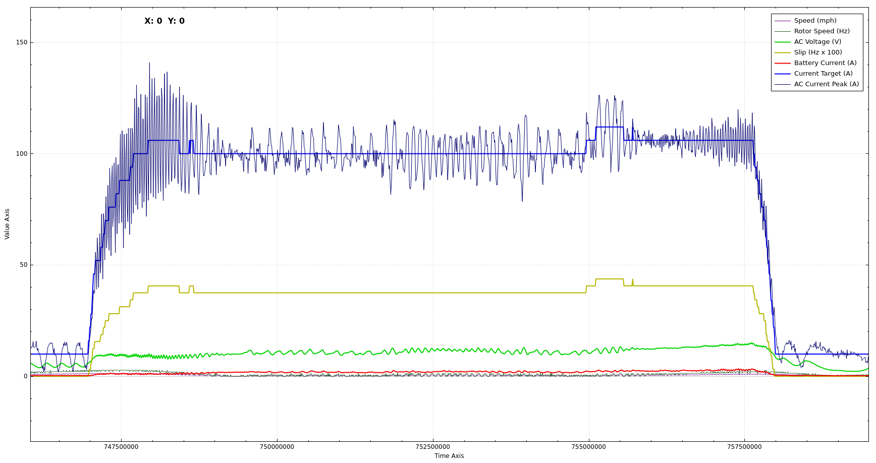

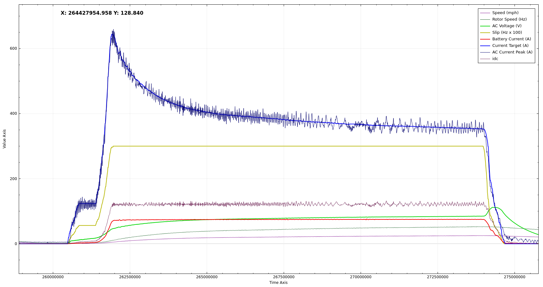

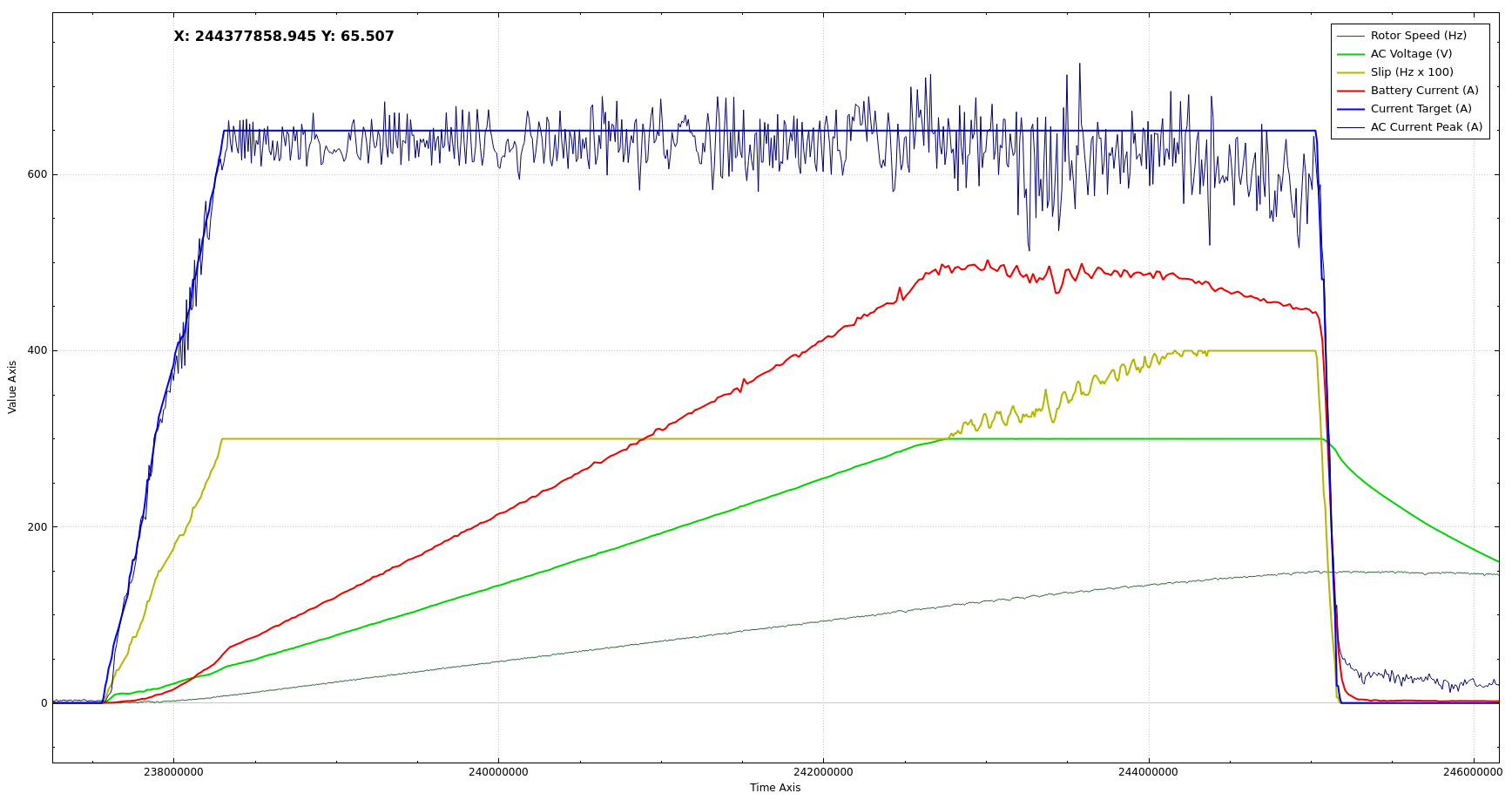

Here's a chart demonstrating a 0-60 run in which initially the AC current it limited to 700A peak and then as DC current rises, the AC current limit is reduced to keep the DC current within its limit of 500A. Field weakening is also increases as needed from 3Hz to 4Hz.
Here's a more dynamic part of the same test drive showing throttle response (note the throttle is unfiltered so the current target is also the realtime throttle position).
Parameters used:
fslipweak=4
fslipmax=3
fslipmin=0
throtcur=7  -  I usually run 6.5 (650A) but 7.0 (700A) gives a decent extra amount of torque
curkp=1
ocurlim=1000
idcmax=650
Note that idcmax doesn't actually match real DC current, but it doesn't really matter. A value of 650 gives a limit of about 500A.
Using this configuration, the SDU is absolutely lovely to drive and sends my car to 60mph in 5.0 seconds with very consistent torque and throttle response.
Source code available as always at https://github.com/catphish/stm32-sine/tree/amp
Regen is abandoned for the foreseeable future to preserve my sanity.

Re: Current control of induction motors
Post by catphish »
johu wrote: Fri Feb 03, 2023 4:30 pm Wow, that looks very smooth! Does it drive as nice as it looks?
Yes :)
At high current levels, the current sensor looks pretty noisy, but this isn't reflected in the amplitude output or the driving experience. Maybe the gain is a little high on the field weakening, but you can't feel it.
Been thanked: 1918 times

My suspicion would be that this will still work. There's quite a lot of noise during real driving, and consequently, the gains on my controller are very low, so the resolution is not critical. I believe there's only one way to find out though. :twisted:

On the subject of current sensors, I'm having doubts about the accuracy of the current sensors in my SDU.
I am using a gain of il1gain=1.5 (1.5 digits per amp?) which comes from the recommended config, but has this value been calculated / confirmed? In many ways it doesn't matter, but I'd like to know if it's accurate.
According to my calculations, at full load, I'm getting a power factor of 0.6, which seems extremely poor. Hard to know if this is the current sensors, my calculations, my tuning, or just whether that's the best the SDU can do.
I suppose the only way to know for sure is to find a way to pass a known current through the phases, but I don't have a convenient way to do that.

I am a bit slow with these messages, but here is a fifth harmonic of the fundamental:
Depending upon the polarity of the fifth harmonic we get either very peaky overall waveform or a flattened crest, which is what we see in this post.
Just to add some cats to the pigeon cage from here: https://www.electrical4u.com/fundamenta ... harmonics/
On the other hand, with overmodulation and inverters, we get this: VA0 (OverModulation)(t).
{With no overmodulation we just get VA0(t)}
Here the carrier of the waveform is swamped by a positive DC or a negative DC between Beta and Pi-Beta of the first half of the waveform and I know Toyota use this for part of their driving their MG1s and MG2s more strongly I suppose during acceleration. In this case, the harmonics are helpful (For the last picture, they happen to show a 3rd harmonic not 5th). This overmodulation is helpful to get a bit more out of the motor, otherwise Toyota would not do it.
Probably everyone knows all this already?

johnspark wrote: Sun Feb 05, 2023 10:45 am I am a bit slow with these messages, but here is a fifth harmonic of the fundamental:
Thank you. I think this confirms what I already suspected. I should clarify, the reason this is a problem is that at low frequencies (anything below about 2Hz), this effect is quite noticeable as a torque ripple at 3x the motor frequency.
The effect can be masked by using a large minimum slip (in my V/Hz setup I sometimes end up running fslipmin=3), and essentially avoiding driving the motor at low frequencies at all, but this isn't ideal.
In theory we could overcome it by injecting an opposing harmonic, but I didn't get very far experimenting with this as the effect isn't nearly as easy to reproduce on the bench.
