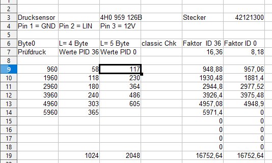

if you want to use the golf pressure sensor 4H0959126B to, you get an answer on PID[0] (0x80) 5 byte long and PID[36] (0x64) 4 byte long.
connector 42121300 1=GND, 2=LIN, 3=12V

Posted: Sun Mar 28, 2021 5:00 pm
by muehlpower
I made a couple of measurements. In the first column is the applied test pressure in mbar, in the second and third the value transmitted by PID 36 and PID 0. 16.38 and 8.18 are the multipliers to get the results in the last two columns. I don't know why these are should these values, it doest'n make sense with any known pressure units.
