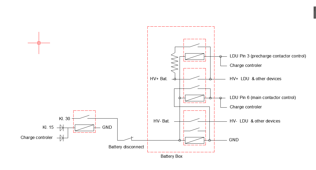

Even if it doesn't help now, I have wired my main contactor with its auxiliary contact so that it holds itself. So the only way to switch off is to switch off terminal 15 (ign.), regardless of the settings or the function of the control board.

Re: [DRIVING] 1940 Chevrolet with Tesla Motor
Do you have a wiring diagram or sketch of that? I've been thinking about how to wire it so that the board still turns it on, but it only turns off with the keyed ignition. Not sure I'd implement, as this really seems like a fluke thing.muehlpower wrote: ↑Sat Jul 06, 2024 7:27 am I have wired my main contactor with its auxiliary contact so that it holds itself.

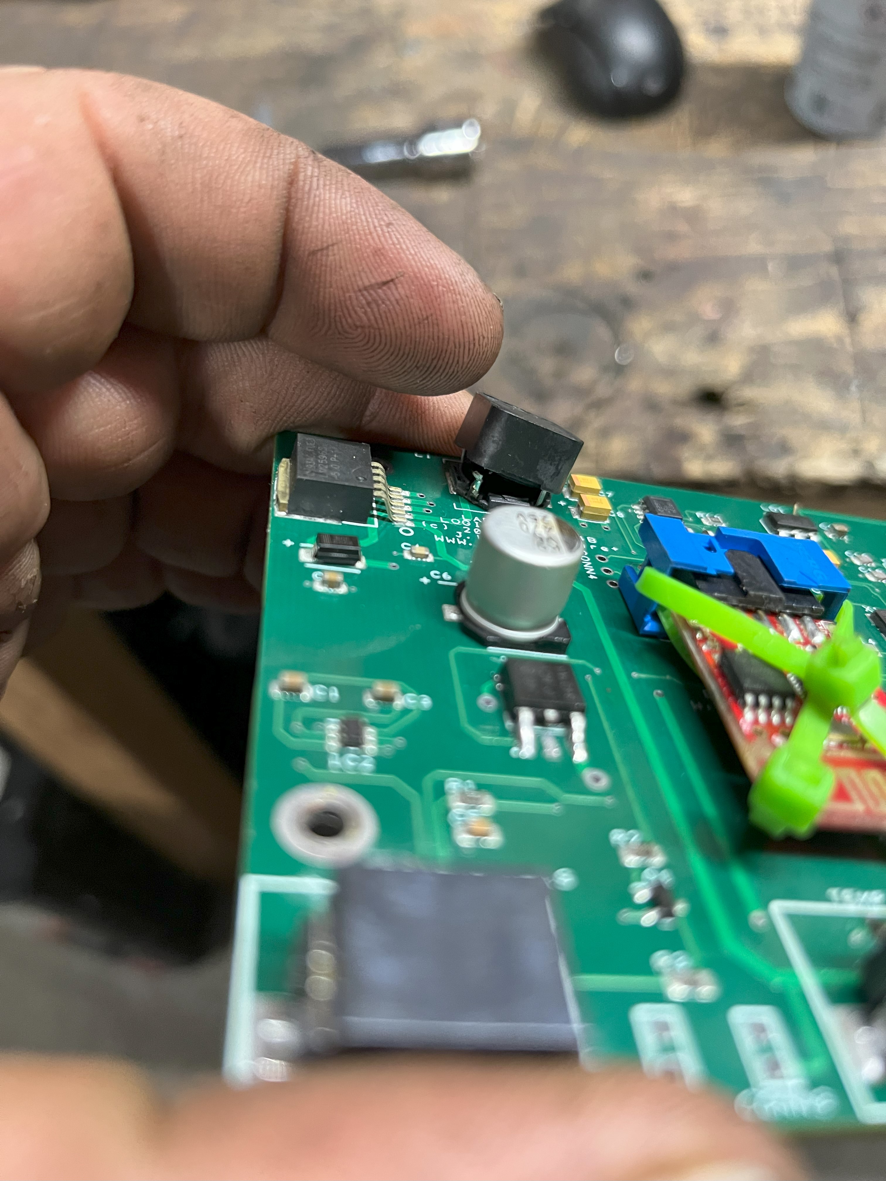

For those interested, the failed part on the control board:
if your main contactor does not have an auxiliary contact, you can also switch a small relay in parallel.

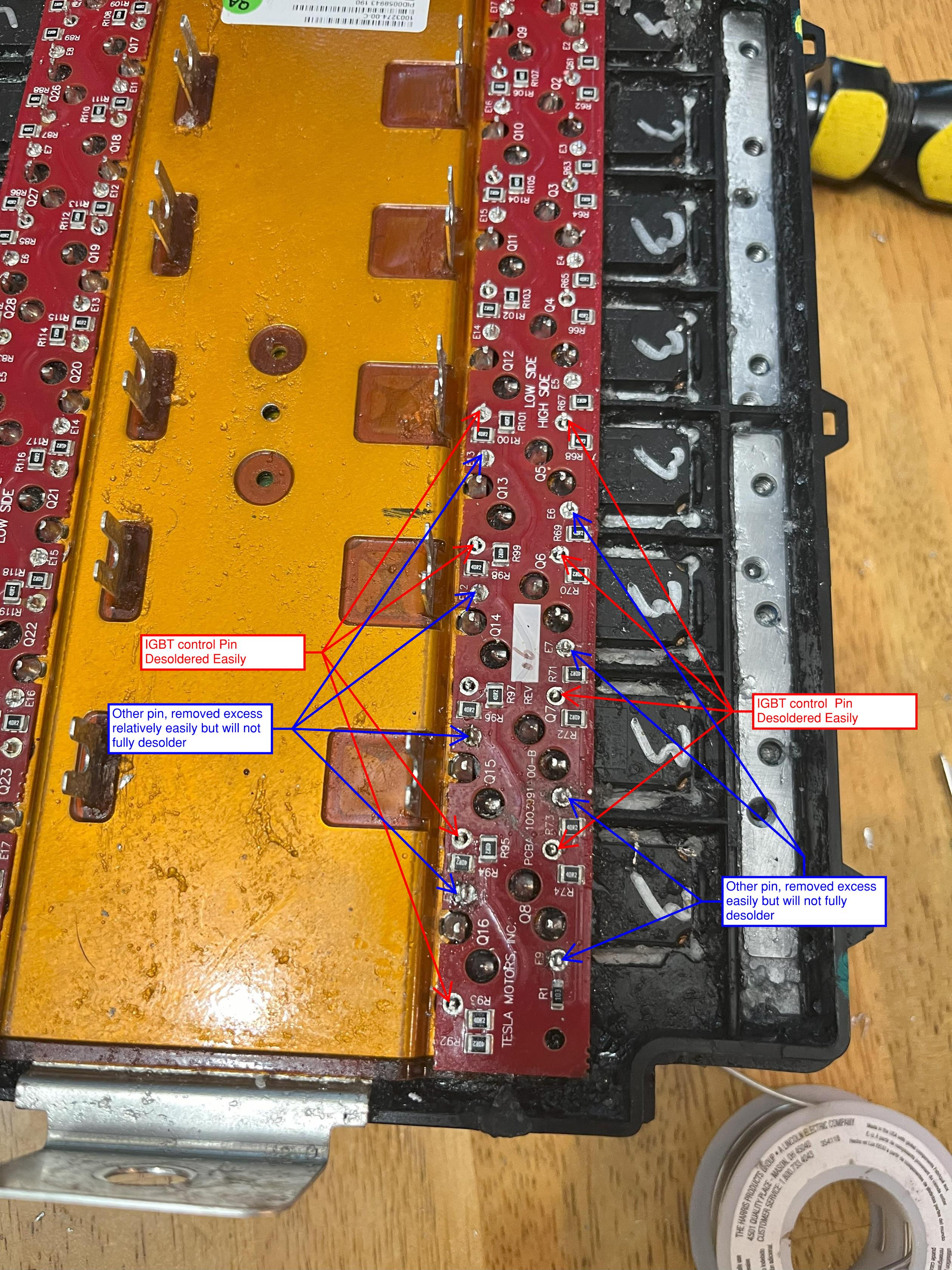

My repair of the inverter has slowed to barely a crawl, and I'm hoping some of you have advice.
The only good news is that I've figured out the damaged IGBT(s) are on the low side, the high side has no shorts.
To get access to all of the IGBTs, the PCB they are connected to must be removed. There are two primary pin types attached to this PCB - the control pin of the IGBT, and a pin that I believe connects to the bus bar in some way, but I'm not really sure. The control pins desoldered easily with a 30w soldering iron and spring loaded solder sucker. The other pins I was able to remove the glob of excess solder with a 60w soldering iron, but they remain firmly soldered to the board. I've gotten up to preheating the board with a heat gun and then using a 200w soldering iron, and still making minimal to no progress removing solder. I've tried adding solder, I've tried not adding solder. I've tried adding pressure behind the board and not doing so. I'm at a bit of a loss and really need to get this inverter fixed and back on the road. The image below notes the two pin types.
I'm considering taking this to an electronics repair shop and having them try to do the fix, but I really don't want to do that. Any advice would be appreciated.

Re: [BROKEN AGAIN] 1940 Chevrolet with Tesla Motor
Do you have a non food oven you can put it in to preheat it to say 65°c (or the max sustained temp of the lowest temp component, maybe 85° c? That should help getting the thermal mass temp up so the soldering iron can hopefully do it's job.
I have a fairly cheap smd rework station and I'll use the hot air gun in combination with the soldering iron like you're trying here. I don't think it will be enough to be useful.
You might be able to carefully use an infrared heater too.
There's also the trick of desoldering as much as you can then adding a blob of low temp solder to get it all melting.
A thick desoldering braid might be really helpful.
I don't have a non-food oven, but seeing as I'm currently using the kitchen table as a clean workbench for this work, I'm not terribly worried about putting it in my normal oven, so I may try that.
I've had a little bit of luck here but its been unhelpful more times than its helped on the hard pins.
Small update; I did finally manage to remove the PCBs, and now I'm wrestling to desolder the busbars and IGBTs. This is slow going but there is some progress happening. My next two weeks have been completely blown up by work and family commitments, but hoping to squeeze in some work on the inverter. I need to get it off my kitchen table, and more importantly I need to get the car running ASAP.
