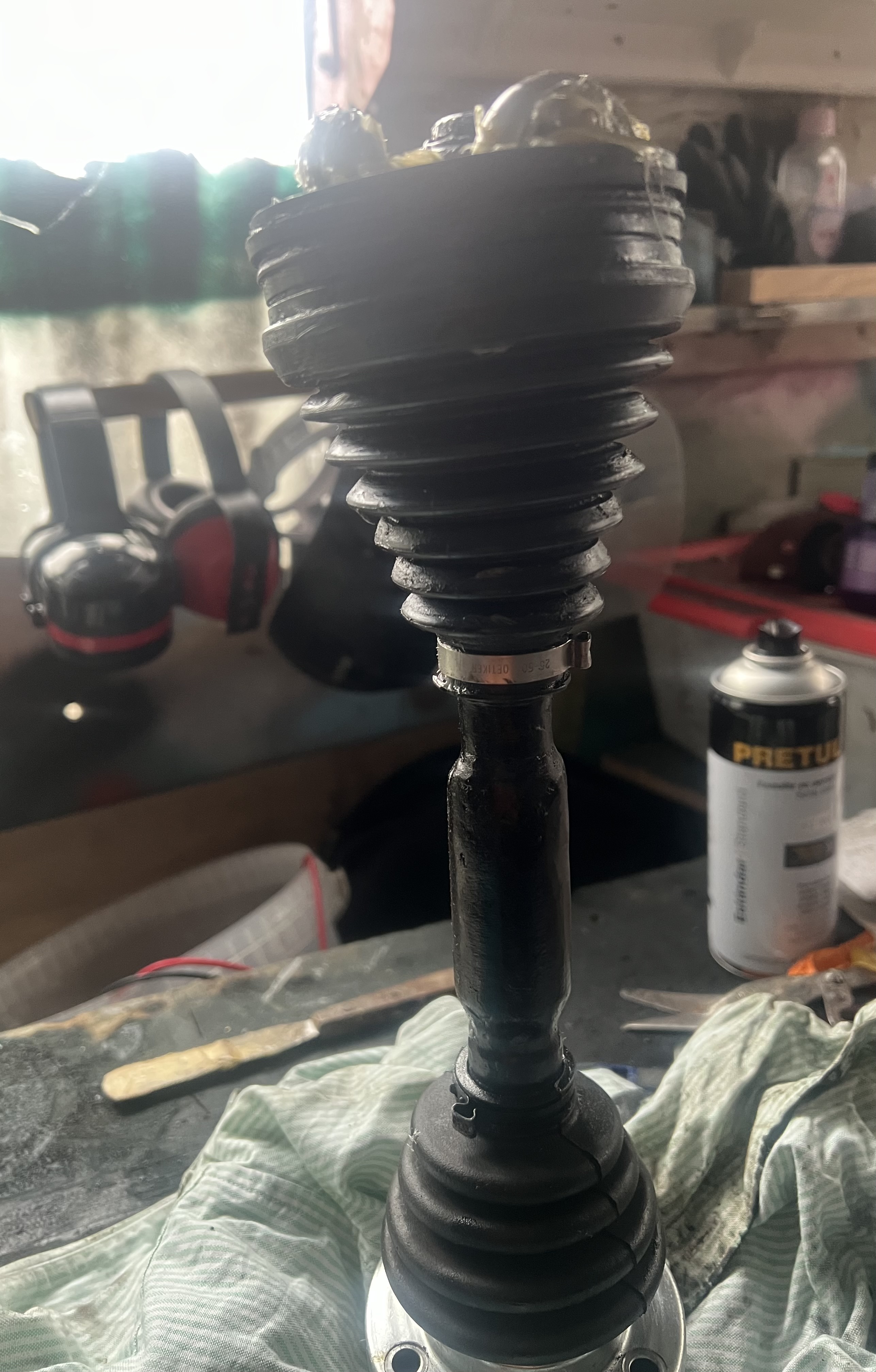

Re: Unlocking the power/torque of Prius gen 3 drive train?
Post by Ghia66 »

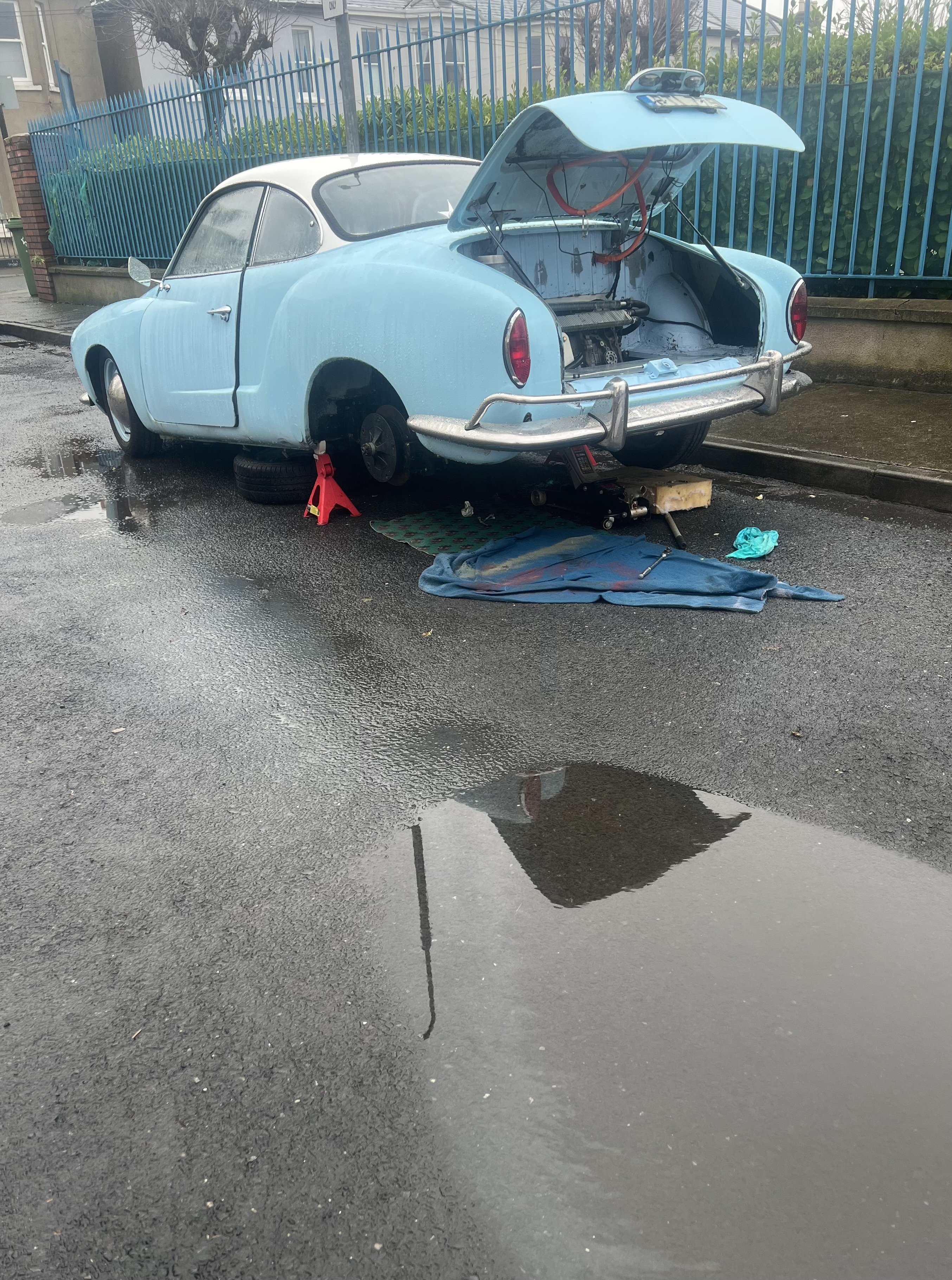

Welded up and ready for action!
As Greg said “Two Post Lift in the free range, open air, organic garage setting with liquid cooling”
Not pleasant in the workplace today!

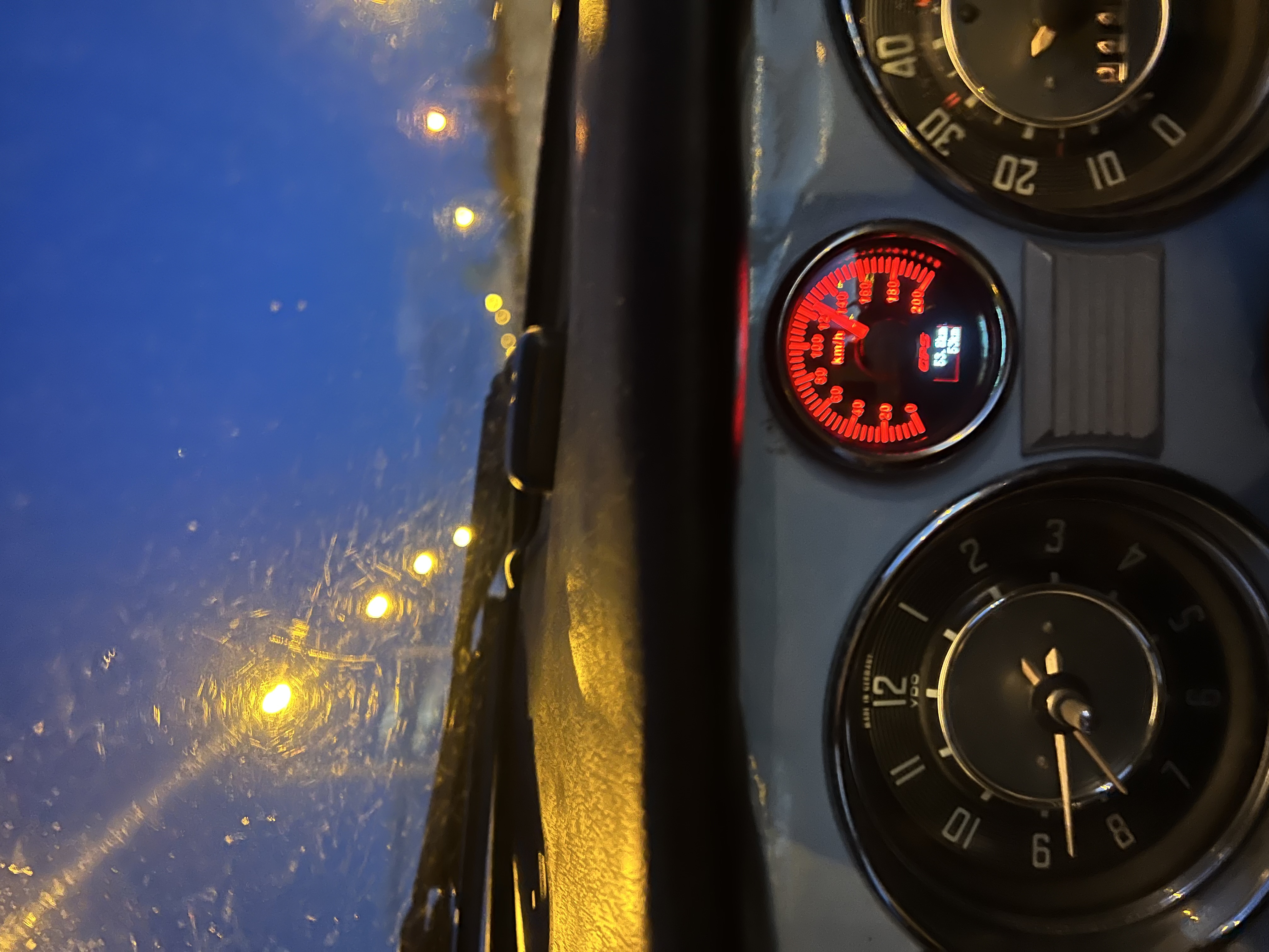

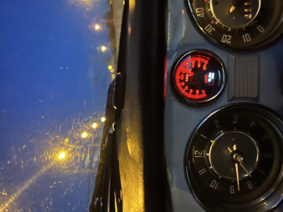

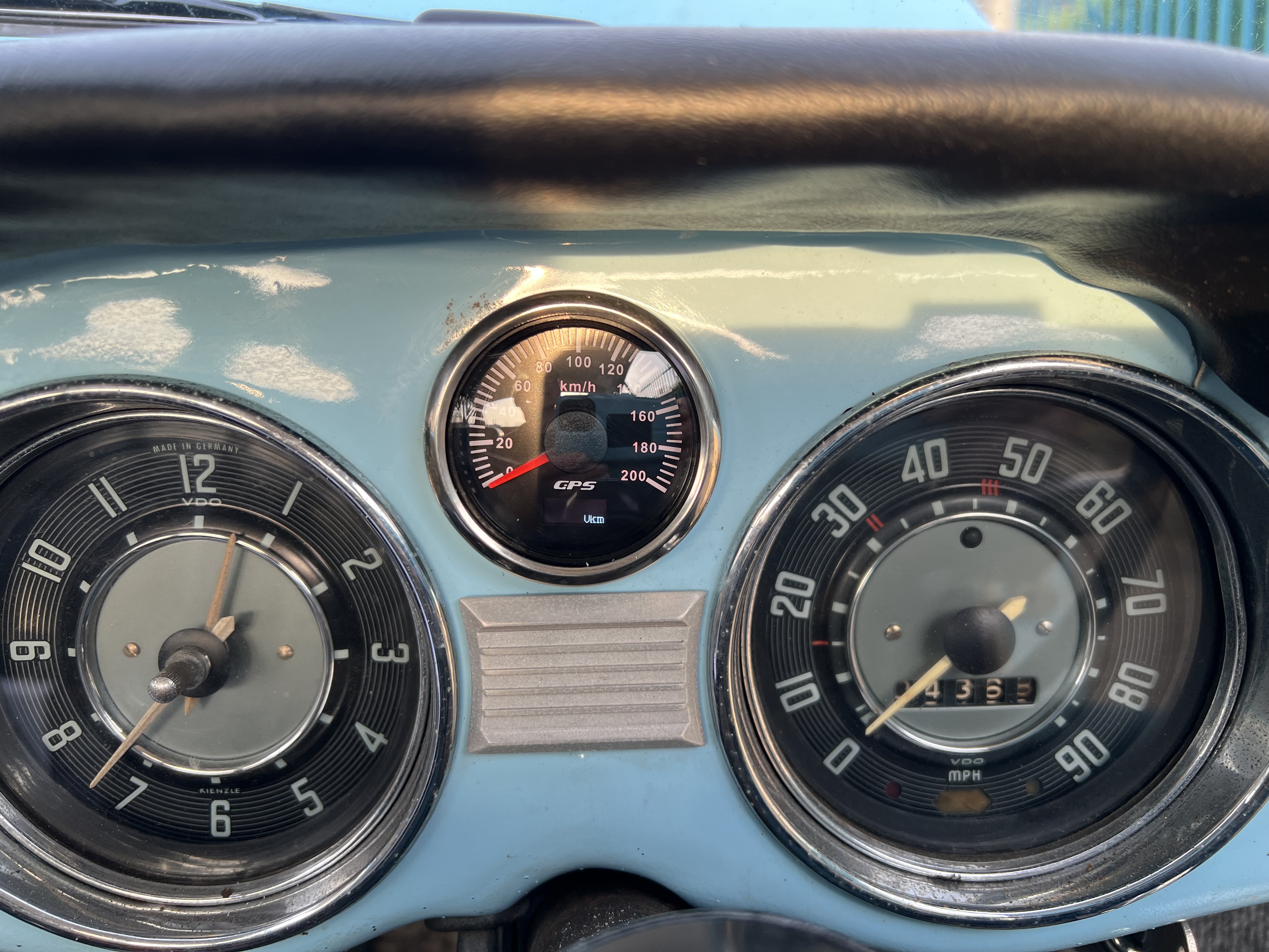

Okay, I’m now ready to GPS record up to 200 kph now!
Bonus, it has an Odometer function as well.

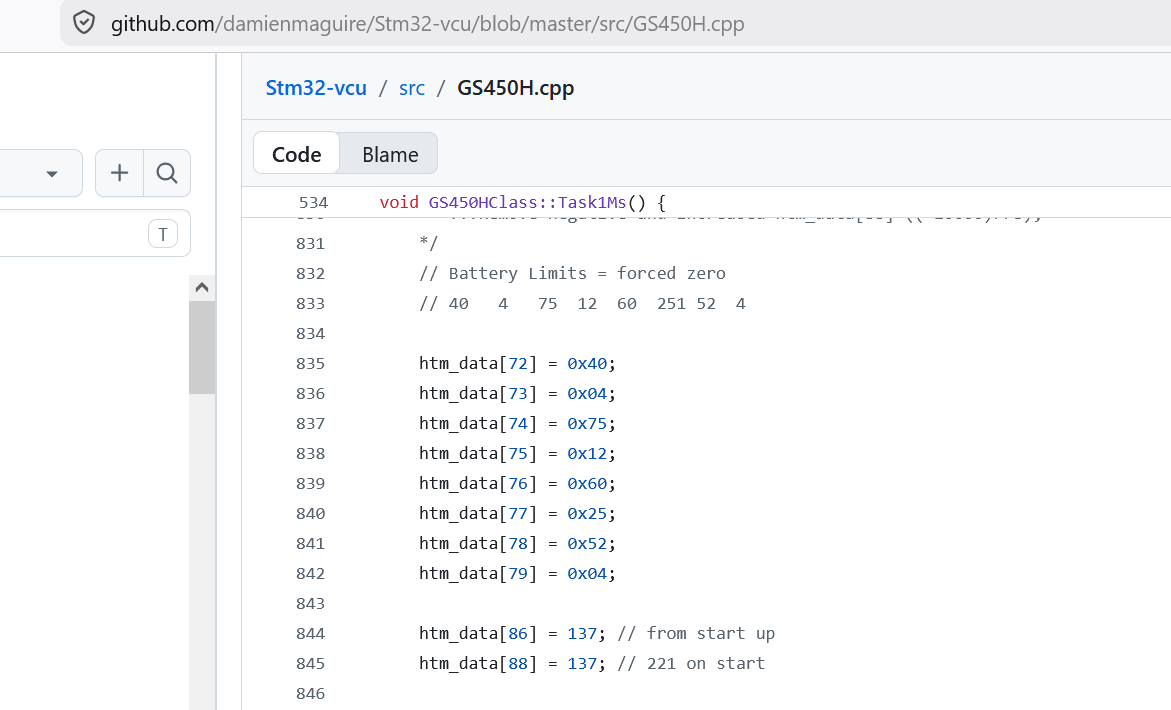

Hi Tom, does this part of the code have something to do with the Gen 3 power/speed limit issue? 🙂
Posts: 2962
Has thanked: 328 times
Been thanked: 847 times
This code has been played with in greg vw rabbit/golf. with no impacts.
I need to still have a look at your logs. Work is keeping me too busy to have any mental capacity left in evening to do coding.
