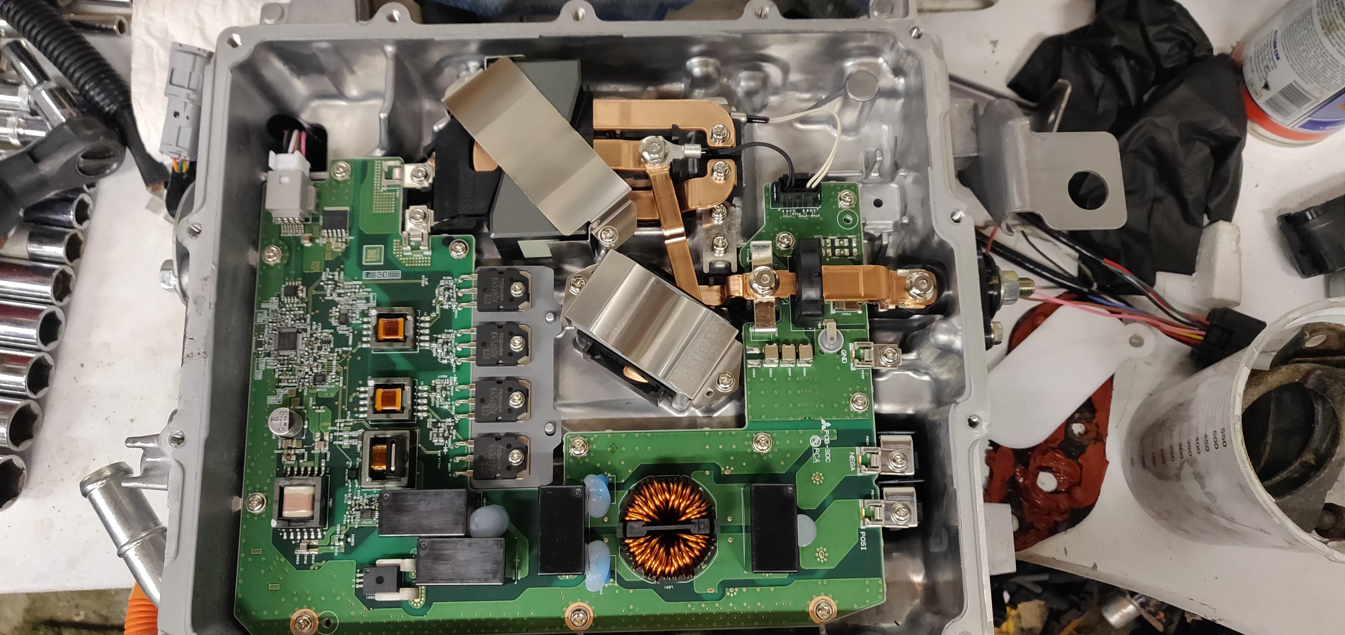

Well every thing has a high end to it, so are Outlander chargers obviously.
Today i put final 8 cells in my rear battery box for a whole 104S system. I managed to join the batteries at 4.01V per cell. Everything went nicely and i got 417Vdc system voltage. Now i can get my inverter working and car runs fine, aside the DCDC converter! When i tried to start it i got a short 14V pulse from it and then it went into shutdown.... I think 417Vdc is over its peak. I tried to drive for a time on my shitty 10A LED PSU, but steering pump draws too much power when driving and i only managed to drain the battery down to 415Vdc.
I tried to disconect DCDC 12V signal cable and CAN bus to reset it and every time i get the same result. 14V rises for a brief time and then DCDC goes into shtdown. I will try the same with the charger to see what would be the boundry there....
EDIT: No... this wont work. I managed to update firmware on my DUE and start the charger. I got them to click some relays inside but they would not work any further with 415Vdc.

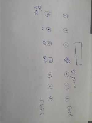

Hi, Just got the dcdc working on my OBC. As I'm reading through this thread I'm seeing different suggestions about what should be connected on pin 9(charger) from EVSE. Is it Proximity pilot or Control pilot? Thx
Clanarn
Posts: 54
Joined: Sun Oct 18, 2020 6:42 pm
Location: Göteborg Sweden
Re: Mitsubishi outlander charger and DC:DC
Post by Clanarn »
Ive also noticed that the pinout as described on the wiki page is wrong if you follow what is written on the Sumitomo connector.
This pinout should be correct for the Sumitomo connector:
Pin 1 CAN H (Black)
Pin 2 CHIN (Serial protocol to EV Remote wifi module)
Pin 3 DC SW (enables the DC:DC converter)
Pin 4 (Blue) NC on outlander
Pin 5 NC on outlander
Pin 6 (Orange) NC on outlander
Pin 7 CAN L (Red)
Pin 8 CHOT (Serial protocol to EV Remote wifi module)
Pin 9 NC
Pin 10 GND
Pin 11 Proximity signal from charger
Pin 12 IGCT main power to charger
Pin 13 Sense line for DC to DC converter
Pin 12(IGCT main power to charger) needs 12v power also. I connect it together with Pin 13(Sense line for DC to DC converter)

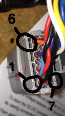

Pilot proximity doesn't go to the charger, you'll likely want to use it with how ever you are controlling it though.
I think pin numbers are messed up on the connectors though, can't remember if the housing has different numbering. But looking at the plug, from the back where the wires come out, clip up, top left, call that 1, to its right 2 etc, 7 is bottom left.

Ok i see. Thanks for explaining. "Proximity signal from charger" pin is actually Control pilot then.
Clanarn wrote: Wed Mar 17, 2021 9:37 pm Ive also noticed that the pinout as described on the wiki page is wrong if you follow what is written on the Sumitomo connector.
Pin 1 CAN H (Black)
Pin 7 CAN L (Red)
Pin 9 NC
Pin 10 GND
This is what I'm seeing on the wiki,
Pinout as as follows:
Pin 1 (Orange) NC on outlander
Pin 2 NC on outlander
Pin 3 (Blue) NC on outlander
Pin 4 DC SW (enables the DC:DC converter)
Pin 5 CHIN (Serial protocol to EV Remote wifi module)
Pin 6 CAN H (Black)
Pin 7 Sense line for DC to DC converter
Pin 8 IGCT main power to charger
Pin 9 Control Pilot from charging cable
Pin 10 GND
Pin 11 NC
Pin 12 CHOT (Serial protocol to EV Remote wifi module)
Pin 13 CAN L (Red)
https://openinverter.org/wiki/index.php ... on=history Bobbycomelately corrected it in February, do you have a cached version loaded?

Clanarn wrote: Wed Mar 17, 2021 9:37 pm Pinout
Hey, thanks for this, this is the pinout that worked for us.
Has someone had any luck of separating the DC/DC unit from the charger and using it separately?
We got DC/DC working this morning, but 3.3kW is not enough for us, so we have a Tesla Gen2 unit for charging. It would be great to extract the DC/DC board and coils into a separate box that could also be about 50% smaller than the existing unit.
It is a shame that the Mitsubishi OBC only has 3.3kW, I even thought about using two of these in parallel to bring it up to the 6.6kW we need...
We opened the unit, and traced the lines from the outside connector, to the one on the board but they go through the charger board & its microcontroller first.
