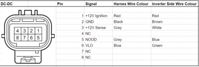

I've been playing with the DC-DC today, I got the pinout info:
chuuux wrote: Thu Jan 27, 2022 2:52 pm I've opened bottom side of camry's 3Gen invertor with the same connector. Colors of control wires and equal with Prius Gen3 internal wires. So we should try the same logic of control.
There is a lot of discussion on the gen3 DC-DC, but in one of Damien's videos it's just a case putting 12v on the ignition and sense wires.
So I tried with HV (tried 60V and 310v) connected to the main DC bus, with Battery+12v on ignition, sense, and the output stud.
DC-DC did not come to life.
Has anyone got the DC-DC running on this yet?

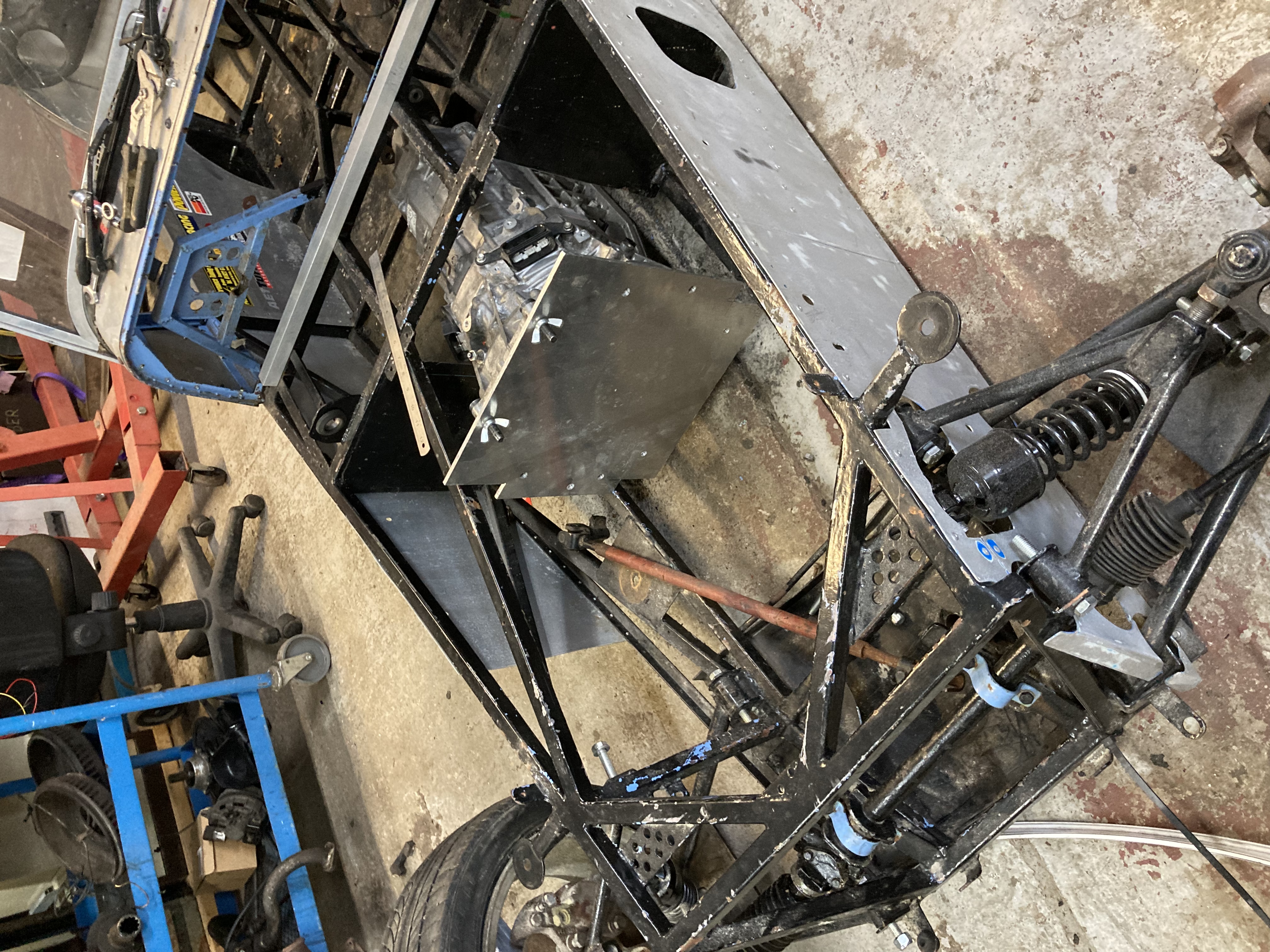

Knew it would fit😊, on the original gearbox support and front plate with a small piece of floor cut out on each side and reorganised oil pump pickups , now where’s the welder….

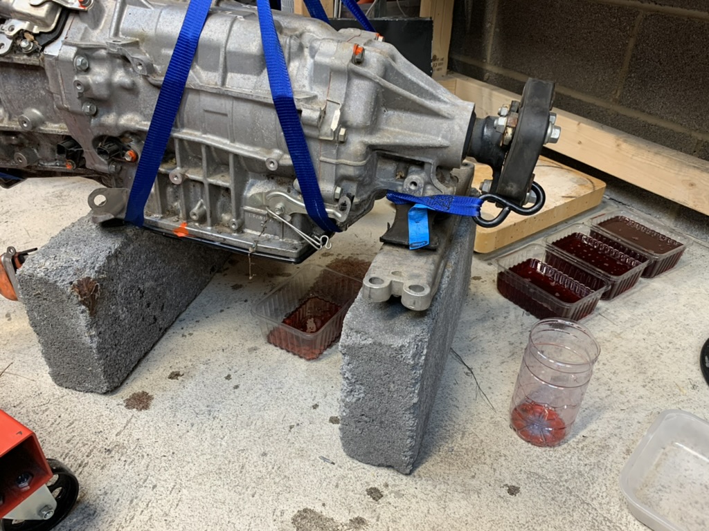

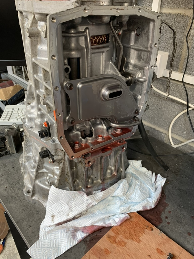

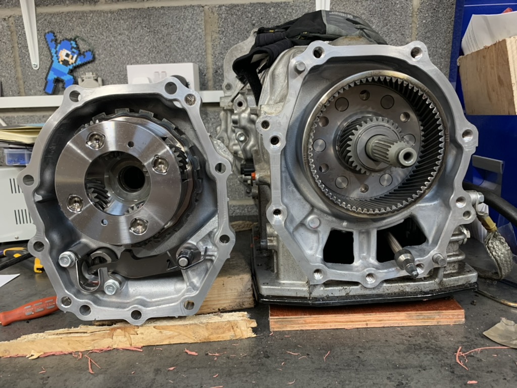

Dxtawise wrote: Sun Dec 18, 2022 7:43 pm Do you have a video or something showing the disassembling of this transmission?

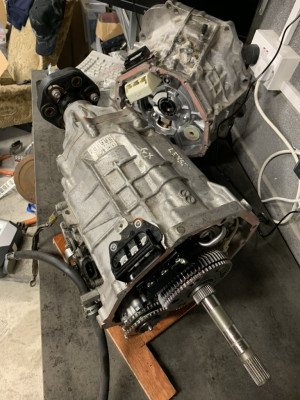

No video, but I have a few pictures. There's nothing to it really. Just undo a handful of bolts.
Drain the oil. Plug is at the rear of the pan.
There are several bolts holding the front bell housing on. MG1 sits inside this section. Three of the bolts are in under the oil pan so you'll need to take that off.
Here's the front bell housing separated from the rest.
For the back, again, just undo the bolts.

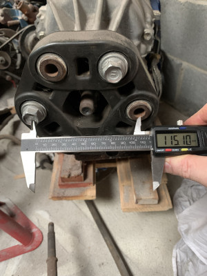

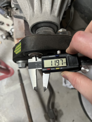

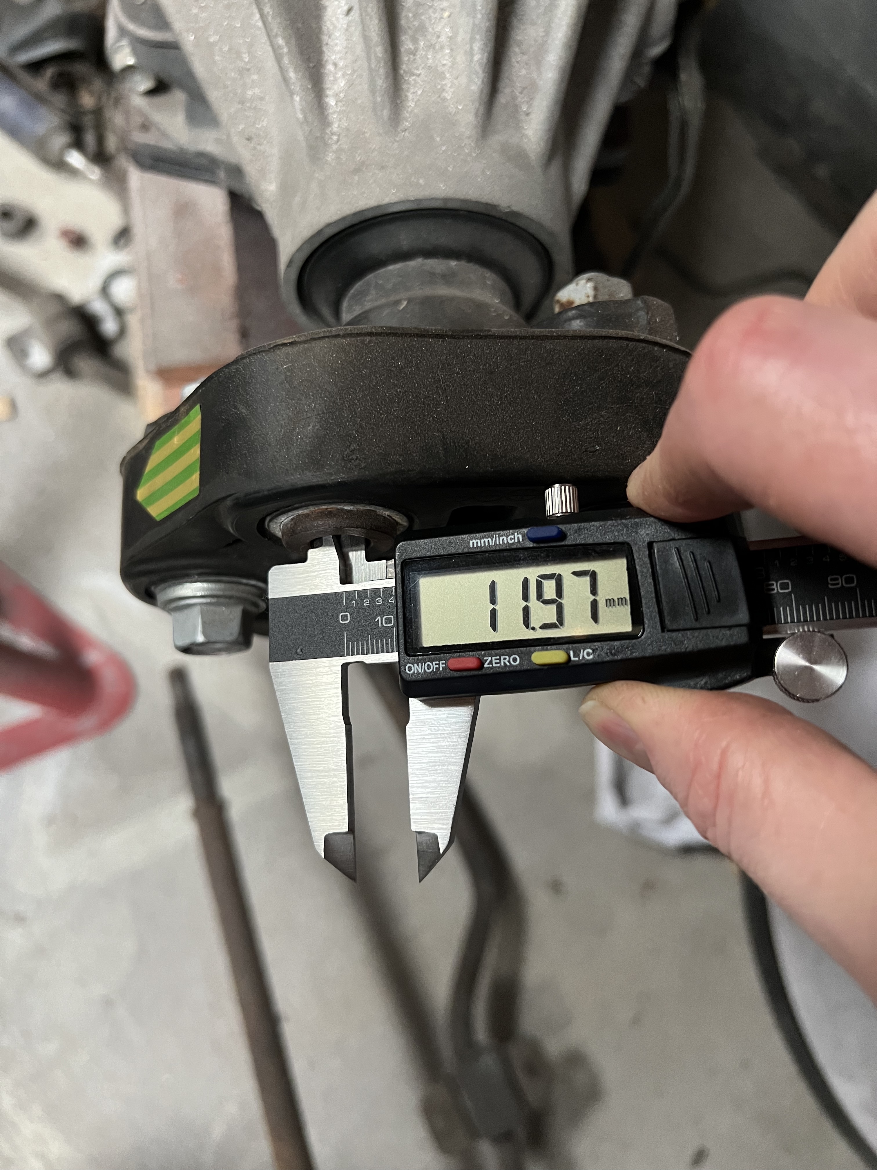

Does anyone know the OEM Part number for the Rubber Flex Mount Coupling of Output Shaft of the L210 Gearbox? Or Could someone please take some quick Measurements?
The Wiki on the L210 seems to describe the Metal flange...
These Aftermarket types are available, and I am hoping one of them fits...
Thanks A lot.
chrskly
Posts: 190
Location: Dublin, Ireland
Has thanked: 74 times
Been thanked: 98 times
Re: L210 gearbox
Post by chrskly »
The OEM one looks to be a little bigger. 115mm between opposite centres.
