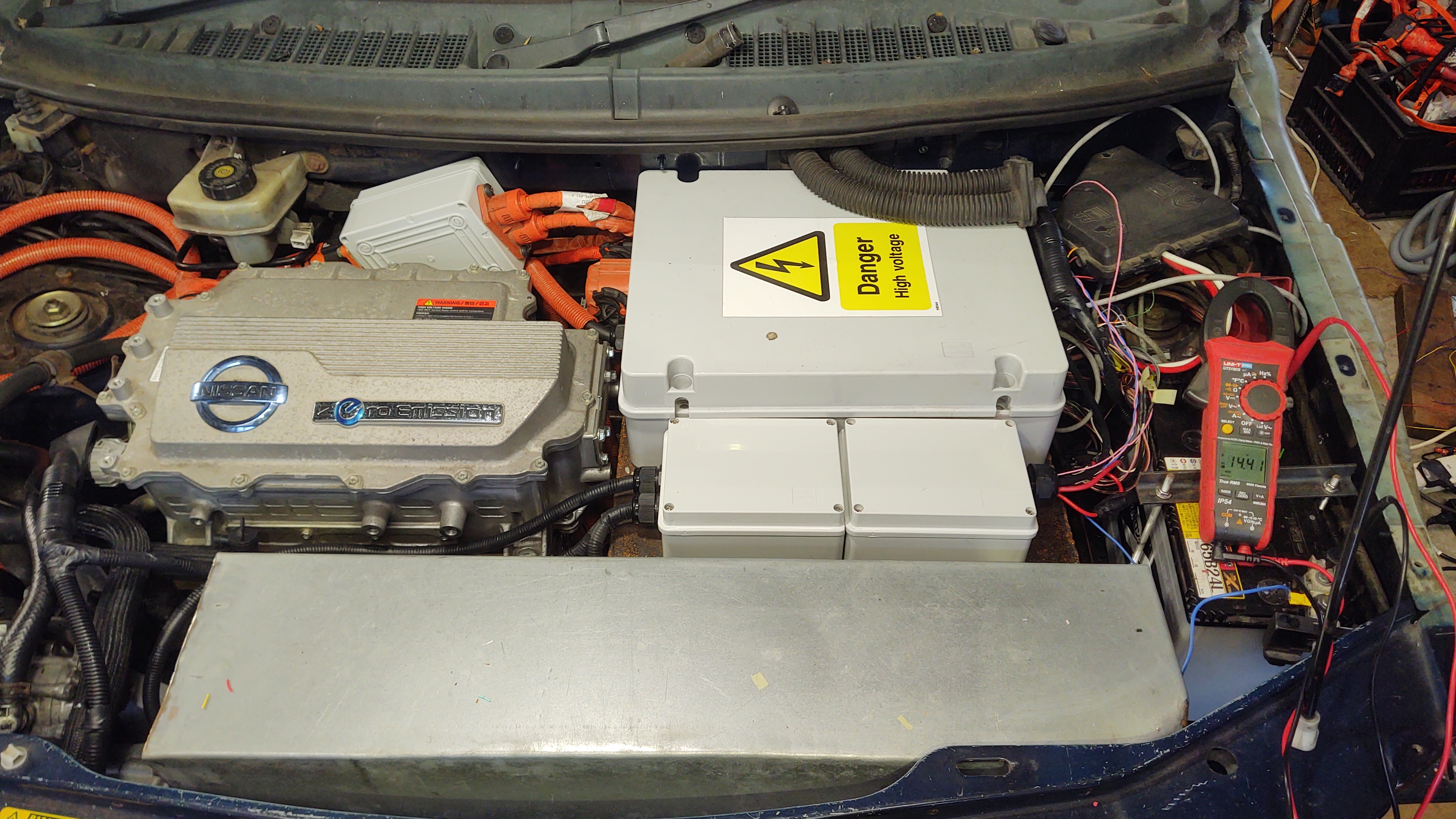

This is a copy of post in the Mitsubishi section about the dc to dc converter and ac charger.
Alibro wrote: Sat Dec 31, 2022 5:07 pm Just a quick update on using the Mitsubishi charger properly for the first time.
I have only in the last couple of days plumbed the cooling in my car so yesterday for the first time charged the battery and found a couple of things.
I had a 220R resistor between ground and PP but removing it made no difference. It still charges with it disconnected so for now I have removed it.
I had the sense line and the enable line connected in two different 12V sources and found the battery voltage went up to 15V so instead joined them together and reconnected them directly (via a relay and fuse) to the battery and the voltage dropped to 14.4 which is just about perfect.
Using a Nissan Leaf Granny charger I am charging at 2175kW or around 9A ac and 5A dc. This is pretty slow but for now is fine. Someday in the future I may look for a way to speed up the charging.
I haven't yet implemented an automatic cutoff at 390V - 400V so had to keep an eye on it but the charging was so slow this wasn't an issue. I'll have another go at getting Arber333 software working and will report back if I do.
So far I'm happy that this unit will do the job for now and thanks again to the guys who helped before.

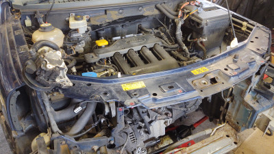

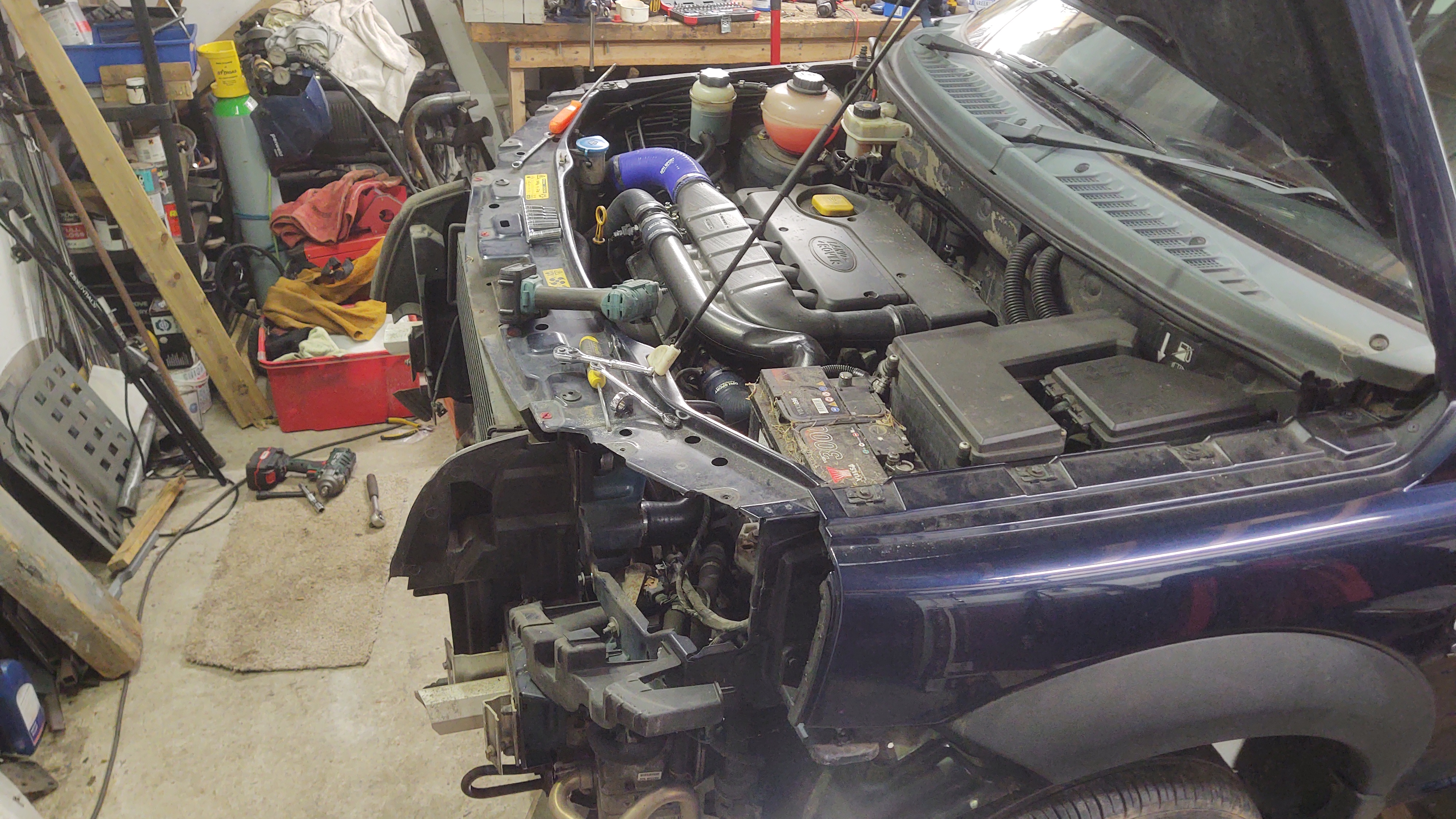

So I've made a start stripping the new car.
The under tray and propshaft have also been removed. ;)

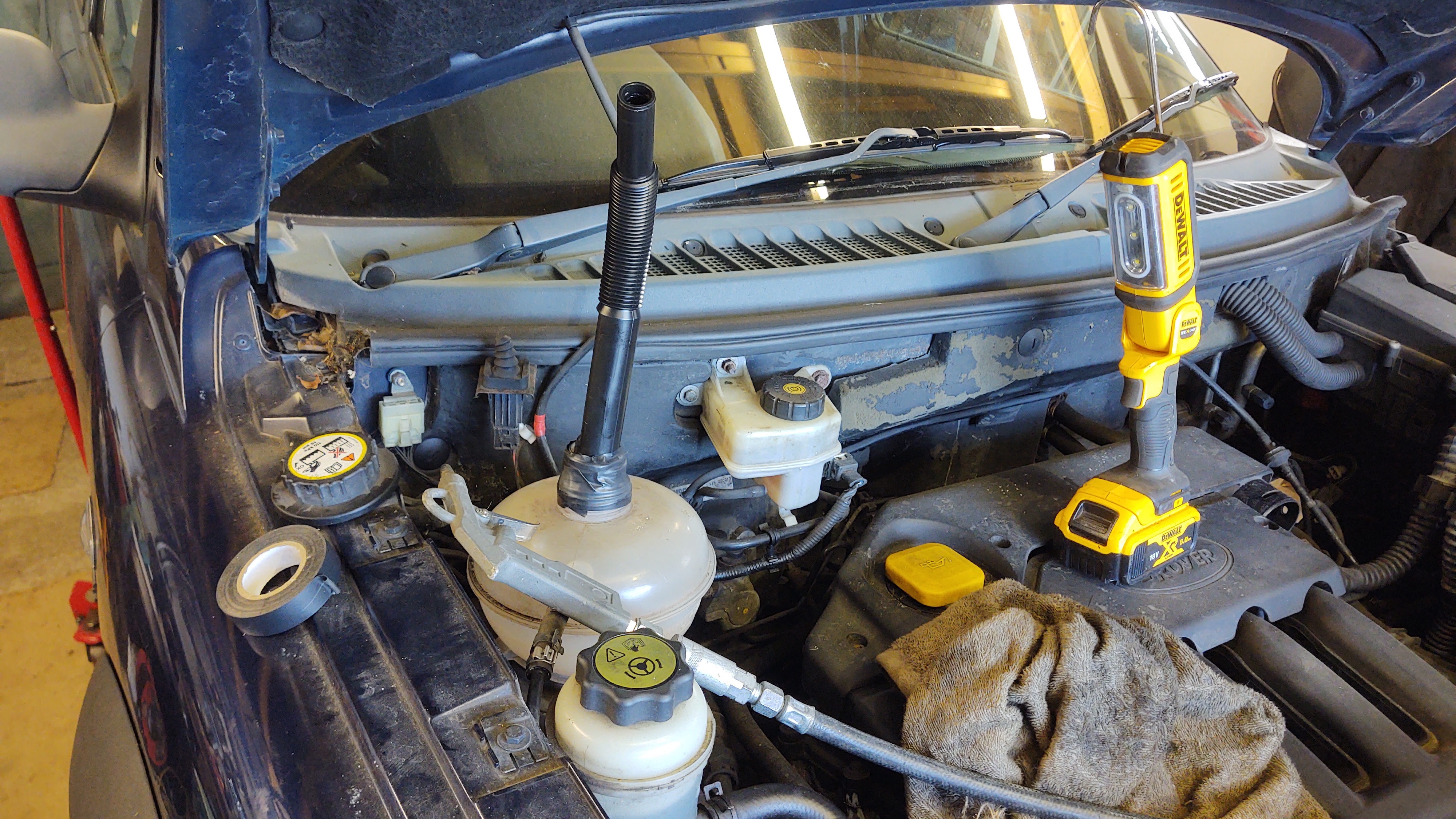

As expected since this car had been lying in a lockup for a couple of years and was bought as a non runner (even though it runs fine :confused:) it is a bit crusty underneath and a few things are not great but it really is not too bad. The previous owner had fitted an EGR bypass, silicone hoses and fuel tank cradle but the VCU seems to be pretty tight so I'll be fitting my old one.
Hopefully over the next few week or so I'll get it properly deiced and can start stripping the test mule. :)
I'll probably leave the fuel tank in place for now as I still haven't ruled out using the fuel burning heater to heat the cabin. It is standard on this model of Freelander. The only problem with doing that is where to put the charger socket.
Trying to push as much coolant out as possible with a little compressed air. ;)

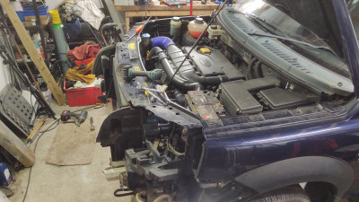

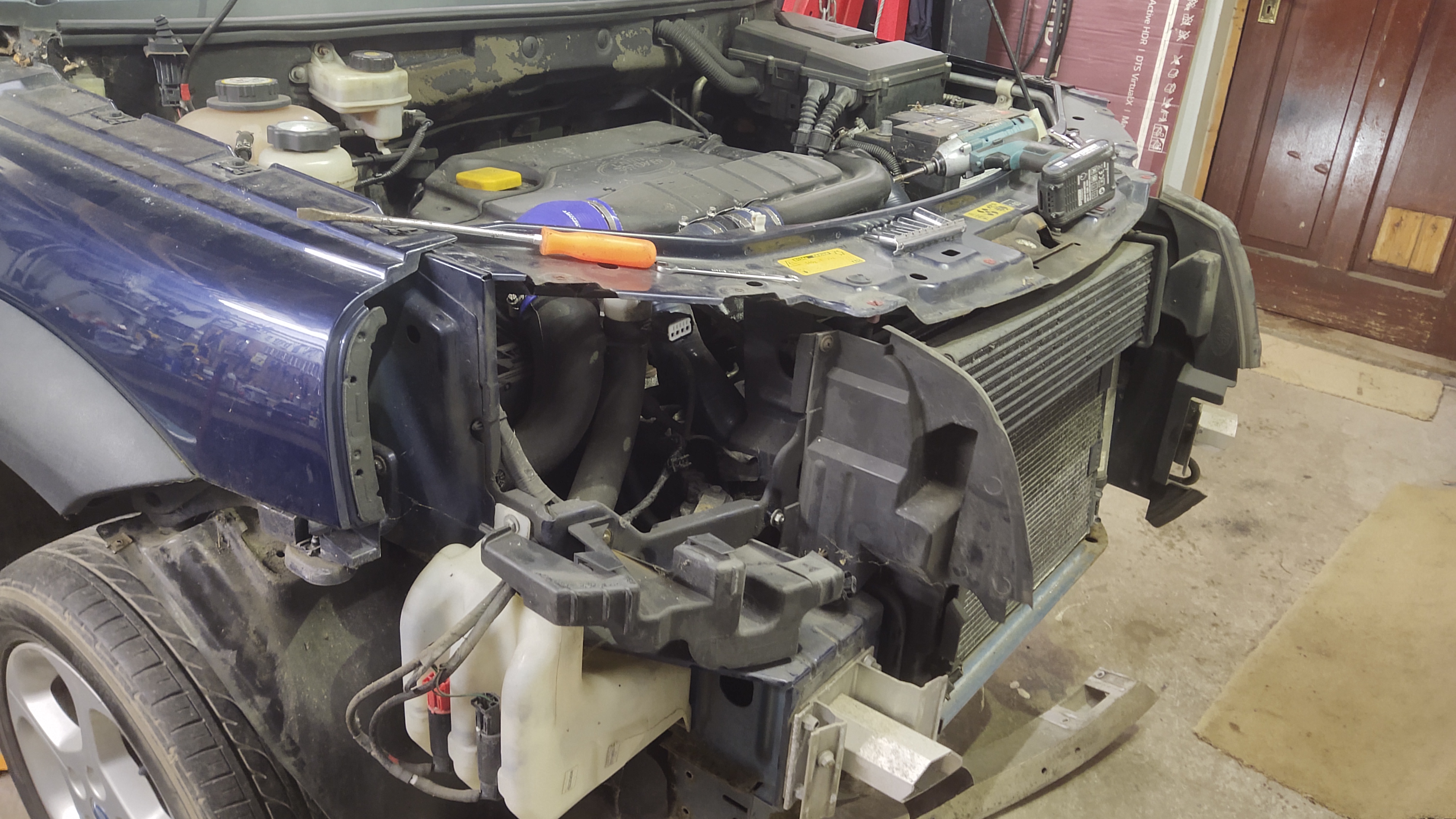

I'm removing the rads and disconnecting the PS pump before dropping the engine. Still a few more things to disconnect.

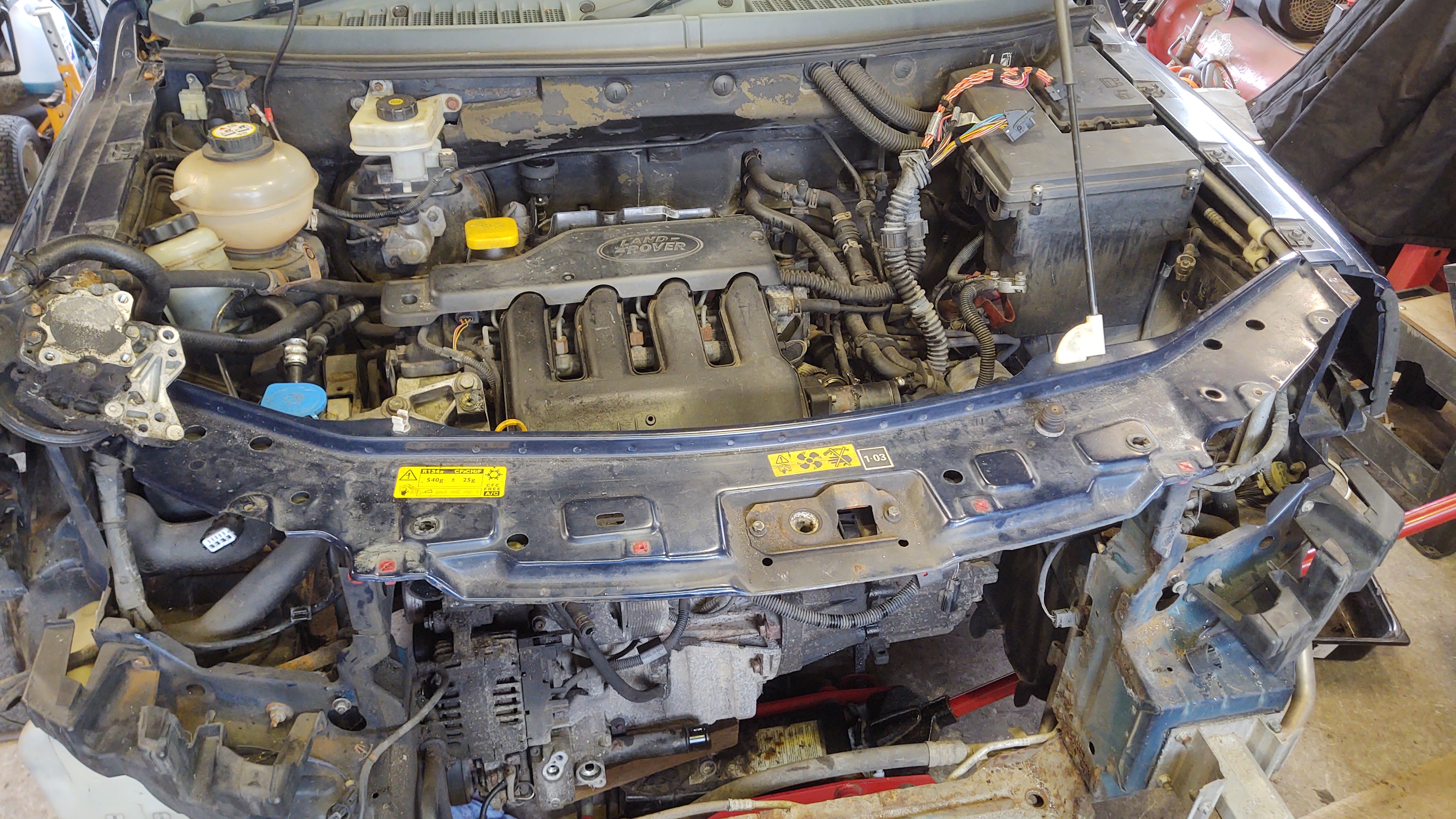

I managed to do a bit more stripping today.
I decided to remove the PS pump first so I don't need to mess about with the hydraulic hoses or drain the fluid. It was a bit awkward and I had to unbolt the OS engine mount to get it out but not too bad. The rads are out too and the wiring harness is disconnected at the ECU box.
So not too much more to do before the noisy smelly parts can be removed. ;)

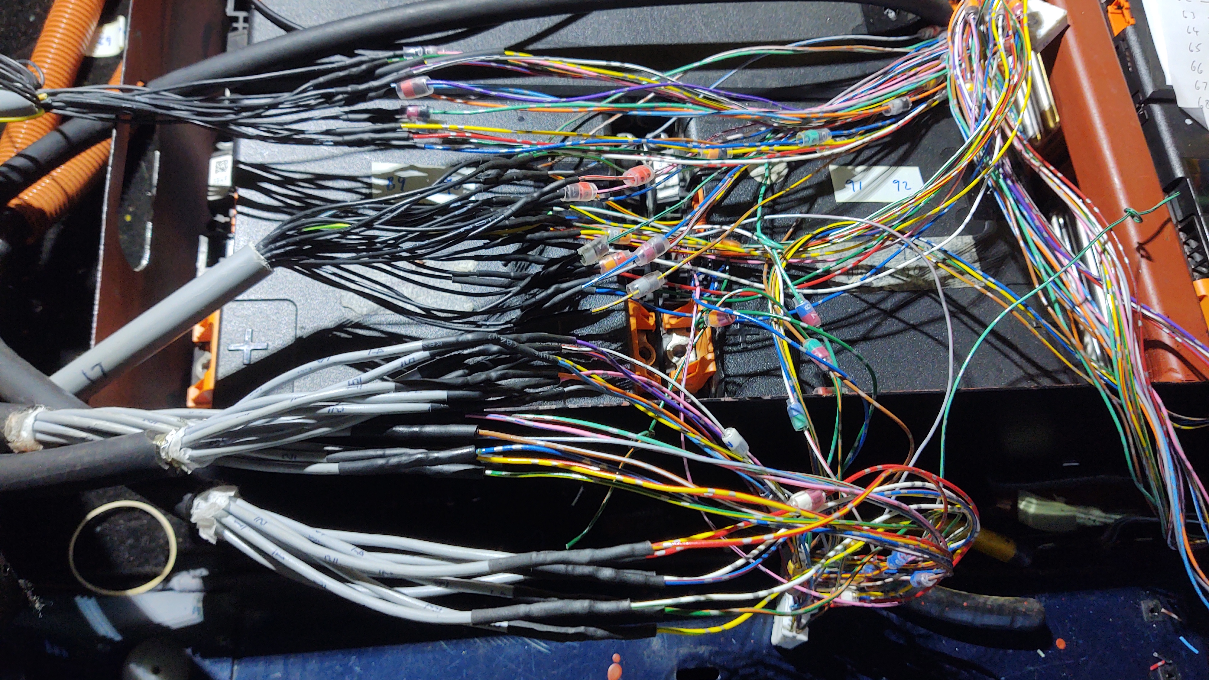

The tangled mass has grown!
The BMS connections for the front batteries have now been spliced in at the BMS end so now I can start to make the connections at the front. :)
