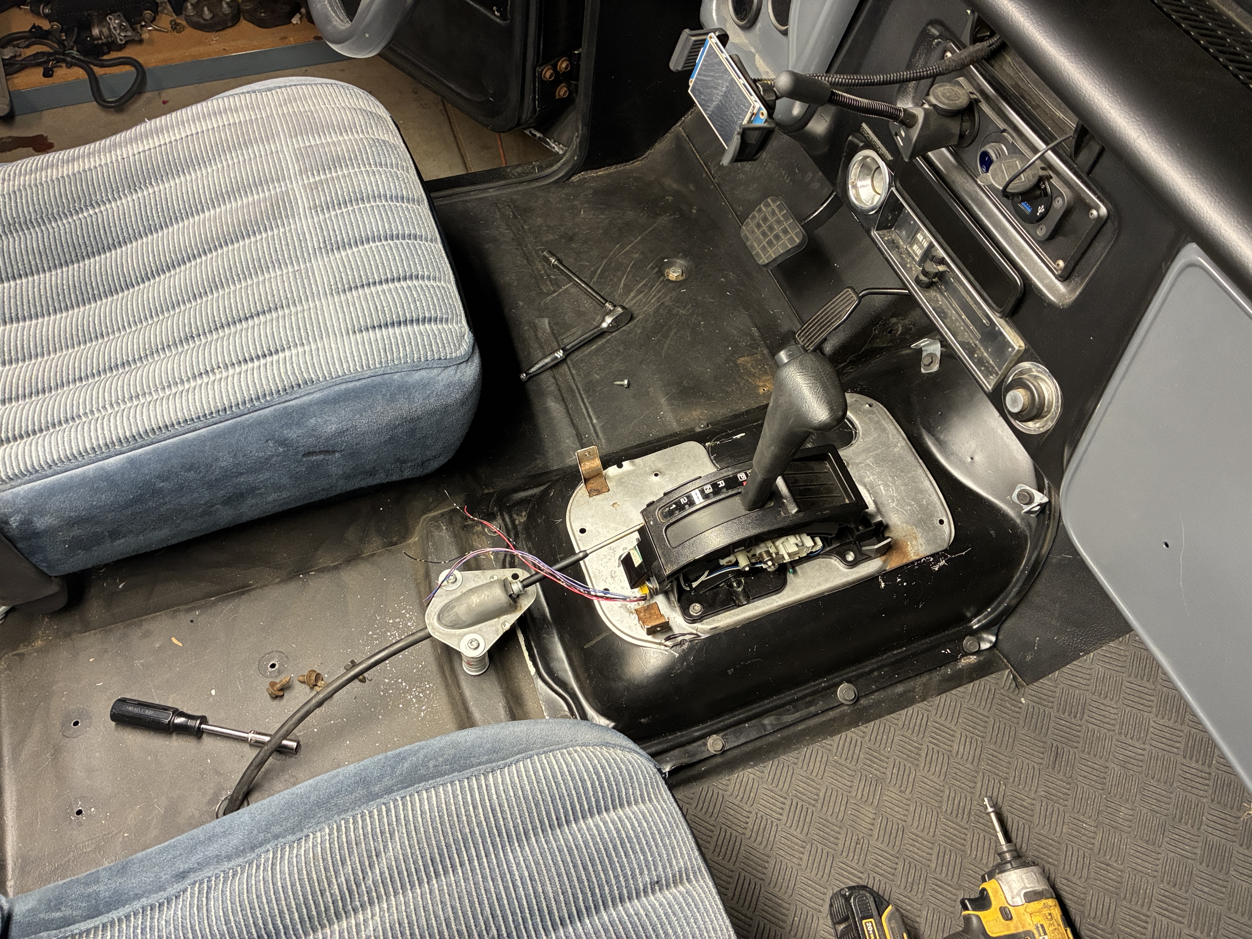

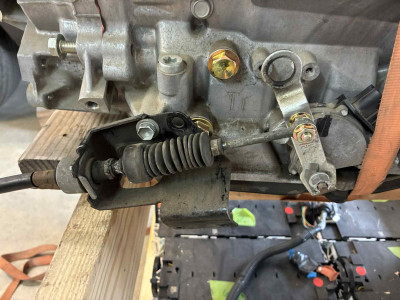

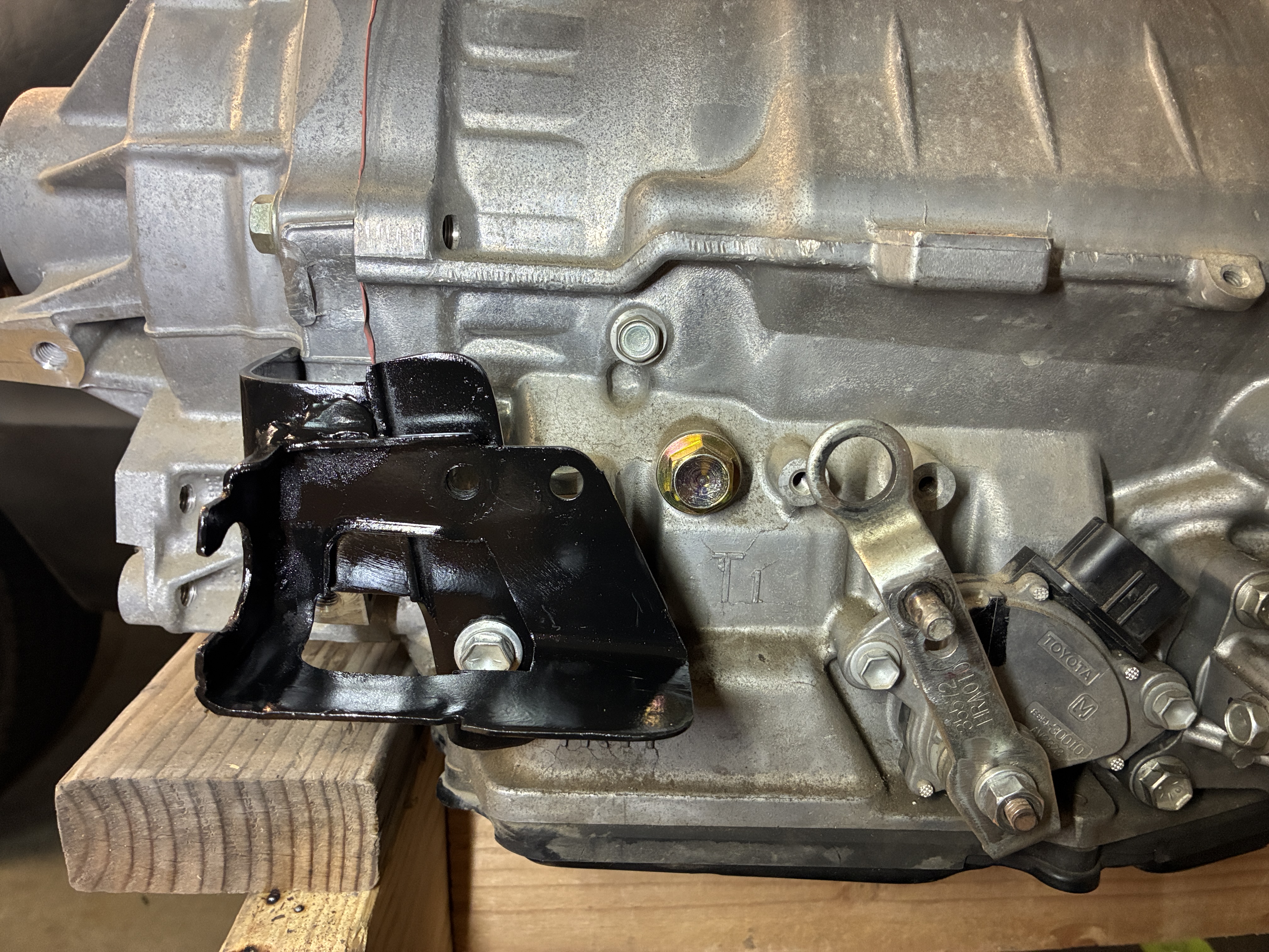

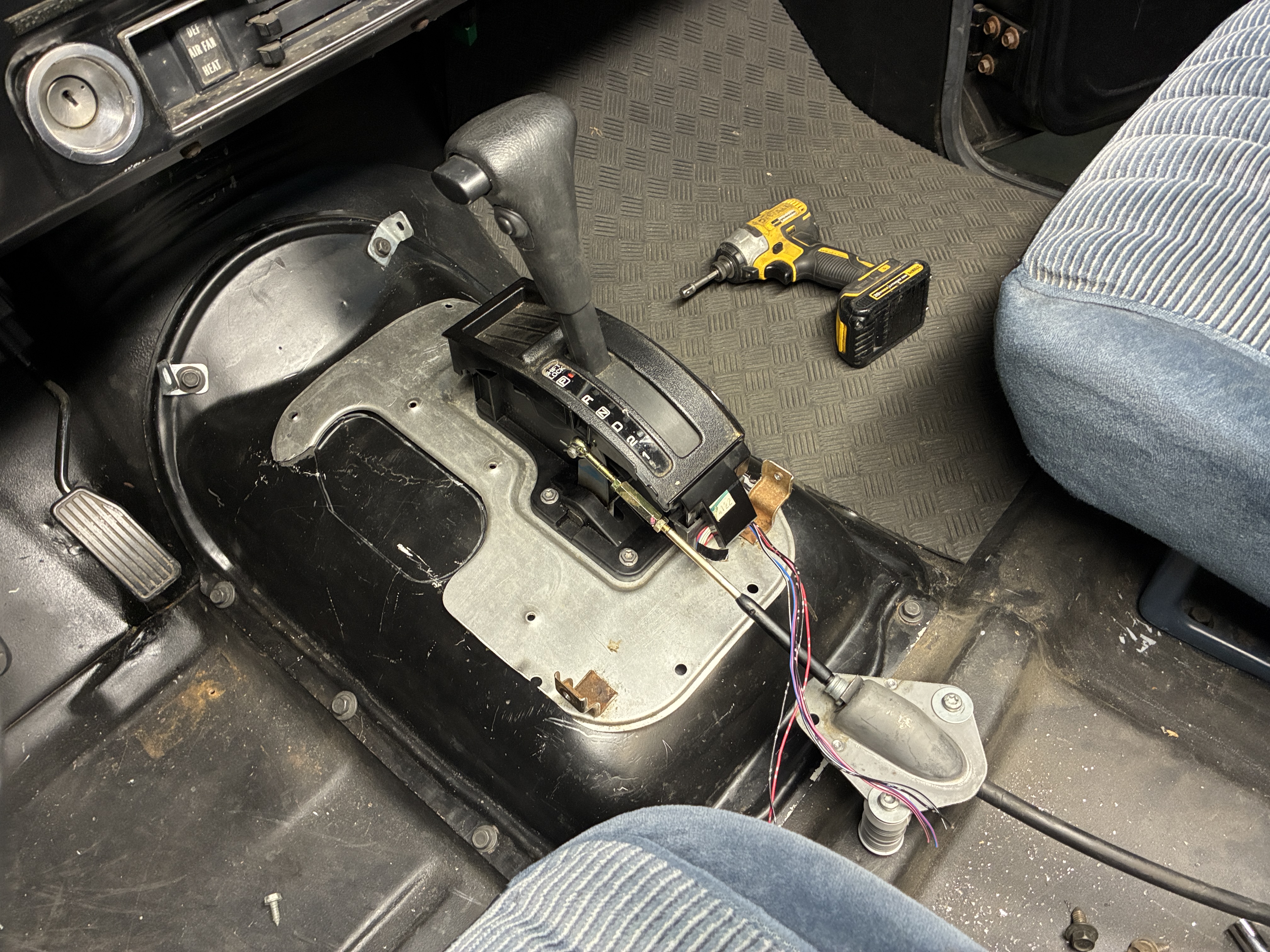

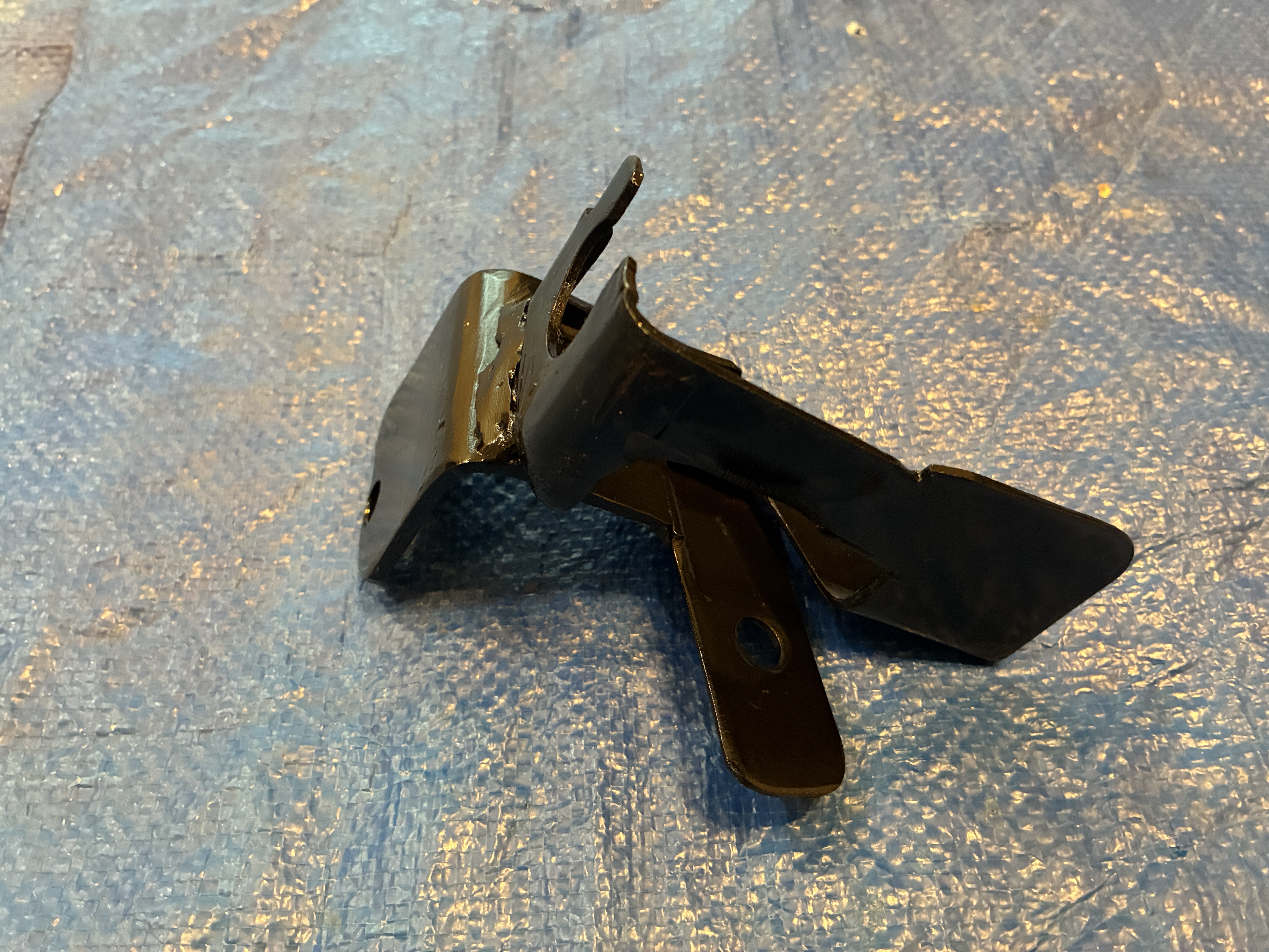

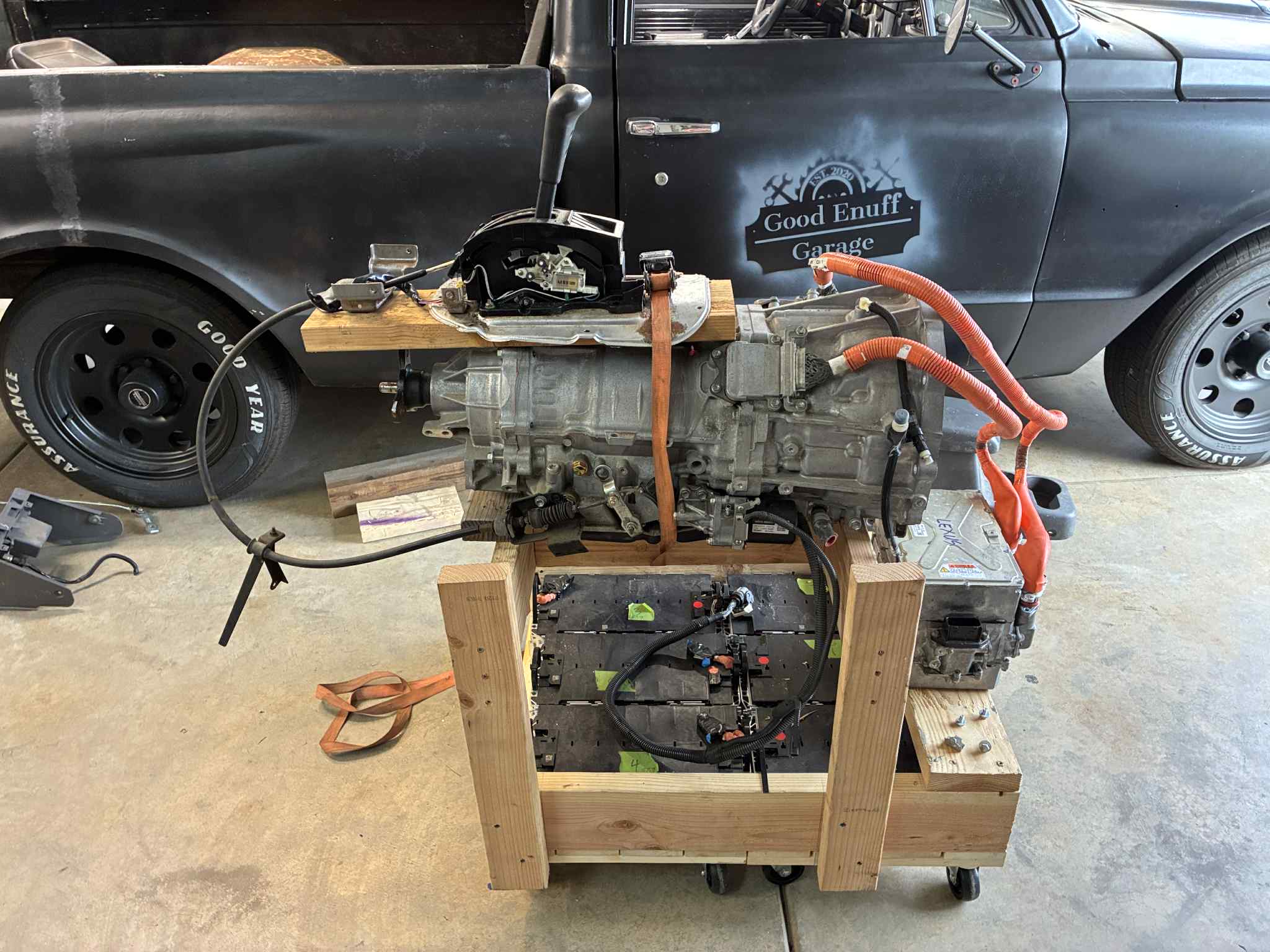

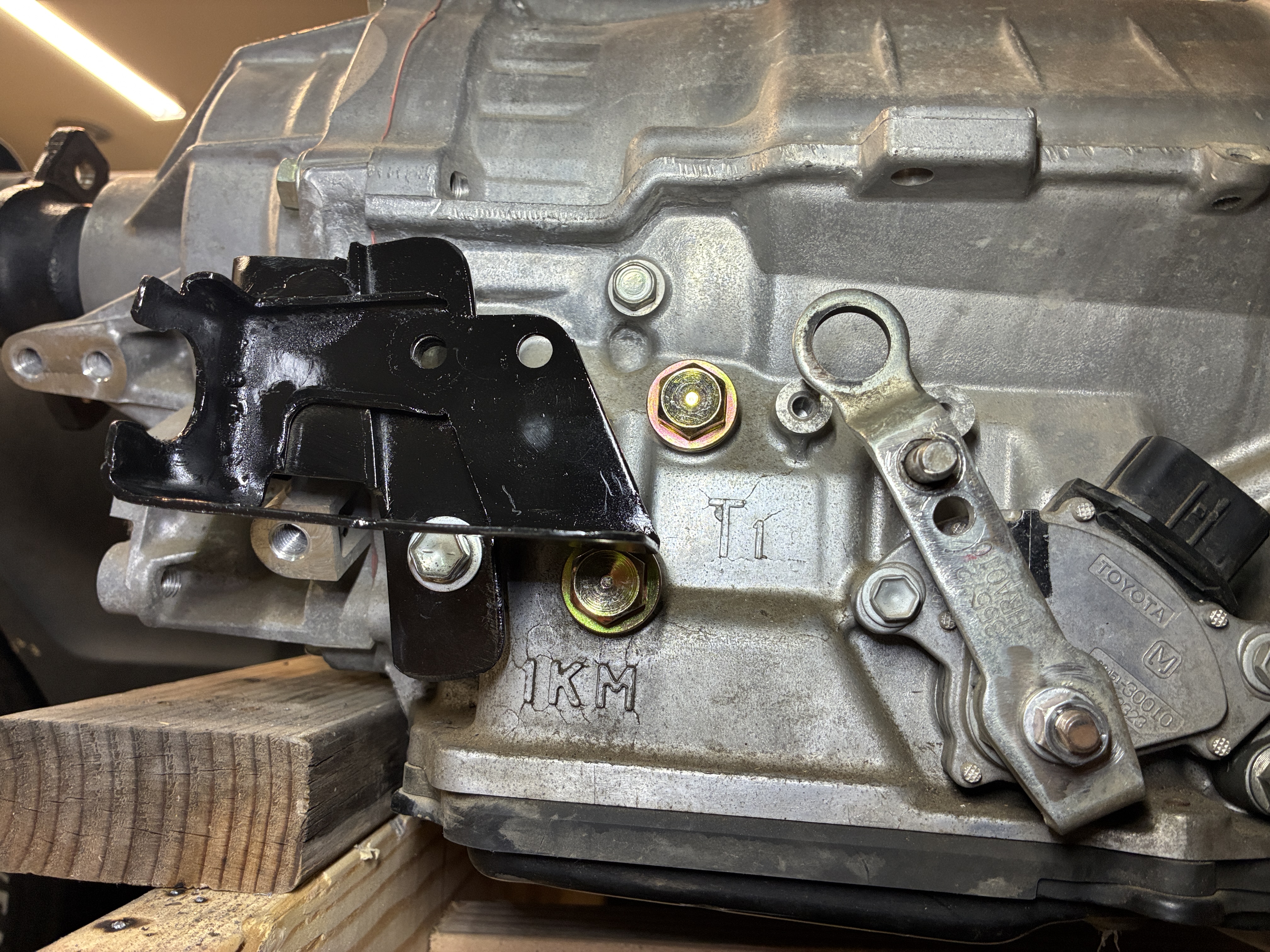

so then I threw her on our mobile motor shifter stand using the custom Nissan Xterra to Lexus GS450h Douglas fir adapter

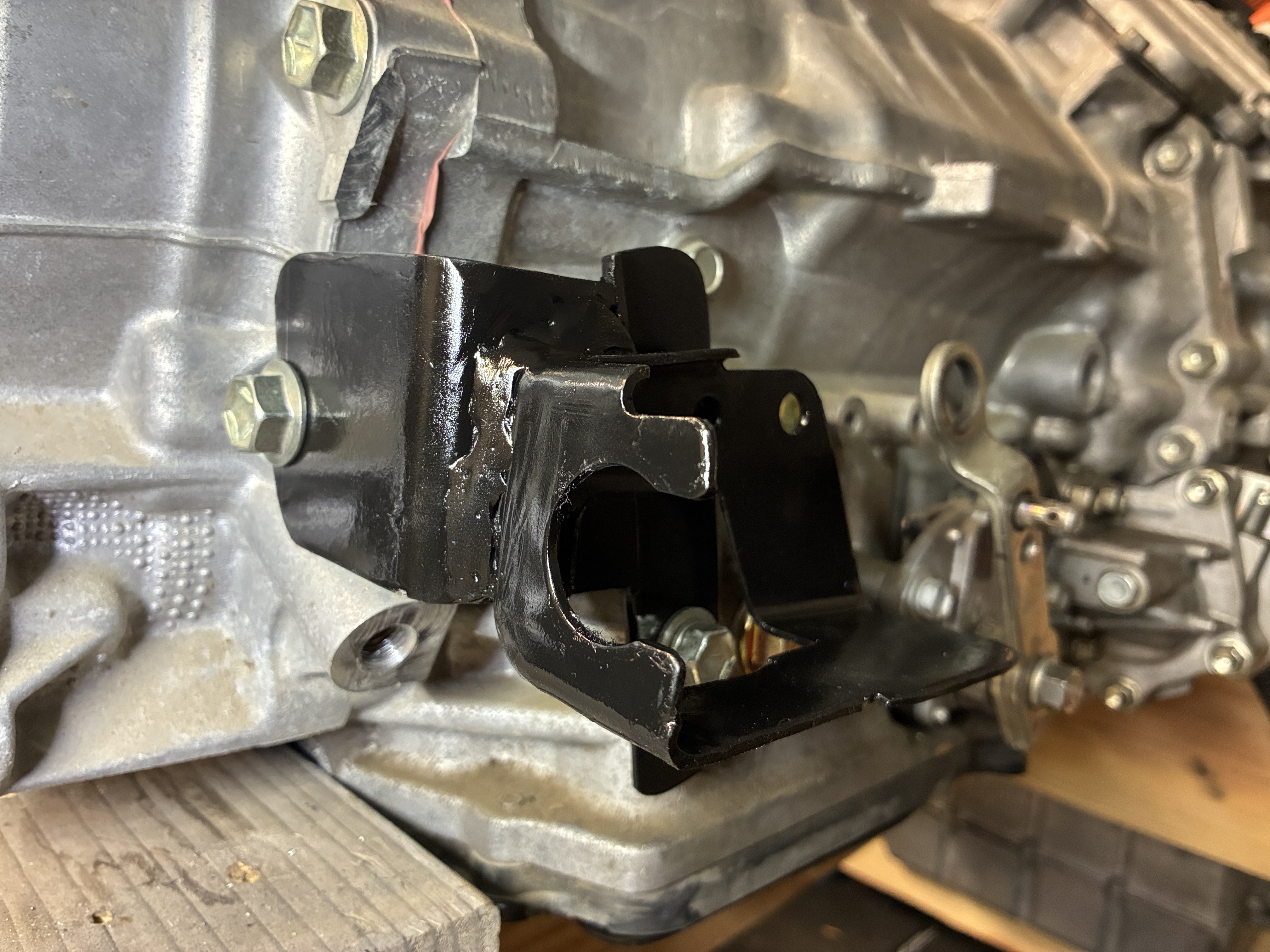

and here I am shifting it almost perfectly using the hole I drilled for that B&M shifter for the GM TH350 transmission, this was working about 98% flawlessly, perfect cable alignment in Park and Drive, and a little short in Reverse and Neutral ie at the peak of that lever arc, so some adjustments need to be made
FYI the cable bracket is attached using its stock holes to the ground strap bolt hole on the gearbox, and I think it needs to move slightly upwards

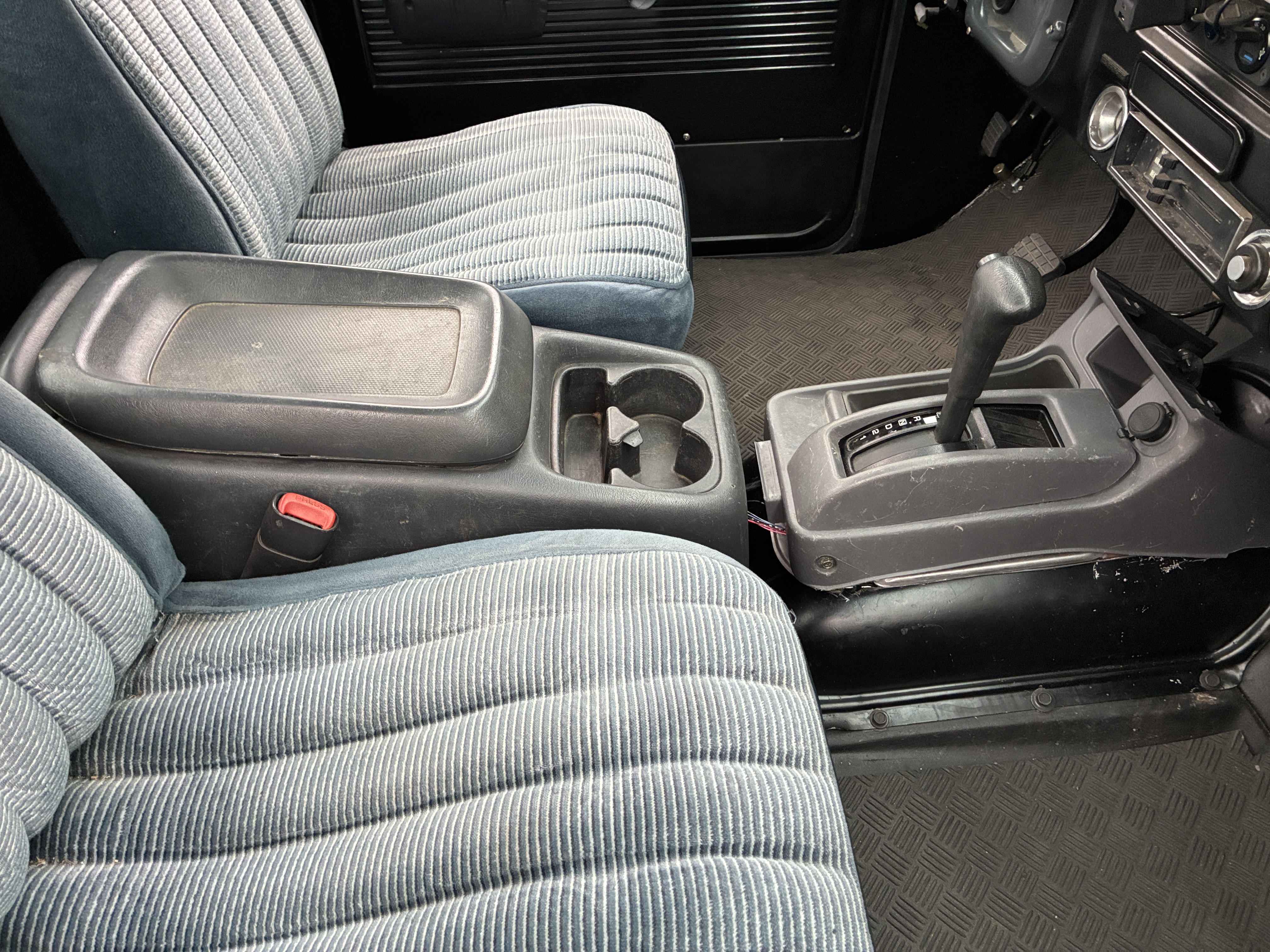

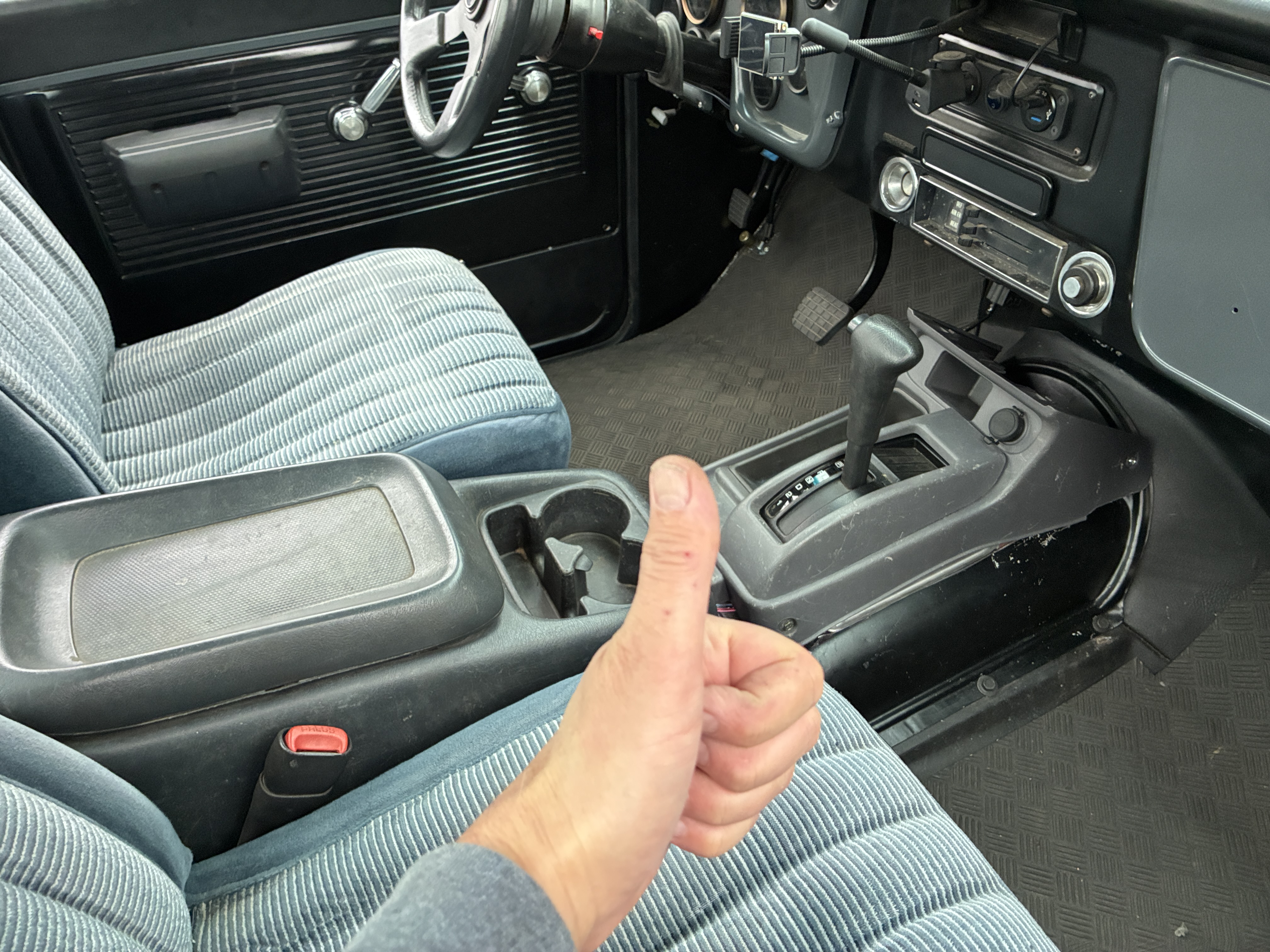

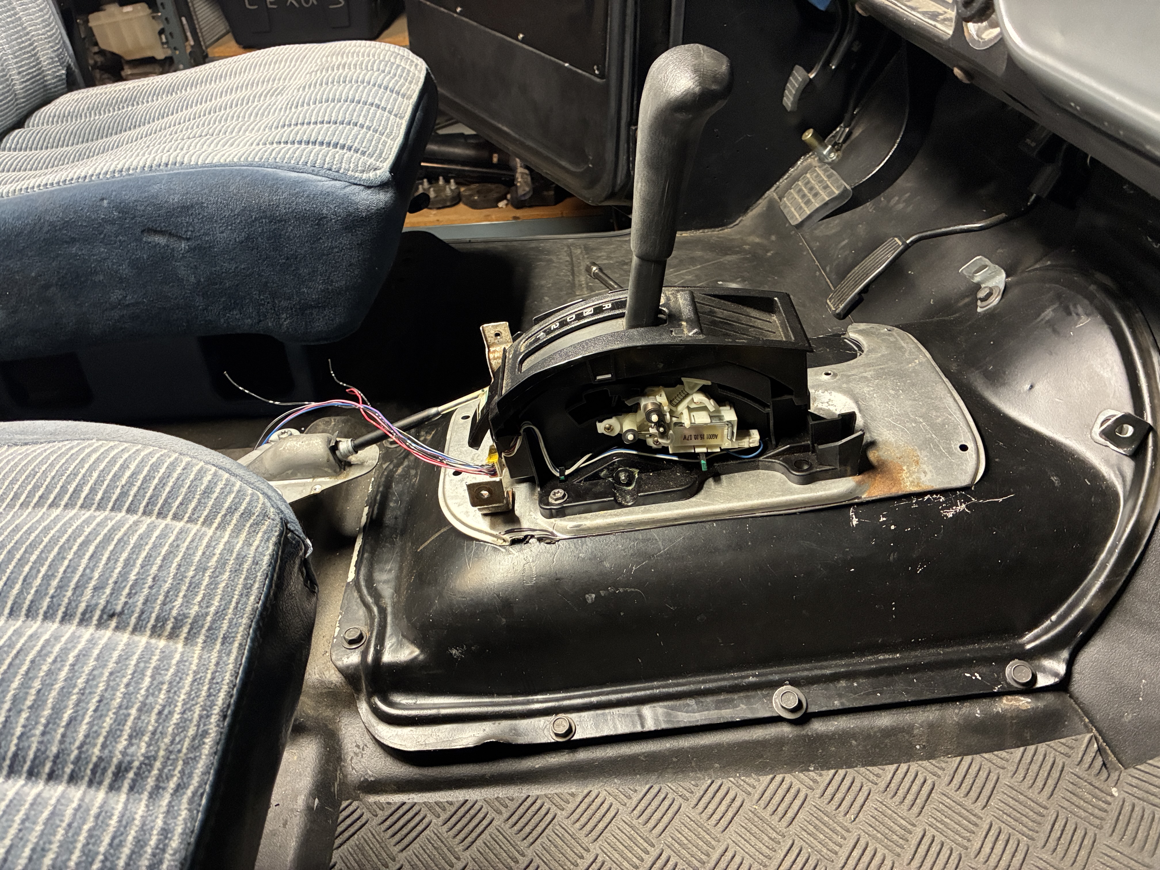

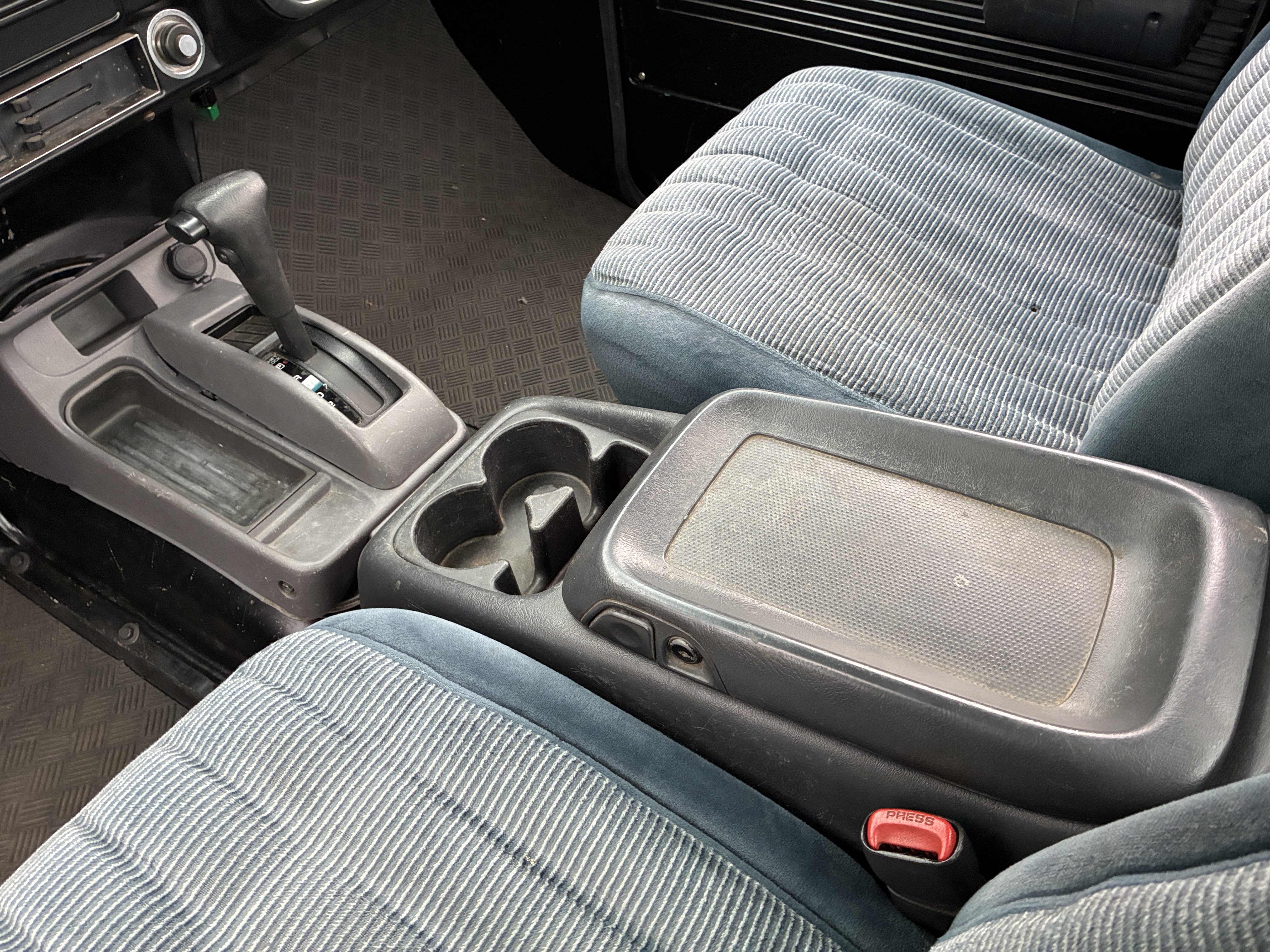

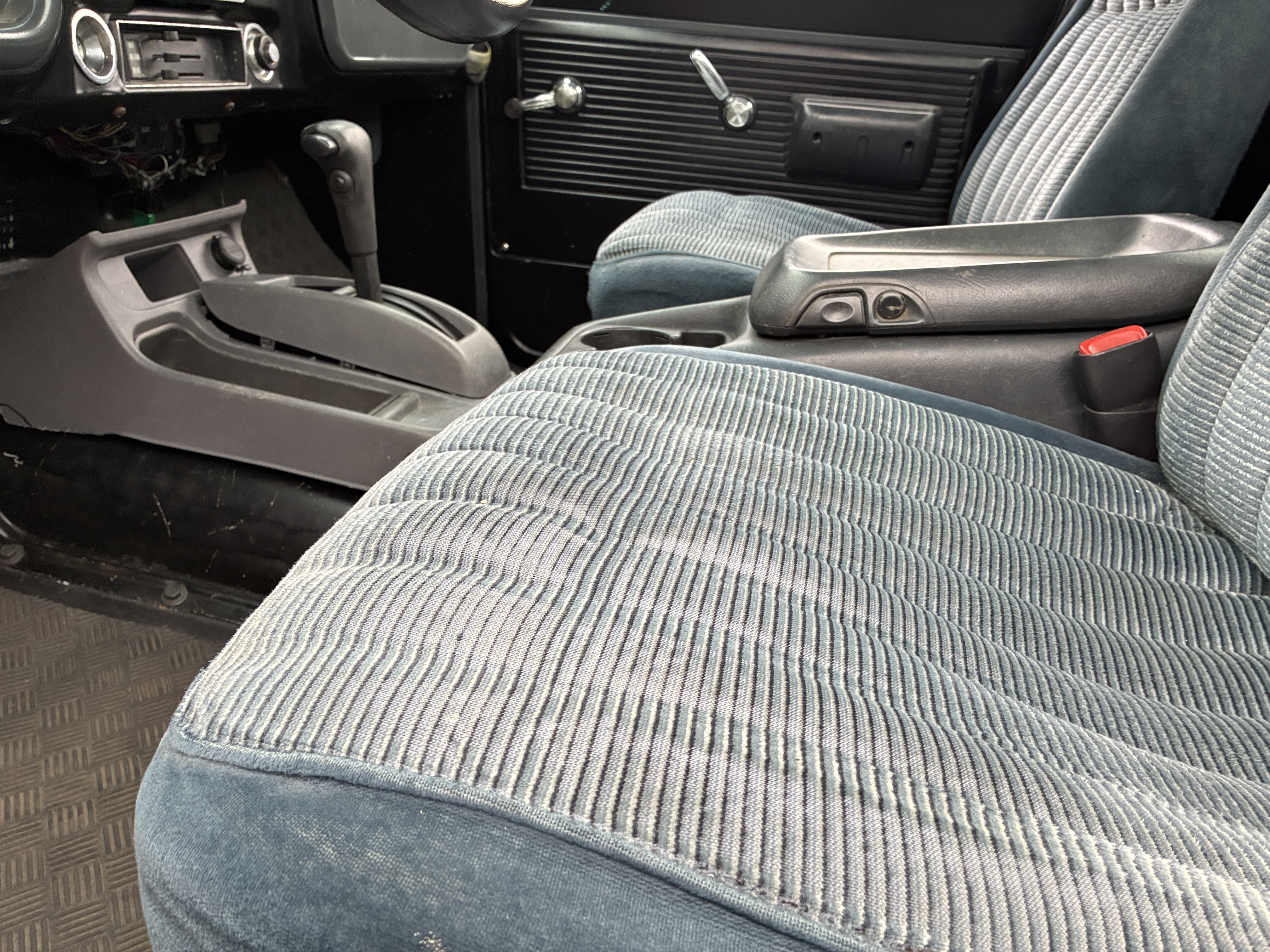

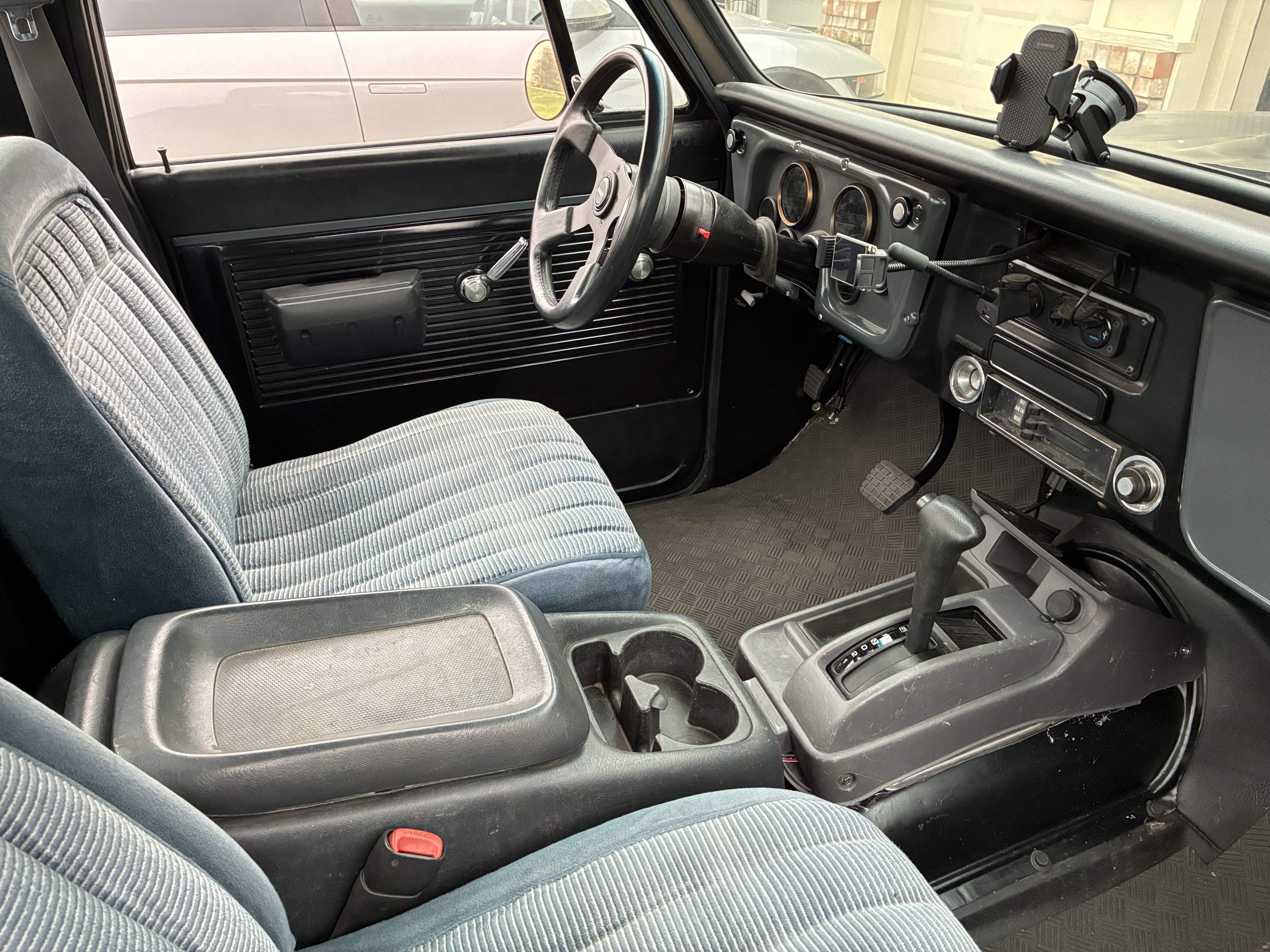

Shifter, console and elbow rest…result!

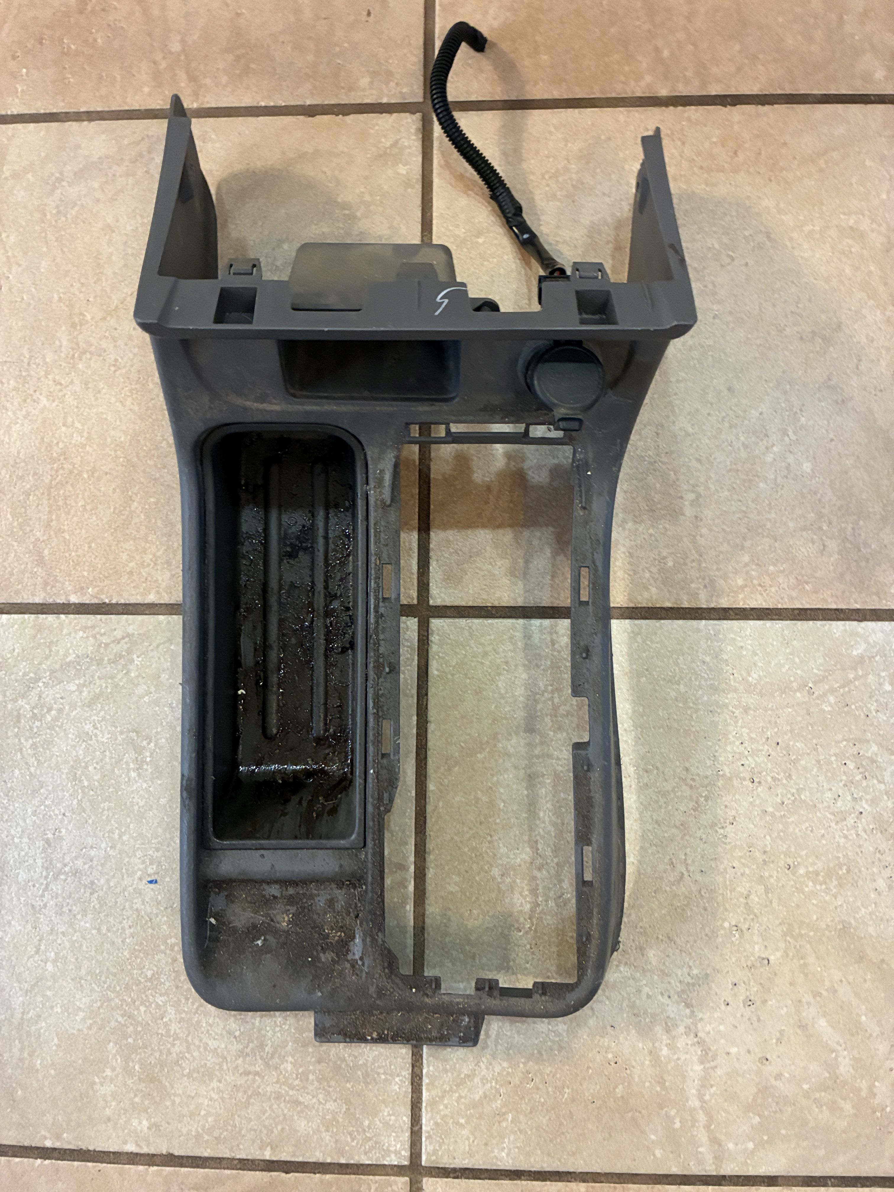

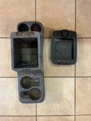

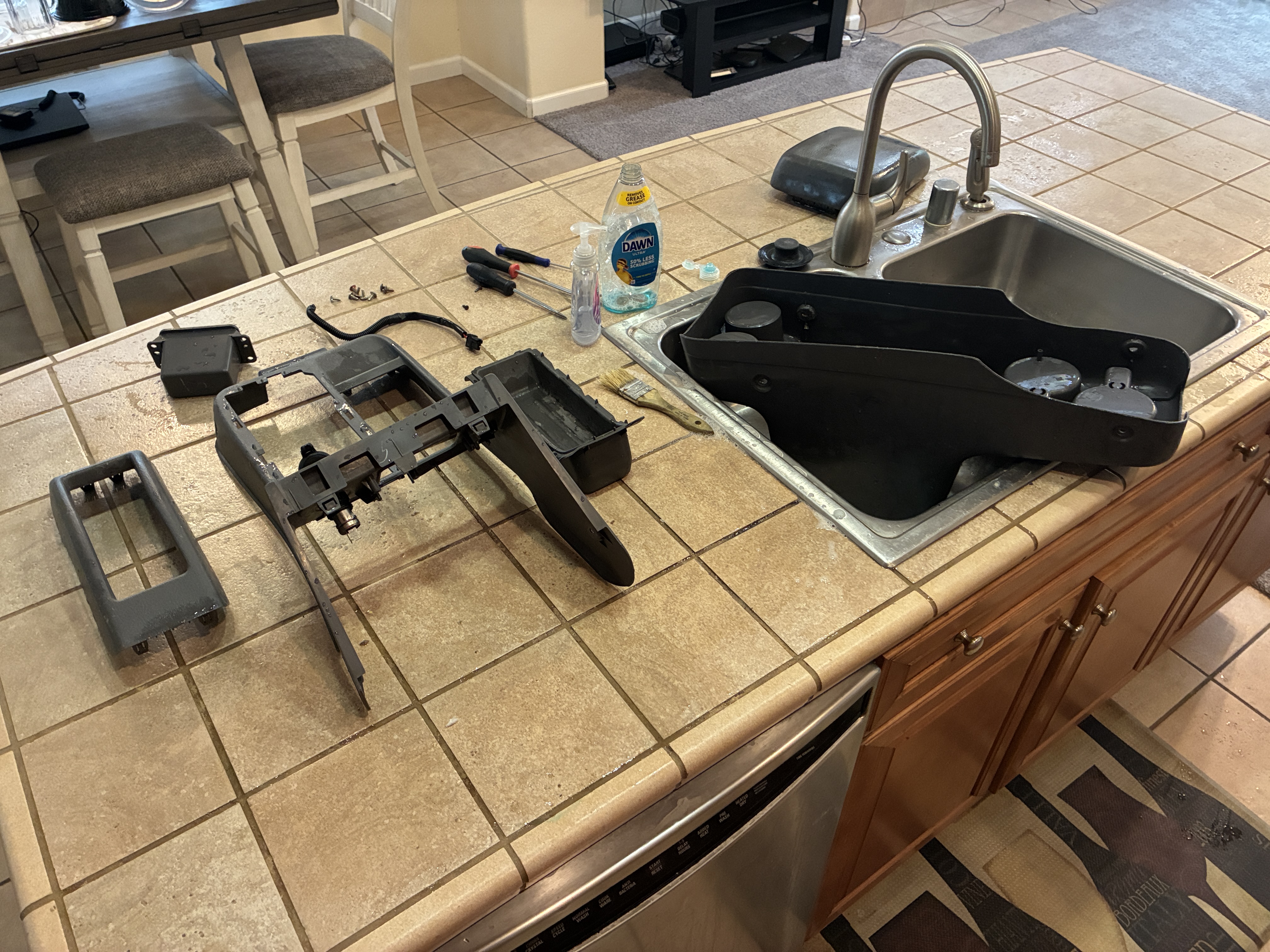

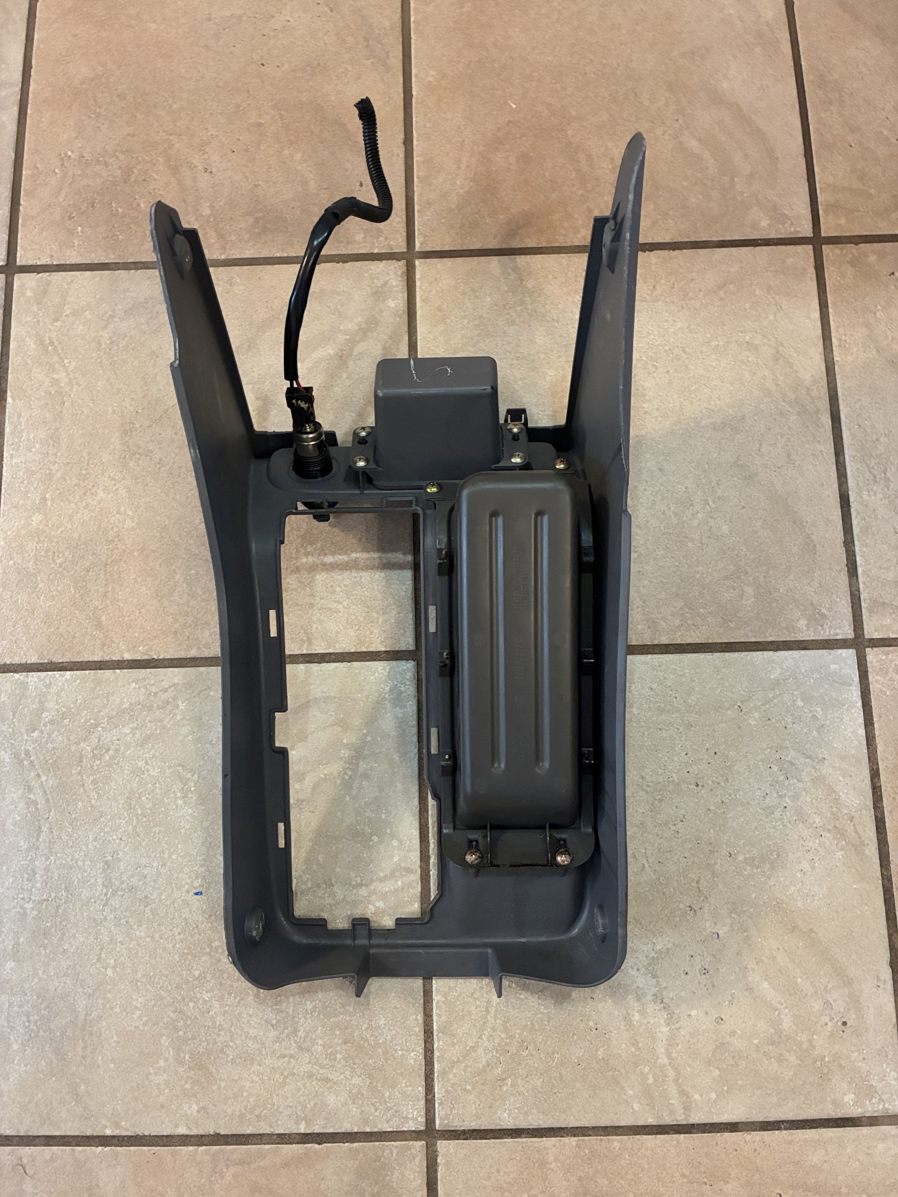

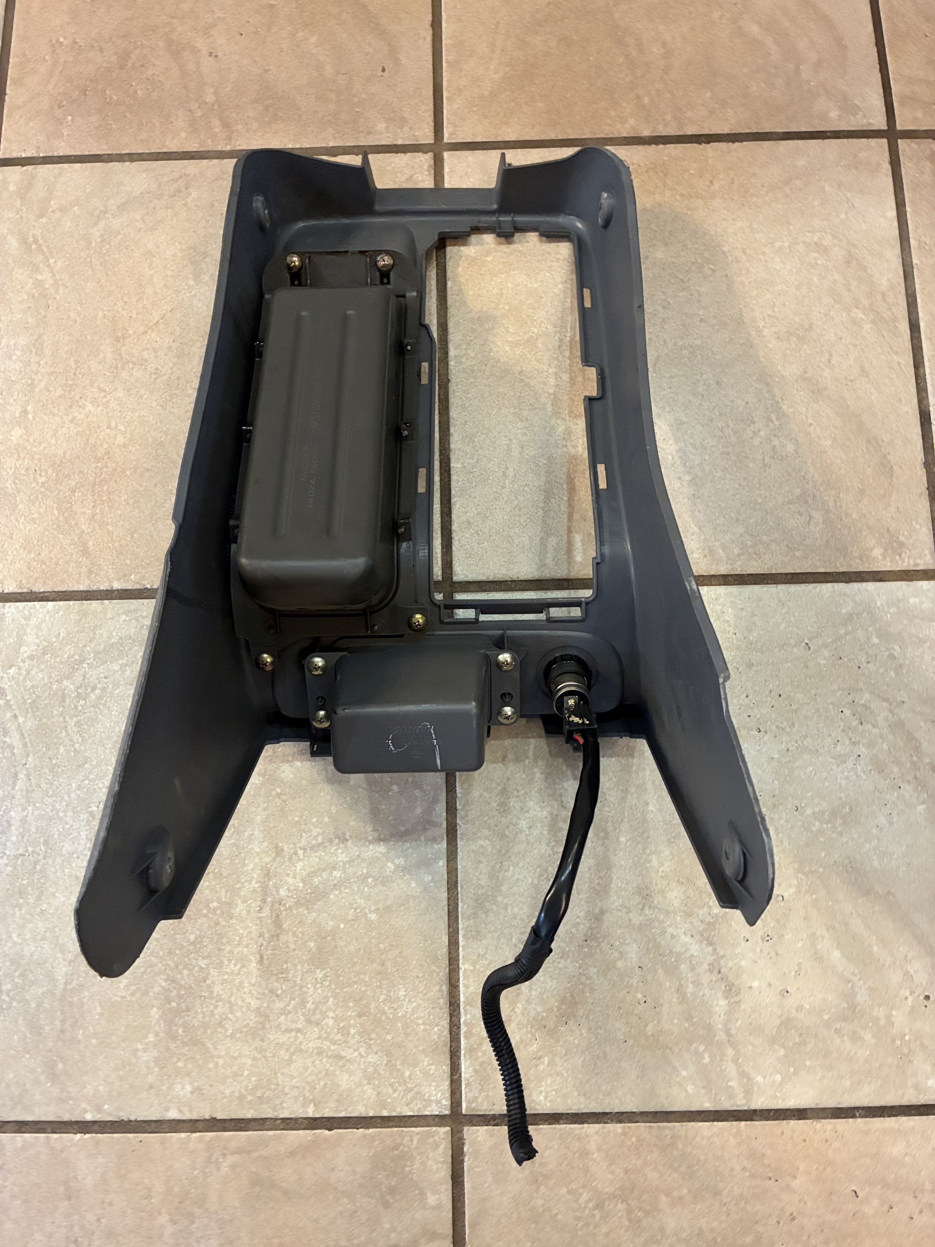

I am just loving the modularibility of this Nissan Xterra center console shifter combo, bless this Nissan engineers for using screws and not those god forsaken plastic clips that get brittle over time and snap right off
Gregski
Posts: 3157
Has thanked: 628 times
Been thanked: 1606 times
Re: [DRIVING] 1971 GMCe Lexus GS450H BMW 530e Tesla Model S Electruck
Post by Gregski »

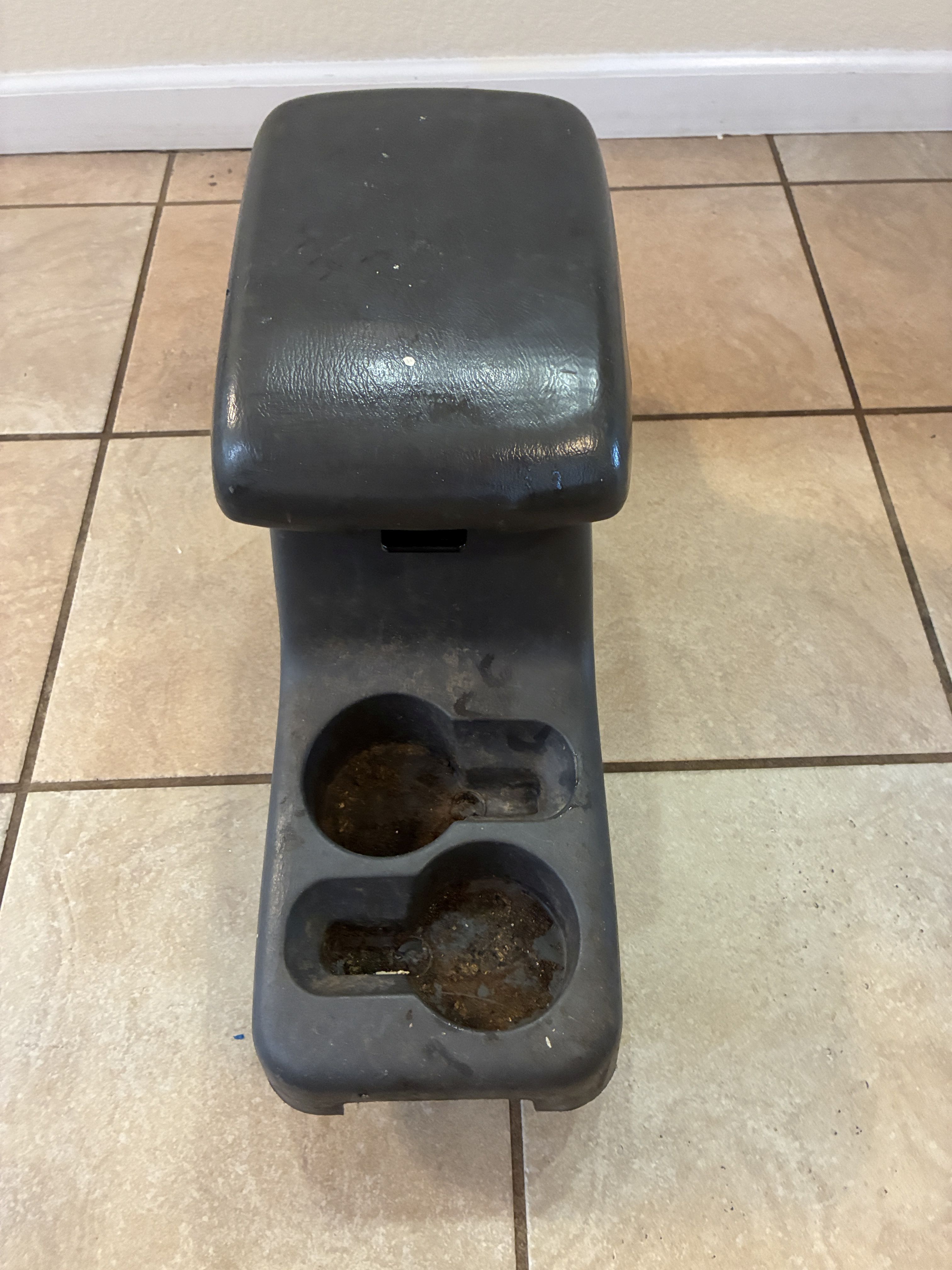

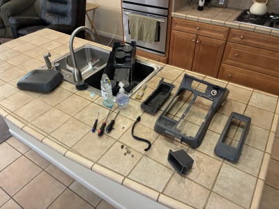

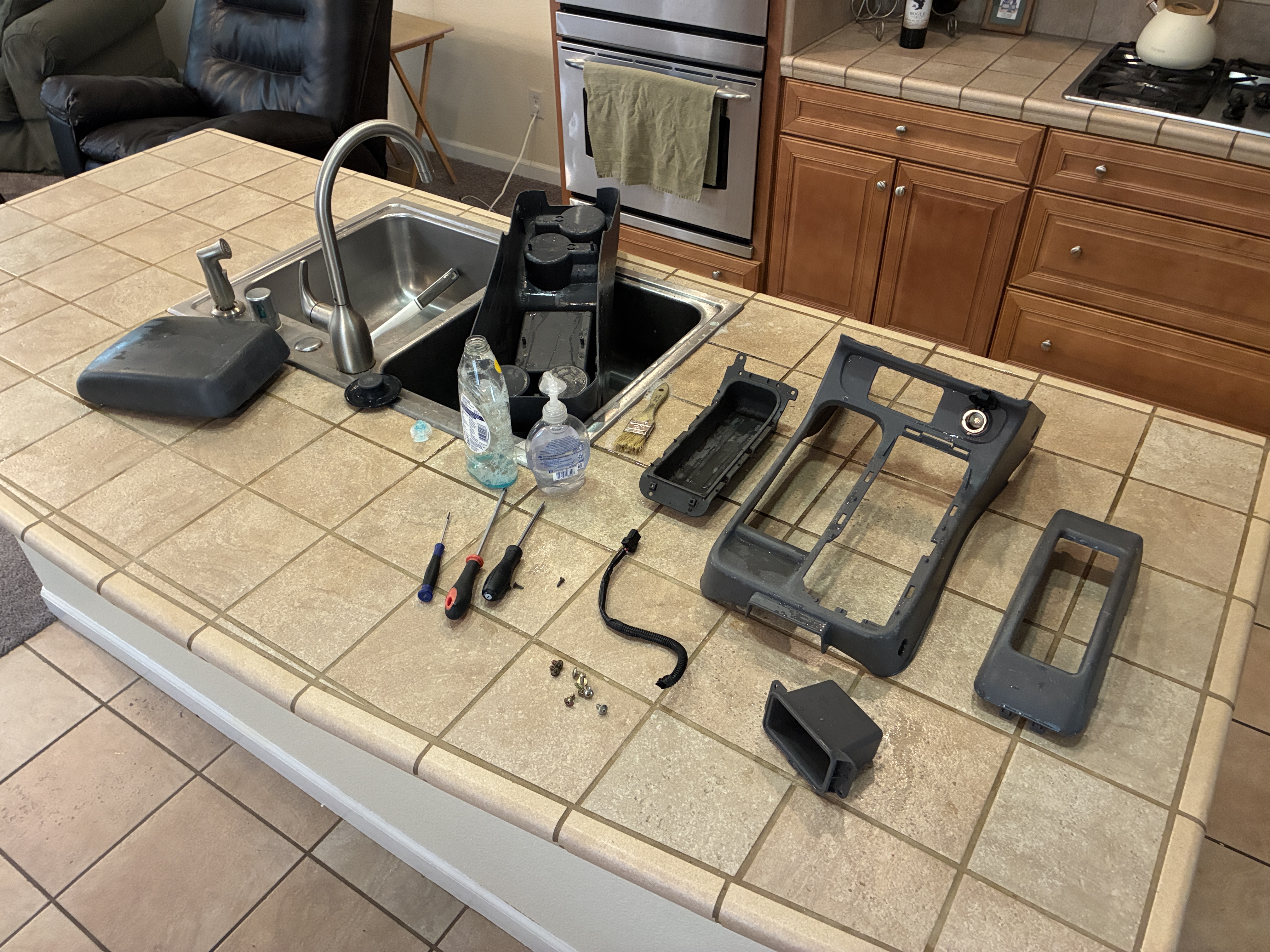

meanwhile in the Kitchen Adjacent Stand Alone None Integrated Center Console Refurbishing Facility - KASANICCRF

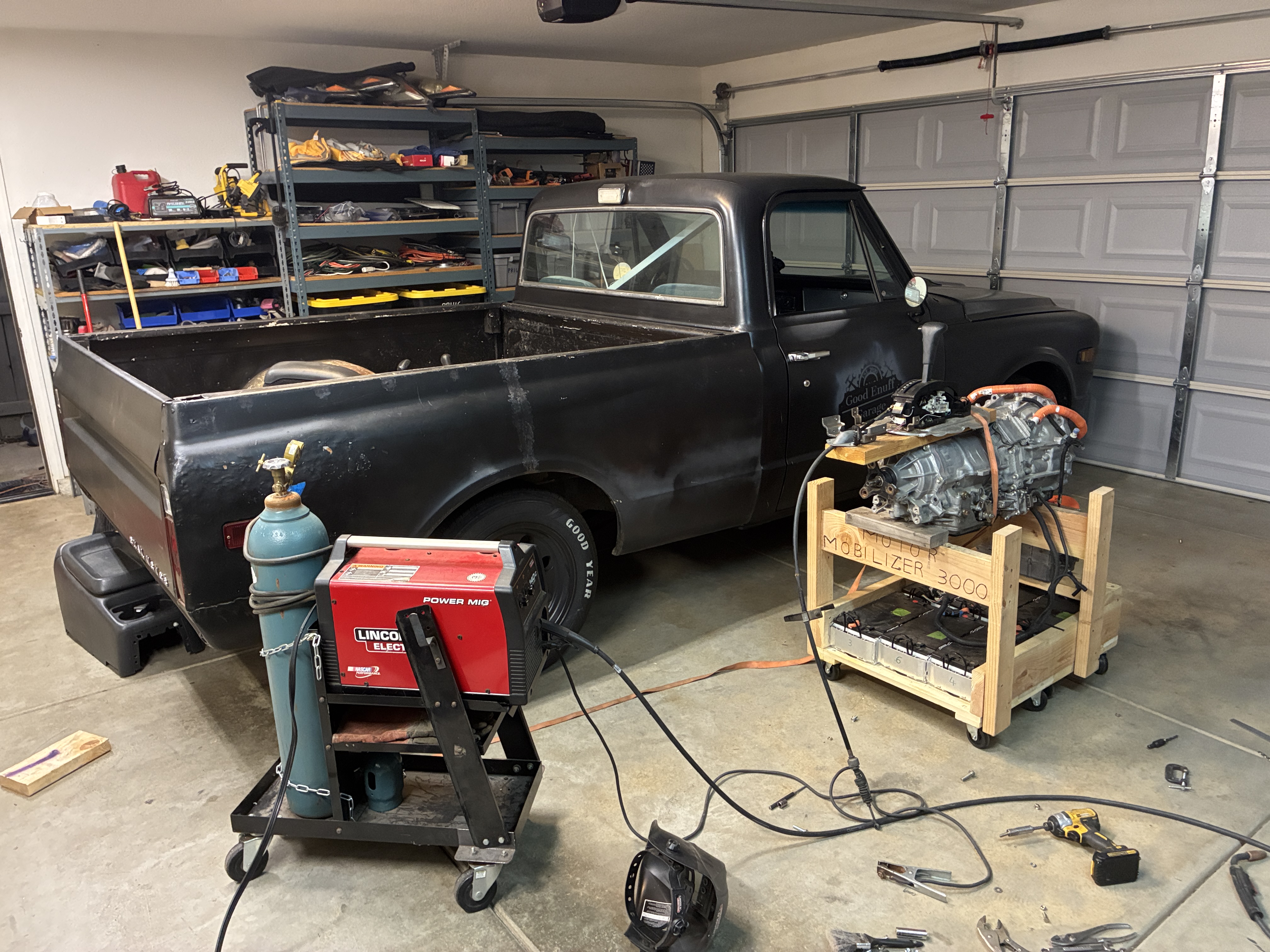

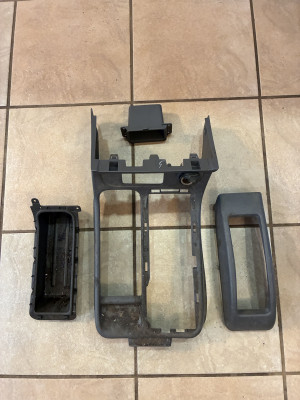

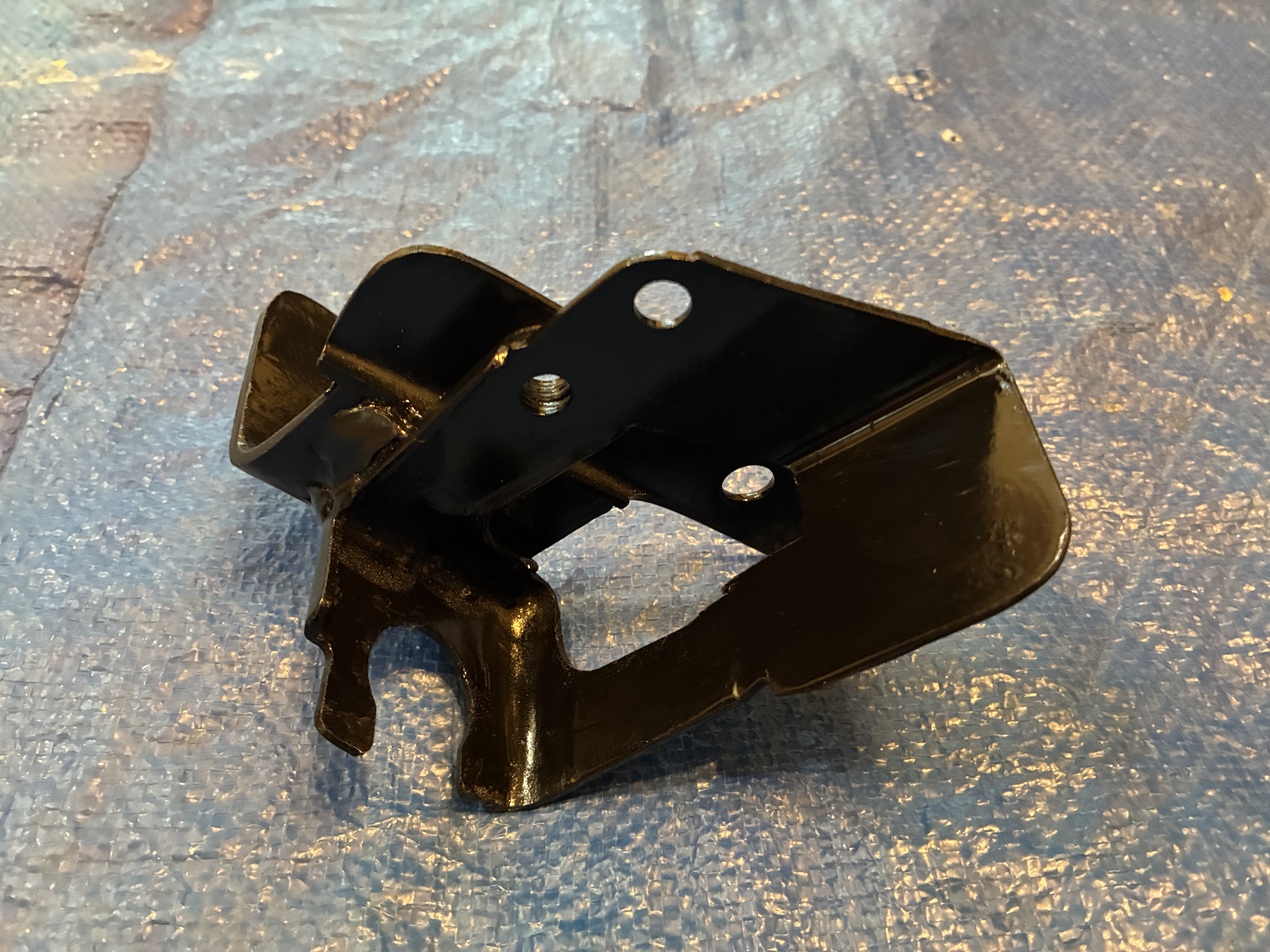

well this escalated quickly, I'm sure you've all been there
The Nissan Xterra shifter cable to Lexus GS450h gearbox adapter... for the Chevy GMC truck

Progress not perfection, hoping to finish editing the 3rd shifter video soon

well I think it turned out Good Enuff

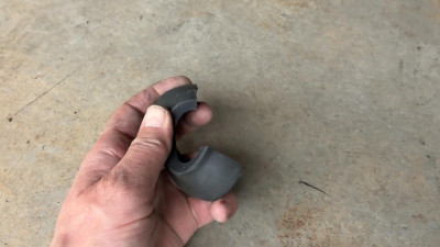

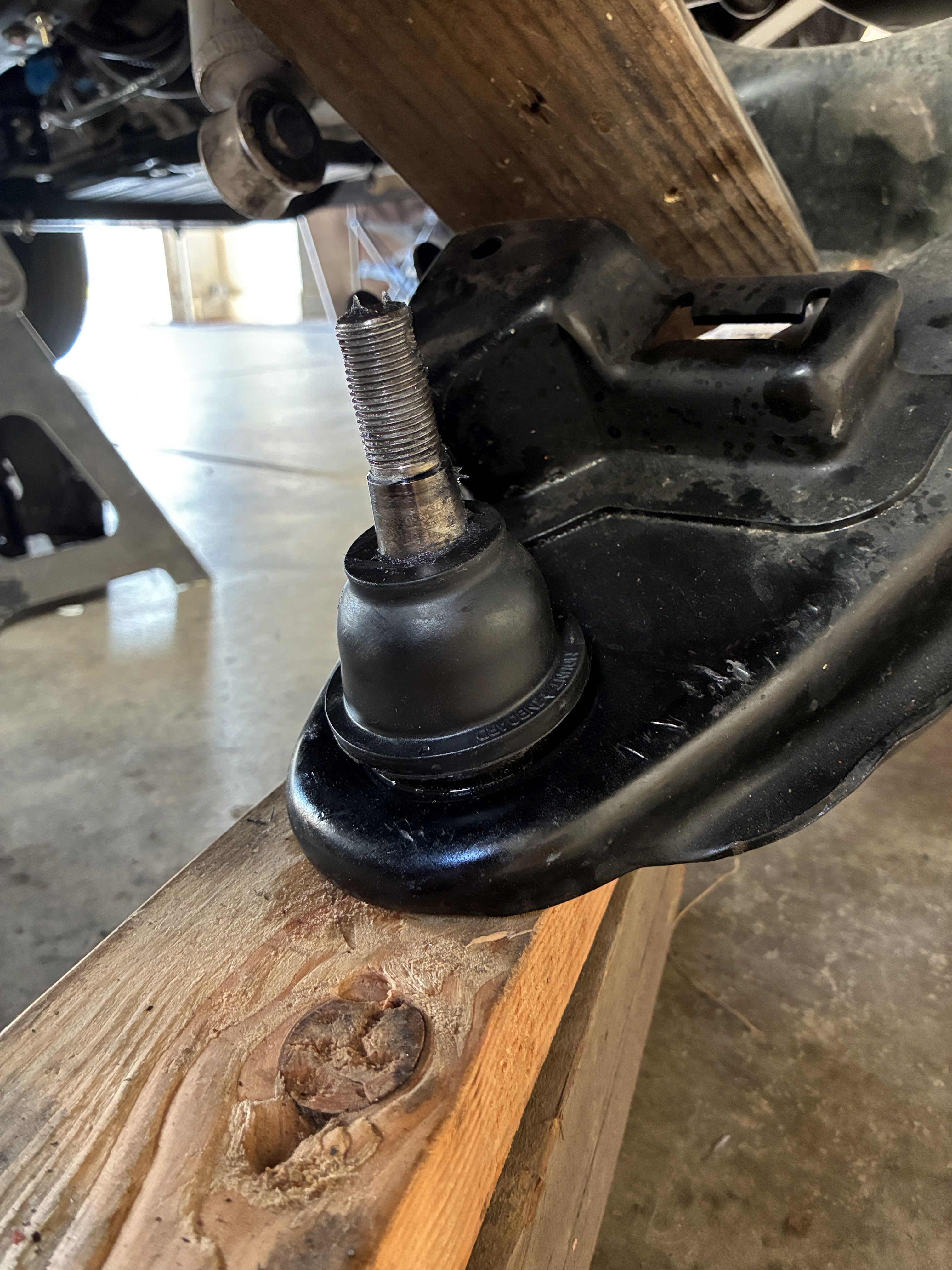

Probably a BMW owner: "Hey Greg now that you completed Phase II of your EV conversion project are you just going to enjoy driving the hell out of it?"
Me: "Um, no! I own an operate a Chevy"

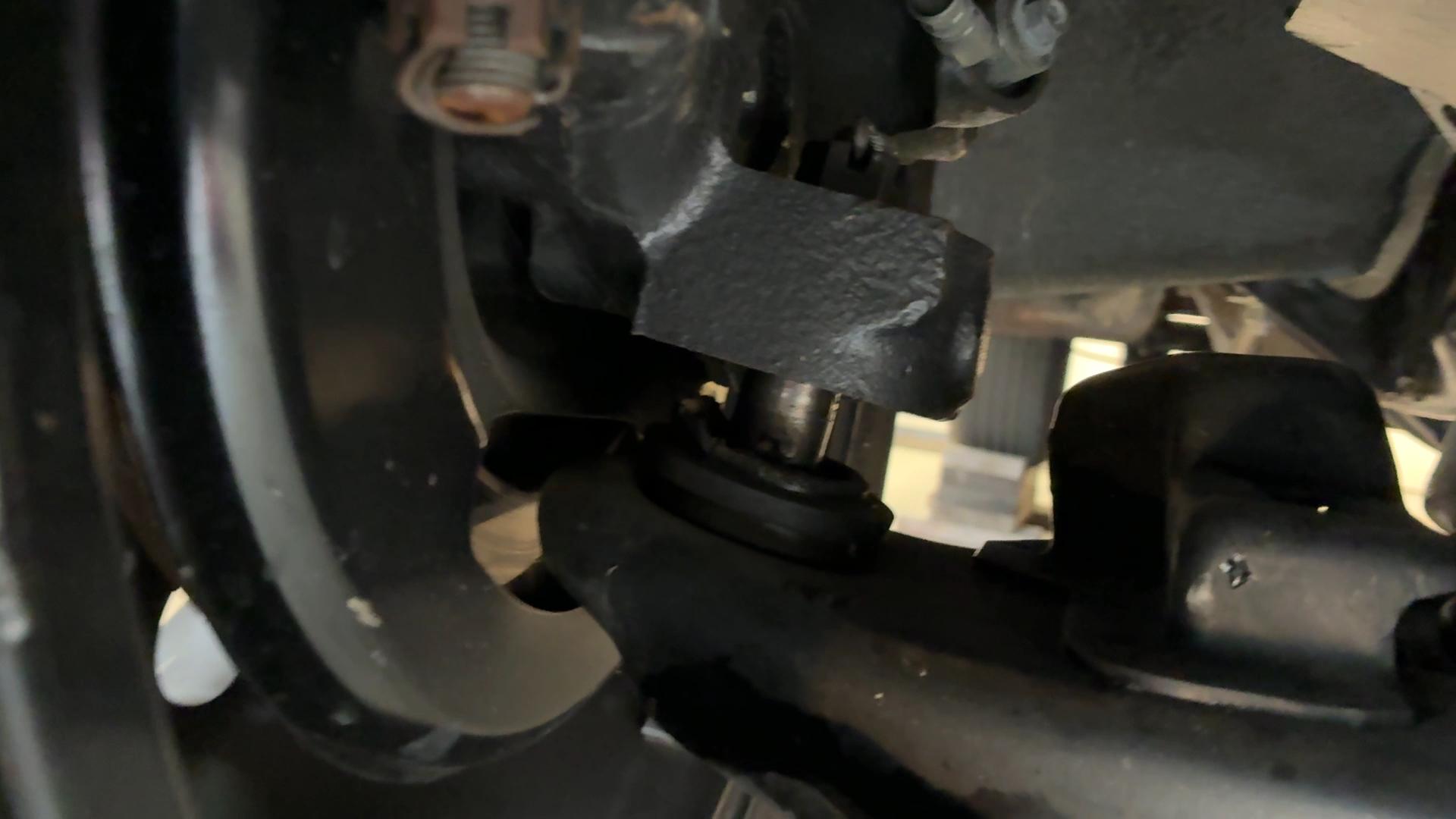

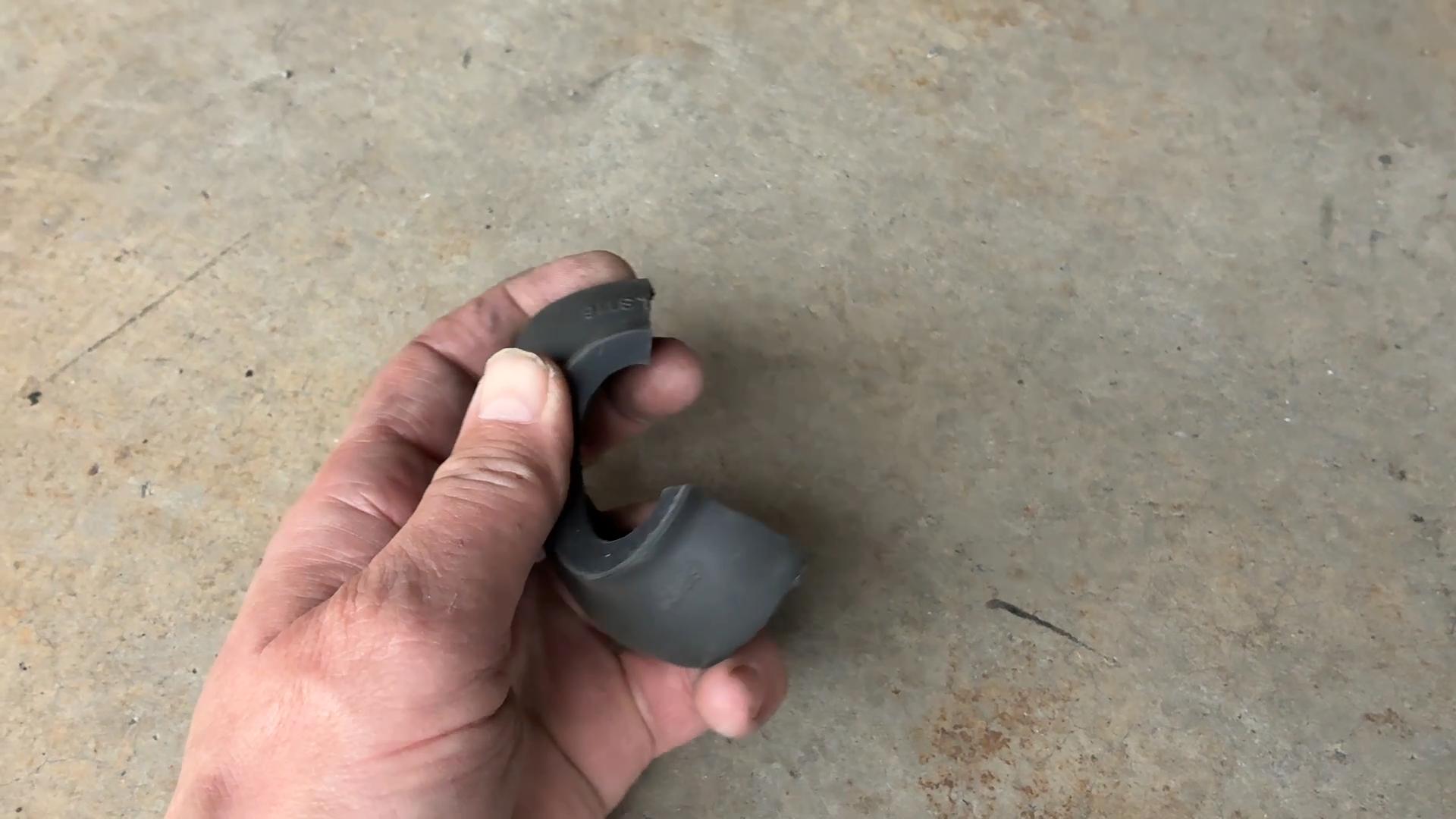

... any guesseses what this is or was ?
jrbe
Posts: 766
Has thanked: 360 times
Been thanked: 249 times
Post by jrbe »
Ball joint seal?
Gregski
Posts: 3157
Post by Gregski »
jrbe wrote: Wed Dec 10, 2025 2:06 pmBall joint seal?
excellent guess

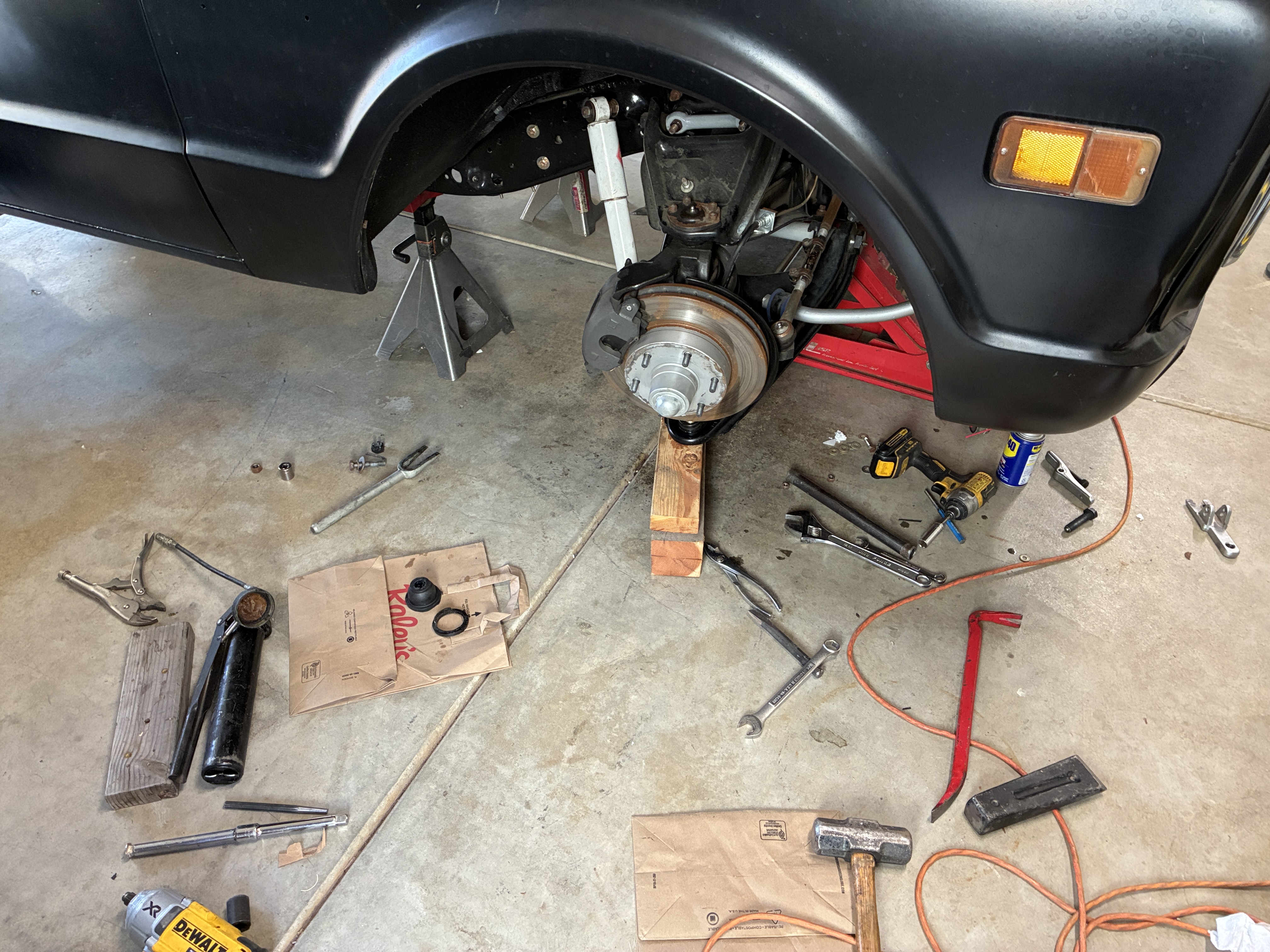

Post by Gregski »
looks like we won't be making the Pikes Peak International Hill Climb again next year
GMCe Failed MOOG Lower Ball Joint Thingie
Post by Gregski »
noffin' to see here, just doin' the non EV things to my EV

Post by Gregski »
MattsAwesomeStuff wrote: Wed Jan 28, 2026 2:37 am Eww. Maintenance. Gross.
Maintenance = Good
having to do "maintenance" on brand new aftermarket parts that are only 18 months old with less than 3,000 miles on them = Gross

Post by Gregski »

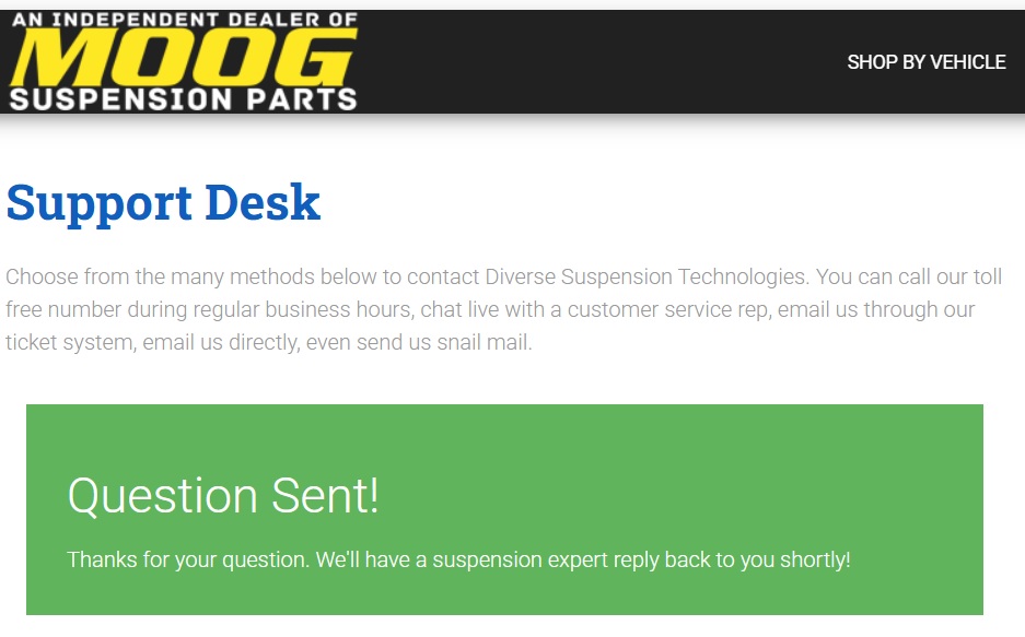

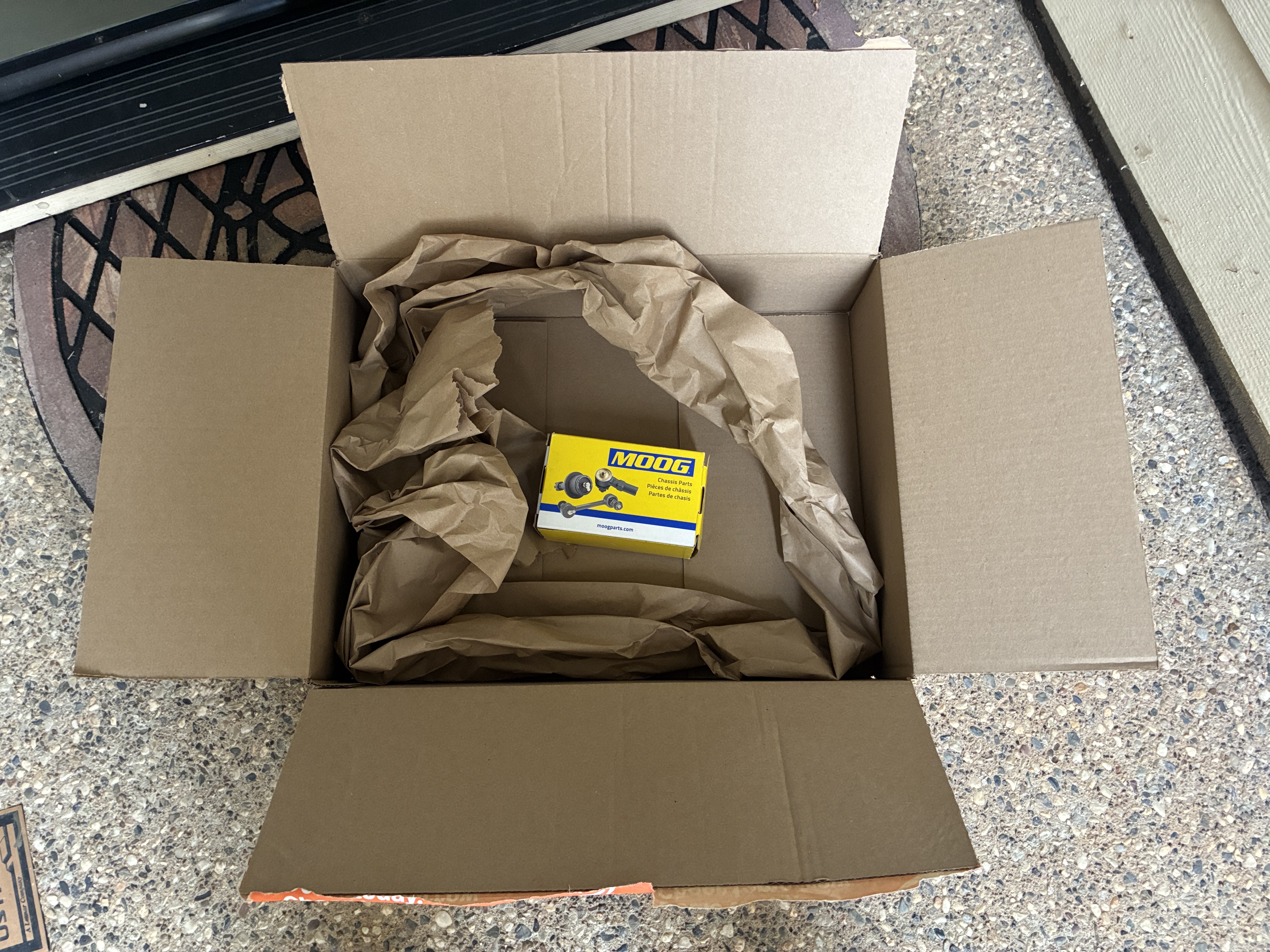

whilst replacing that lower ball joint rubber thingie, I noticed a hole in the brand new uppoer ball joint rubber thingie, disgusted I decided to reach out to MOOG... and now we wait!
