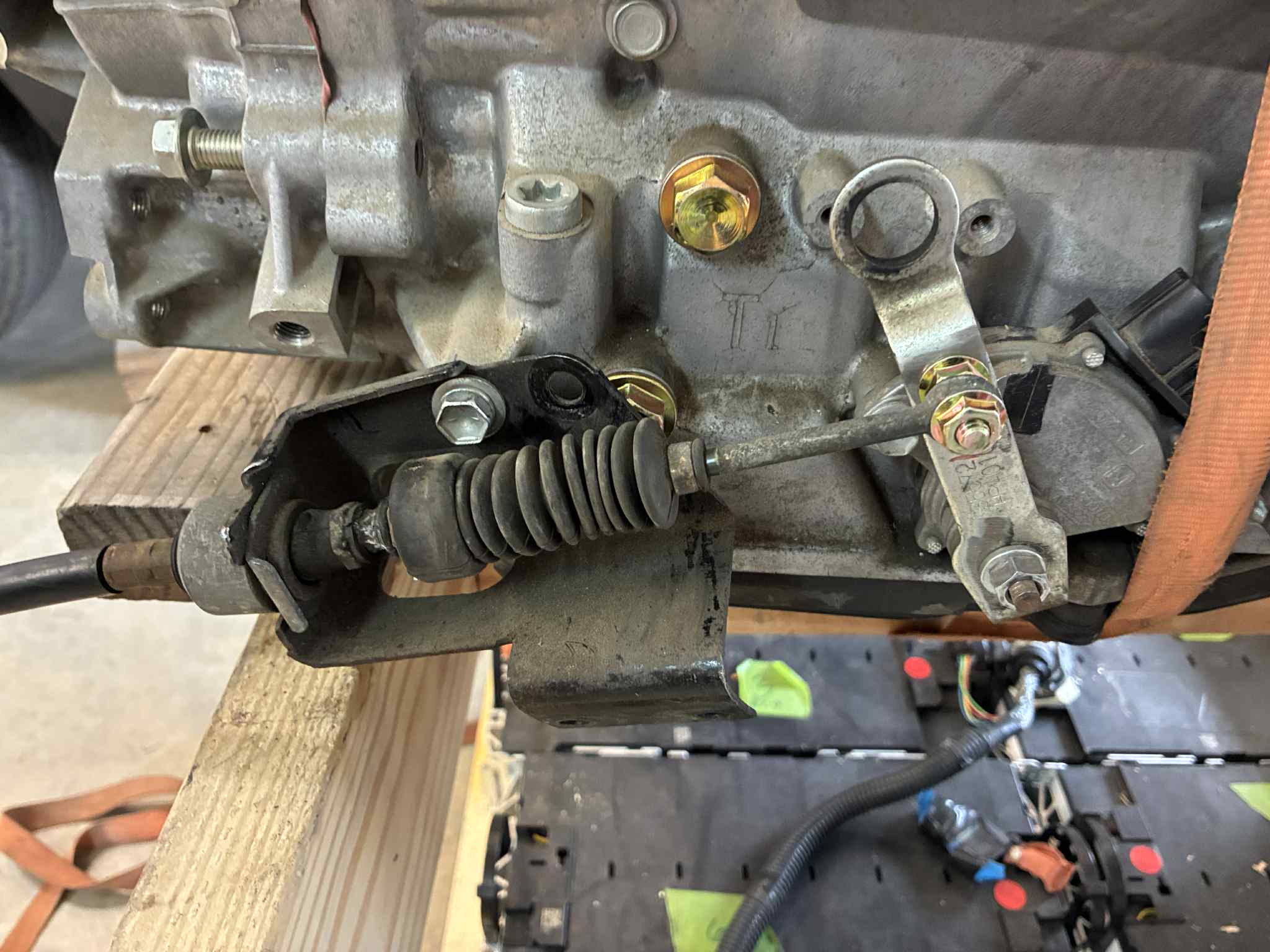

so then I threw her on our mobile motor shifter stand using the custom Nissan Xterra to Lexus GS450h Douglas fir adapter
and here I am shifting it almost perfectly using the hole I drilled for that B&M shifter for the GM TH350 transmission, this was working about 98% flawlessly, perfect cable alignment in Park and Drive, and a little short in Reverse and Neutral ie at the peak of that lever arc, so some adjustments need to be made
FYI the cable bracket is attached using its stock holes to the ground strap bolt hole on the gearbox, and I think it needs to move slightly upwards

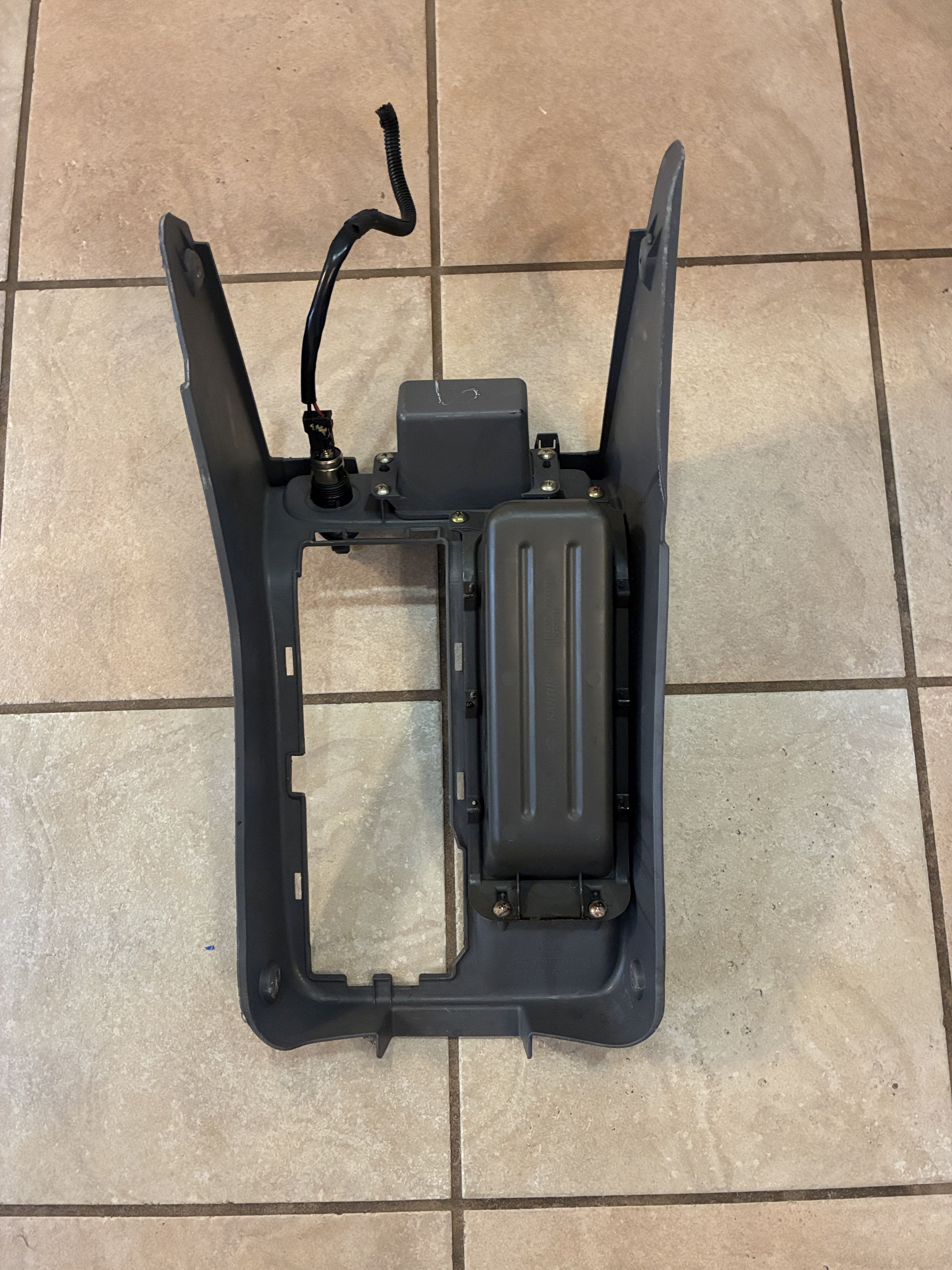

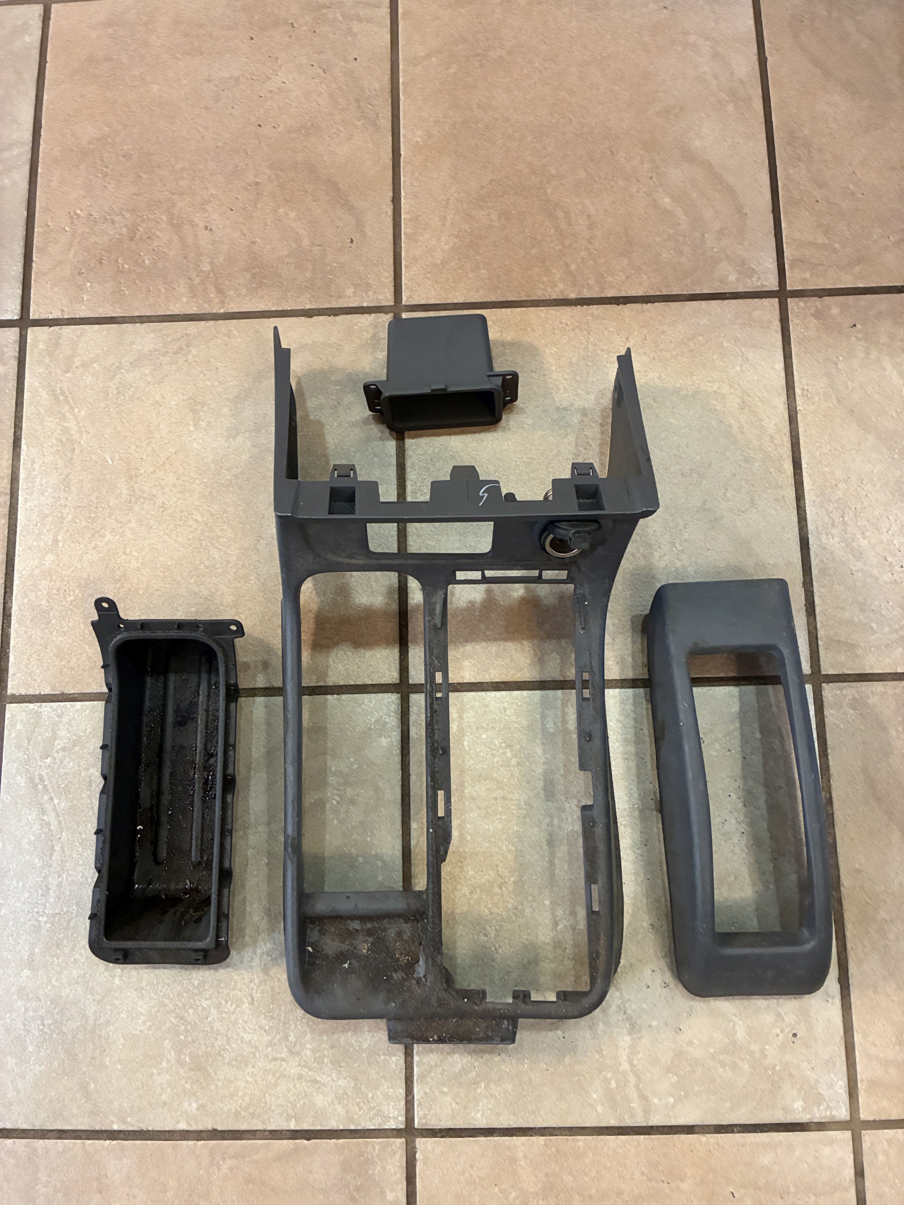

I am just loving the modularibility of this Nissan Xterra center console shifter combo, bless this Nissan engineers for using screws and not those god forsaken plastic clips that get brittle over time and snap right off
Re: [DRIVING] 1971 GMCe Lexus GS450H BMW 530e Tesla Model S Electruck
Posted: Sun Nov 16, 2025 11:13 pm
by Gregski
meanwhile in the Kitchen Adjacent Stand Alone None Integrated Center Console Refurbishing Facility - KASANICCRF

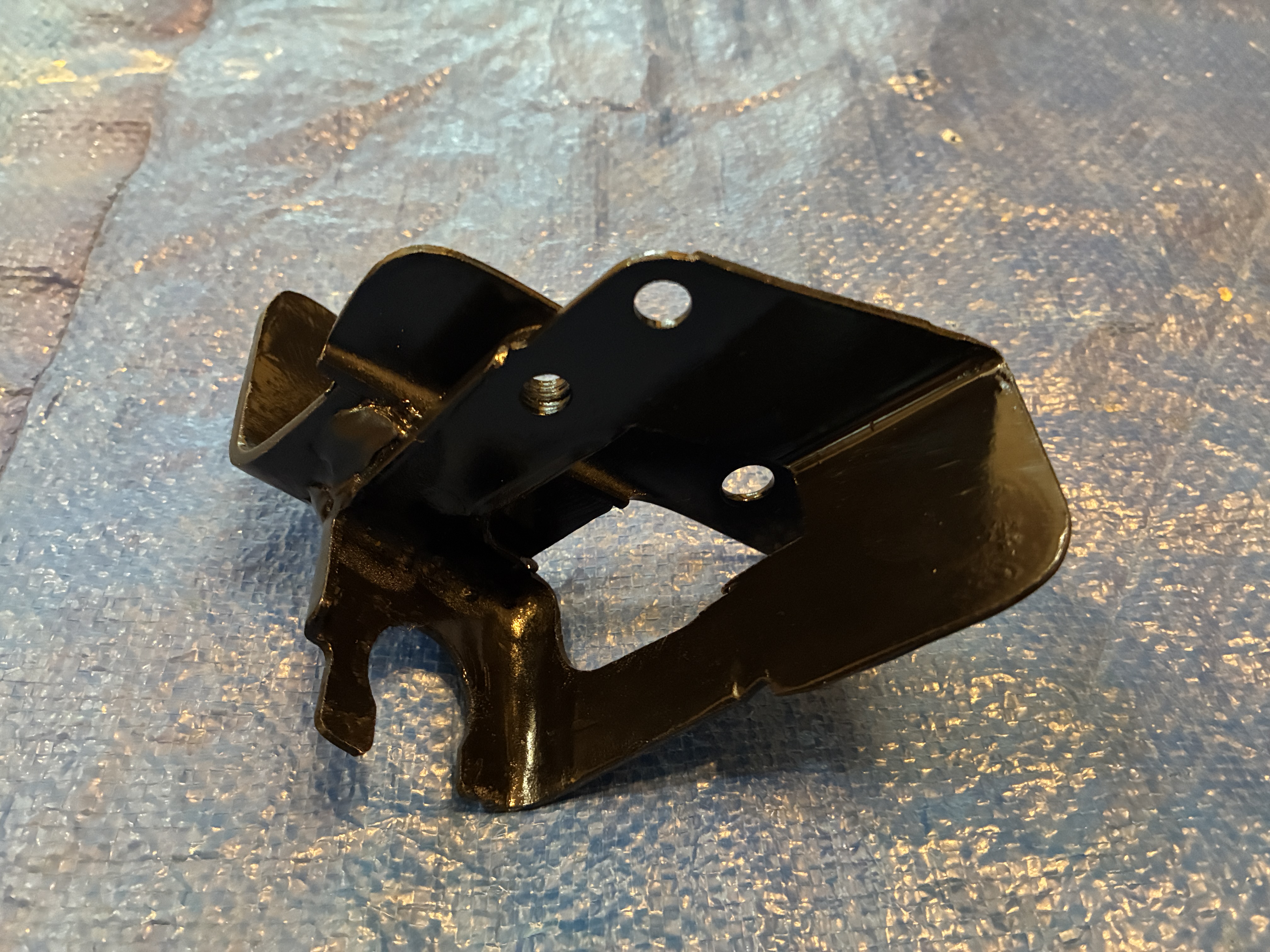

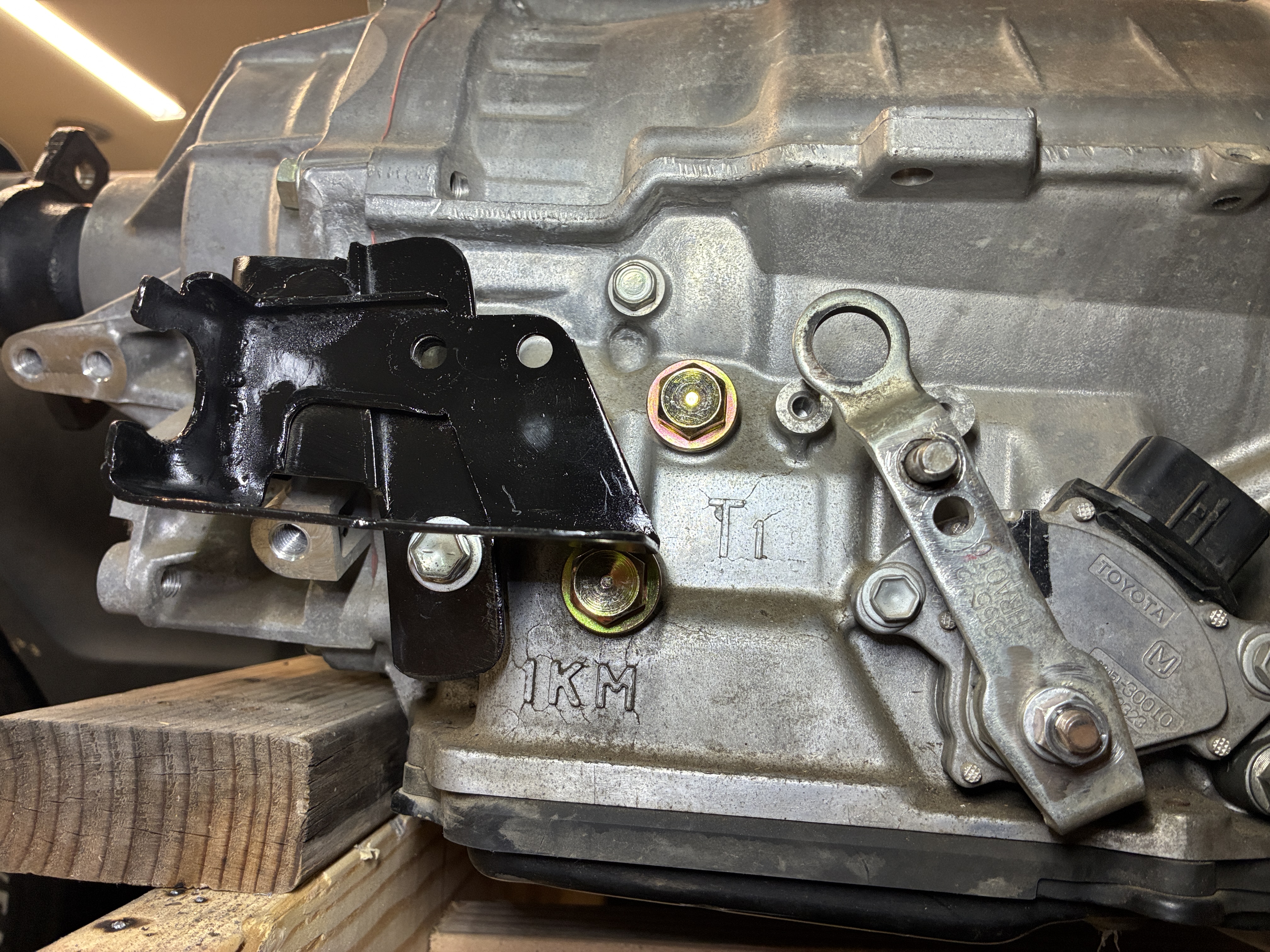

well this escalated quickly, I'm sure you've all been there
The Nissan Xterra shifter cable to Lexus GS450h gearbox adapter... for the Chevy GMC truck
