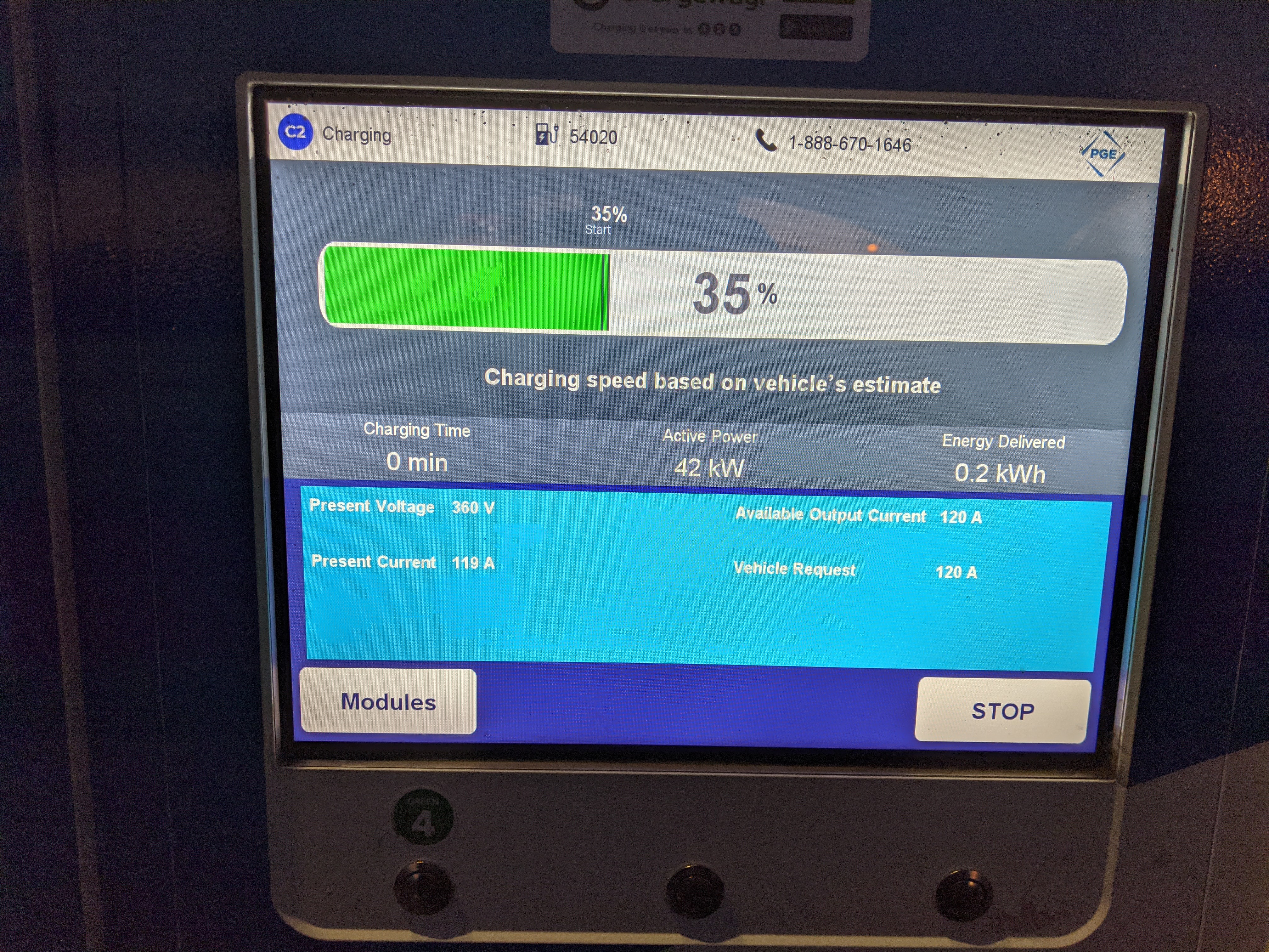

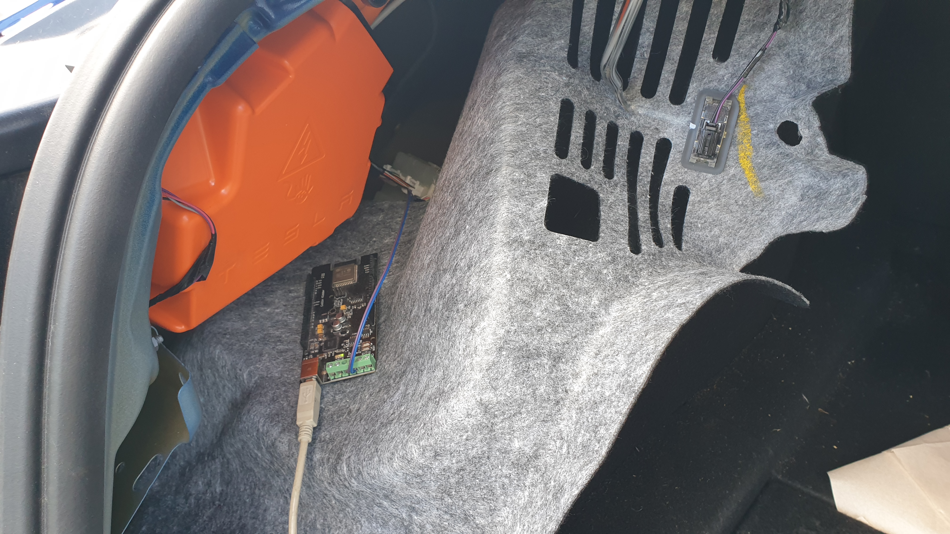

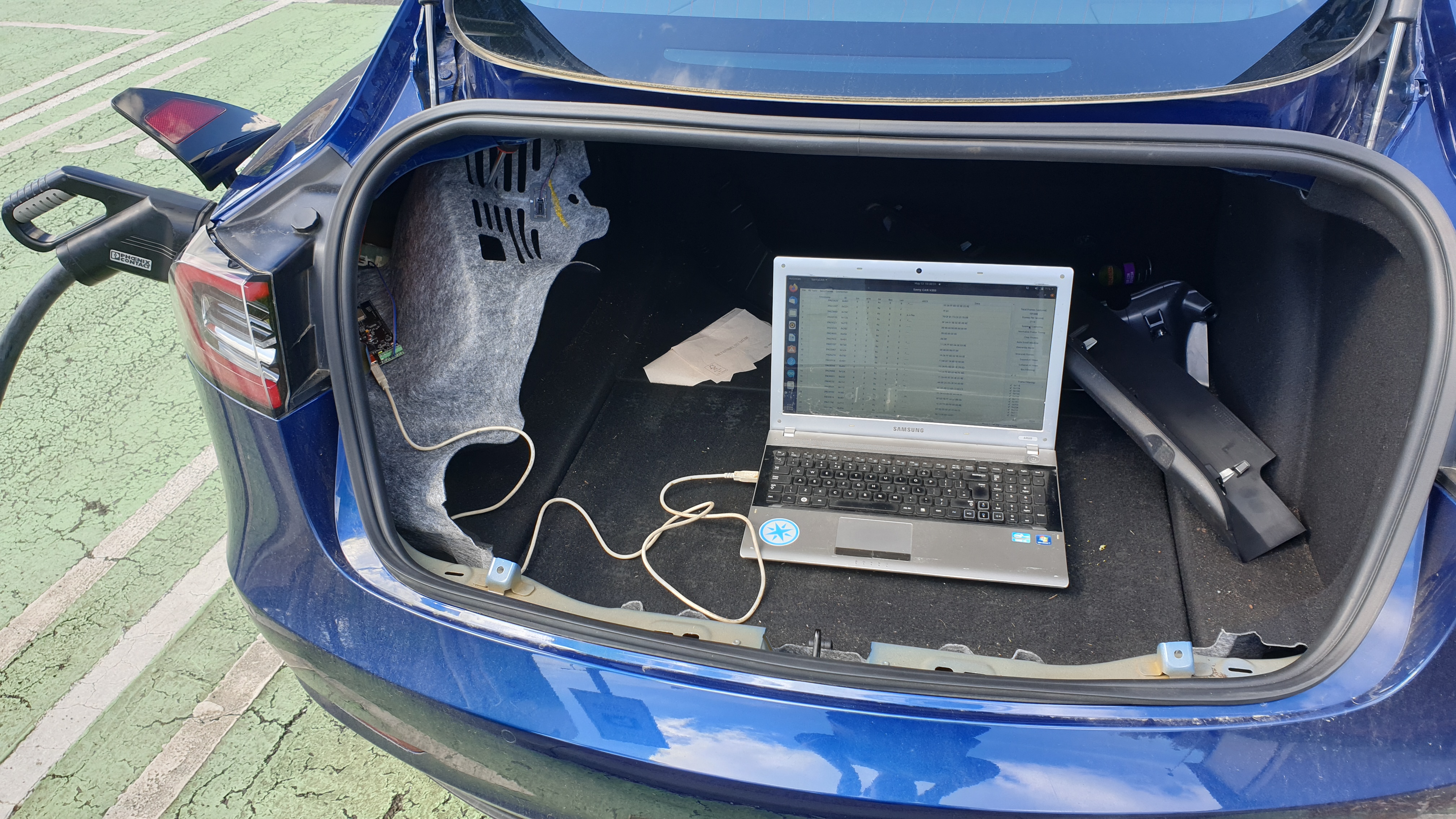

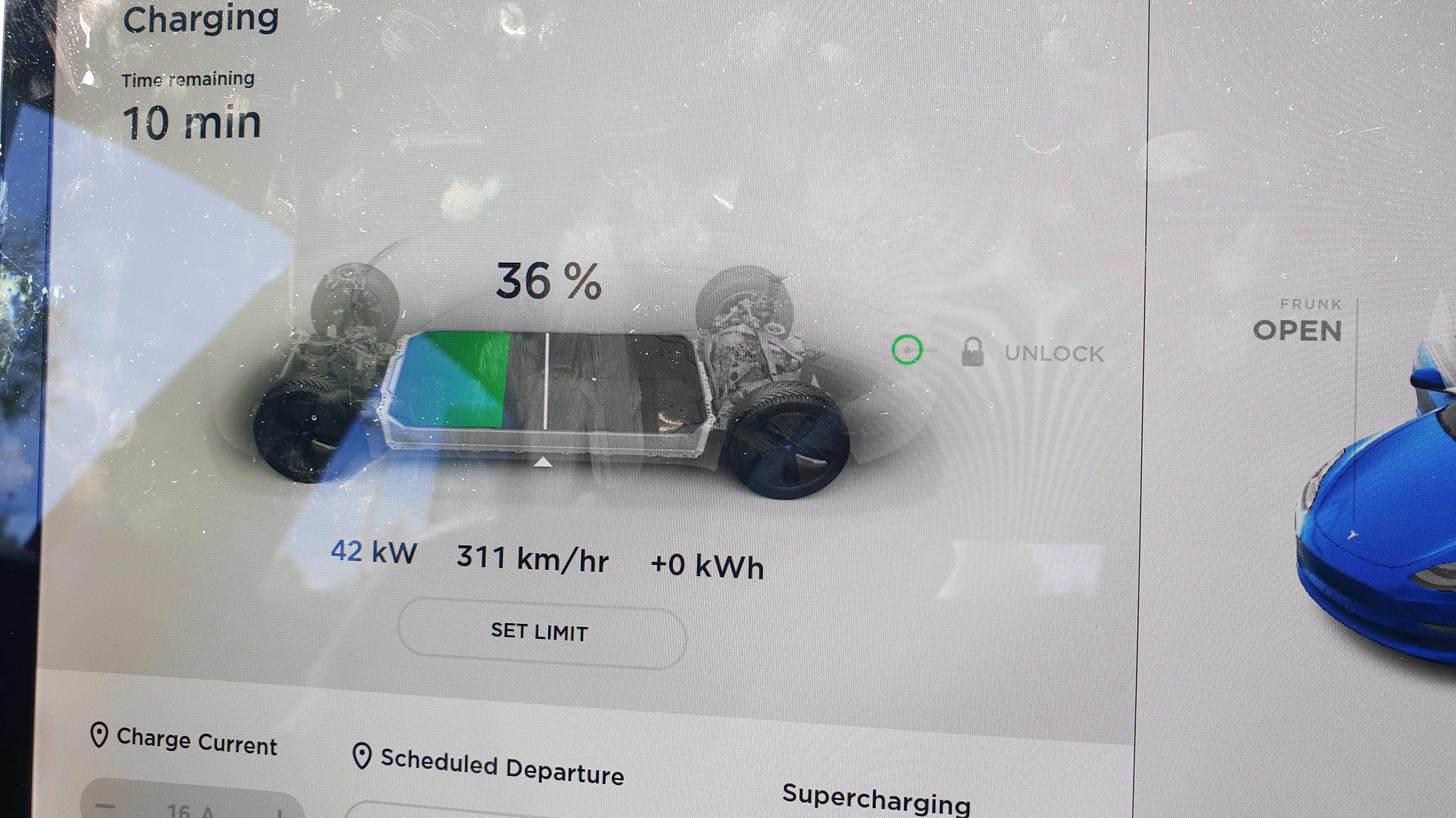

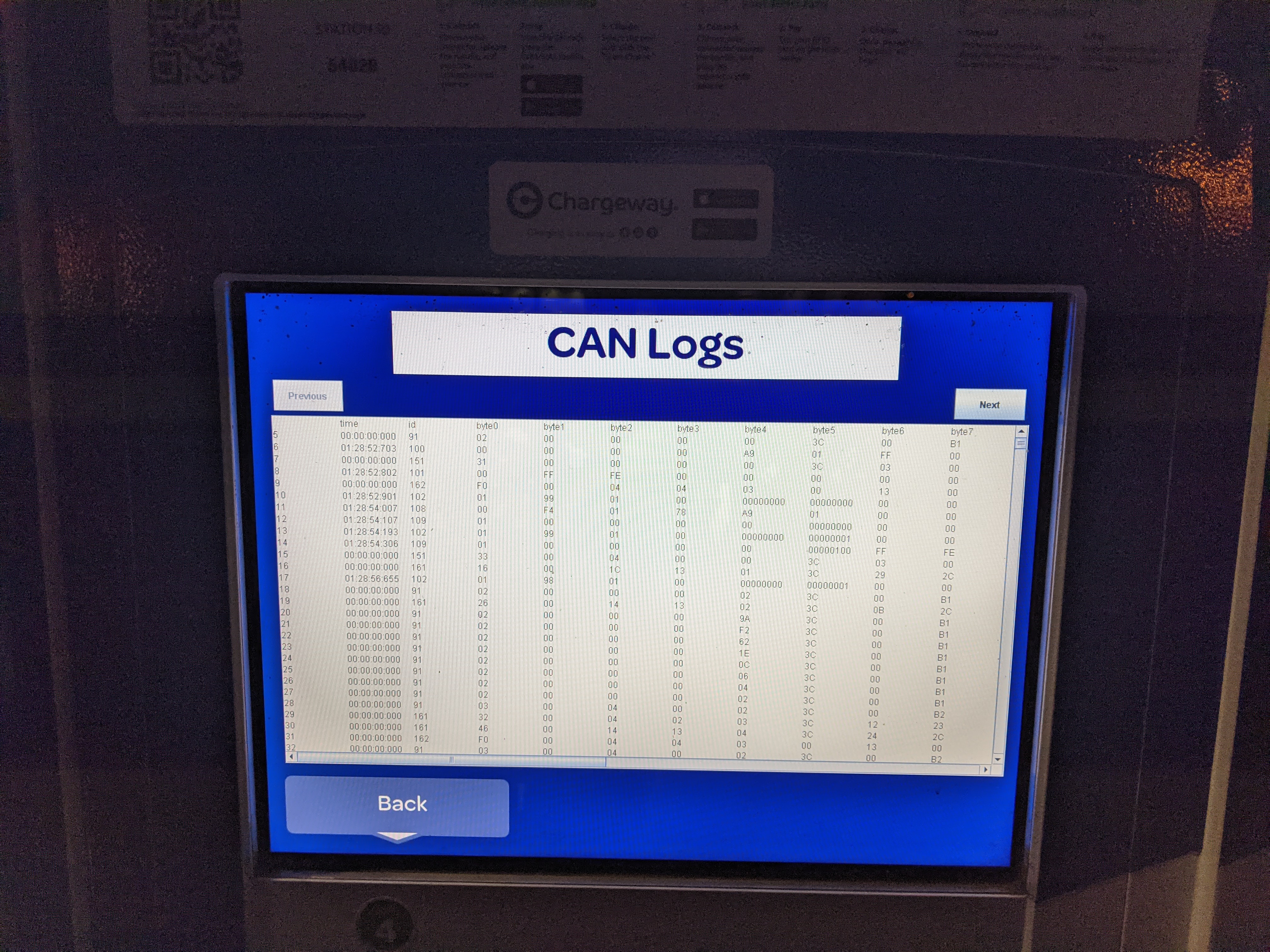

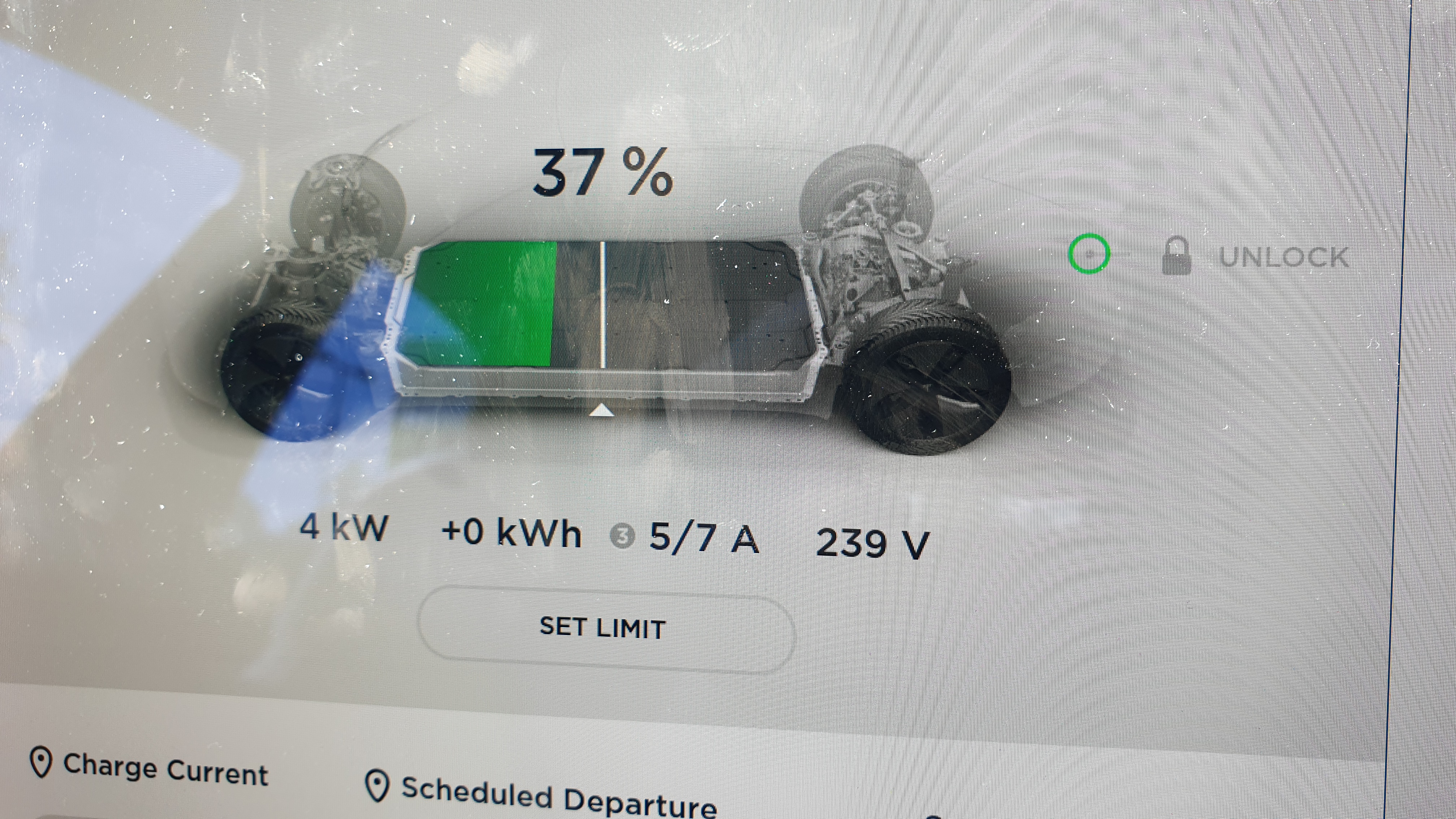

Ok I wired that up, and went to my local CHAdeMO charging station, and captured the whole session. Voltages were decidedly less than 400V during the charge...
Notice anything odd?
Note that "Modules" piece. Uh, what?
After the charge was over, there was another one that said "Logs"...then... The station was in some sort of Tech mode. Kind of interesting. I was so focused on getting the charge stated and logging that I wasn't paying attention when going through the menu. There was a button to exit the special mode. Glad I didn't.
Anyway, I got a capture here. Then went home and installed the "Holiday Update", logging that. Now I'm finishing a short top-off to 50% on AC...then tomorrow I'm pulling all my stuff out of the car, and making that service appointment for the BMS_a035 error.
That said, hopefully I have enough here now to get a little further than before.
Back to squashing warnings on the ZombieVerter code.
-Matt

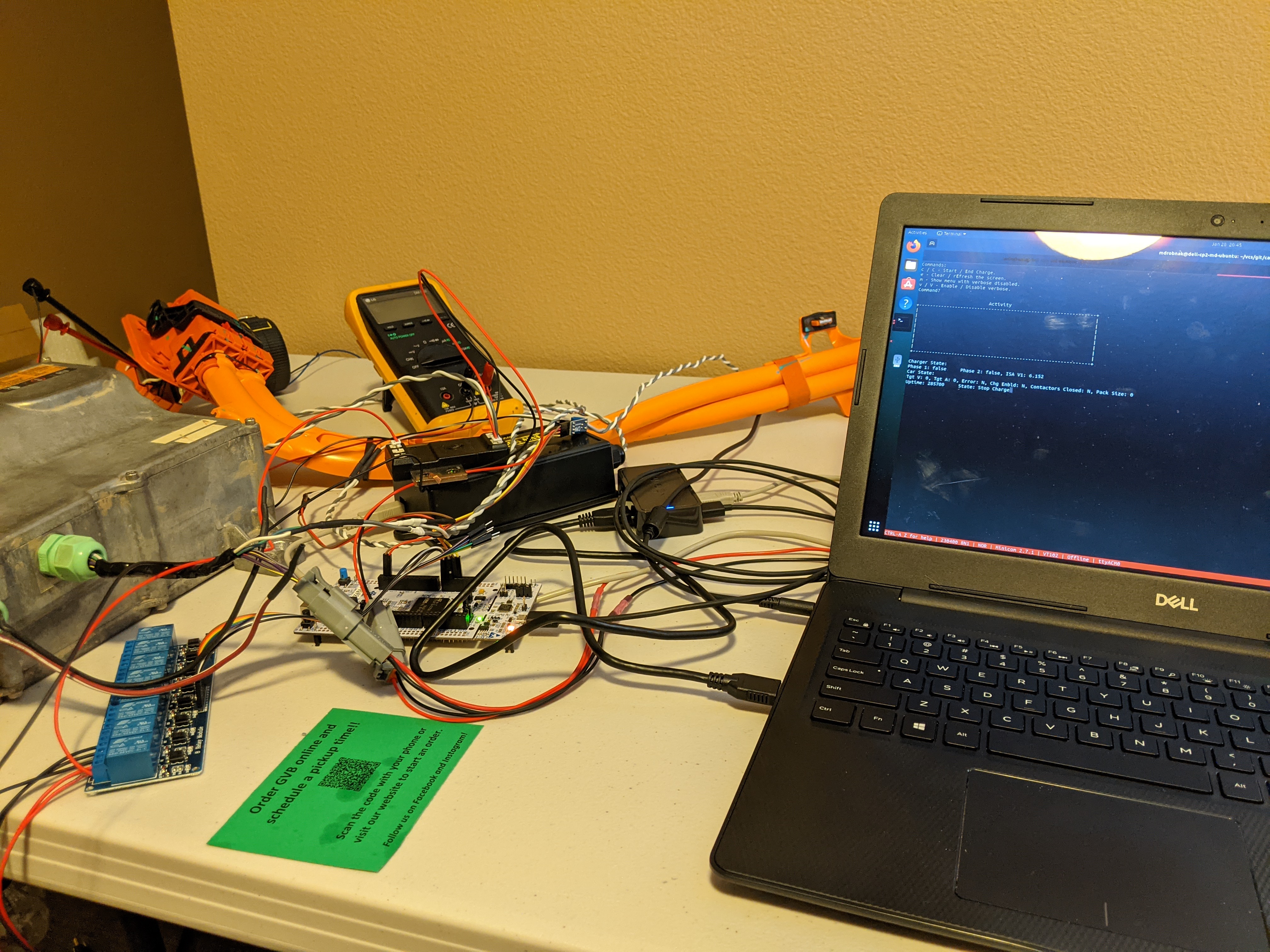

ISA Shunt is wired up for testing finally. Will start working through my code tomorrow. Will then figure out how to iterate through available on the bus.
Code will do the following:
1) If set up in EEPROM, use that serial number.
2) Otherwise, do device detection.
- If only one device, use that one.
- If more than one device, alert user more configuration is necessary, and show device serial numbers.
-Matt

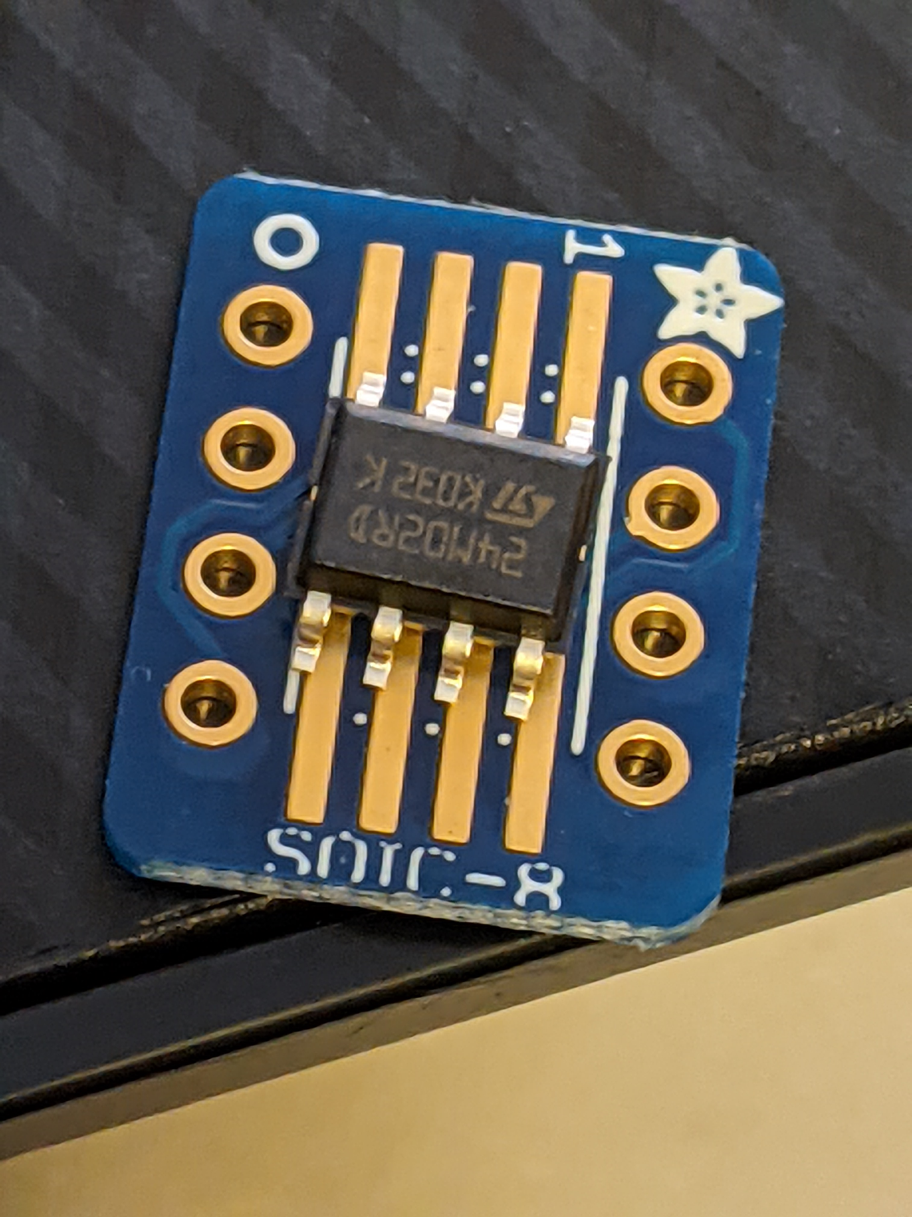

Soldering SMD to adapter boards SUCKS!
What kind of tools does everyone use for SMD soldering? I am fairly certain I made a complete mess of my first try.
-Matt

It looks like I may have not completely messed it up. But still,not great. Now trying to figure out I2C. I see data burst on the scope even when not connected to the board, just clock, so I think the chip is OK. But, usage is a bit of a mystery to me.

SOIC-8 EEPROM. I think I did an OK enough job, just dealing with learning how to do I2C programming now.
But no fun, that's for sure!
I have the hot air gun, but it's one of the wallpaper ones. Works fine for shrink, but too much power and moved the chip too easily. I have terrible tweezers, so that was a mess. But definitely felt like I needed more hands.

Re: Tesla Model 3 Charge Port Controller Standalone Development
Oh yeah those are no problem with a little bit of care. Here's what you need to do if you haven't got a good method yet:
If any of that's not clear I can make you a video soldering a part just like that
- Put a little bit of solder on one corner pad (IC is not on the board yet). Keep the rest of the pads dry for now
- Hold the iron down on the edge of the pad and use tweezers to slide the part onto the hot solder and center the part on all the pads
- Make sure the part is perfectly flat. If it's not you can put light (very light) pressure on the top of the part and re-flow the solder so it drops down flat
- Now you just put a little bit of solder on each of the rest of the pads. I usually do the diagonal pin second to make sure nothing will flex. Make sure you heat the pad and the leg together so the solder flows evenly and quickly
- At this point if the solder filets don't look great you can flux them and re-flow. If there's too much solder use the wick to pull some off or re-flow and clean/scrape the iron a few times to get rid of the excess solder

That's really awesome tips. I'll definitely re-read that if I end up having to re-do this mess.

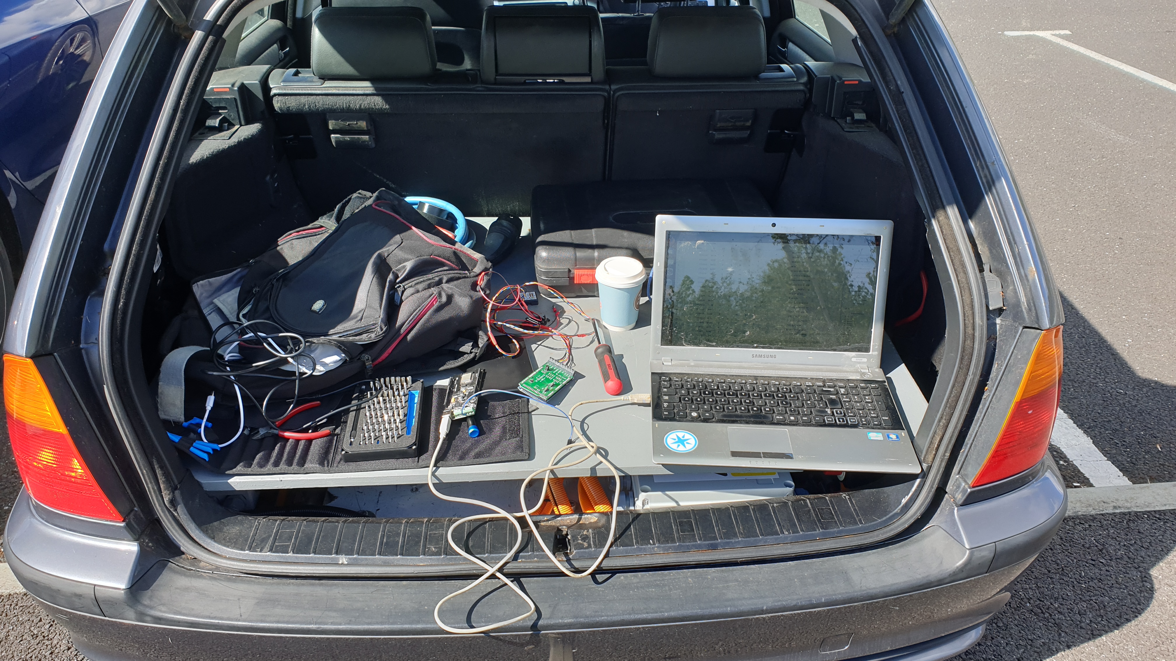

aannnd its here. Very kindly donated by forum member paaa. Contacted my friend with the M3. we are good to go for next week. Now I just need to find the easiest way into the hvs can wiring. Any pictures would be great:)
- Posts: 4000
- Been thanked: 1116 times
We got logs :
https://github.com/damienmaguire/Tesla- ... CP_CAN_CCS

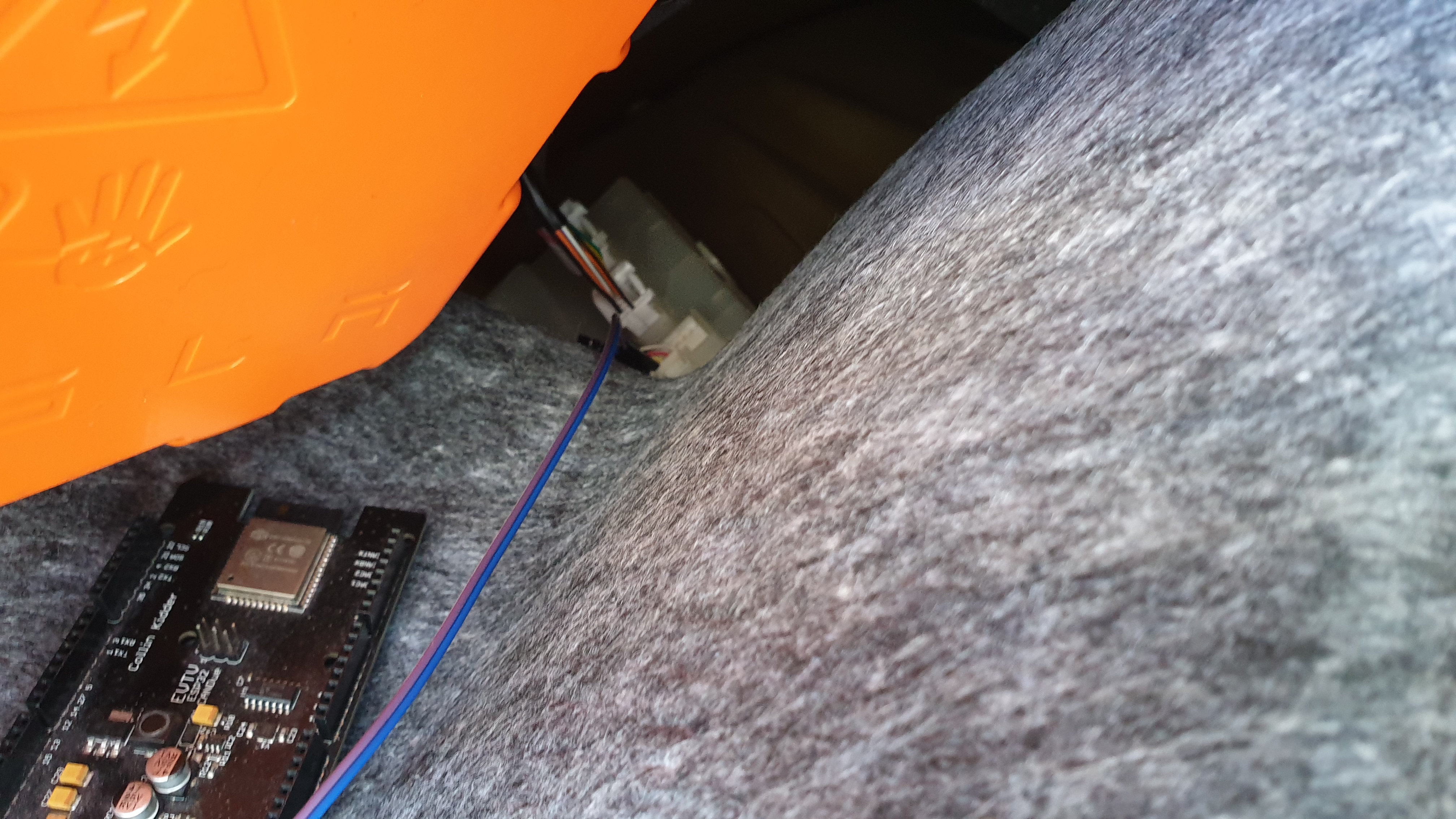

Ended up not half as hard to get to the CP ecu as I had thought. Only had to remove 2 pieces of trim and pull back the carpet. Rather then mess about with the inductive can unit I just stuck two wires into the back of the car side connector on the cp ecu.
We did the following :
1)open and close the charge port flap
2)CCS at 44kw (probably charger side limited because Ireland)
3)AC charge
4)Drive a few hundred metres,
5)Damien drive Model 3 for the first time
Car is a 2020 55kwh single motor right hand drive model.
E46 Touring is an excellent service vehicle:)

First finding 0x244 reports FC limits from the charge point. In this case :
Max power 50kw
max voltage :500v
min voltage: 50v
I sure would love to try ccs charging a low voltage car:) I'd nearly bet the Panzer it would crap out...
