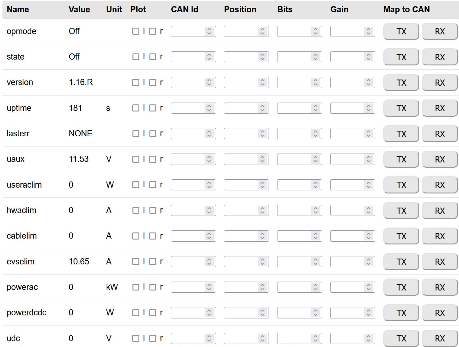

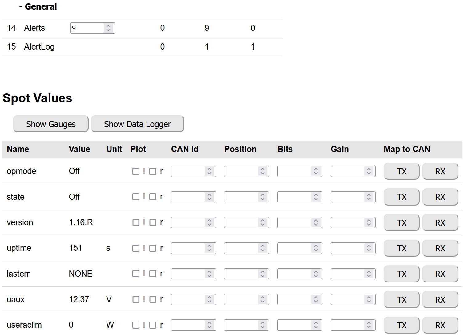

Got to give the Beta firmware a run this morning, nice work JB :) Couple of comments. Some of the default values set after firmware upload fall outside the min and max range for now. Look to be missing some of the drop down selection boxes such as 'inputtype' and 'Alertlog' so couldn't activate the error log test yet
First two screenshots when PCS controller powered up but no enable signal. No AC or DC HV connected for either to match my earlier test above. Looking to get the same error messages.
Next three screenshots when enable signal connected. On previous firmware with this test, PCS controller opmode changed to 'Run' at this stage, stays 'Off' here?

Ok I have no idea why the parameter database is doing that. Attached is my set so I'd load that in and do a reset and that should put things back to normal. Probably an artifact of me moving params around in the new code. The PCS will only respond to the enable line if in manual mode so I'd guess that's where the problem lies. Try those params and lets see if the interface displays properly.

Got to connect HV to the PCS today and do some more testing. Manual mode and DC-DC option only to start. Applying enable generated a count of 5 alerts, but only three unique alerts. Not quite sure what they mean yet, and likely to do with my setup. Didn't get any DC-DC charging for the 12V battery. My 12V battery voltage was very low after a days messing about and I have a vague memory there's a minimum voltage required...need to check

In this case the Alerts tell the story. First DCDC. As you guessed your battery is too low as per 67dcdcLVrationality.
The charger in your PCS is a 3 phase unit so you have 4 AC mains inputs : N,L1,L2and L3. Its capable of running on single phase, 4 wire 3 phase or 3 wire 3 phase. Assuming you are running from single phase then you need to connect to N and...... not L1:) as that would be too easy. What happened is your PCS saw 230v between N and L1 and set grid config to 3 (3p) phase as you can see from your spot values. The Elon brain then got confused as it didn't see the AC on all 3 phases so gave :52acvoltagenotpresent and 90expectedacvoltagesourcemising. So you need to find the right phase to apply power for single phase operation and then gridConfig will show 1p for single phase and you will then need to ask elon nicely for some power using the pacspnt parameter.
