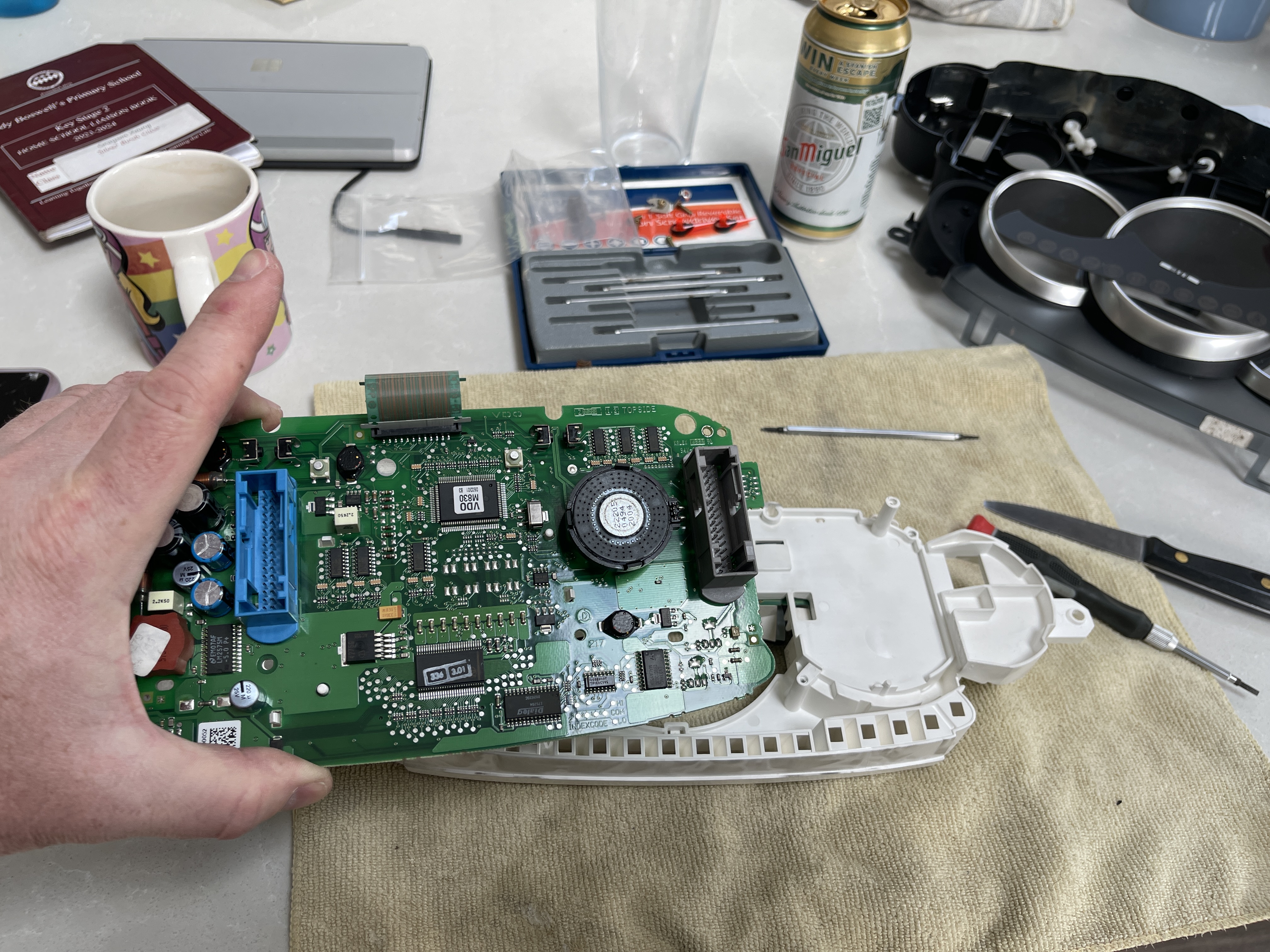

I’ve been having trouble with my dash fuel gauge and have been putting off digging into the issue for some time. Bottom line is that I needed to open the cluster and repair a dry solder joint to the stepper motor and rewire. The next issue was that I was using a twisted pair of .5mm2 cable to run from my Teensy VCU (near the motor) to the easydriver board, however I am getting interference. Thanks to suggestions by Janosch and KnoxEV, it was identified that EMI was indeed disturbing the signals. I’ve now moved my VCU to the front of the car as far from the motor as possible. This has significantly improved things, but I still see small oscillations with the needle. Any suggestions out there on how to shield the Teensy VCU further would be most welcome.

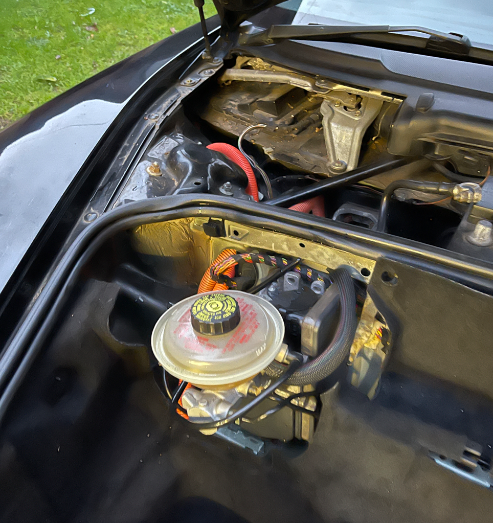

Tesla Gen 1 ibooster installation:
Whilst I installed an ibooster a few years ago upgrading from a UP28 vacuum pump, I wanted to update this thread as I’ve improved the installation solution.
Here’s the first iteration whereby I offset the fluid reservoir position.
I was never happy with this solution, running hoses from reservoir to cylinder, however it was necessary as neither the Tesla or Porsche reservoir fitted when mounted directly – they were too high fouling the bonnet. Moreover, because the OE brake lines ran in front of the Ibooster the frunk cowling didn’t fit over it and made the whole thing look very ugly:
I haven’t changed how the ibooster is mounted (its straightforward as the bolt patterns make it almost plug n play for the Porsche).
Here’s a picture of the connection between ibooster and the Porsche OE rod to brake pedal. It is adjustable as the ibooster rest point must be within its calibrated parameters. I used blue Loctite to secure the adjustment bolts once tested and working.
Revised set-up
With this revised set-up I fitted the OE brake lines from the ABS pump to the cylinder from a later car that runs directly to the side of the brake cylinder. To overcome the reservoir fouling the bonnet when closed, I found some lower profile rubber seals that attached the reservoir directly to the cylinder. Look how clean the installation is compared with my first iteration.
For obvious reasons, power and ground cables must be properly installed and robust!
Final picture with the cowling refitted.

I did some research as I am also converting a 986. How deep did you dig into the fuel gauge? It seems like the fuel gauge is calculated by the resistance of the tank sensor and the "fuel consumed" CAN bus message sent by the motor controller. If they are out of order they can be recalibrated by PIWIS / DURAMATIC. Would mean you have to emulate the resistance and the can messages in paralell. Did you ever try this before resoldering?
For calibration:
The factory calibration procedure is to use 28 liters (7.3 US gallons), not 13 liters. It is also important that the fuel tank is completely empty before starting this procedure.
"Calibrating fuel level sensor system
1. Disconnect the battery and cover terminal or battery.
2. Remove cap over the fuel level sensor system.
3. Remove fuel level sensor. Removing and installing fuel pump.
4. Using a fuel extractor, completely drain the fuel tank through the fuel level sensor opening.
5. Make sure that the two recesses on the left and right hand sides of the tank are emptied completely.
6. Reinstall the fuel level sensor and, with "ignition off", fill the tank with exactly 28 liters of fuel.
7. Perform tank calibration with the Porsche System Tester 2 (PIWIS or Durametric):
- Select vehicle type (911 Carrera)
- Select control modules
- Select instrument cluster
- Select menu item "Tank calibration"
- Confirm calibration
8. The fuel level sensor system has now been calibrated."
