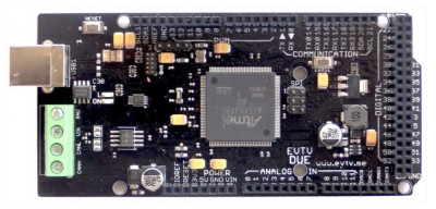

EVTVDue Microcontroller for $100 bucks, think of it as thanking them for SavvyCAN
OR, get their dual channel board
1 CANKIT - CANbus kit with Microcontroller and Cable for $150 bucks
cause you will spend that much to roll your own as this is the only decent shield like CAN adapter for the Due board COPPERHILL TECHNOLOGIES Dual CAN Bus Interface For Arduino Due With Extended Power Range and runs $50 bucks alone

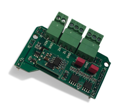

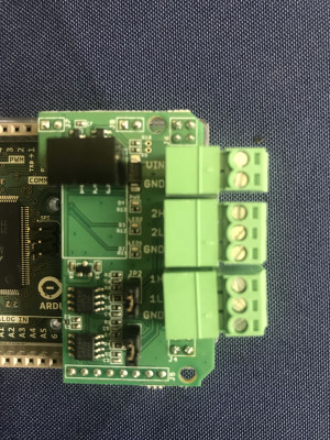

so I plan to use this COPPERHILL TECHNOLOGIES Dual CAN Bus Interface For Arduino Due With Extended Power Range doodad to control my first gen Chevy Volt onboard charger (yes the VCU can run the code to charge it but for Phase I, I prefer to have some isolation)
Initial thoughts, I know this is a dual CAN piece of machinery so I was wondering what the third smaller green connector was for and it appears as though it is for power, ie 7-36 volts DC and ground, well why didn't they just pull the power from the Arduino Due "mother board" why do I have to supply separate power to this animal?
Looks like they Uno reverse carded us:
"In order to more efficiently serve automotive and industrial applications, the JCOM.CAN.DUE-X board supports an extended input power range of 7 to 36 VDC to power the entire system, i.e. including the Arduino Due itself."

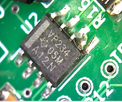

I had two surprises regarding CAN transceivers, and these are totally unexpected, so I will share here:
1. I ordered some SN65HVD234 CAN transceivers from Aliexpress, use them according to the data sheet with Enable pin connected to 3.3V. And what they are doing? They do not drive the CAN lines to a dominant level, they just mirror back on RXdata what the controller sends on TXdata. Means: Some kind of loopback mode. According to data sheet, this type should not have such a mode. The only explanation which I have, is, that they sell wrongly labeled parts. By pulling the EN pin to ground they work.
2. I ordered the cheap CAN transceiver boards from Aliexpress, they contain a SN65HVD230, and a 10k resistor between pin 5 pin 8 and ground. This looks good, it should enable the slope control. But what does the board? It routes the traffic from CAN to CANRX, the controller tries to send the ACK bit on CANTX, but the device does not send the dominant levels on CAN for the ACK. The device is in some kind of "listen only" mode. This is not according to the data sheet. I tried the "strong pull down" (grounded) on the pin5 pin8, and with this setup, the transceiver works as intended.
My conclusion: It is possible to spend a lot of time searching at the wrong place. Nothing works, and at the end it is just a wrong IC. Measuring the lines with an oscilloscope (two channels are sufficien) is from my PoV the only way to find such an issue.

@uhi22: Did you test those faulty SN65HVD234 aliexpress chips on polarity of Enable pin? I am interested if they would work with Enable pin floating?
- uhi22
- Posts: 1117
- Has thanked: 206 times
- Been thanked: 618 times
Re: I think I CAN, I think I CAN...
Just tested more deeply. With unconnected enable pin, the communication works. Then connected a multimeter between enable and ground. It shows zero voltage, and still the communication works. Third test, measure the resistence between enable and ground. It is 165kOhms, no matter whether the device is powered or not.
Conclusions: it has an internal pulldown resistor and works fine when leaving the pin open.
This is the strange device: And this is the other from the transceiver boards:

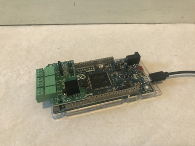

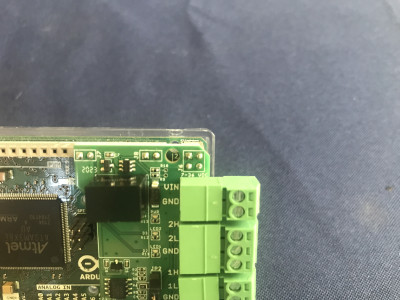

I followed the directions on the OpenInverter Wiki page for CAN bus with Arduino Due (https://openinverter.org/wiki/CAN_bus_with_Arduino_Due) and have reached the final step of closing the Arduino IDE and adding the connection in SavvyCAN. However, SavvyCAN cannot recognize my GVRET-loaded Arduino Due. Interestingly, I am able to connect to the LAWICEL version. First, here is the screenshot of my GVRET (showing not connected):
Then, here is a screenshot showing that the LAWICEL version does show as connected: To get the LAWICEL to connect, though, I have to close and reopen SavvyCAN. This doesn't work with the GVRET serial connection. I should also note that SavvyCAN at least detects that the Arduino Due is connected to the USB port, as it shows up on both the Serial GVRET and Serial LAWICEL menus.
Any thoughts?
Thank you!
In response to my previous post above, I just got it working, but I had to find an older version of SavvyCAN. It works for me, and my mac, on version v199.1. However, it does not work on any of the follow-up versions I've seen on Collin's website (V208, V213, Pre-Release development build from November 2024, and QT6 Development Build from December 2024). Any thoughts as to why not? The website I accessed to retrieve the different versions of SavvyCAN is: https://github.com/collin80/SavvyCAN/releases
