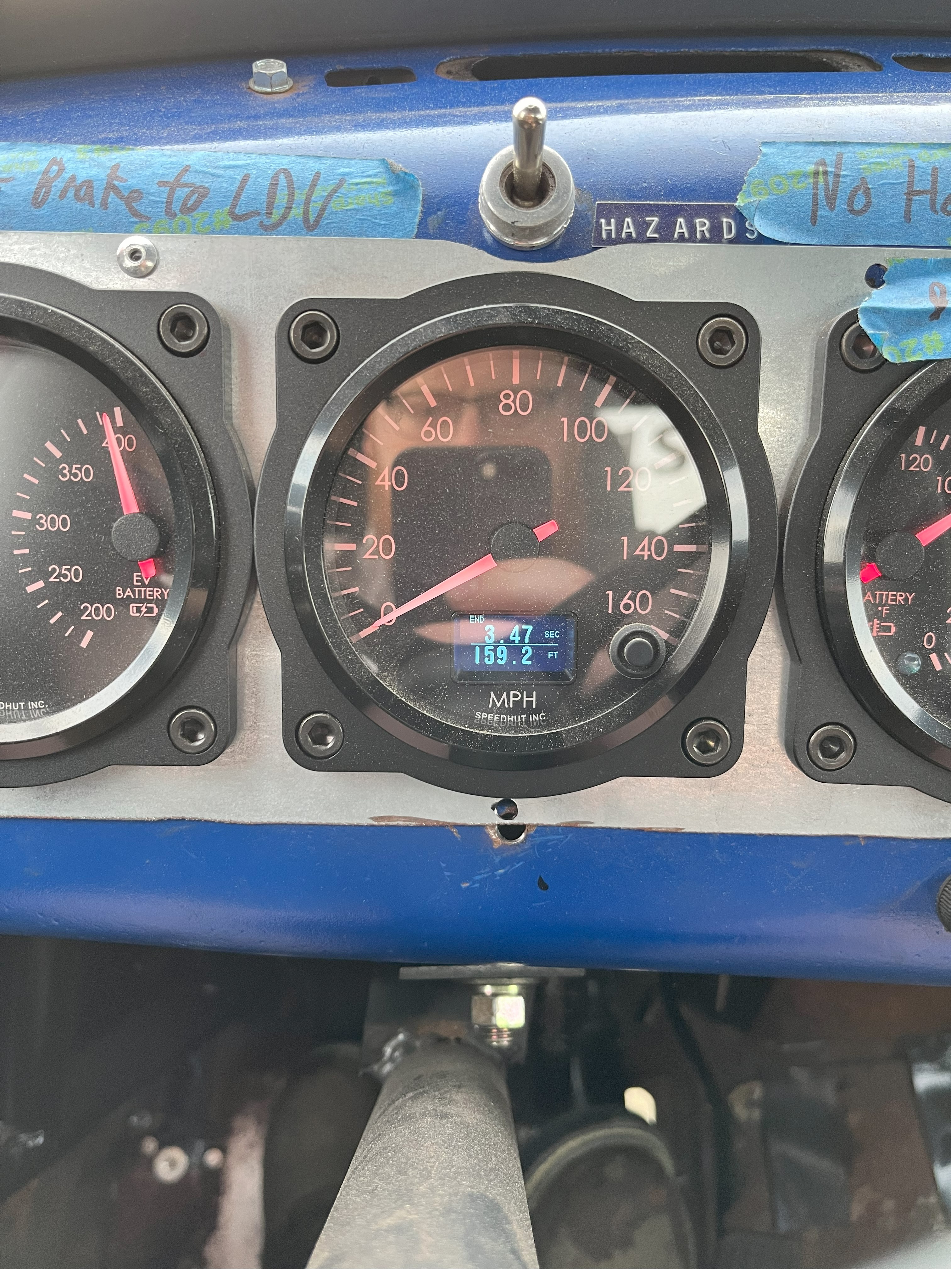

In the scramble to make it to Drag Week, I didn't post much, but now that the event is over, here's the update:
I did get the Bolt charger and DC-DC working, though not exactly how I wanted. I had to cut bait, and just use a PWM generator that I manually adjusted to run the charger. The DC-DC was setup how I wanted, but I discovered an issue; the DC-DC keeps running sometimes when the PWM is removed, so at times it kept the car powered when I tried to shut it off, as an alternator can sometimes do. I've still got to work on that.
I got CCS fully wired and talking to the station, but my board was not providing current requests fast enough for FOCCCI to be happy. I believe I found the issue in my code, but haven't been able to update it (the Arduino IDE on my personal laptop was acting up, and my work laptop was at home). I think the slower pace of the Voltage message coming in was disrupting the current request going out.
The car and it's patched together inverter did great! No major breakdowns (only a rough road shaking some body panels loose), slightly higher efficiency than last year, and good runs each day. I don't know if the terrain, my driving, the dc-dc, tire pressure, tune, or something else led to the higher efficiency, but it did seem closer to 360Wh/mile rather than 400Wh/mile. I need to do more logging to make sure I have that right before saying the range is actually longer.
In terms of performance, I did have two runs trigger the gate driver desat shut down, but 7 runs go cleanly. It does seem that a long burnout reduces the likelihood of a shutdown (maybe from heating the motor?). Best run of the week was an 11.75 @ 114. Some more info on the event is in the thread here: viewtopic.php?p=75187#p75187
Moving forward, I want to get CCS running, get the OBC running automatically, and fix the DC-DC shutdown issue. Plus a few general repairs/upgrades like trunk and window seals. Then its just more tuning and suspension tuning to get the car quicker. I do think low 11s are possible, and maybe even 10s, though that may require a full Sport inverter.

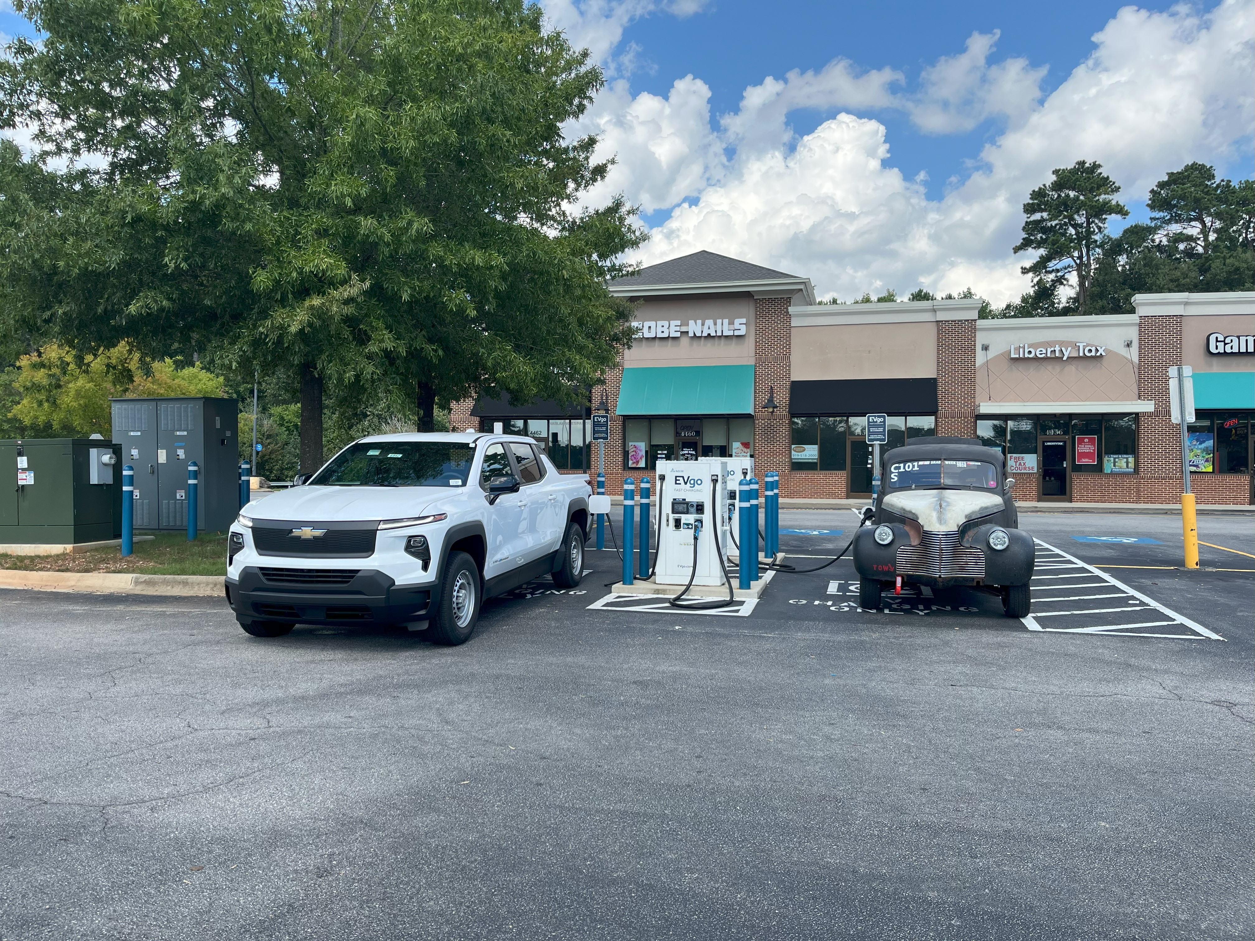

Annndddddd we have CCS!!!
With a few tweaks to my charge curve board's code to make sure that the outgoing messages are sent quick enough for FOCCCI, I completed my first CCS charge today! It's hot and humid here in Raleigh, and I do have non-car things to do, so I only tested at one EVGo charger (made by Delta), but it is working! Next weekend I'll likely do a bit of a charger testing cruise one evening when it's a little less toasty in the car.
I also couldn't help but stop and take some new glamour shots of the car on the way home. It is so good to have her back on the road, and now with even more functionality!

I spent all afternoon and evening on Saturday playing with the '40. This included charging testing, efficiency testing, acceleration testing, and simple cruising.
First, I tested my new CCS charge curve. I'm fairly happy with it, but it ramps down a bit too aggressively so I sat at 25kW and 8kW for a long time on a 100kW charger. But doing a stepped ramp worked better than a linear one, and reporting SOC in 10% intervals seemed to make the station a bit happier.
Then, I did an efficiency test. From the charger I was using to test, there's a good stretch of road that is very similar to the routes we get sent on for Drag Week (4 lane divided with stoplights every couple miles) that ends in a small downtown area about 13 miles away. So I drove there, got lunch, and drove back to the same charger, and charged to full again. In total: 27.3 miles consumed 10.235 kWh, meaning 2.67 mi/kWh or 375 Wh/mi. Assuming that the pack retains the energy capacity it had the last time I did a zero to 100% charge of 28kWh, that means a max range of 74 mi. I'm saying it has a safe range of 65 mi, given that I really don't want to push the battery that low.
I went home for a bit to handle other things, and then took her back out. First stop: acceleration testing. I remembered that the GPS speedo I put in the car has a 0-60 timer built in. Well with the "street" tune in it, which is what ran 12.1 sec in the 1/4 all week at DW 2024, it pulled a 3.47sec 0-60. And did it twice in a row.
Then, I headed into downtown Raleigh to grab some dinner, BBQ with a Cheerwine (NC based cherry soda).
Then I did some cruising around downtown and over to one of my favorite parts of the city, Dorothea Dix Park, before heading home for the night.

Re: [DRIVING] 1940 Chevrolet with Tesla Motor
Sounds like a nice day out
Just had to check, the Model S P85 that your motor would come from(?) is 4.4s 0-100kph. Nice work!
- Posts: 1081
- Location: Raleigh, NC, USA
- Has thanked: 235 times
- Been thanked: 278 times
Thank you!
The current drive unit is a base, or actually a base hybrid (2 base phases and 1 sport phase) from cramming to get ready last year. So Model S 85. I'm hoping to move to a full Sport inverter from the P85 at some point this spring, depending on budget, mostly.
It is significantly lighter than a Model S. With me in it on DW2024, it weighed in at 3510 lbs (1592kg). And most of that weight is right over the rear axle, so no traction limitations.
I'm cooking up an idea for a future car that takes a Plaid drive train and puts it in something really light - hoping to have the money to start on it late this year. It appears the Plaid inverters share the basic design of the Model 3 inverter, so Damien's board might be usable to enable those shenanigans.
