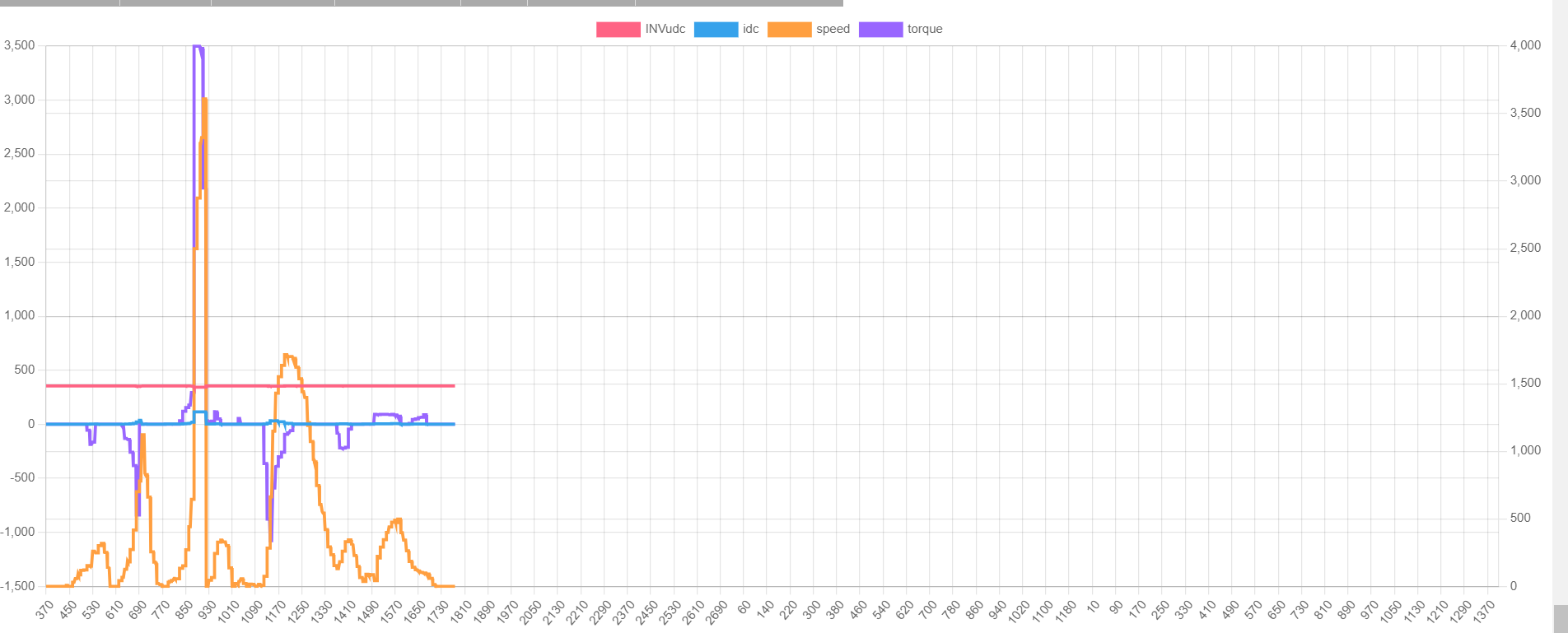

I got the data logger to work though it stopped after 24 seconds but the torque spikes at each end are curious

Did your log cover a torque cut?

weirdest thing, I've just done 3 runs with the data logger and everytime it cuts the data logger stops

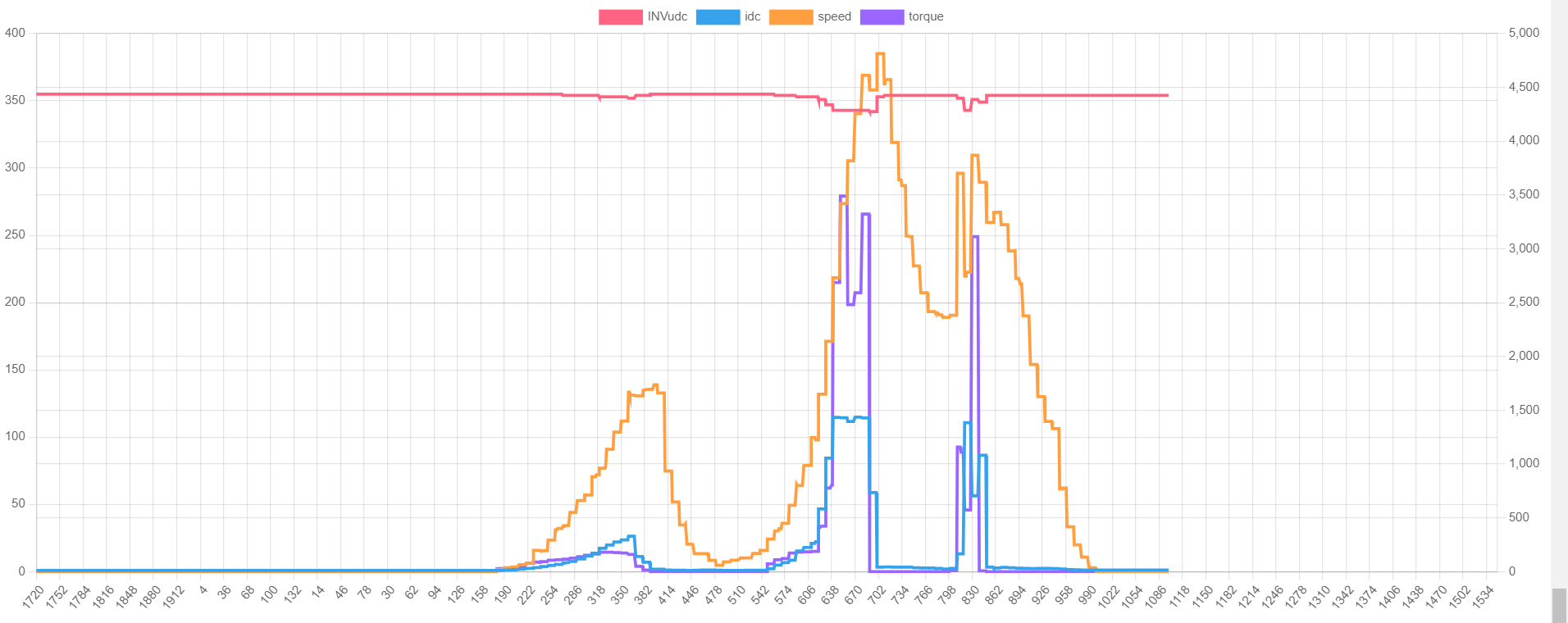

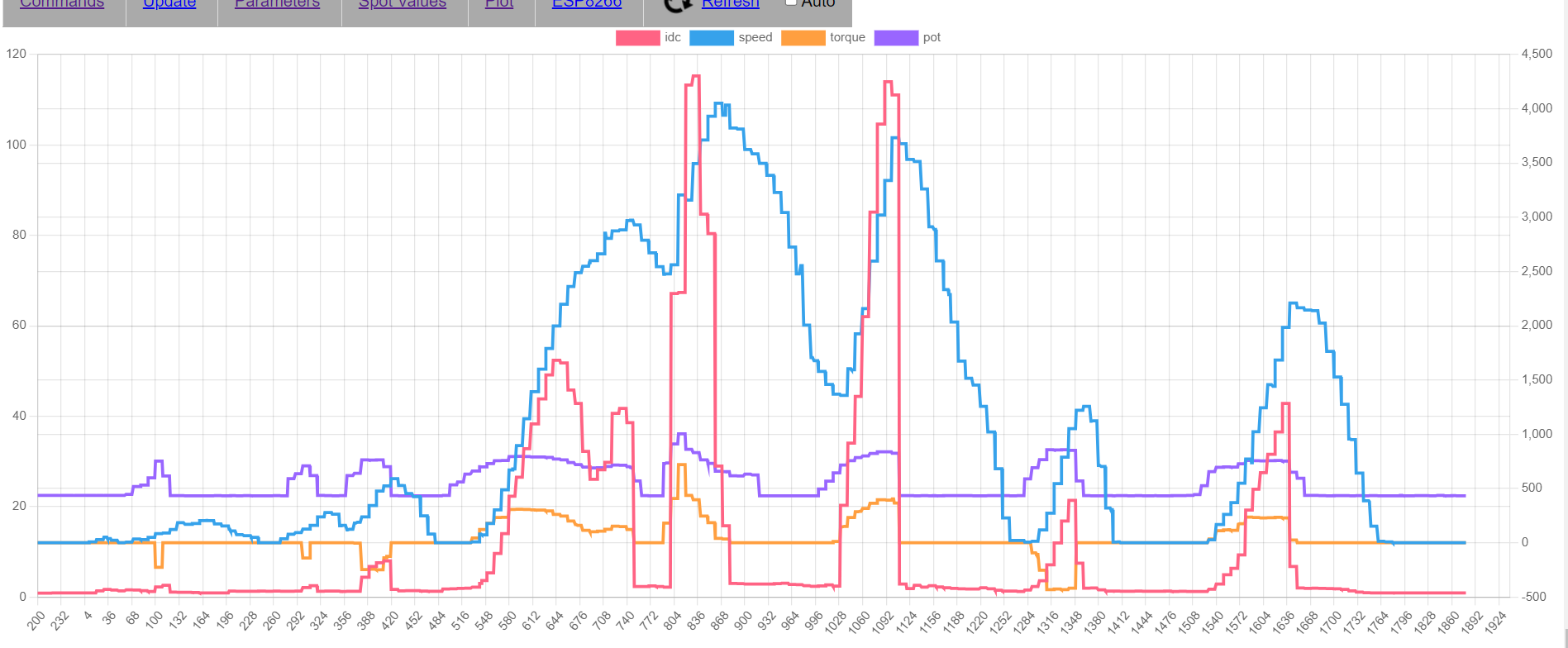

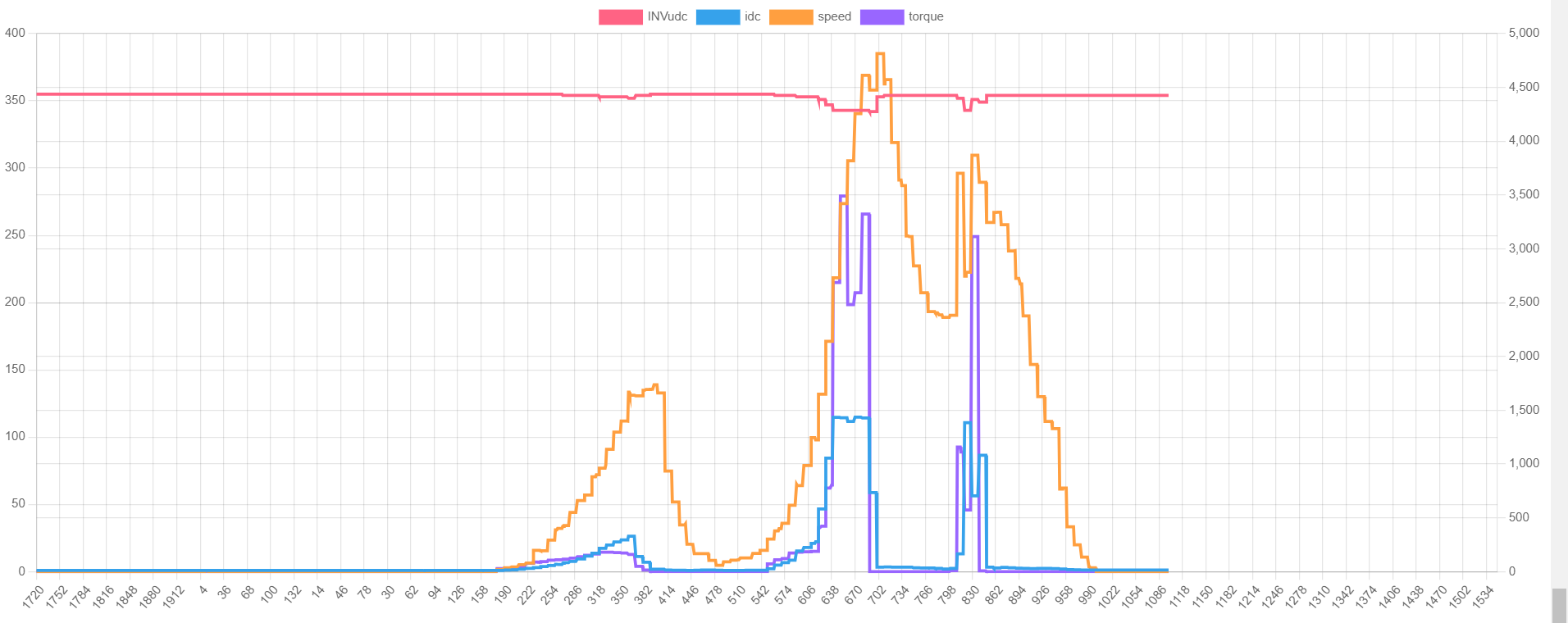

Thanks to Jamie coming through with an updated Bin making up for my shortcomings we have some more data from the l210 with is300h inverter
I'm pretty sure I'm no longer getting the harsh cut but the car is juddering a lot due to my bad choice of mounting the entire motor to gearbox coupling, but current still max's out at 120 Amps

I'm going to pull out the L210 to fix the coupling to lock the input shaft solid hopefully at the end of the week so if anyone wants me to do any runs before that to get specific data let me know hopefully the l210 wil be out and back in quickly but sods law say's something will slow me down or get in the way you know the way it is. :)
