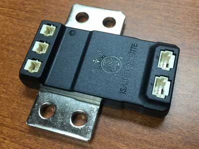

larsrengersen wrote: Thu Oct 29, 2020 4:10 pm
Jack Bauer wrote: Fri Oct 16, 2020 3:06 pm Brilliant! I'll be in touch to order two and I'll pop the controllers in the webshop so hopefully will generate more orders from that.
An update on the signup.
Assume you will be opting for the 1000A version Damien?
Other signups are
1x 500A
1x 1000A
So not very much.
I'll be away for a week and then I'd like to close the group buy round on November 10th and place the order.
I want to sign up for 500A unit. Which one should be used with the developed controller - CAN 1.0 or CAN 2.0?

larsrengersen wrote: Thu Oct 29, 2020 4:10 pm I'll be away for a week and then I'd like to close the group buy round on November 10th and place the order.
So back in town and I have e-mailed everybody. Did you join and not receive an e-mail, please check your spam folder and send me another e-mail. Tomorrow 10th of November 18:00 Amsterdam time I'll close the round and will proceed to ordering.
In parallel while awaiting delivery from ISA I will finalize the discounts and add the shunts and connector kits to my webshop.
Then I'll create discount vouchers and send them individually by e-mail so you can place the order online (payment via paypal) so the whole process of creating shipping labels and administration goes via my automated system.
Posted: Mon Nov 09, 2020 10:21 pm
by larsrengersen
And to make sure everyone is on the same page in terms of what we will be getting. It's
a) The 500A = IVT-500-U3-I-CAN2-12
b) The 1000A = IVT-1K-U3-I-CAN2-12
So this means:
- 500A or 1000A nominal
- 3 channels (probably will not be used in most setups, but perhaps gives more flexibility in the future)
- No CAN termination (it's easier to add if needed than be stuck with it if you don't)
- 12V nominal
Update: wrote earlier that the non 3-channel version might be an option but it is not so 3-channel it is (thanks Damien for your input).
Posted: Wed Nov 11, 2020 10:08 am
by larsrengersen
Ok, guys, I have placed the order at ISA and received an update on price and availability.
The good news is there is a discount and the 1000A is in stock. The bad news is the 500A is not in stock.
I have chosen to split the order into two shipments.
The 1000A is expected to arrive at my place in a week, the 500A is expected in the first week of December.
The discount I can provide for the 500A = 29,30 and for the 1000A = 23,62
I have rounded the 5% kickback for Johannes and Damien to 10 per shunt. So the 500A is overpaying a bit, but these got more discount.
So that means:
500A = 192,15 + 6 for the connector kit = EUR 198,15 ex VAT
1000A = 208,42 + 6 for the connector kit = EUR 214,42 ex VAT
Obviously they cost more in my webshop so I will individually e-mail vouchers so you bottomline pay the above price (+shipping).

The 1000A IVT's are in and the connector kits are ready.
I have e-mailed the people who have ordered the 1000A version and provided a voucher so you pay the above price.
I have dedicated stock reserved for the group buy so you can place a backorder (if the shop says there is no stock) and I will be able to ship yours out.
Posted: Thu Dec 03, 2020 8:39 pm
by larsrengersen
Another update. There is good news and there is bad news.
Let's start with the good news: the 500A shunts are in
The bad news: I've shipped the wrong connectors with the 1000A orders :(
I've been bouncing around with the connectors before. Do we need 5, do we need 6?
Turns out I've been mixing up datasheets and models.
The old model has 6 connectors and uses JST.
The new model has 5 connectors and uses Molex.
And I've bought a bunch of JST not realizing the new ones need different ones.
Will dive into it and get back to you with a solution (refund/extra delivery/....).

larsrengersen wrote: Thu Dec 03, 2020 8:39 pm Another update. There is good news and there is bad news.
Took a while since the small connectors were out of stock everywhere but I have a few now and will contact the people who signed up for a 500A IVT and send the correct connector kits to the 1000A orders that were already shipped.
