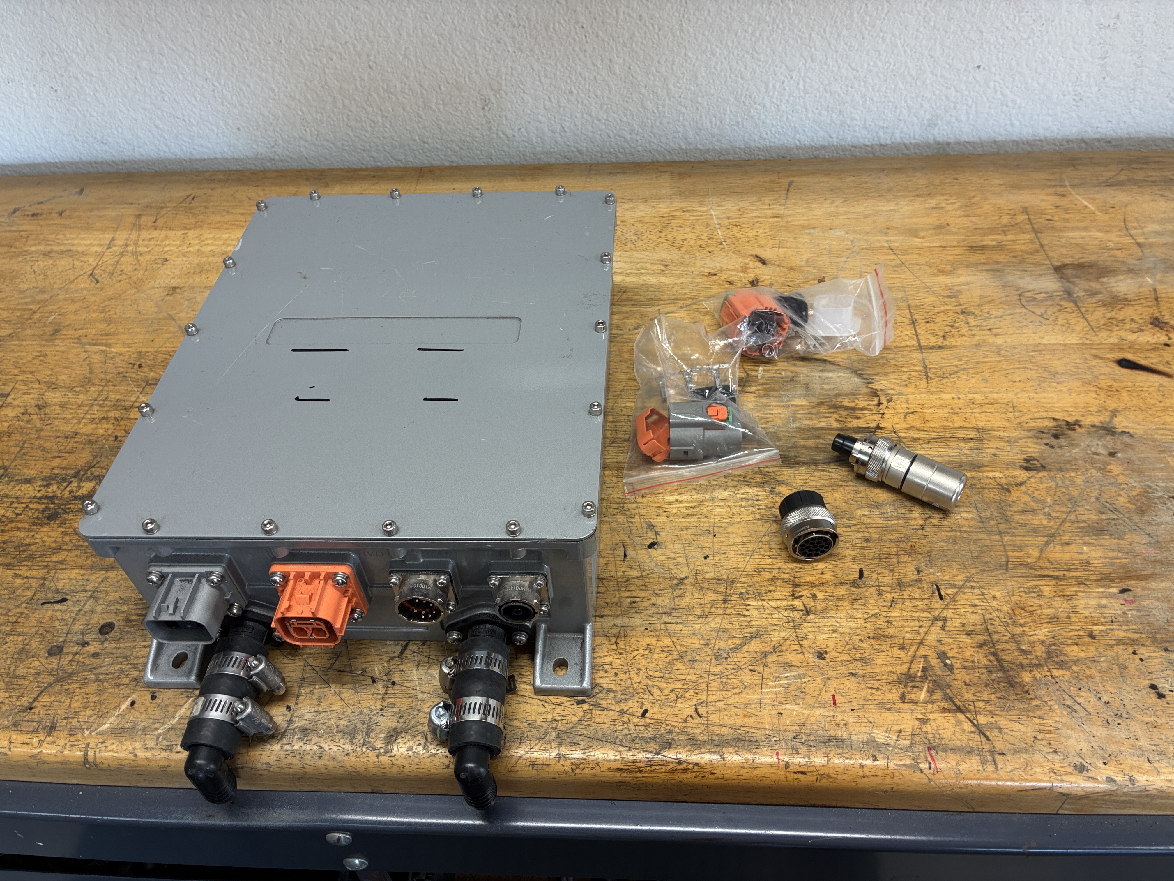

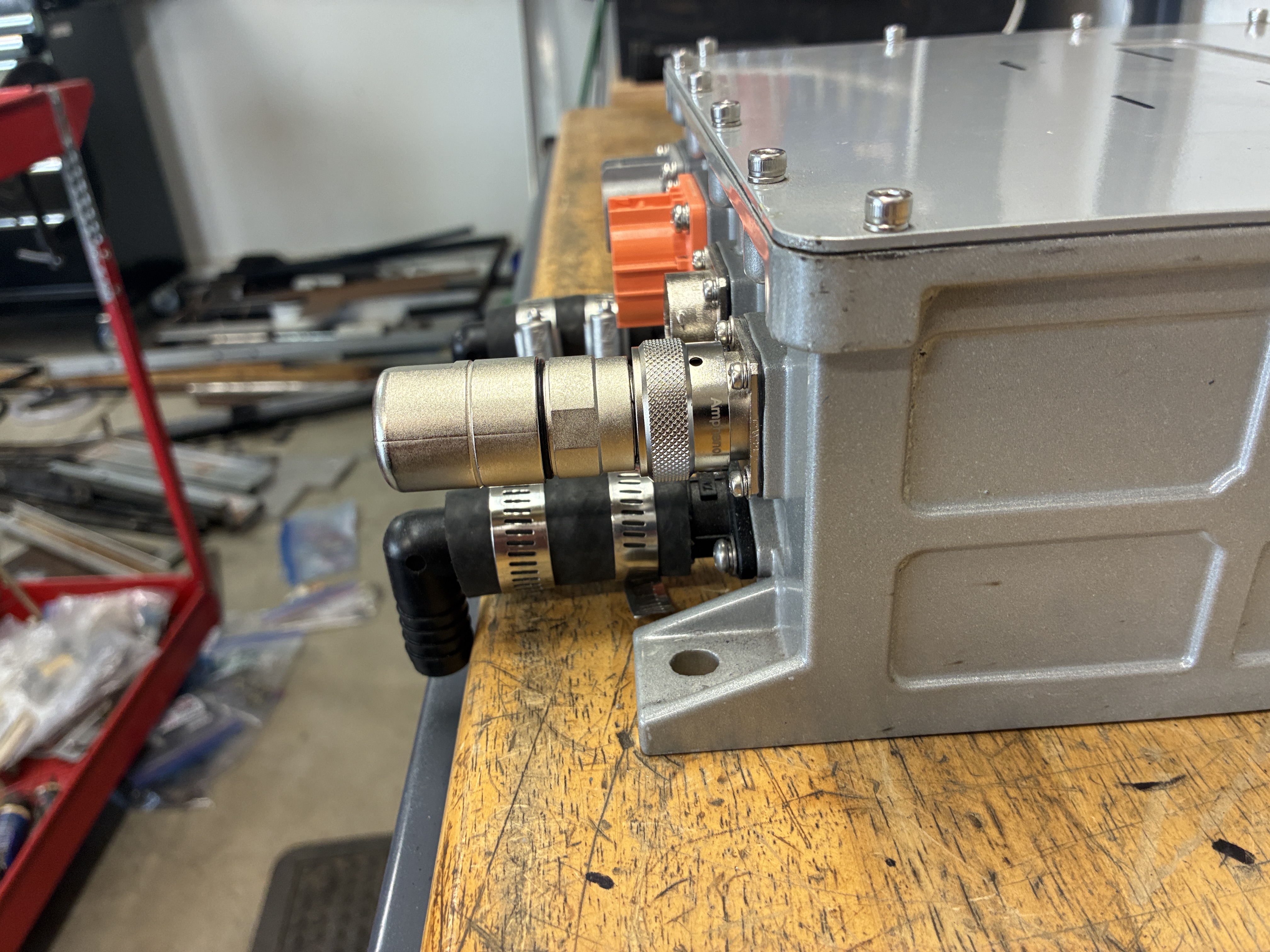

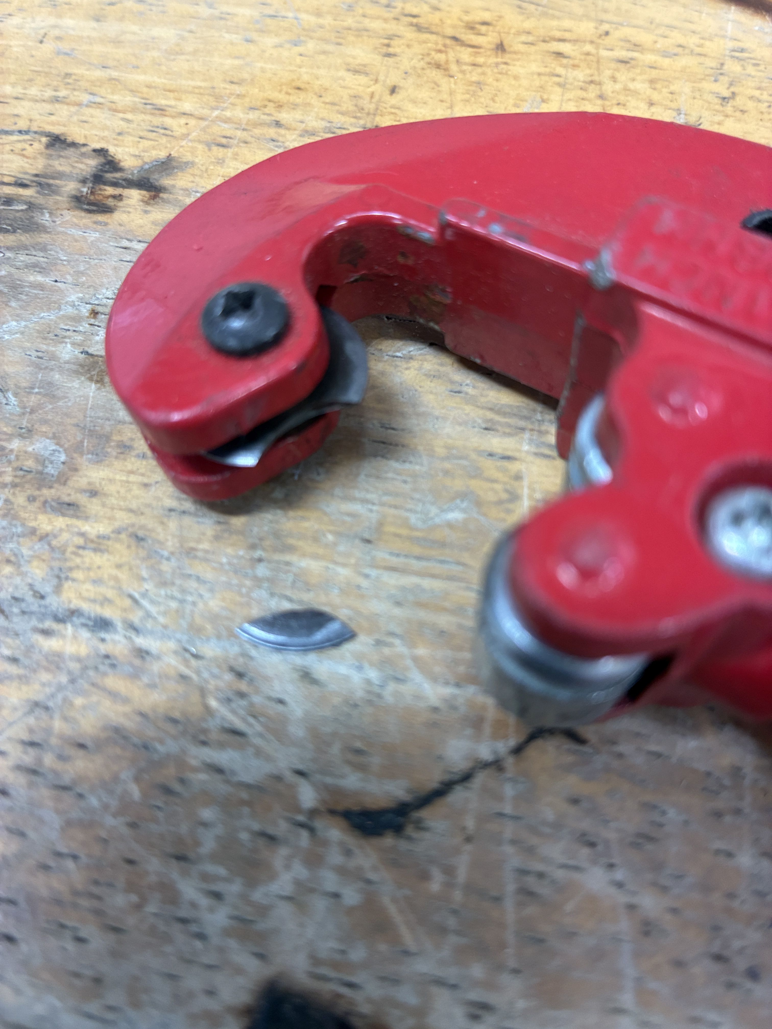

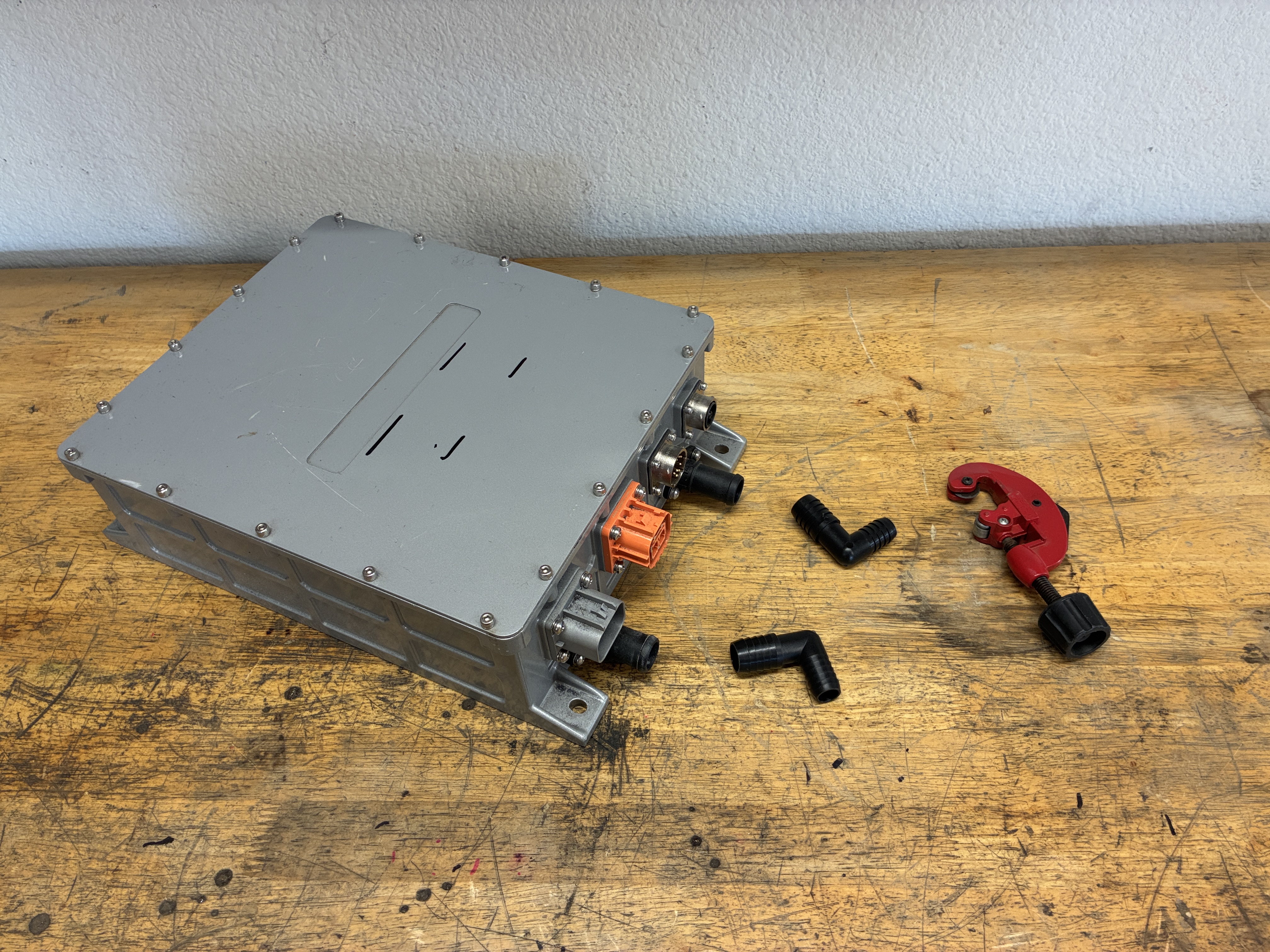

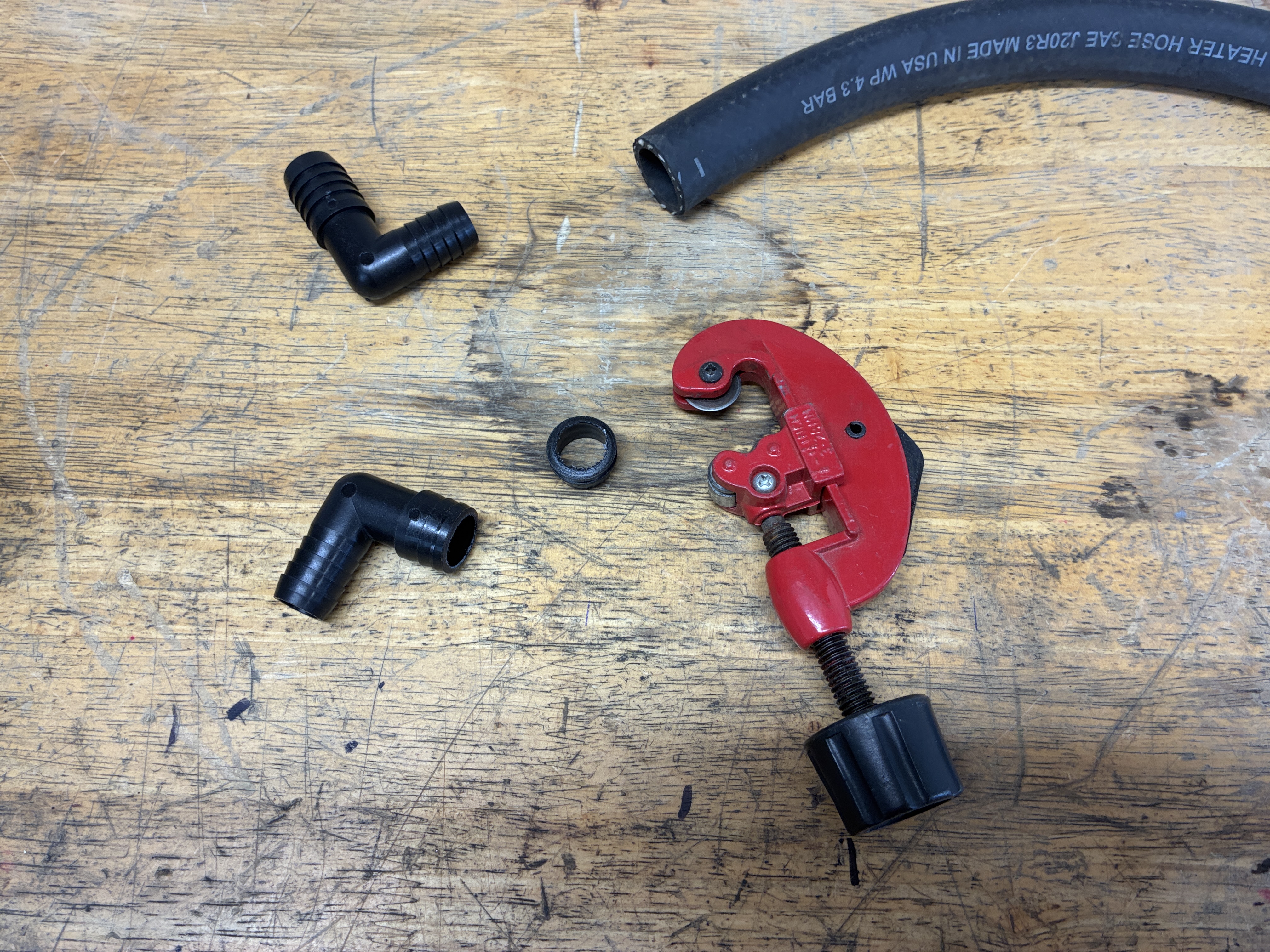

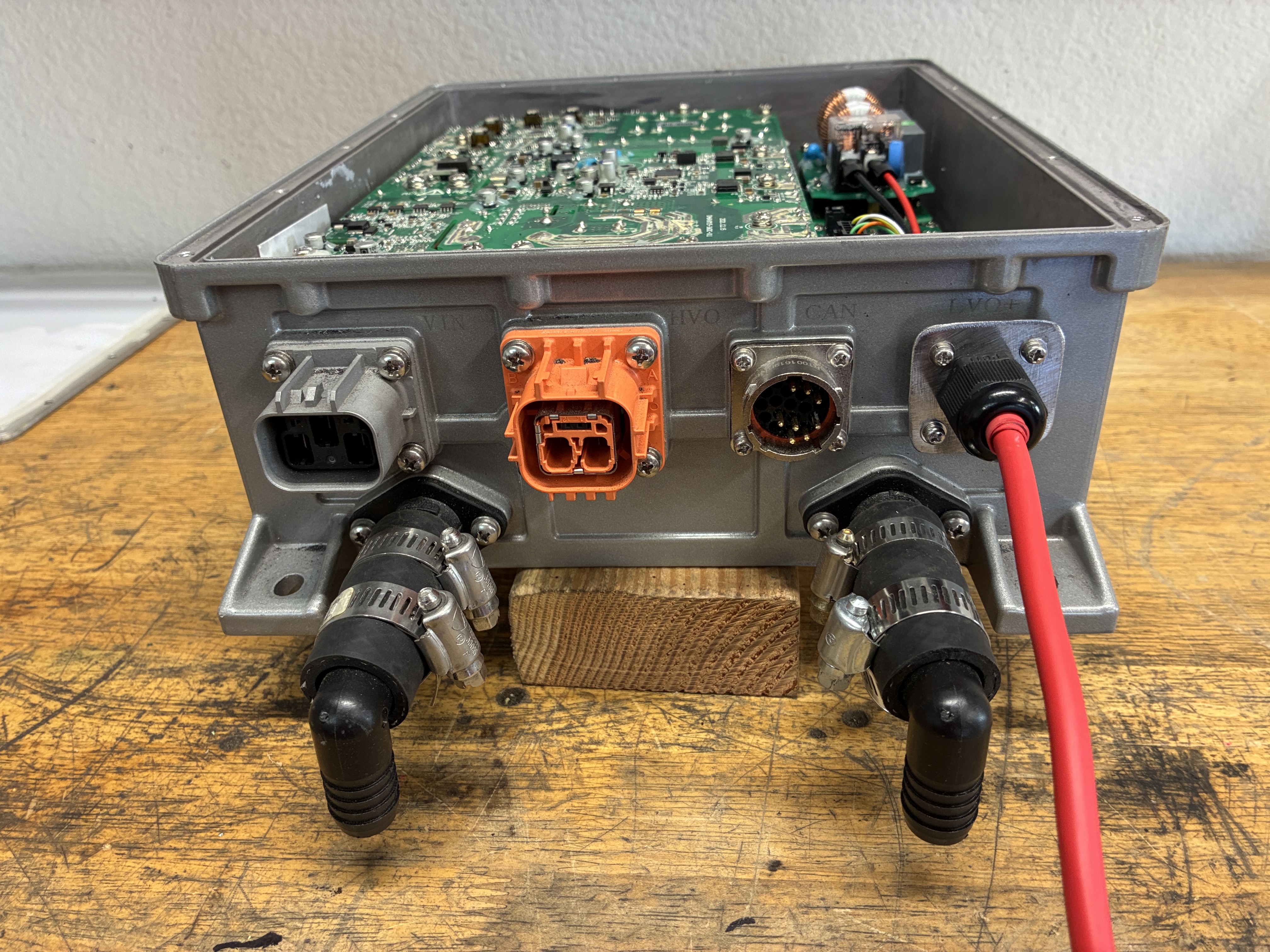

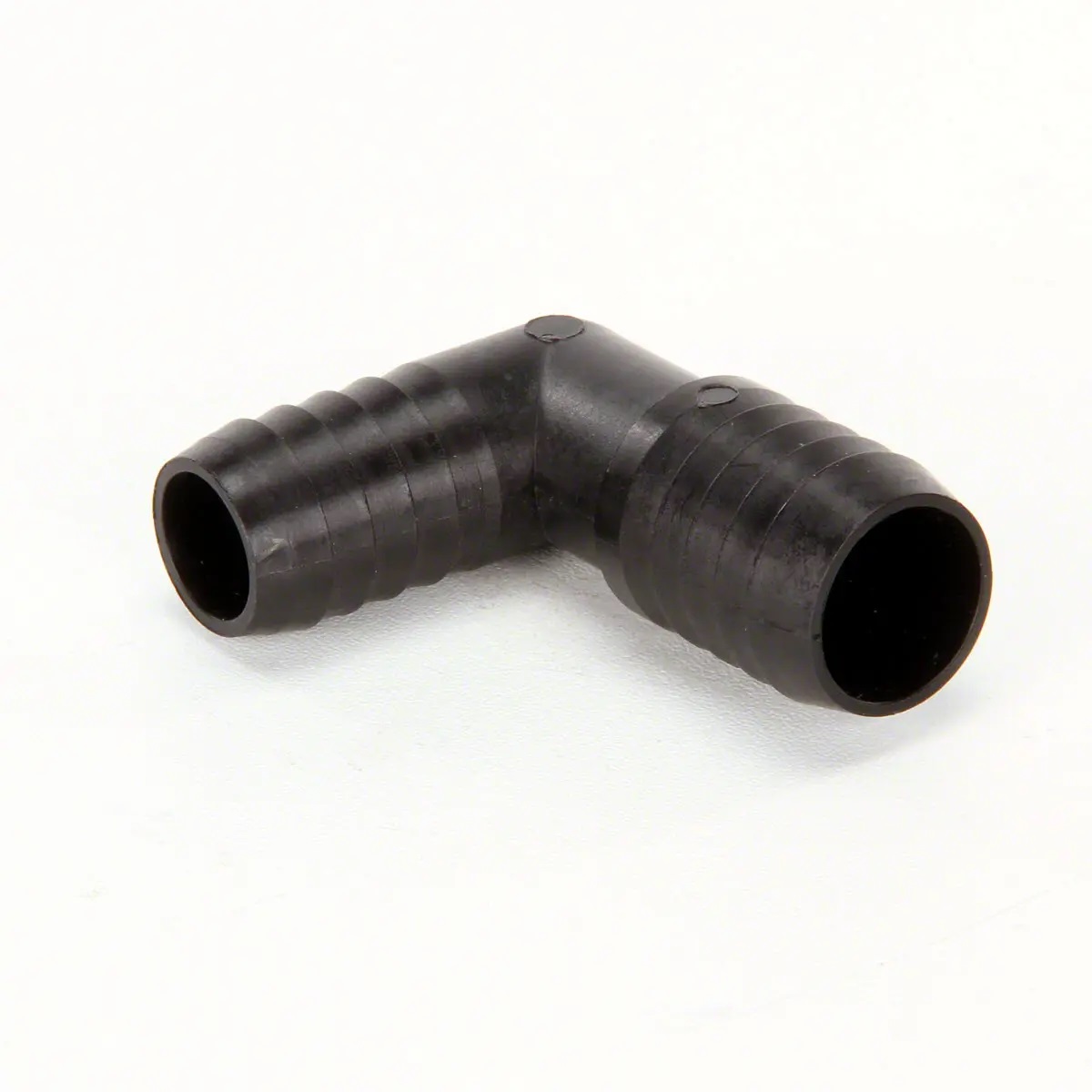

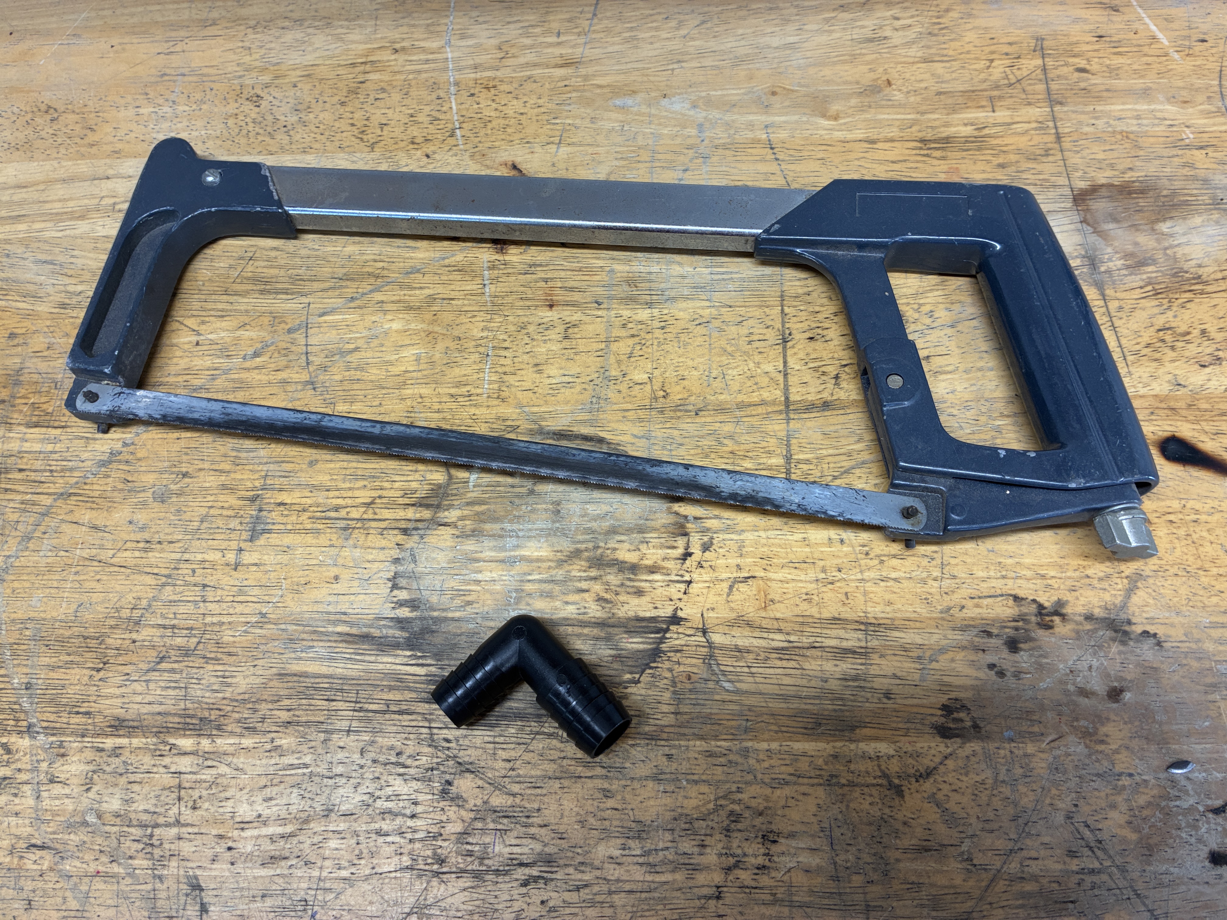

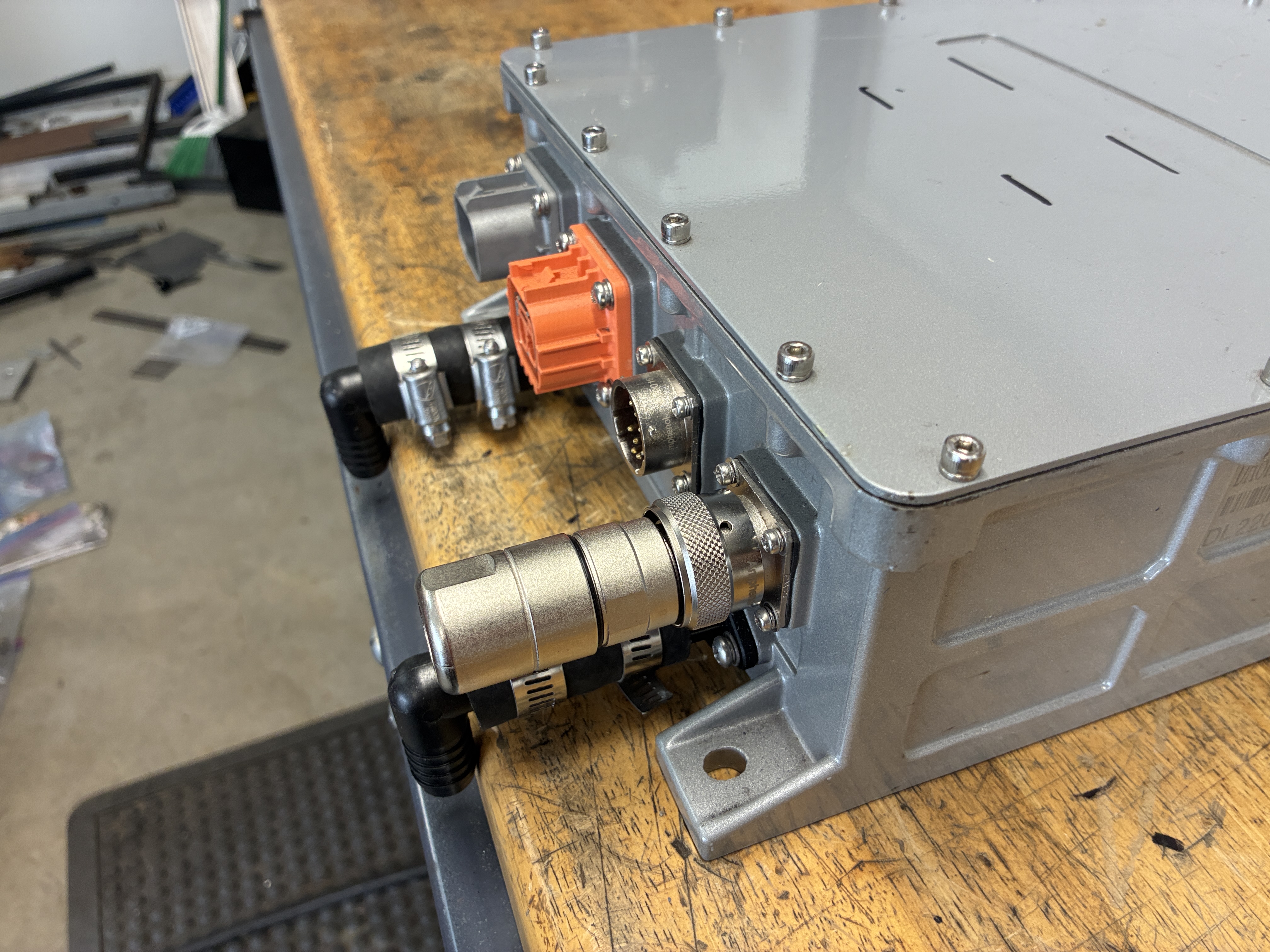

one of the things I don't like about this Ding Dong charger is that it's cooling ports are closer to 3/4" so slightly larger than all the other components (inverter, radiator, water pump) which have 5/9" ports, so I needed to order some reducers and since space was tight they had to be elbow
Hypro 3/4" Hose Barb x 5/8" Hose Barb Poly Elbow Fitting
https://www.spraysmarter.com/hypro-3-4- ... yGWJsbVxDD

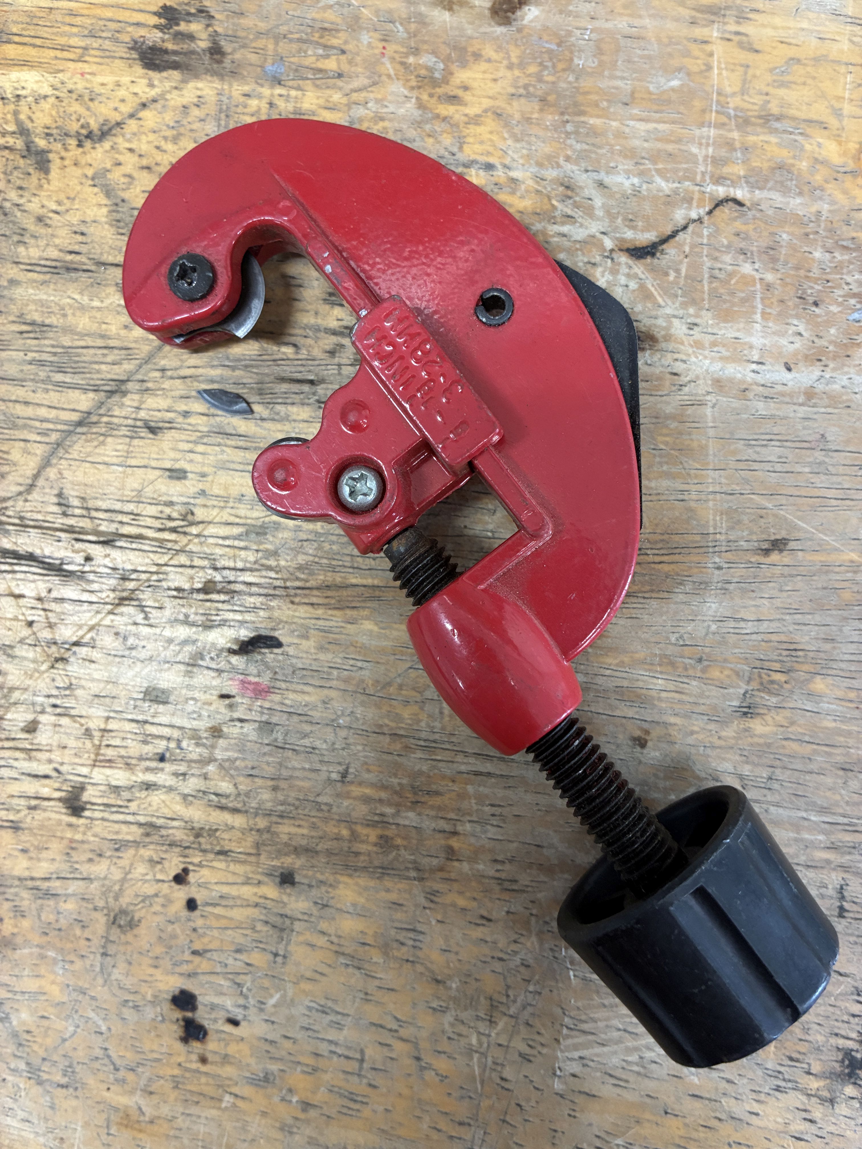

and so the elbows had to be shortened, thank goodness for the extra rows of barbs

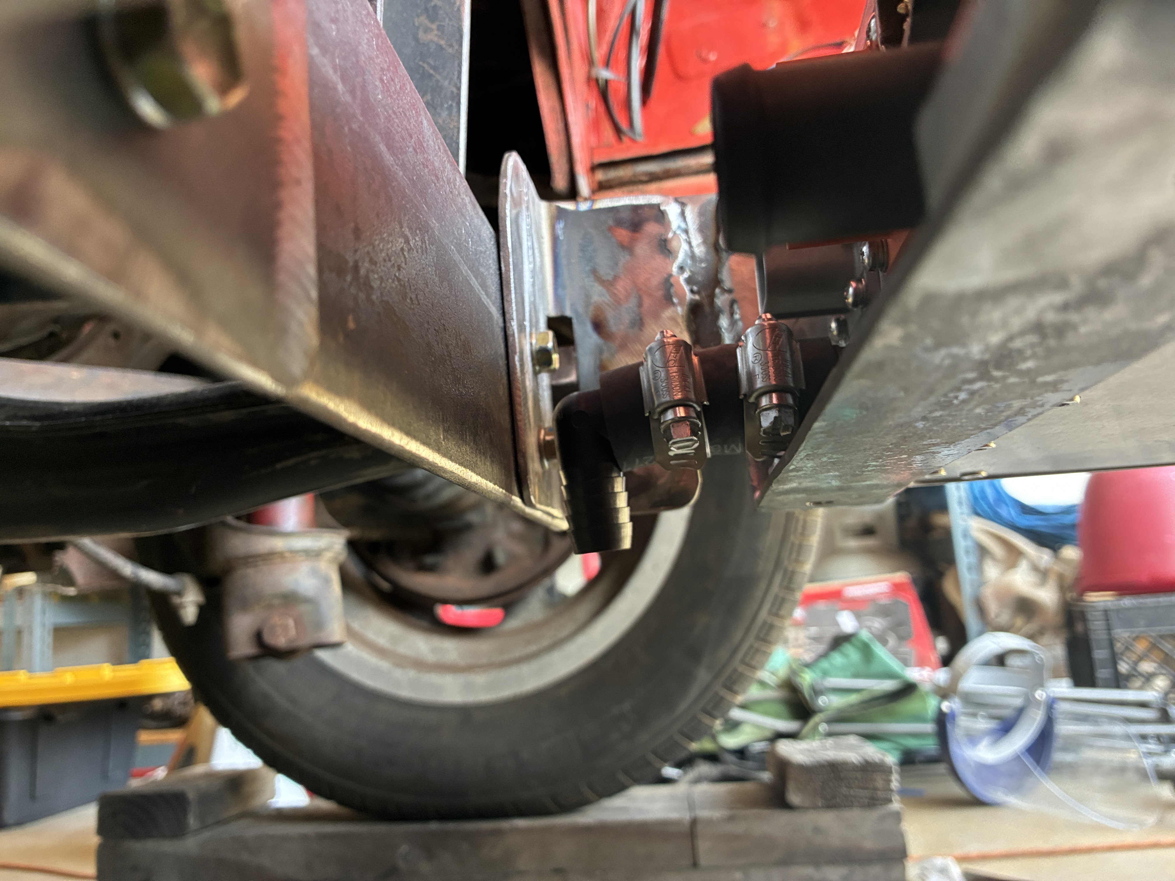

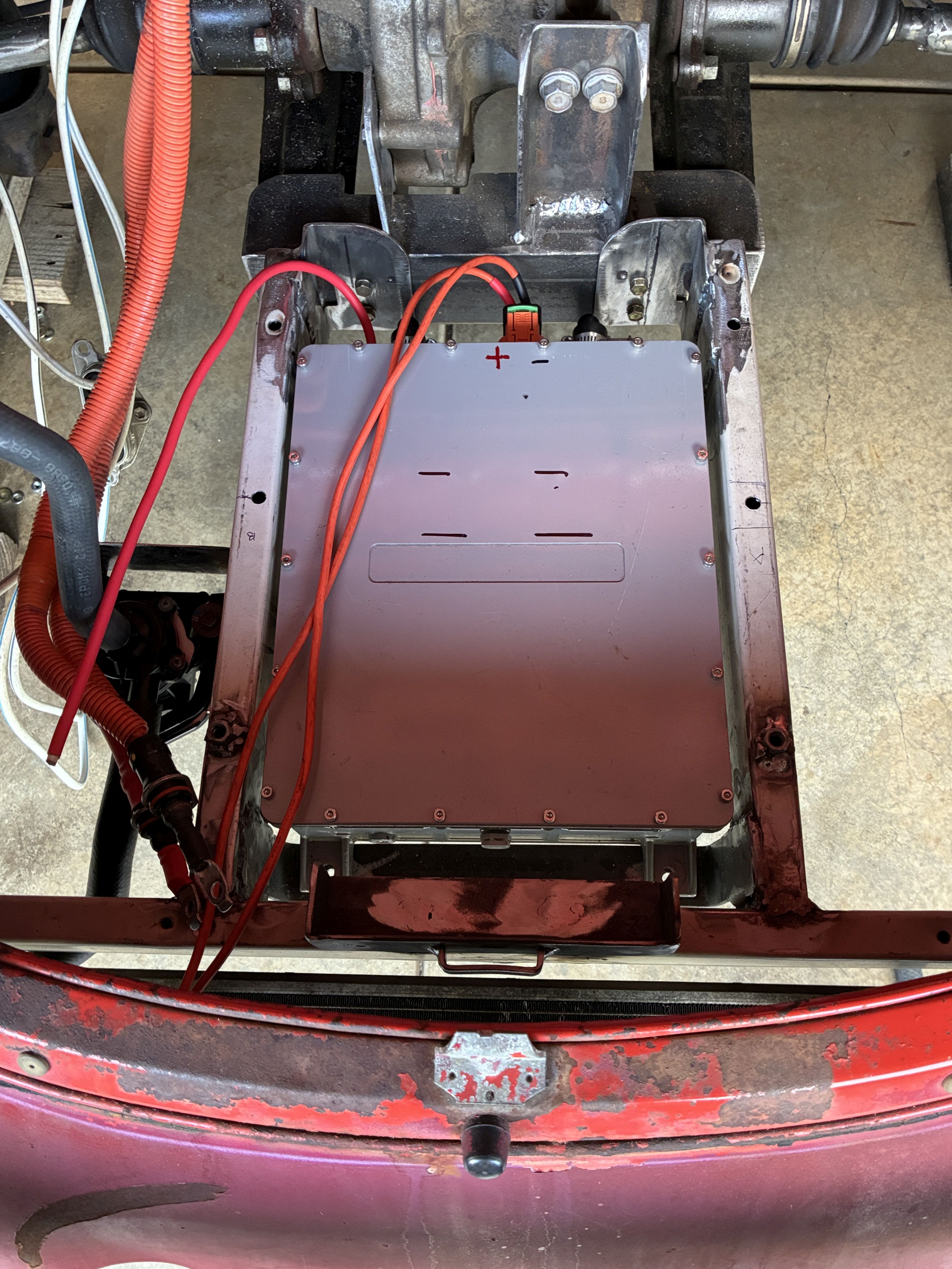

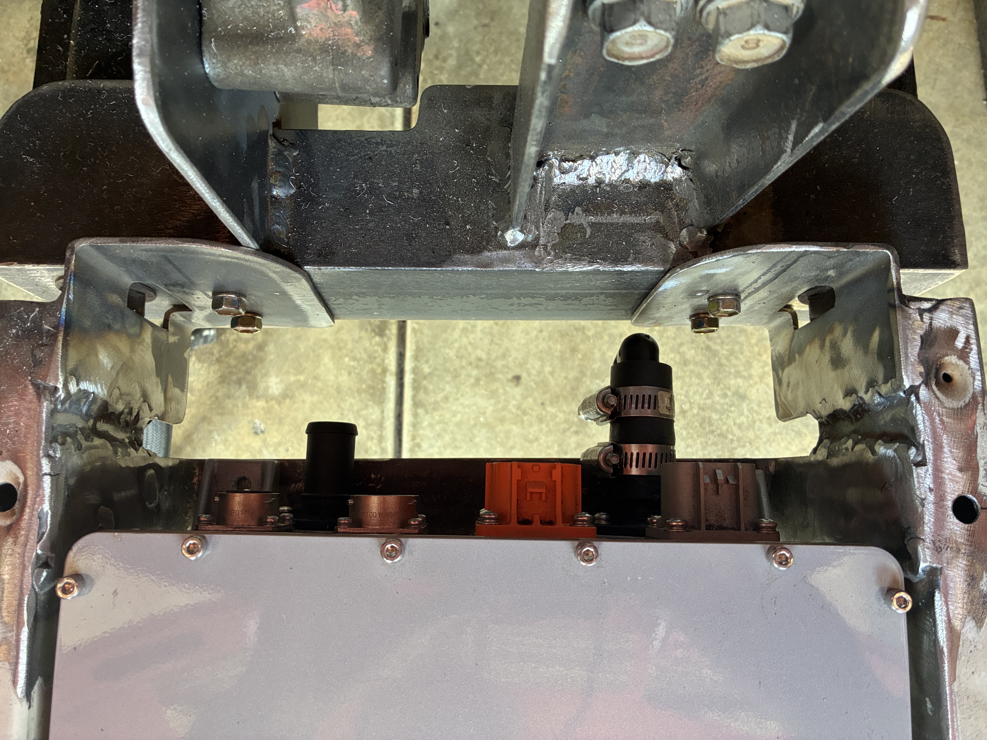

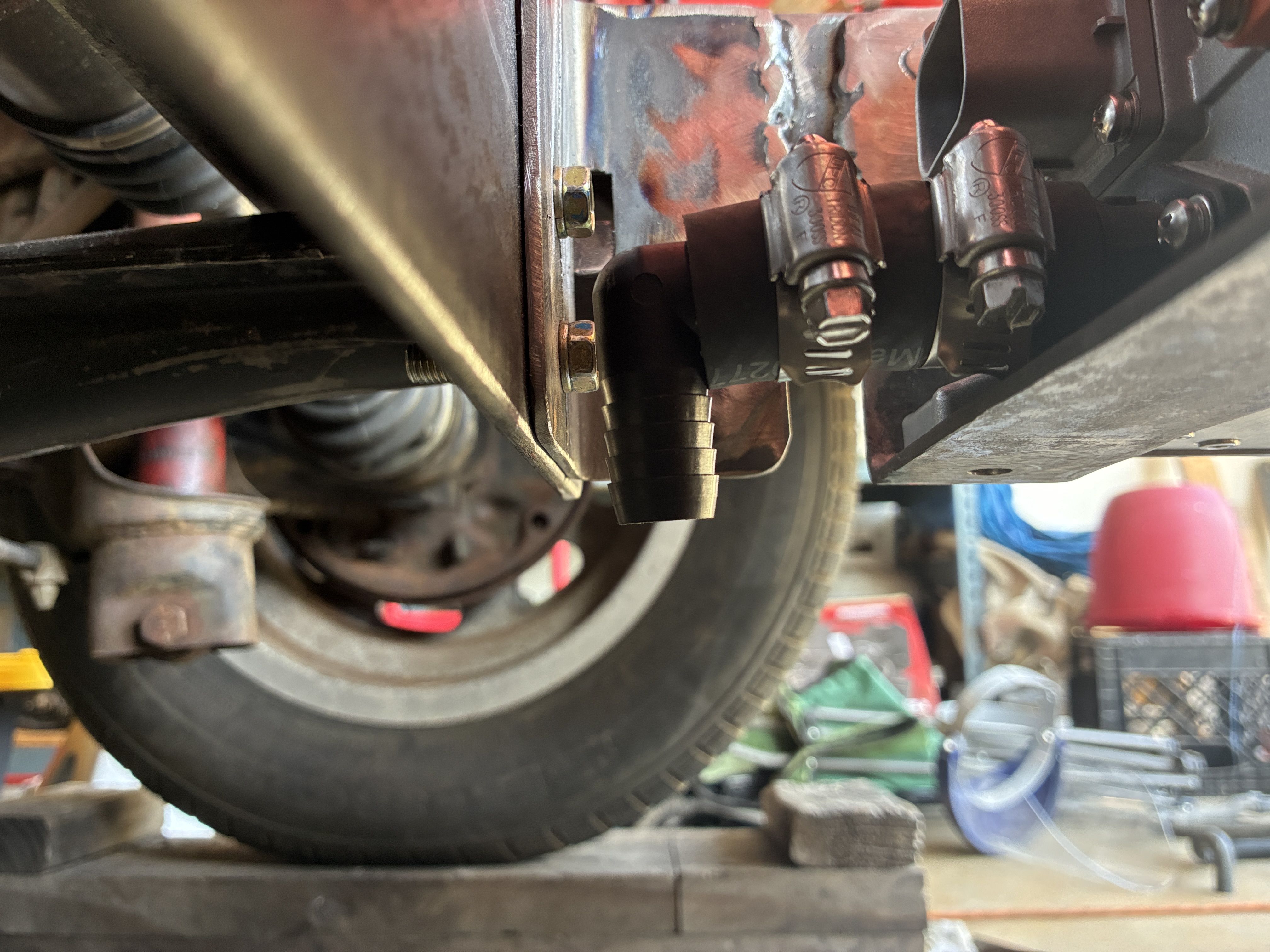

and let's see how that fits... good enuff for the girls we date!

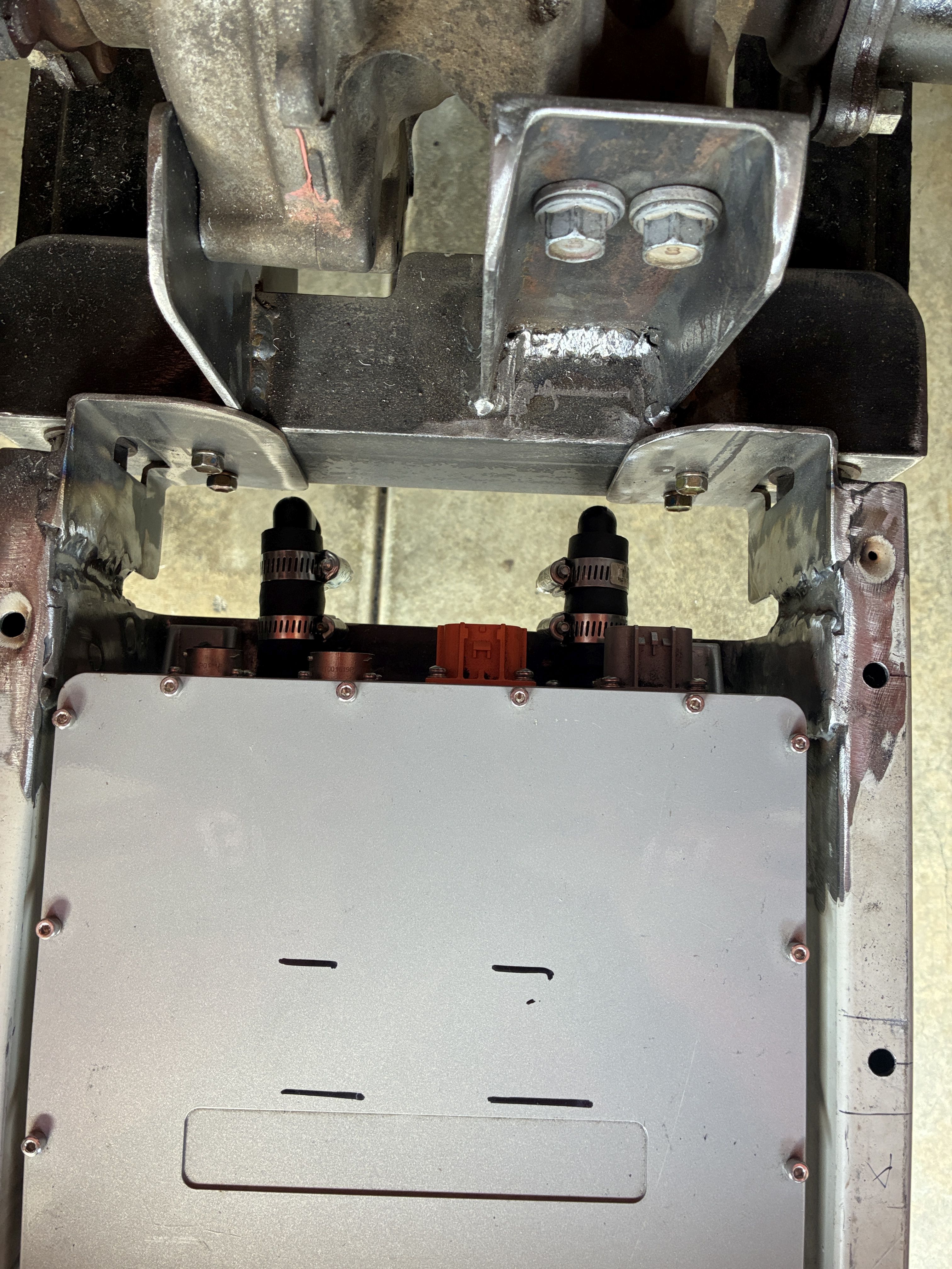

The Greg did not even skip a beat...
and we have clearance Clearance

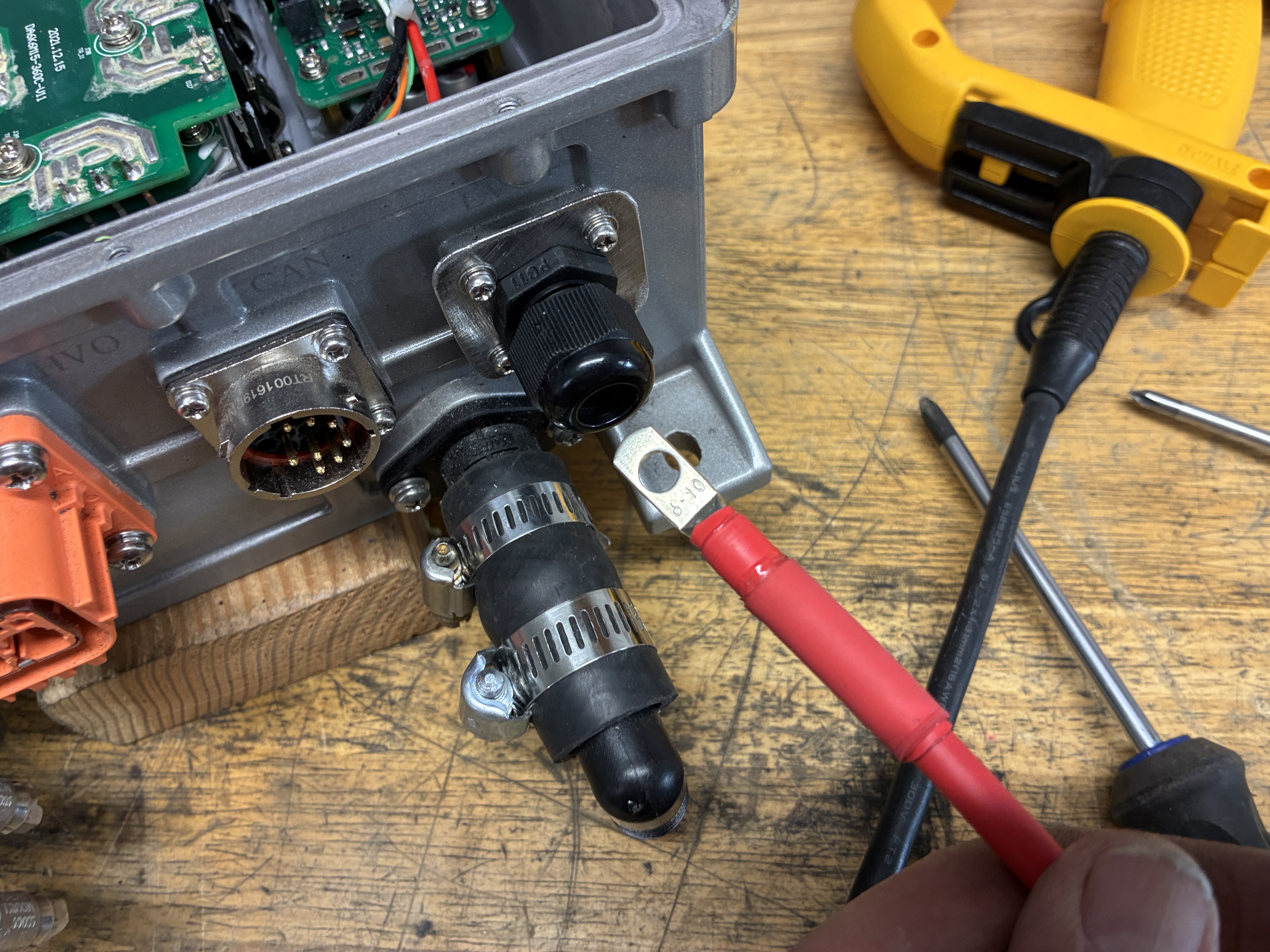

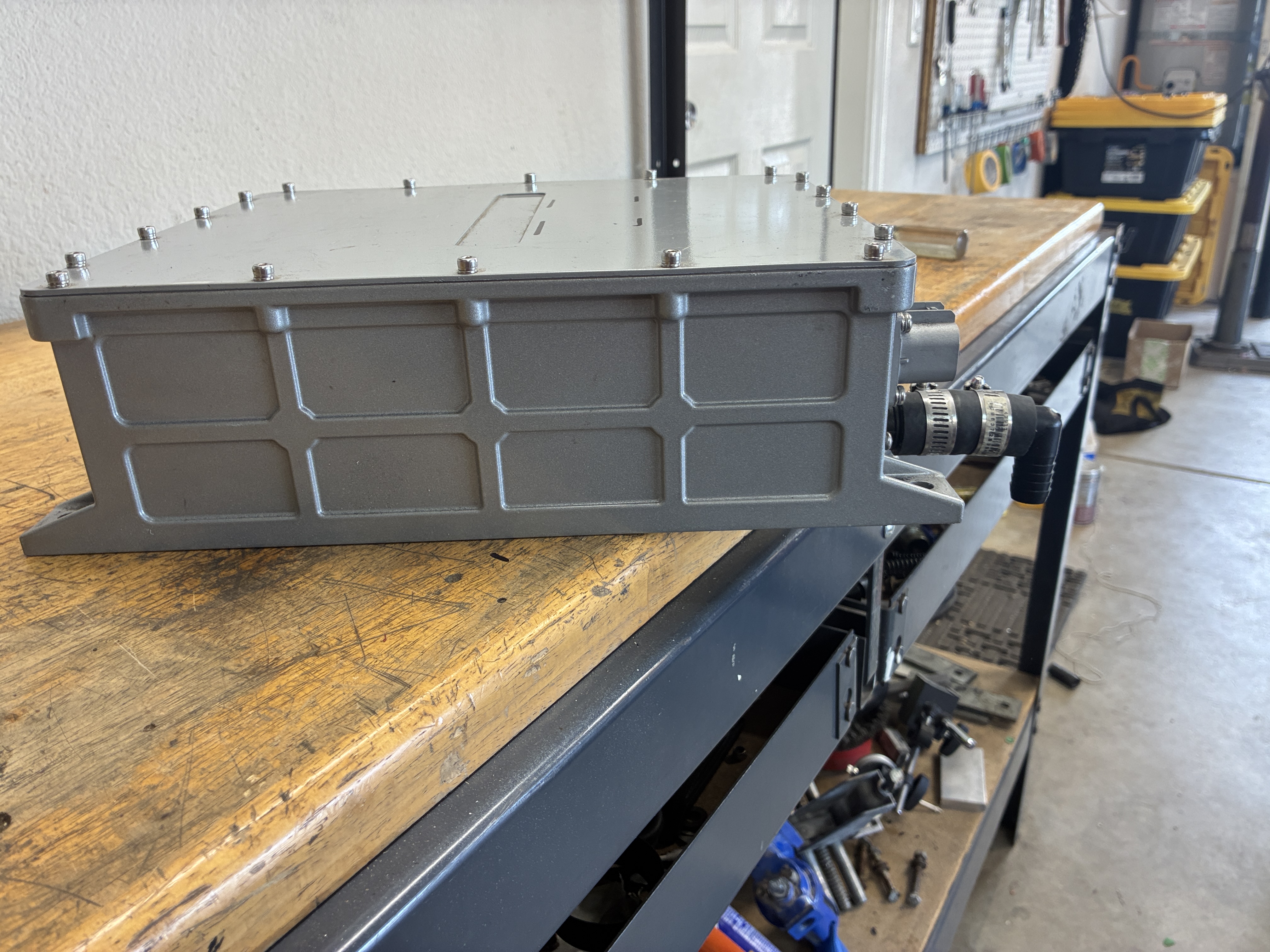

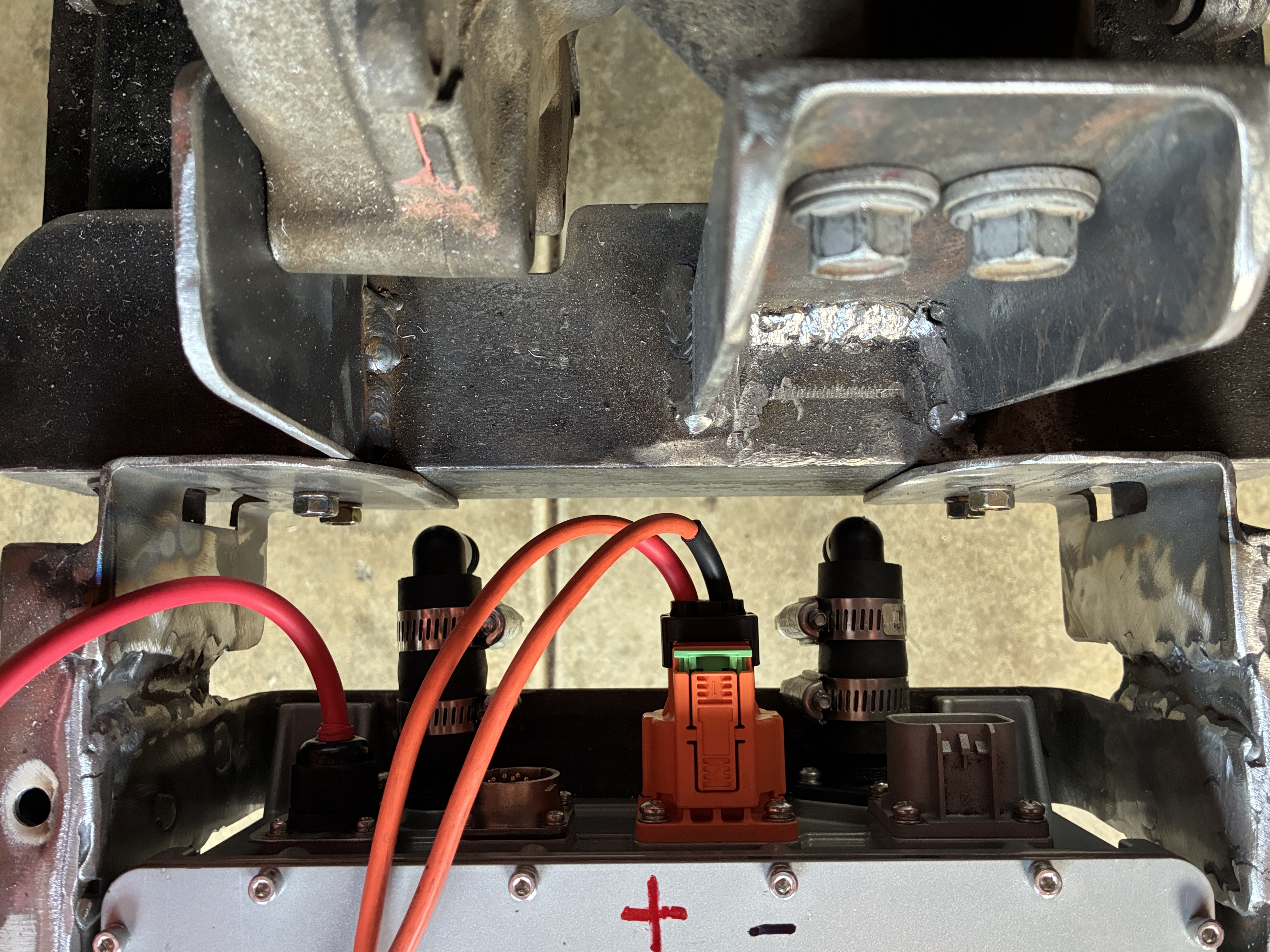

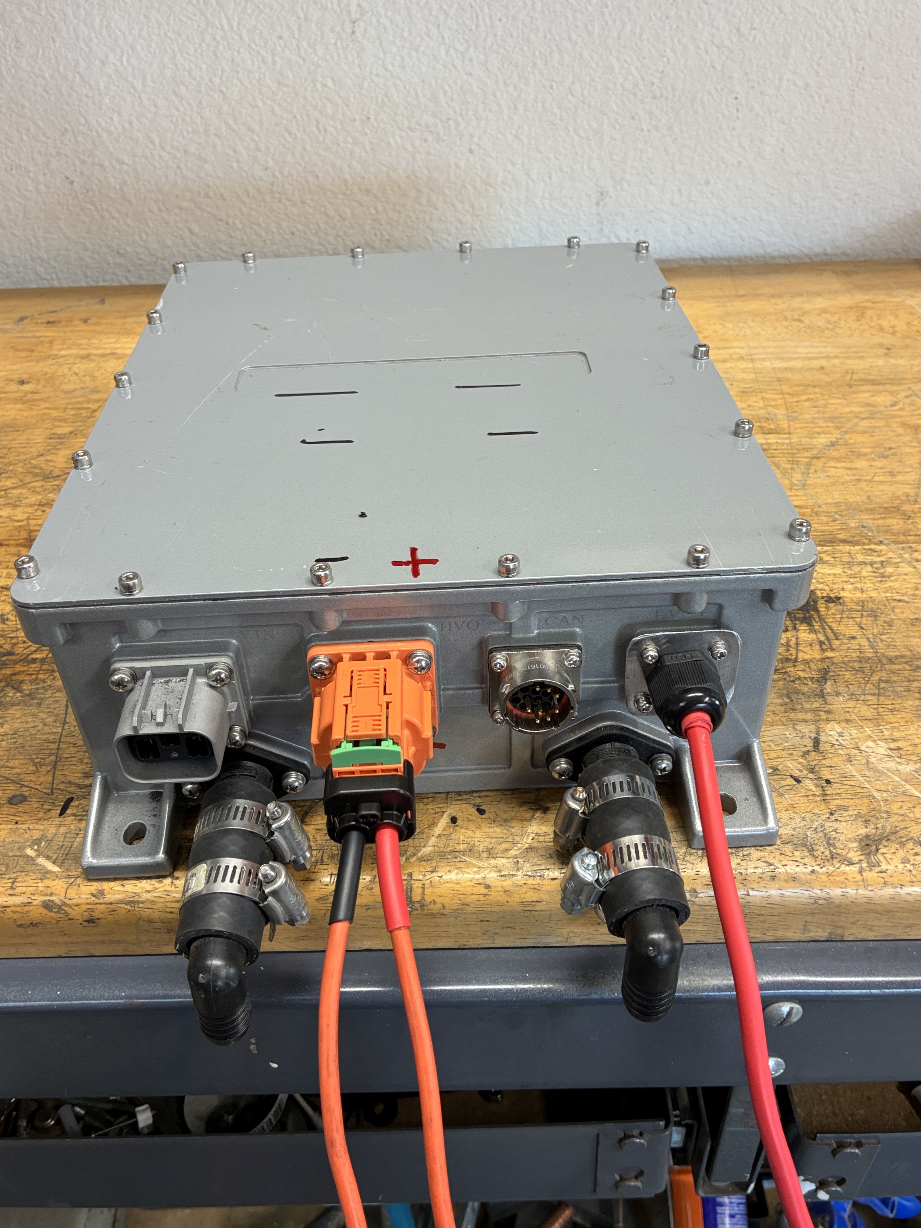

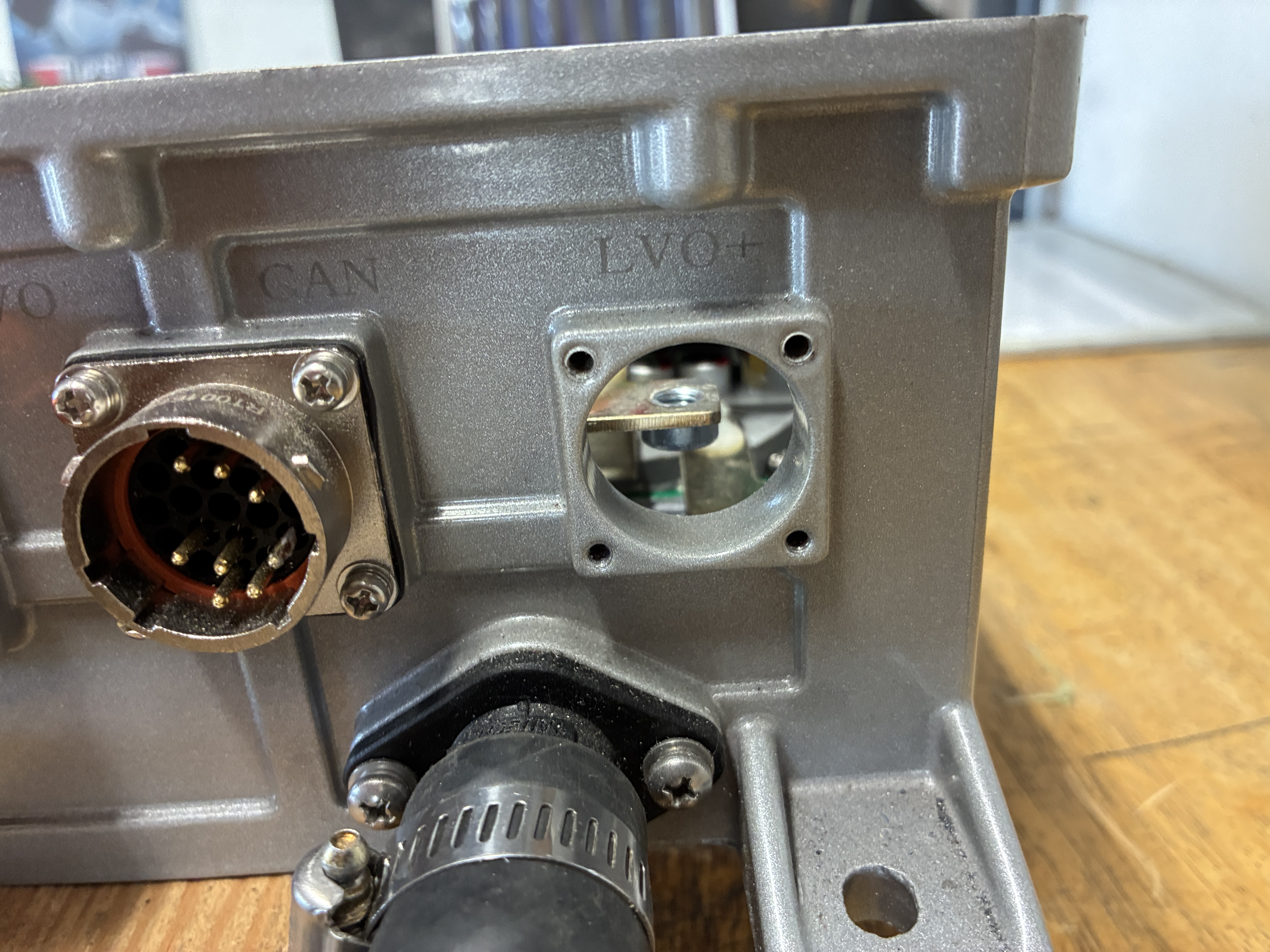

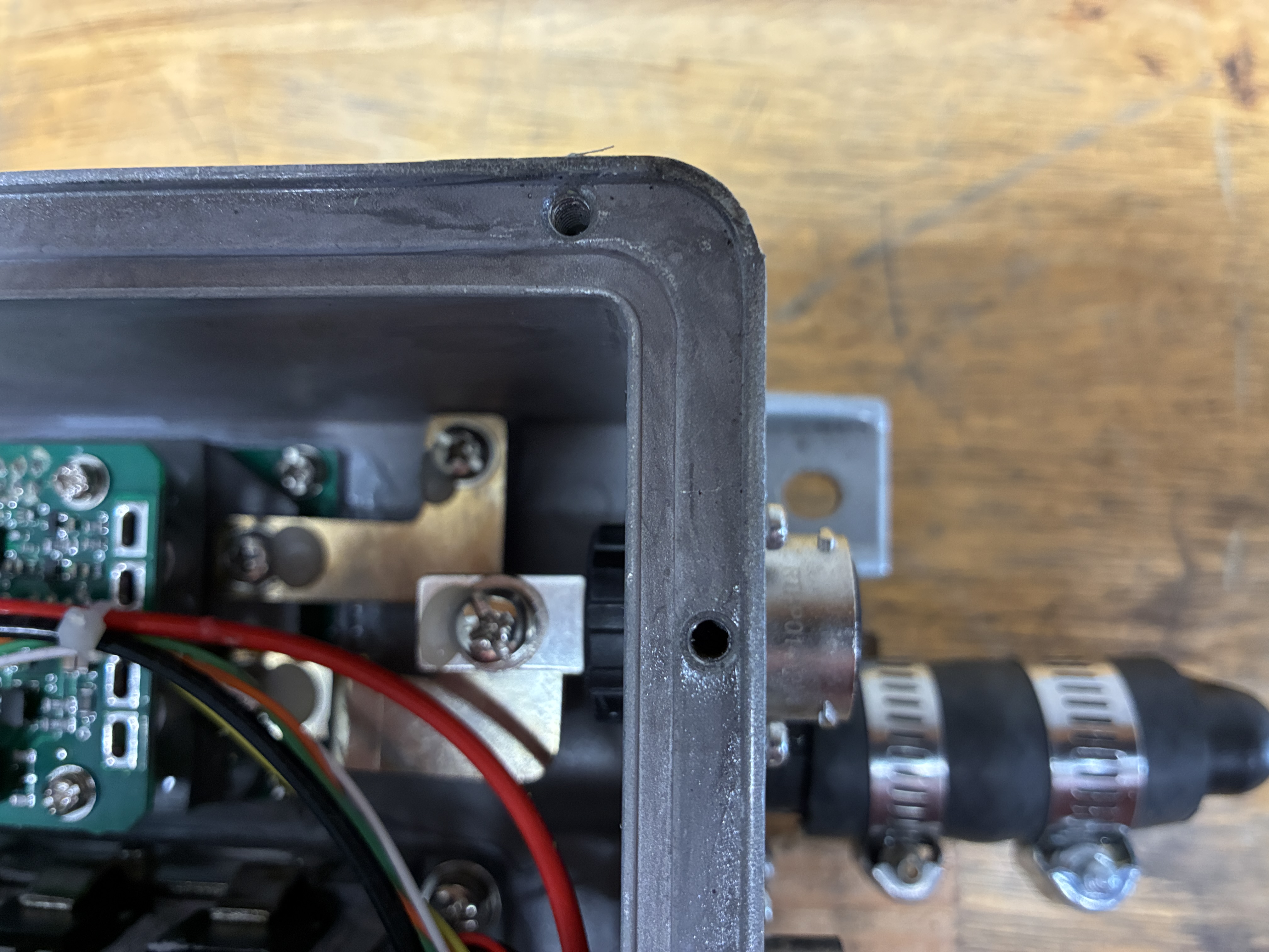

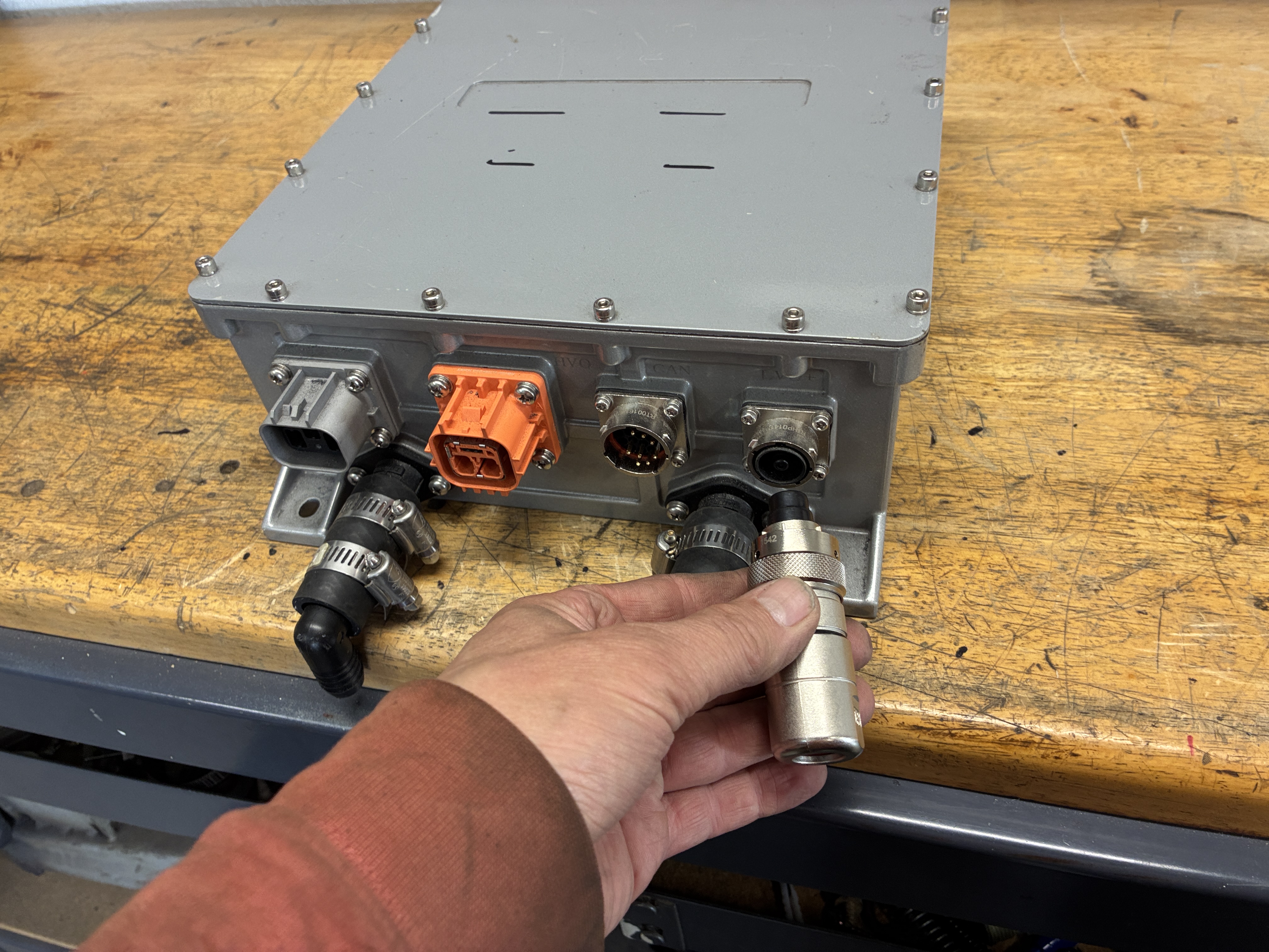

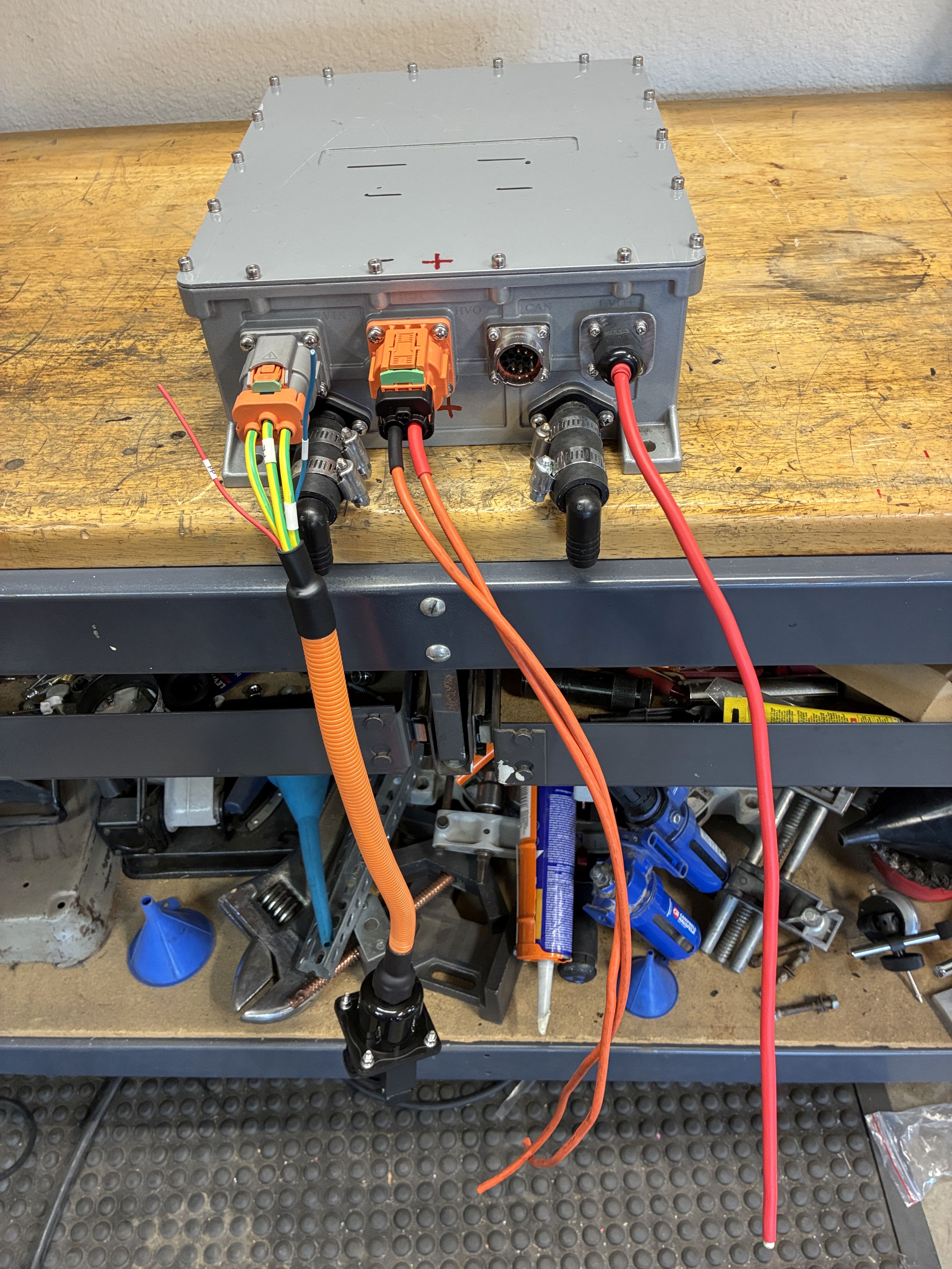

I was dreading wiring up this Ding Dong Charger/DC-DC Converter but here it goes
first up was this SINGLE WIRE low voltage regular 12 volt car battery charger cable, ie alternator cable
and folks we just don't have that kinda room

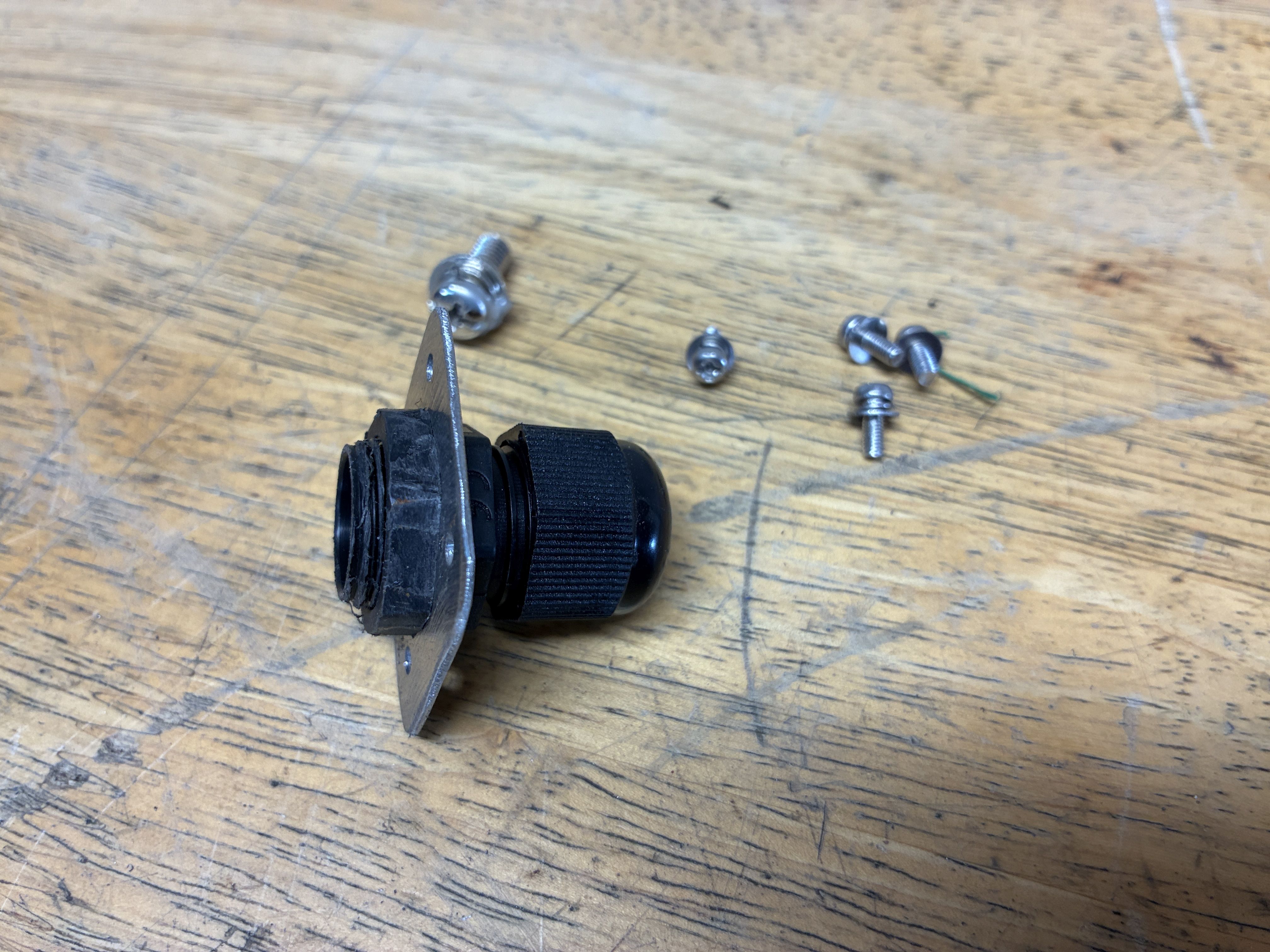

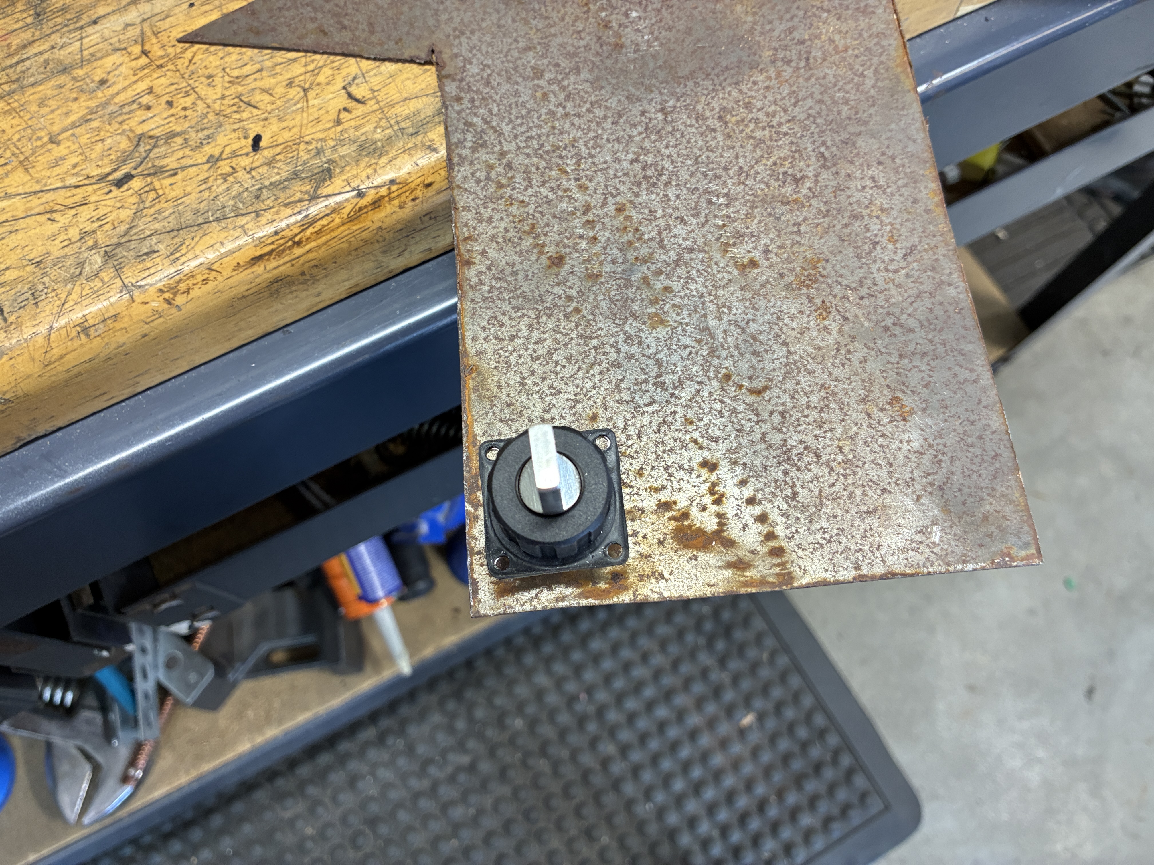

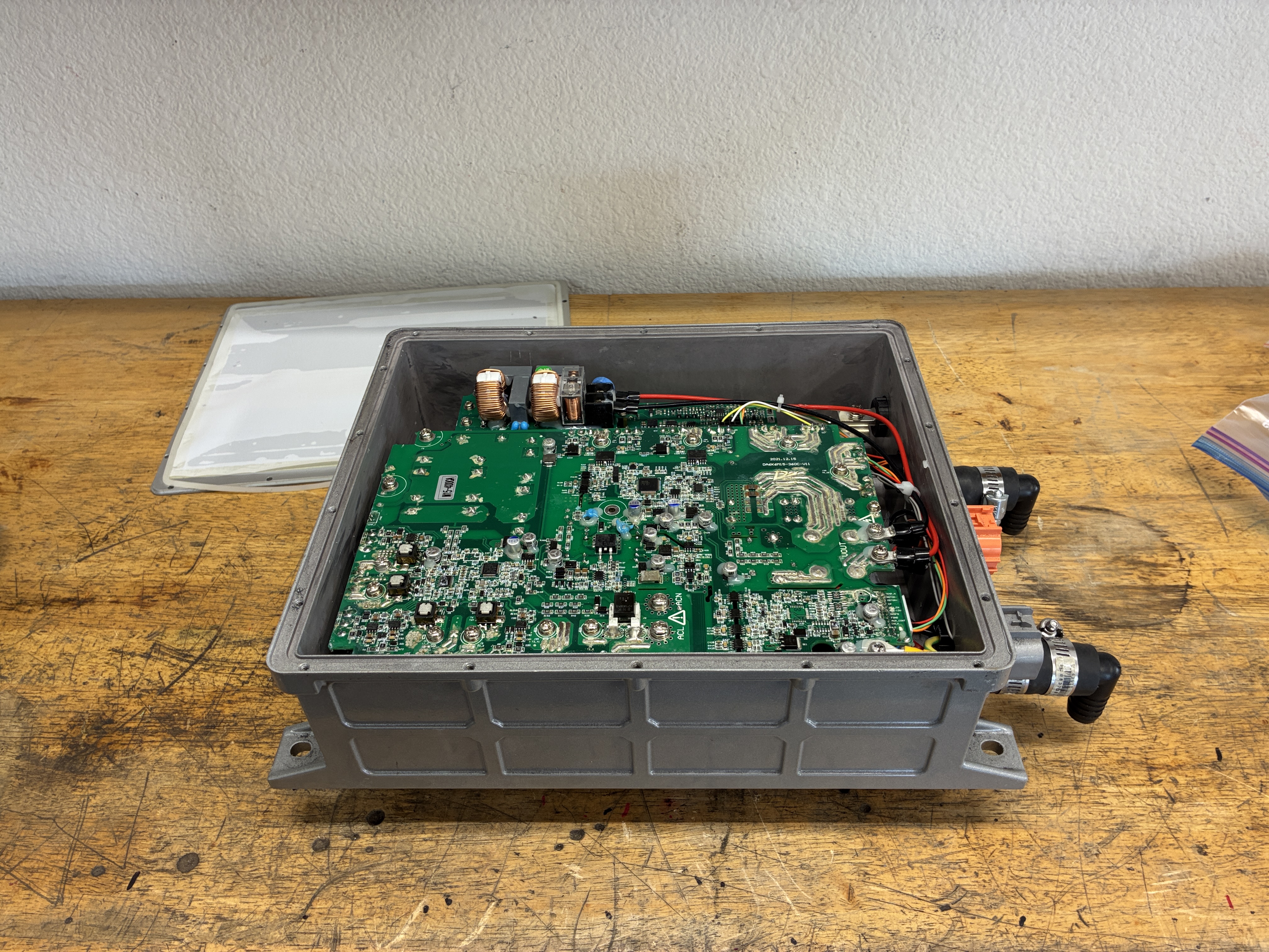

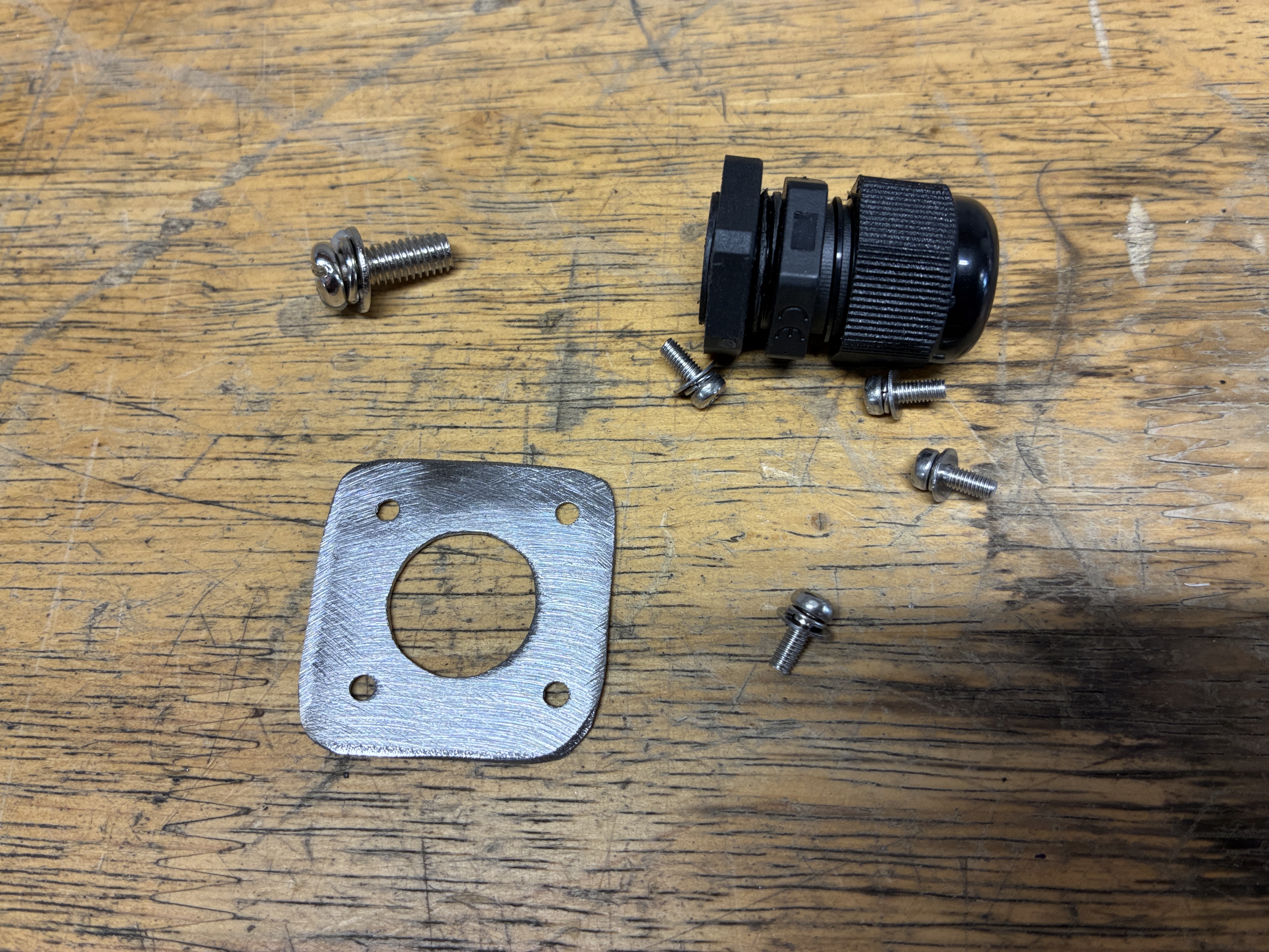

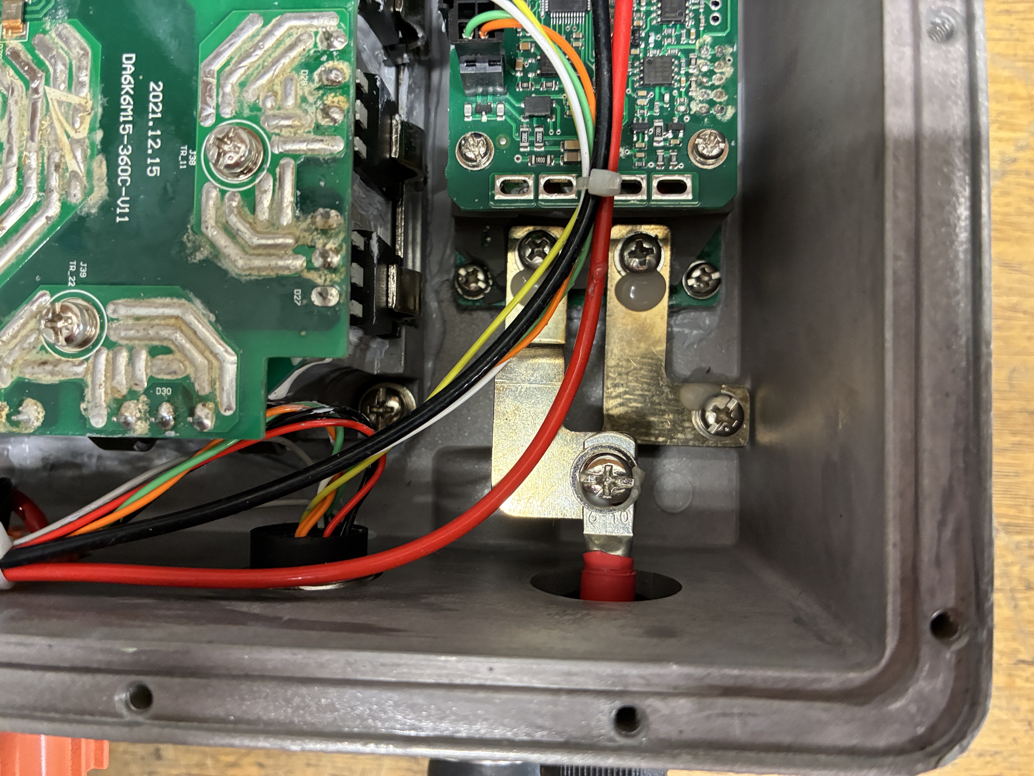

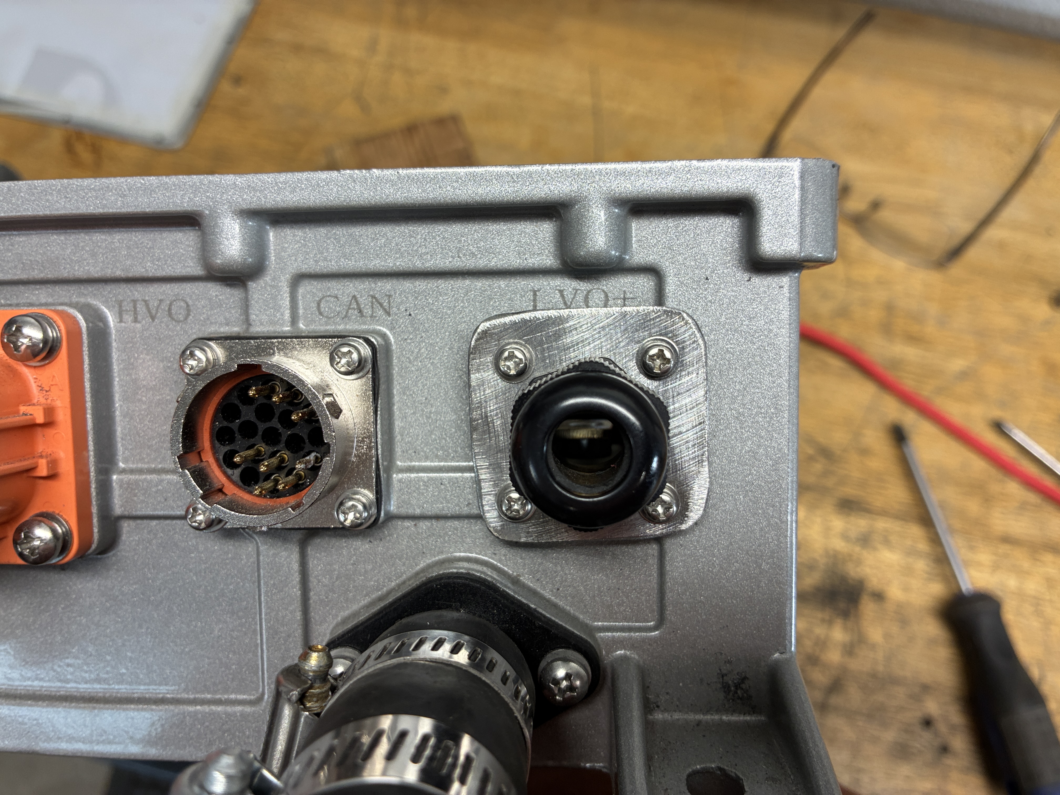

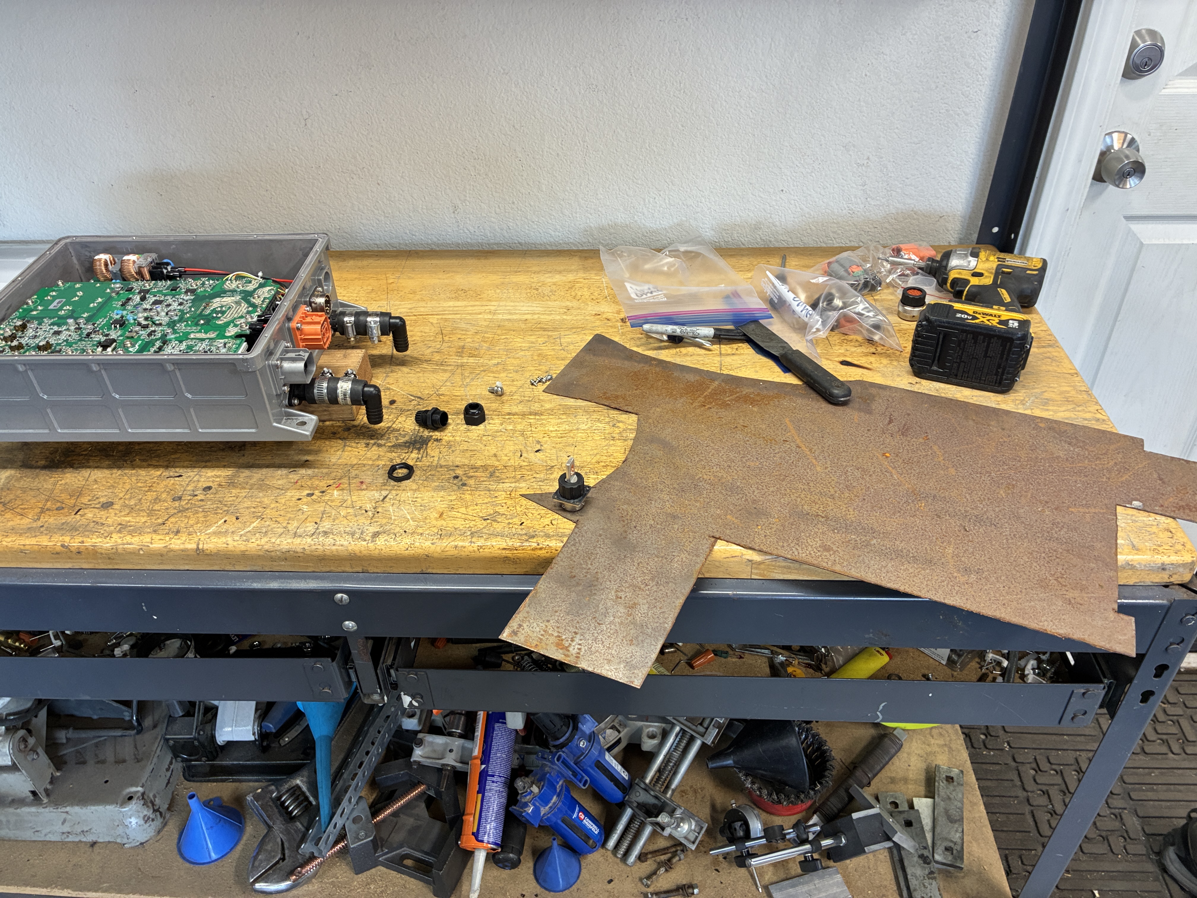

so out came the stock thingie
and we set out to make our own

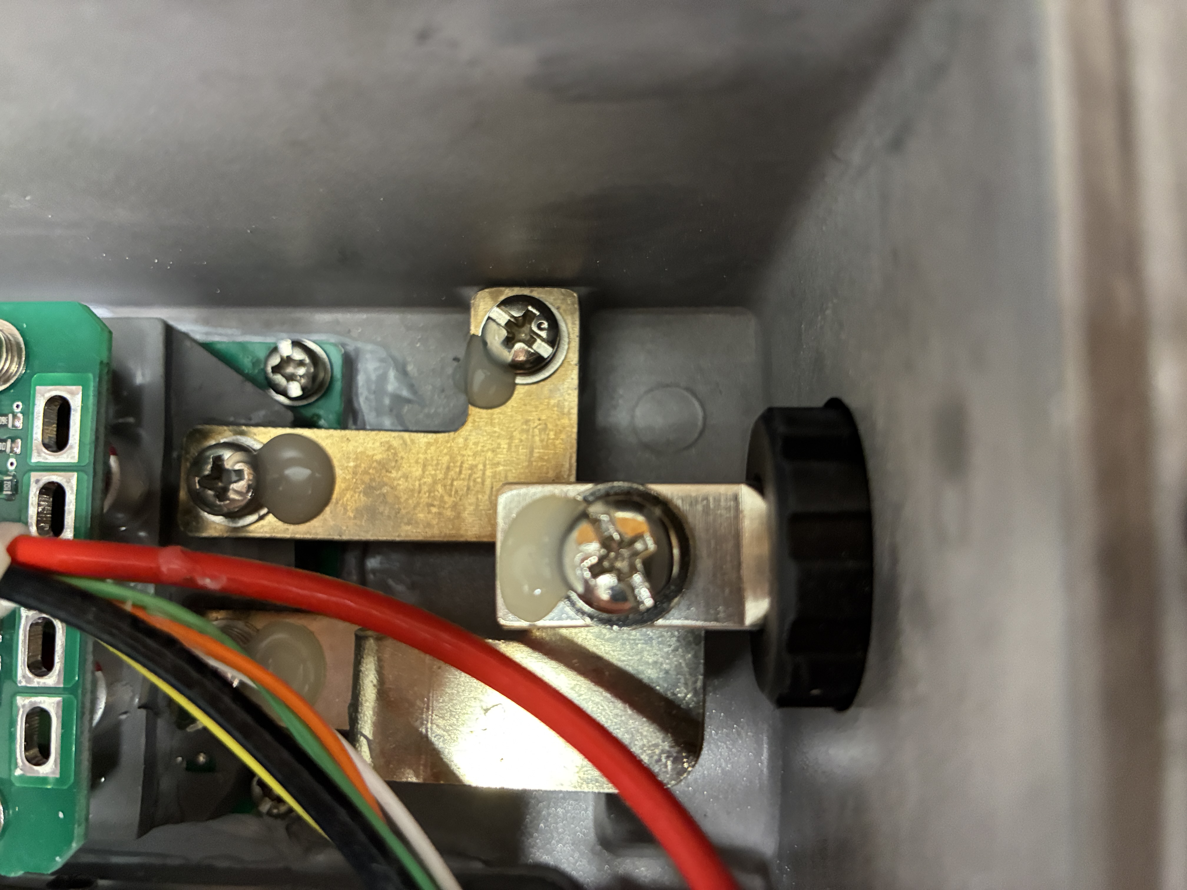

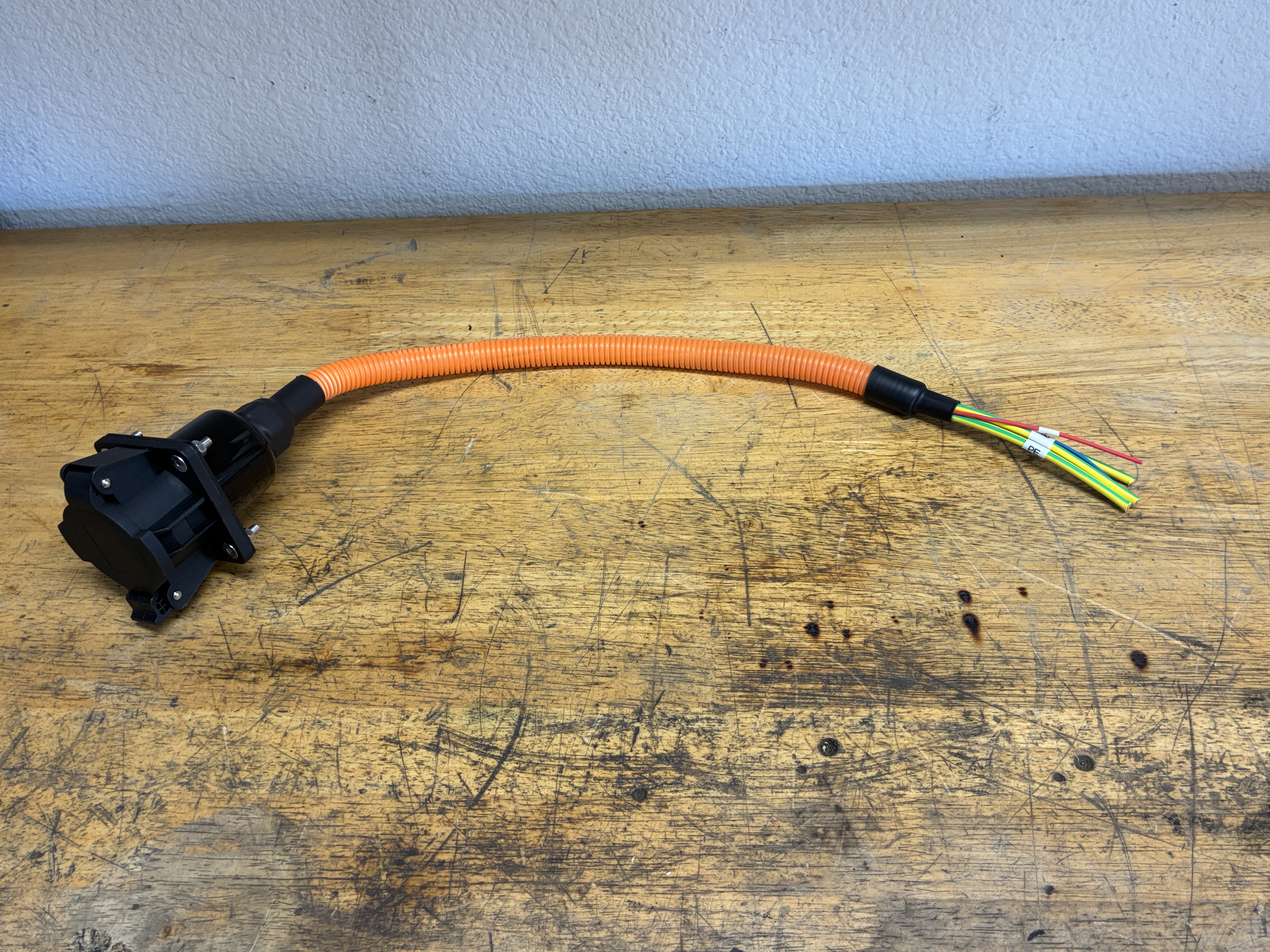

then I made the high voltage battery cable [more detail here: I just bought a Dilong aftermarket charger - Now What? ]
and checked for clerance

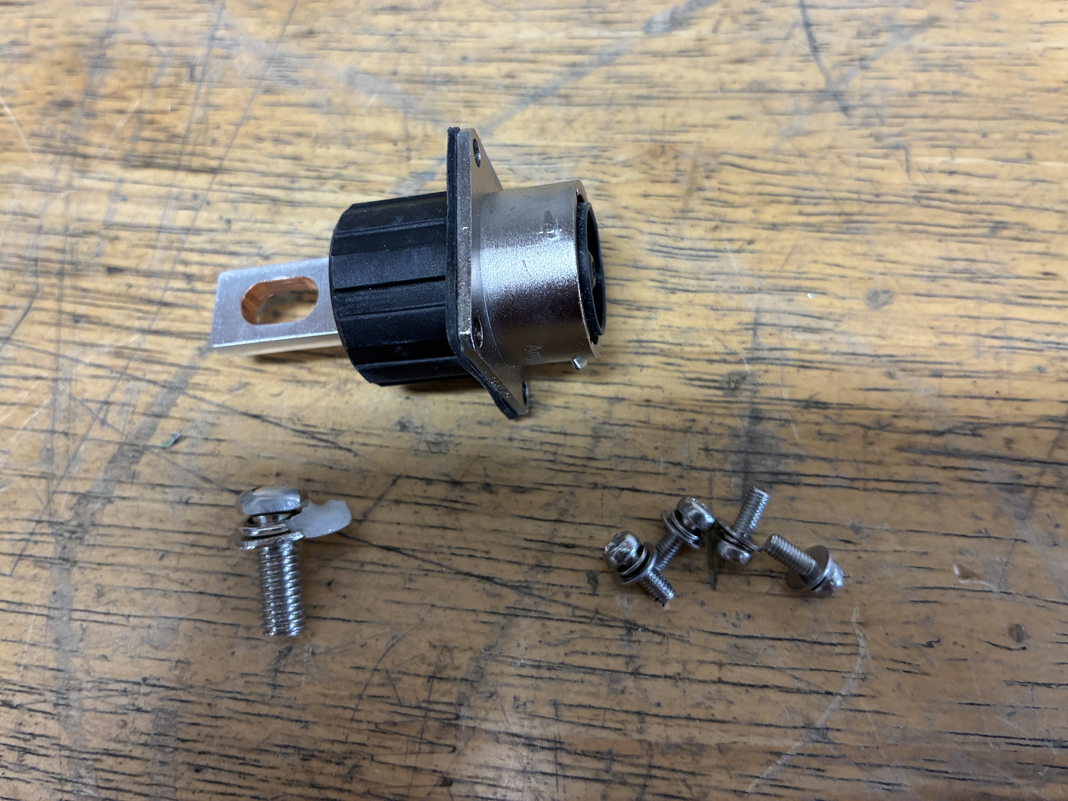

when searching for a charging receptacle I was surprised to find one at Walmart, so I had to order it
J1772 Receptacle Walmart.jpg (25.69 KiB) Viewed 152 times
I don't think this could have come with a shorter tail
