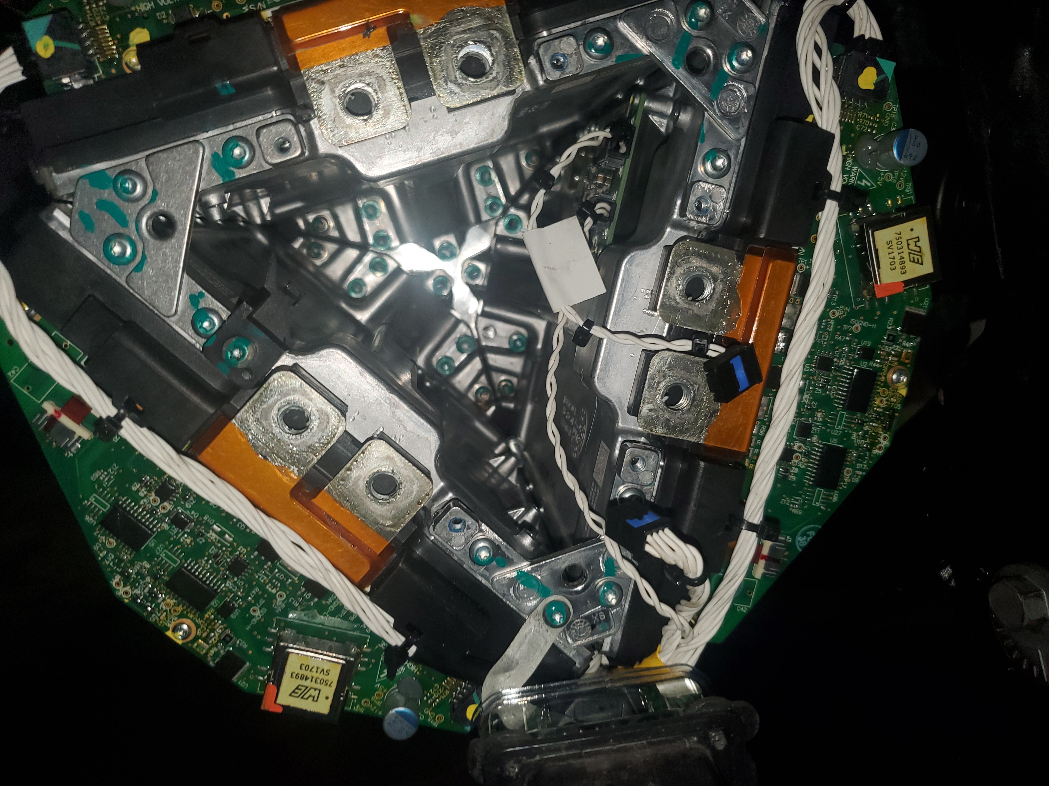

Yes, the short is in both directions. :( Do you think it could be repairable? I will disassemble the motor this weekend to check out the inverter.
Not sure what could've caused the failure, only drove for 20 minutes and didn't push it very hard. It didn't overheat or anything. Thank you Jack for all your help to this community, sad to see that you are discontinuing the Tesla boards.

You can find what is broken by removing the triangle busbar and measuring all the body diodes in the IGBTs. if one does not show a diode voltage of +/-0.36V or rising its broken. Remember to measure from motor phase to positive and negative, then swap the meter leads around and repeat.

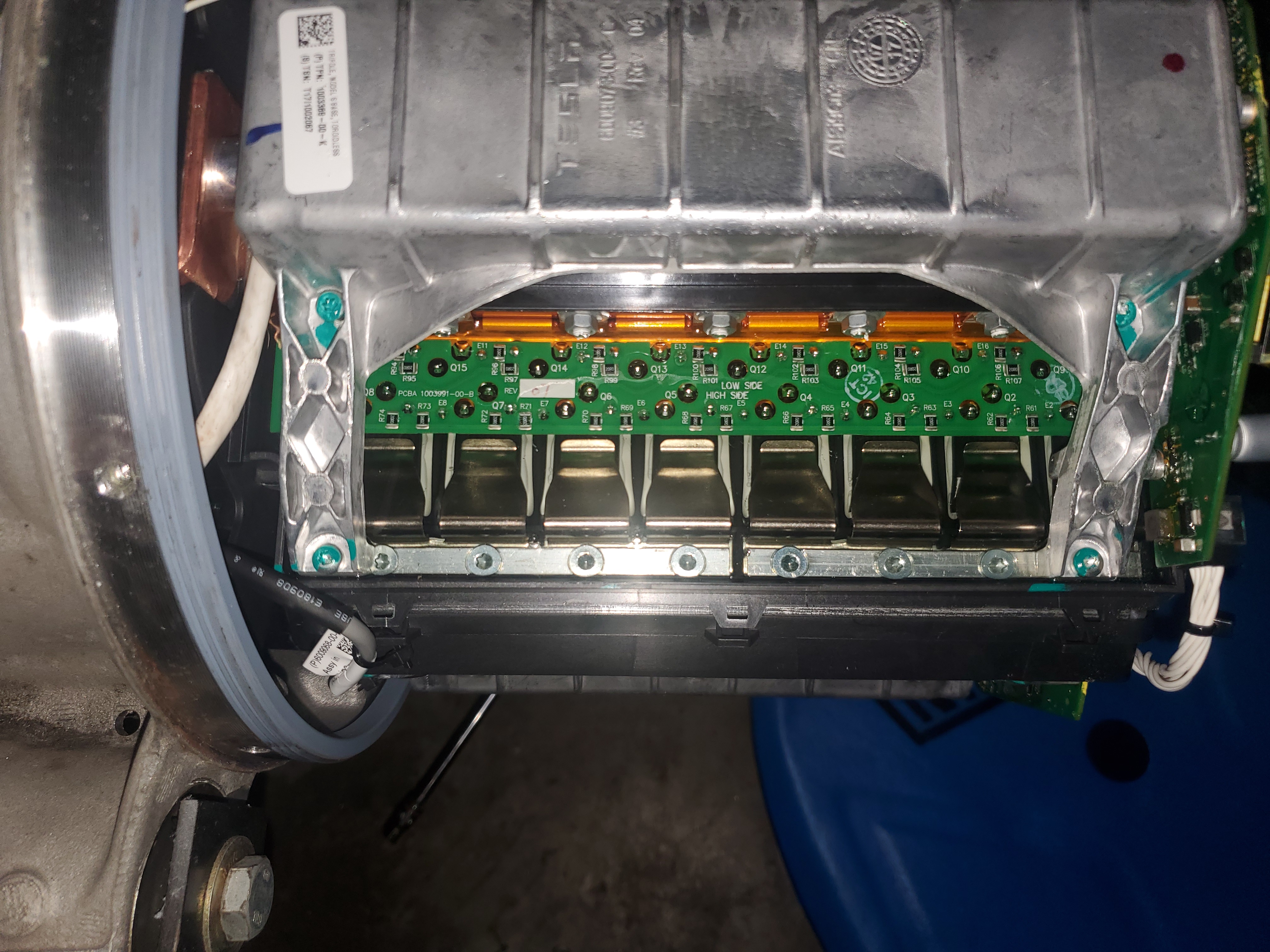

Any tips or a guide for removing the inverter from the drive unit? I have removed the 10 screws that are deep inside the triangular structure, but something else is holding it on (the ac power connections?).
Also, Tom what do you mean by a diode voltage? Is there a voltage drop across the diodes? Does it have to be powered by 12v in order to get this drop? And which solder joints on the circuit board are the diodes connected to? Thank you so much for the help!

Rx7FD wrote: Sun Dec 15, 2019 6:58 am Any tips or a guide for removing the inverter from the drive unit? I have removed the 10 screws that are deep inside the triangular structure, but something else is holding it on (the ac power connections?).
No your multimeter needs to be set to diode check and then measure from phase to dc bus.

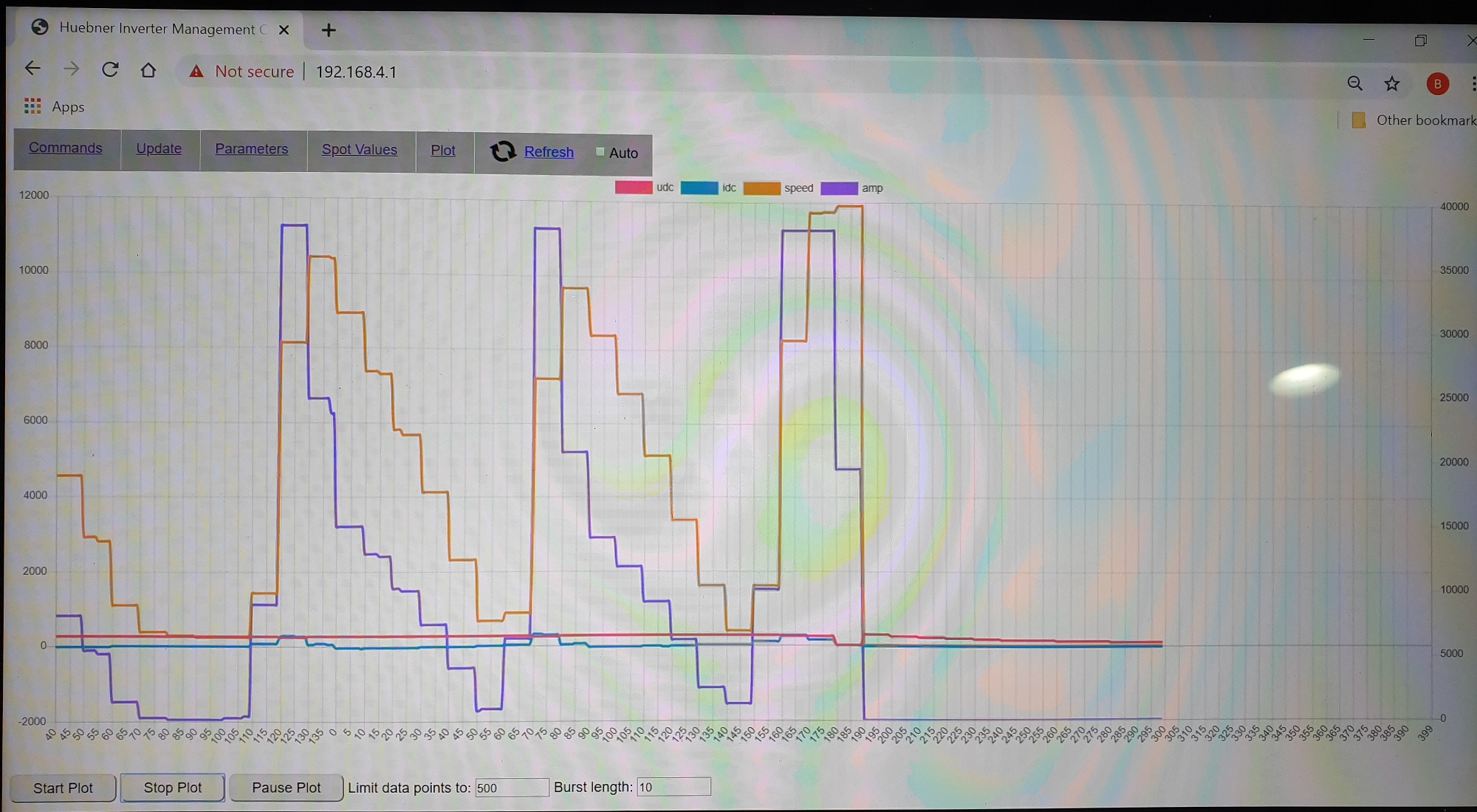

Rx7FD wrote: Fri Dec 13, 2019 6:19 am After a short drive yesterday, my main contactor shut off, and then my precharge resistor and relay overheated/ caught on fire. The cause: my tesla motor appears to be shorted out, as in the resistance between the 2 power leads is 0 ohms. :( Any ideas on what this might be? I'm hoping it's not catastrophic.
Sounds like the same thing that I experienced with the Small Tesla Drive last week. I have the motor in a support rig (Model X chassis) and have cooling running. Blows precharge resistor if attempting to power-up. Found inverter to be shorted.
I think either one of these scenarios to be the cause:
Possible Cause 1:
- I am using a 63A HV DC Breaker as HV protection in lieu of a fuse as did not intend to push the motor too hard while free-spinning
- While testing the plot function, I did push the motor a little harder than anticipated and the breaker tripped
- Motor was spinning at 12,000rpm when this occurred so the presumption is that, without the battery pack connected, the back-EMF from the motor spinning at high rpm damaged the inverter
Possible Cause 2:
- If the above is unlikely, then maybe the breaker tripping was a symptom of the inverter failing due to the parameters not being ideal for a free-spinning motor and me punching the accelerator pedal
- The parameters used were Marco's which did seem to be working well
A plot of the moment my SDU inverter failed is below:

Sutho wrote: Tue Dec 17, 2019 2:30 am
Possible Cause 1:
Yes she is propper fried now, any removal of HV on a spinning motor above anything but near idle speed will cause a huge spike in voltage and fry the inverter.
So a dropped contactor or blown fuse can be catastrophic.
Unfortunate this means you now need a new inverter, which does not get sold standalone so you will need a new drive unit.

Thanks for the confirmation...and certainly something that others need to consider in their build and testing.
Fortunately I have some other drive units.
We have attempted to pull the SDU inverter out of the housing to investigate, but not as easy as expected. Wrong thread for this though...
