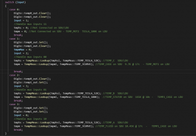

OK getting somewhere now. Found S1 was actually floating not just low, so changed bms_in (temp1_out is an alias of this)
digio_prg.h
DIG_IO_ENTRY(bms_in, GPIOC, GPIO8, PinMode::INPUT_FLT) \
to
DIG_IO_ENTRY(bms_in, GPIOC, GPIO8, PinMode::OUTPUT) \
and commented the bms read using this pin in stm32_sine.cpm here to make sure the pin mode wasn't changing dynamically
//Param::SetInt(Param::din_bms, DigIo::bms_in.Get() | ((canio & CAN_IO_BMS) != 0));
S0 and S1 are now cycling through the 4 select states & get a sensible temp reading with standard mapping on HS. Motor temps still wrong, but that's to be expected as those sensors are actually different. I can spend time sorting those :)

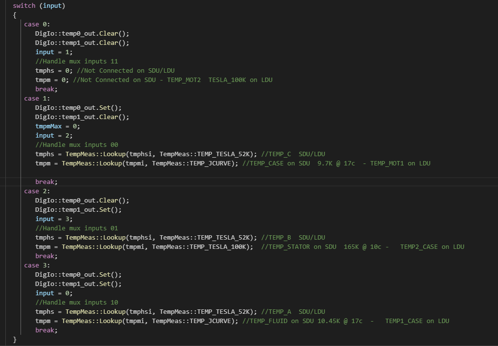

SDU Stator temp appears to be a TESLA_100K, the FLUID/CASE inverter temp appear to be J curve, but will need to do a full range test to be sure.
Here my tested mapping on a SDU. Now getting sensible temps for all inputs - hopefully this helps some others out. It would be great if we can get this, and the temp1_out patch integrated into the main code 8-)
EDIT: Not sure the fluid/case sensors are in fact J curve, reading low - should consider those not known yet
EDIT2: Just realised that the divider resistors are different between LDU and SDU boards for TEMP_CASE and TEMP_FLUID pins (150k SDU vs 15k LDU) not sure if this is a typo or deliberate

Measured some calibration temps on the case/fluid sensors today. They read out as standard 10k NTC thermistors with a beta of about 4000.
I've created lookup tables for them using the standard 150K pullups on Damien's board and all code is here including the mux and mapping fix
https://github.com/jameswarner62/stm32-sine
Working great for me, hopefully helps some others
These are hardcoded as the hardware sense cannot tell between LDU and SDU. Can we get Johannes to pick up these changes and implement a SDU mode?
Thanks!
