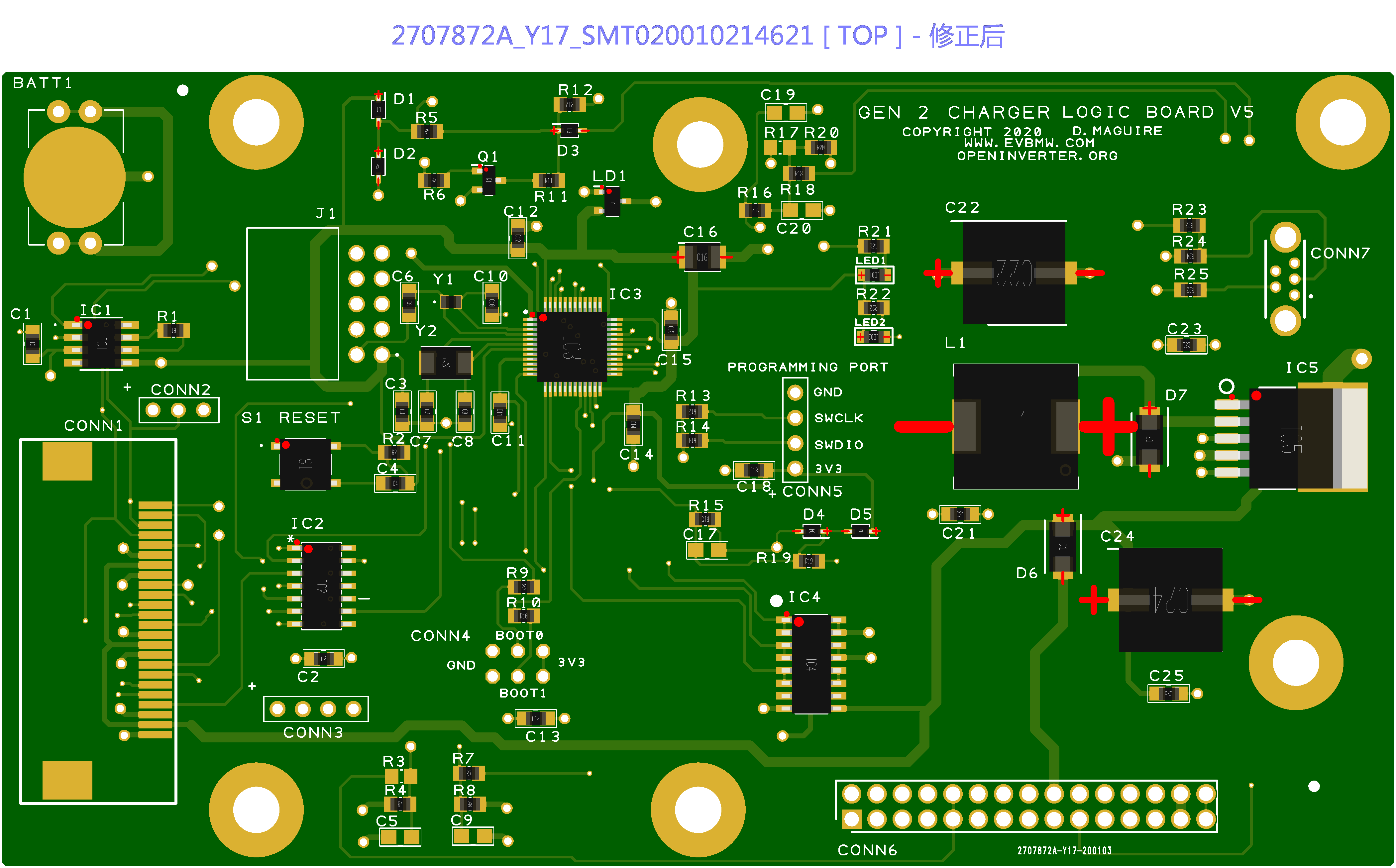

Posts: 4005
Been thanked: 1132 times
The new Tesla Gen 2 charger logic board V5 now in production at JLC.
Main differences over previous versions :
  • STM32F103C8T6 processor instead of SAM3X8E. Required as JLC do not stock the SAM3 at this point. Same processor as blue pill board.
    Deleted external CAN channel. As the new mcu only has one can controller this is required to run the charger power modules.
    Added an analog input.
    Added support for backup battery (coin cell) to allow for scheduled charging.
    Added WiFi connector for ESP32 WiFi module as used on the inverter.
So the plan is once we get boards in will start writing software for the new processor. Will have connectivity over wifi using the web interface for monitoring charge, setting parameters etc:)
Posts: 2962
Has thanked: 330 times
Been thanked: 847 times
V5 will thus no long support a Master and Slave charger setup.
Has the issue of the capacitor interfering with the lid been resolved? I do not believe this is on every cover but on most.
Kevin Sharpe
Posts: 1339
Location: Ireland and US
Been thanked: 10 times
Post by Kevin Sharpe »
tom91 wrote: Mon Jan 06, 2020 5:50 pm V5 will thus no long support a Master and Slave charger setup.
Clear opportunity for the commercial vendors to differentiate their products ;)
tom91 wrote: Mon Jan 06, 2020 5:50 pm Has the issue of the capacitor interfering with the lid been resolved? I do not believe this is on every cover but on most.
Can you let me know which capacitor? I'm installing some V4 boards and can verify the issue and check when V5 arrives 8-)
