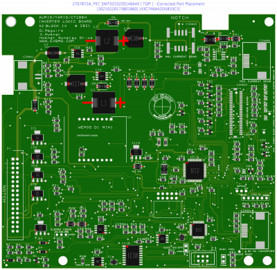

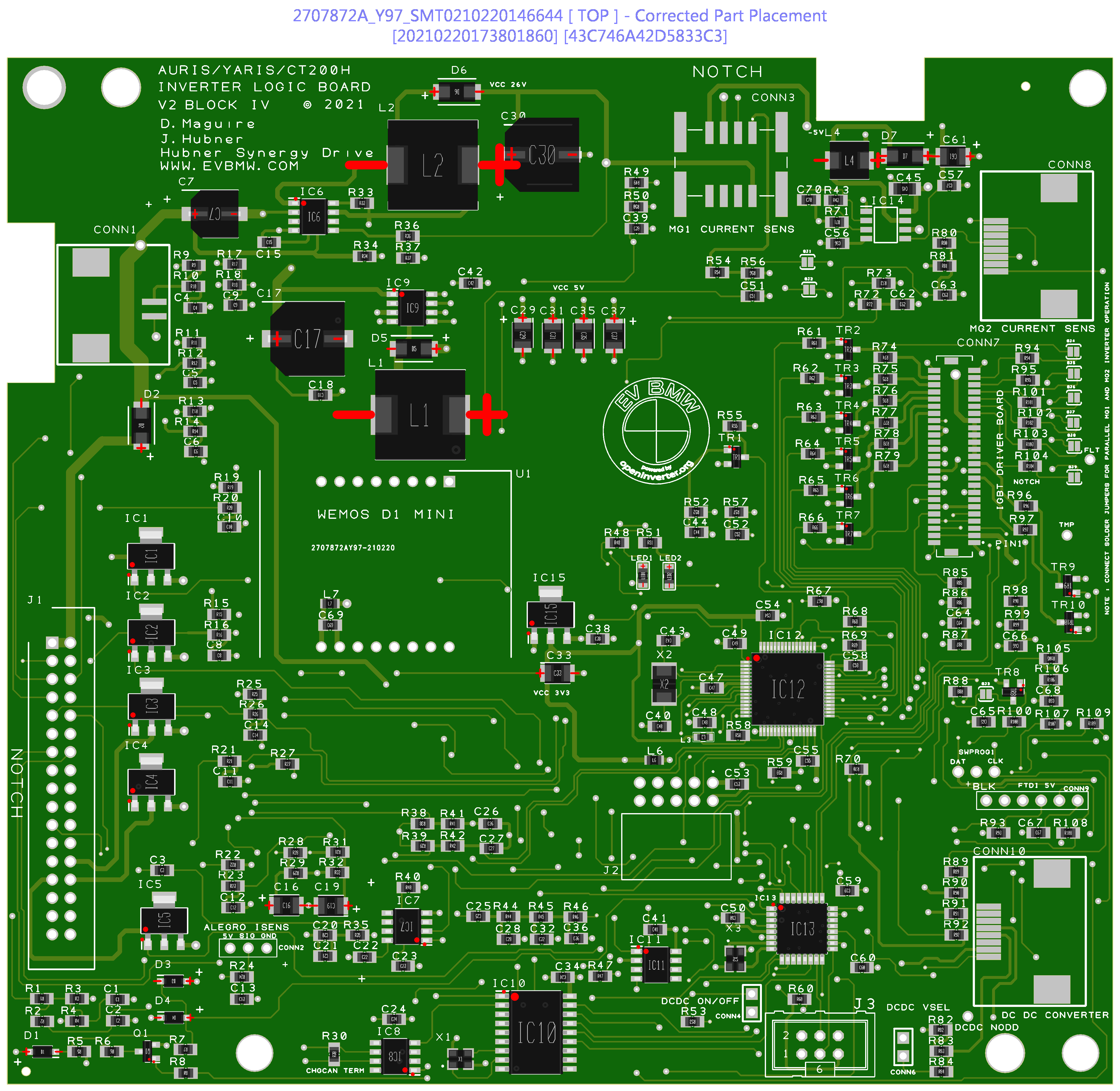

So a few things to note here : The 5v regulator on the Yaris board cannot keep up with the extra load from the wemos. I bet if you check it is hovering around 4.5v which is causing the 328p to drop in and out of brownout. This will also cause the -5v rail to run low or not at all and hence the current sensors read garbage. When you disconnect the current sensors the 5v rail recovers and everything seems to work fine. So what I would do is remove the inverter wifi and see what happens or try supporting the 5v with an external psu for testing.
In light of this I have redesigned the Yaris board with the following modifications :
-2A 5V psu
-AMS117 3v3 reg
-MAX735 switch mode -5v regulator in place of the cap pump version.
-add filtering to inverter wifi module
-add option for a wemos d1 mini for charger wifi
Currently have prototypes in production at JLC. As soon as I verify correct operation they will be available in the webshop and design files on Github.
-2A 5V psu
-AMS117 3v3 reg

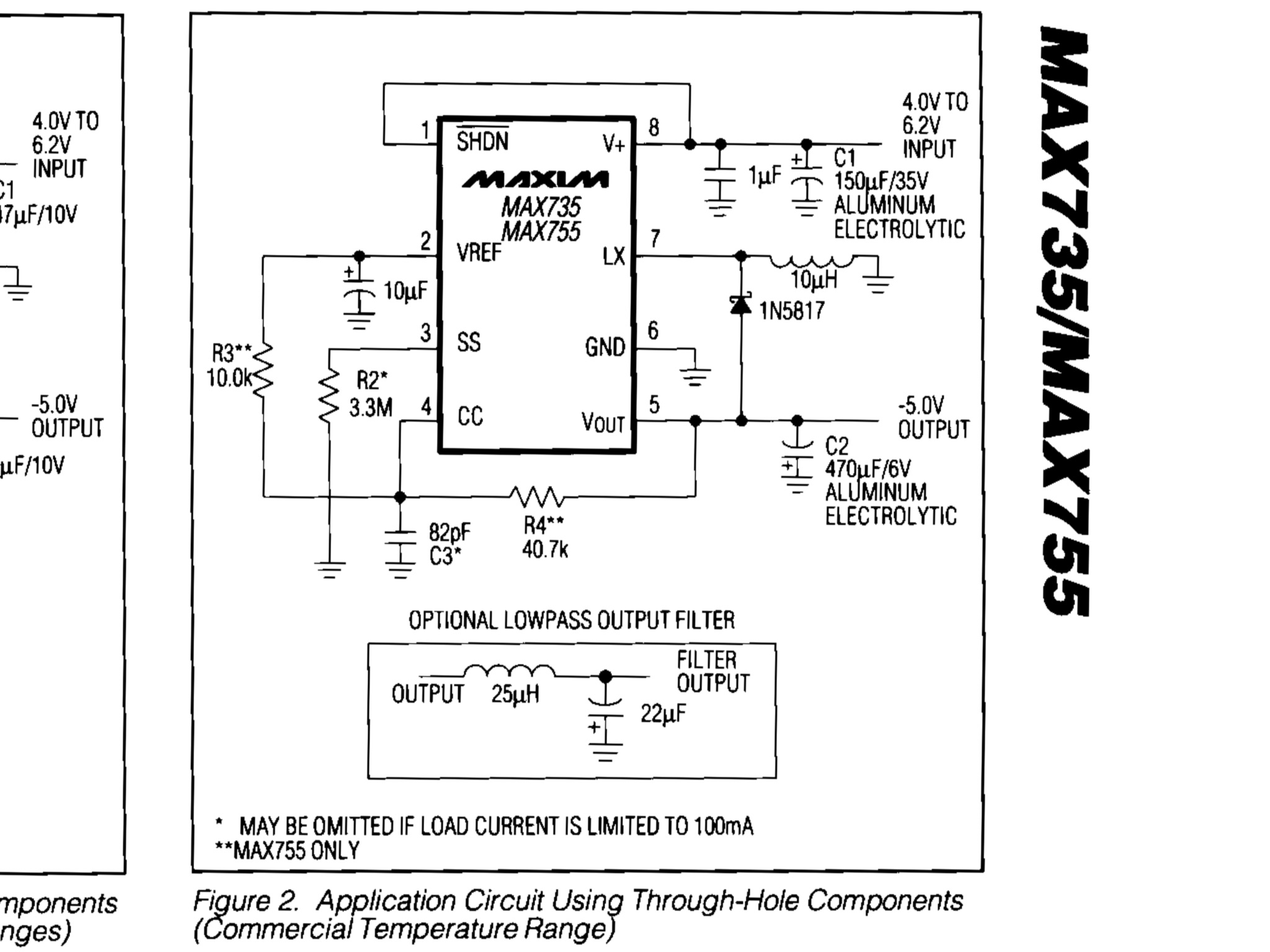

MAX735 ? Maybe there's a problem here? A separate 5V power supply did not solve the problem ((Atmega is still hanging... it turns out that on all the boards previously released, the charger circuit is not working? Or is it still possible to revive it?
