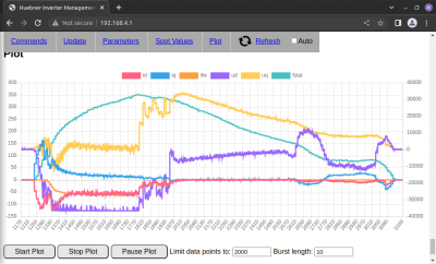

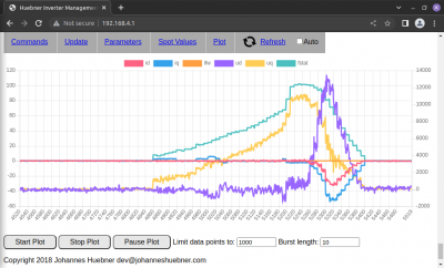

Hm, Johu recommends running curkp around 500 and I have 32 so this is a good starting point for adjustment, will give it a go.
- bexander
- Posts: 866
- Has thanked: 71 times
- Been thanked: 97 times
Re: Renault Clio Electrique -97
Set curkp to 500 (32) and also changed vlimmargin to 2000 (2500).
That made big difference. Now the oscillation starts closer to 60km/h or fstat 260 and are much smaller in amplitude however at 70km/h or fstat 300 it starts to self accelerate, I guess due to it is running out of Ud? Worth mentioning, I made an acceleration from standstill up to self acceleration while pulling around 60A from battery, gets up to 65A when self accelerating..., anyway thats around 22kW (or 24kW while self accelerating). I don't think the MGR have delivered this power at that speed before, and no unwanted regen either, just the self accelerating part that needs to be tuned away.
And also, that was not flooring the pedal so more to come...
Should I incease curkp further or should I tweak some other parameter?
The weather forcast states snow for tomorrow so probably will have to wait until saturday for more tests.

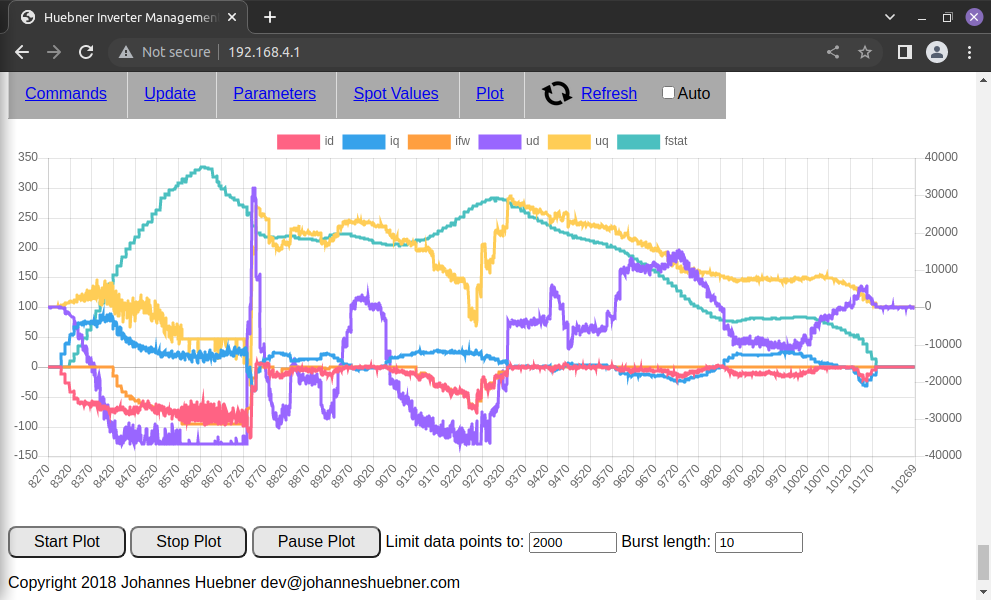

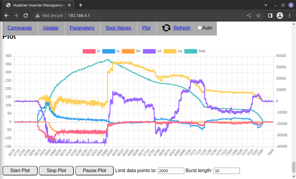

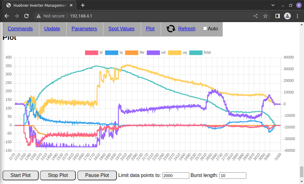

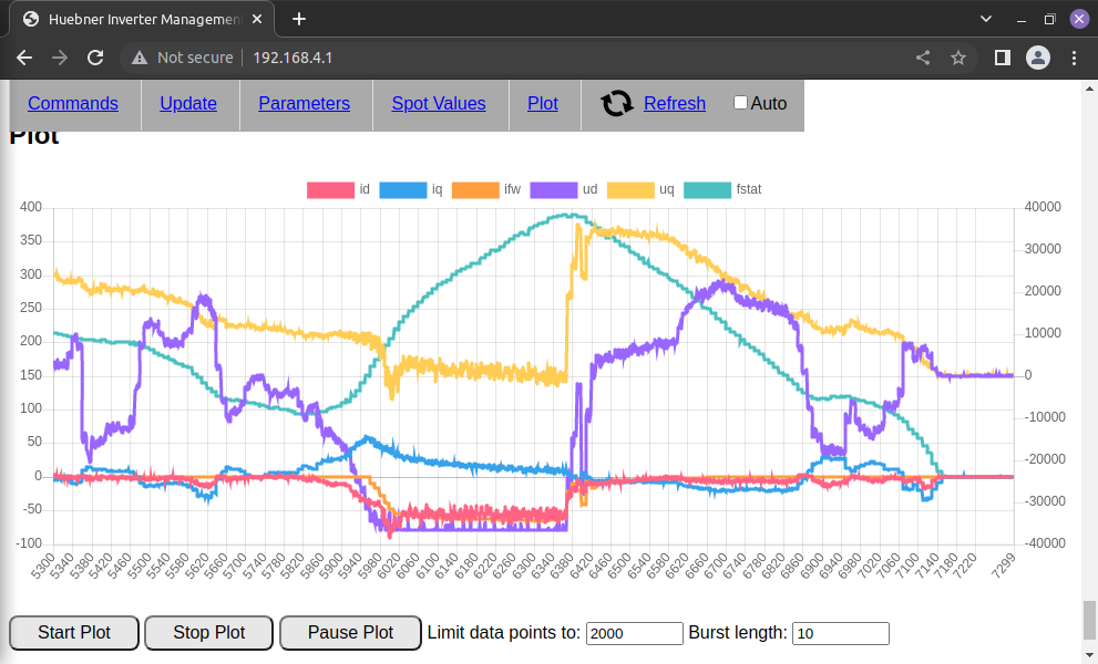

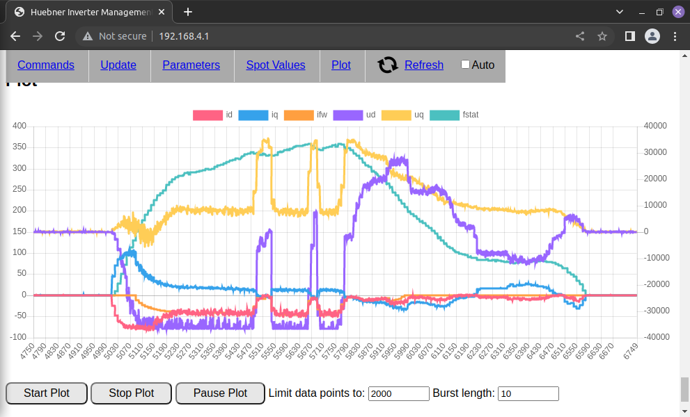

Still damp roads but couln't hold back my quriosity any longer so some tests done.
First a coast up (well, its downhill) test with just trying to hold the pedal at neutral torque request. Looks like Ud is decently straight. Maybe slight tendency upwards, hence might need small decrease in syncadv?
Changed "lqminusld" to 2 (4) and set "fwcurmax" to -50. No auto acceleration nor oscillation but a bit sluggish, only pulling 40A from battery at 370V in FW.
Set "fwcurmax" to -75. Felt like I got some small oscillations starting at 80km/h, pulled 52A from battery at 370V in FW.
Set "fwcurmax" to -70. Felt good with no oscillations at 89km/h (ran out of road, top speed limited to 91km/h), pulled 50A from battery at 365V in FW.
Before FW I got 75A at 360V so 27kW and then 18kW in FW.
A bit concerned about the dip in Id and Iq after FW has started to kick in. Don't really understand why it is doing this?
Overall, very smooth to drive with no unexpected behaviors.
Next will be to test and tune "curkp" and "curki".
Also will test different "lqminusld" settings. I feel 4mH is a bit high and that is why I changed it to 2.
Lastly, my latest parameters.

Looking good
Ud on the first plot looks fine.
I think the oscillation is when the controller goes past the critical current and the motor voltages start increasing rather than decreasing. On that basis -70A looks about right.
I'd should stay pretty stable during field weakening, it needs to stay close to the critical current, but to allow that Id has to drop as that is the only way left to control motor volts, so that looks fine. Also interesting to see the way Uq rises when you come off the throttle, exacltly what the maths predicts but nice to see it in real life too
Edit - it should be possible to maintain the power level going into FW though, agree it is worth adjusting lqminusld to see if it improves.
Edit2 - adjusting fluxlinkage may help here too.
Edit3 - whats also interesting is that it is Ud not Uq that is driving the field weakening. I need to have a play on the simulator to be sure but that could suggest that Lq is quite a bit bigger than Ld. If so then a good amount of the torque will be reluctance torque which you will lose if lqminusld is set too small. 4 might not be too big after all?

Just been doing instructions for the simulator so while it was all set up I decided to have a quick look at this, essentially I get exactly the powers you mention, 27kW dropping to 18kW and no matter how I tune the motor parameters the power drop is still there.
Having looked a bit more I think the problem is that FW is coming in when it's not required. FW helps when Uq is hitting the stops due to high motor speed, the simulations on your motor (and your plots) don't show that, instead it's Ud that is hitting the stops. Unfortunately the existing algorithm doesn't differentiate between the two so it tries to add FW when it needs to back off the throttle which actually makes things worse and causes the power drop.
I have had a play with an algorithm that differentiated between the two before but didn't get too far with it and at the time hadn't seen any evidence that it was a real problem. If you can't tune the power drop out let me know and I'll have another look.
BTW - I think flux linkage should probably be a bit higher, Icrit x Ld should ideally equal the flux linkage (70 x 2mH = 140mWb, or 70 x 3mH = 210mWb).

According to the calculation of the fluxlinkage with data from coast up test I get,
6800 * 32768 * 380 / (2 * pi * 65) = 0,193Weber
Close to your suggested 210mWb.
So a good idea might be to test with fluxlinkage set to 193 and lqminusld set to 4.
EDIT: Wrong, missed the /2 of the DC-voltage. Should be
6800 * 32768 * 380/2 / (2 * pi * 65) = 0,097Weber

Depends what you would like to use it for, if it is just for measuring the motor then any of the cheap ones should be ok (both Ev8 and Bigpie have detailed the ones that they used in the simulator thread). If you do any electronic work then a slightly better one may be worthwhile.
The current probe technique should be fine if you have the kit for it, in fact due to the higher currents it is probably a bit more representative. I'm guessing it might need the motor shaft locking accurately to get a good value for Lq (as the higher currents might start to move the rotor which would invalidate the result).
I'm wondering whether it is possible to calculate Ld and Lq from your plots too. What's needed is a step change in throttle below FW, from the change in Iq and Id and the corresponding change in Vd and Vq it should be possible to work them out. There is a bit towards the end of one plot that might do so Ill try to have a look later today.bexander wrote: ↑Sun Jan 08, 2023 8:40 am
