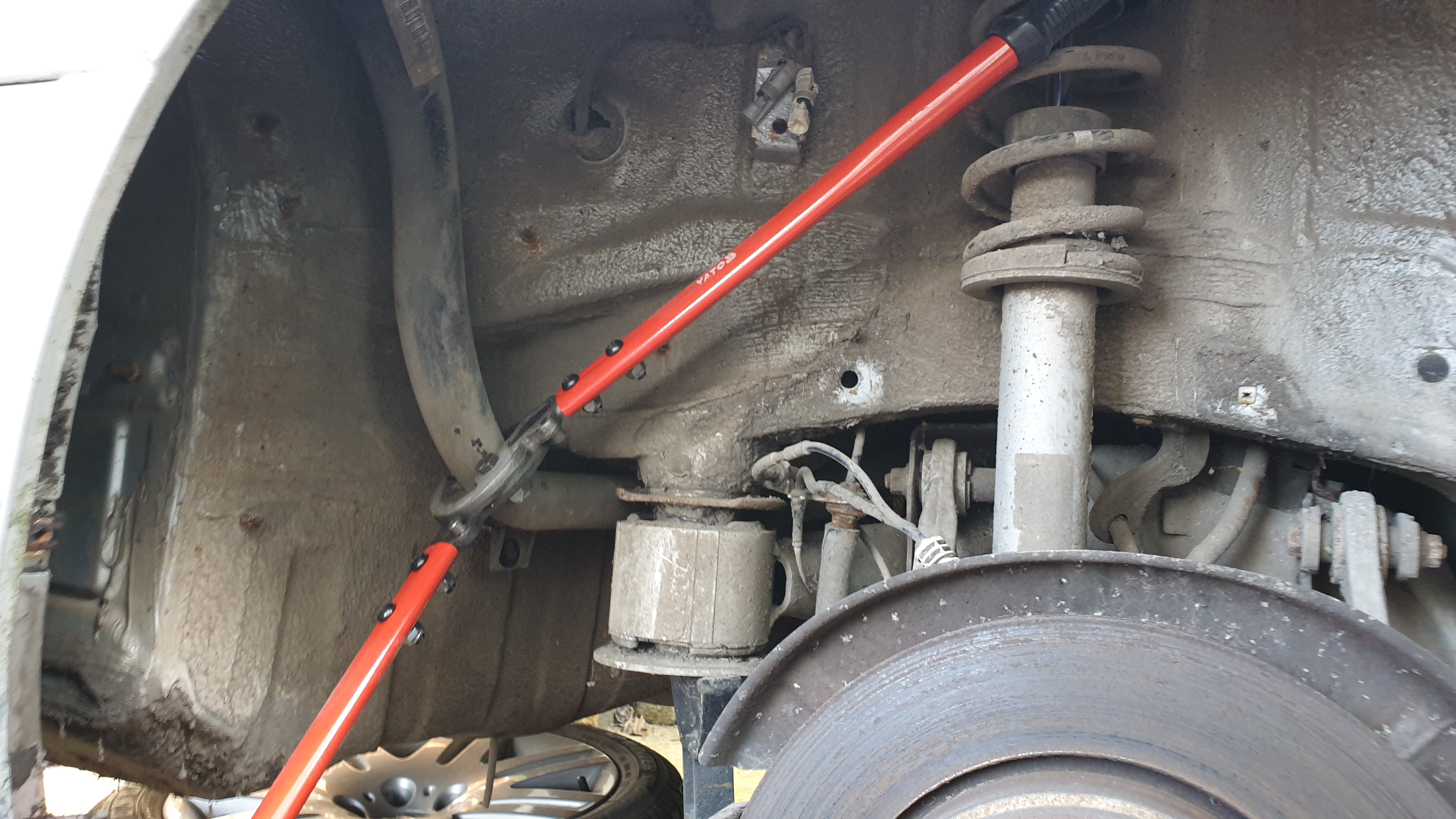

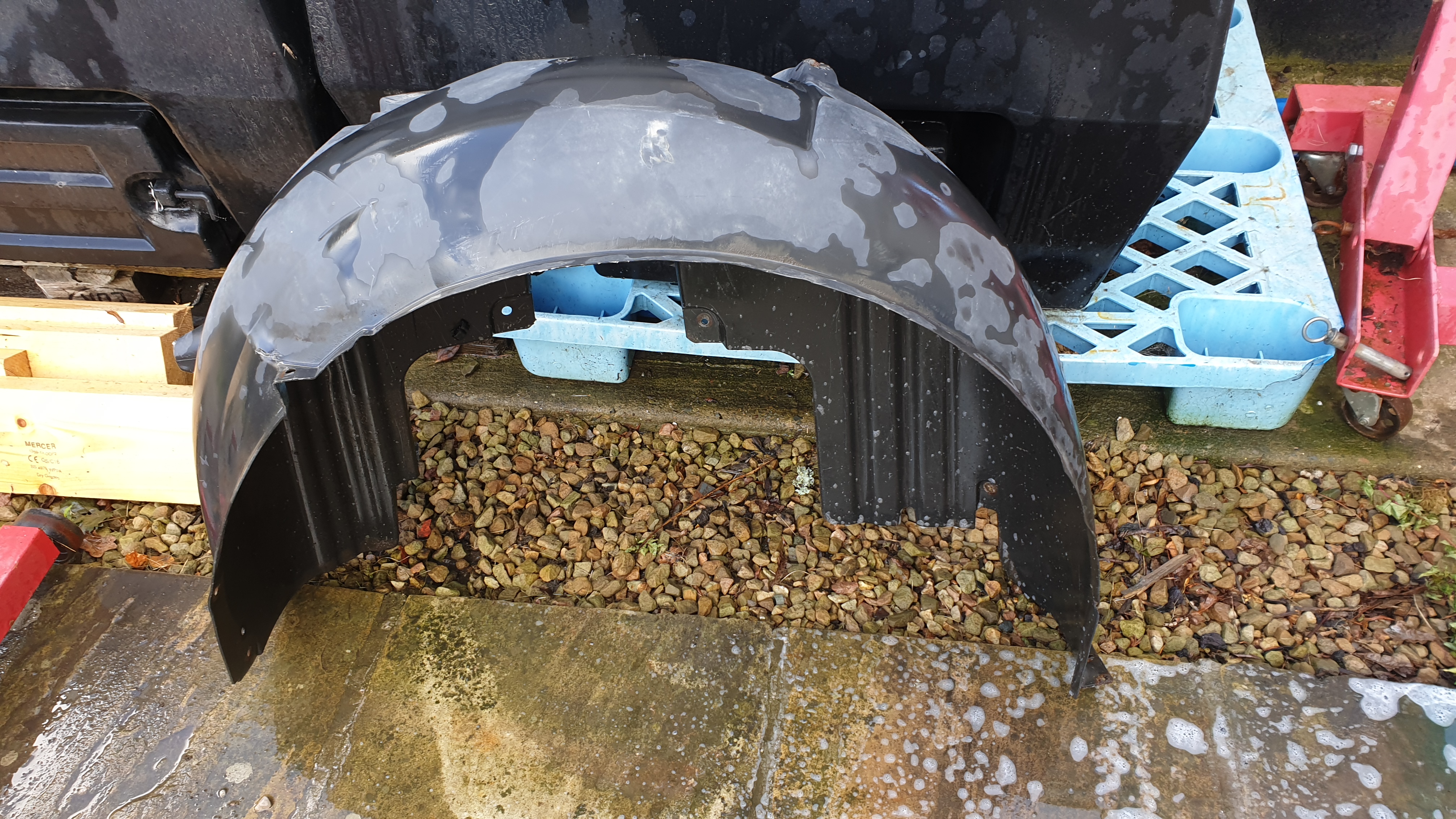

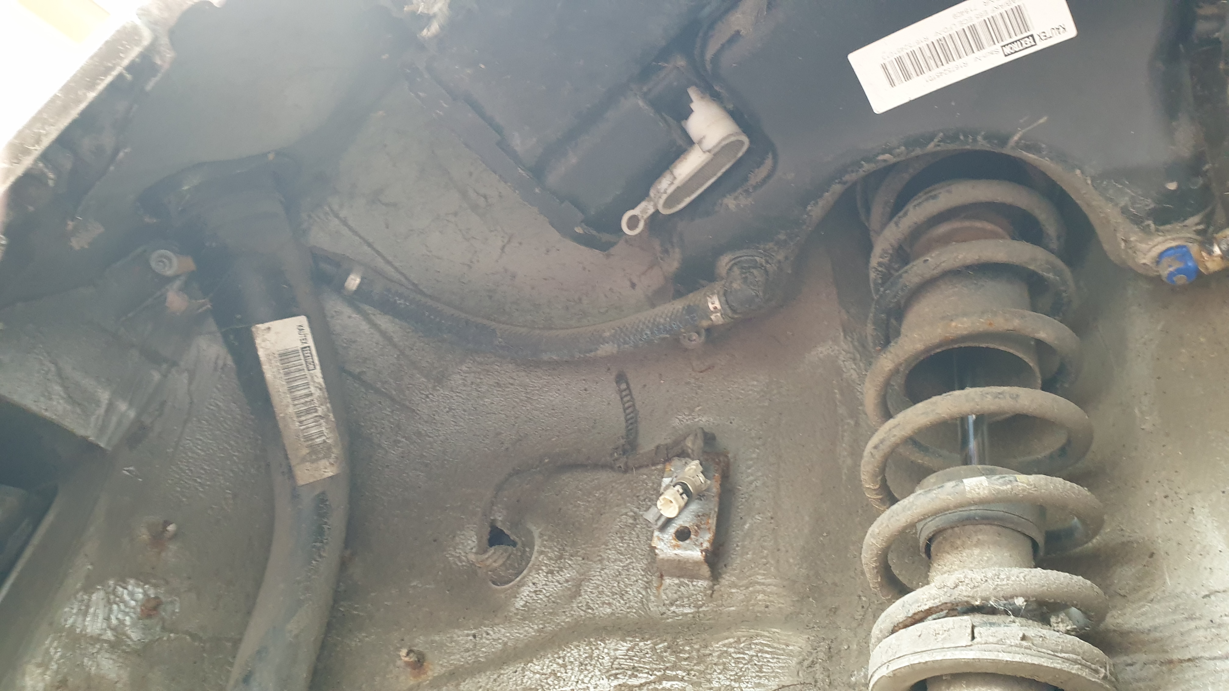

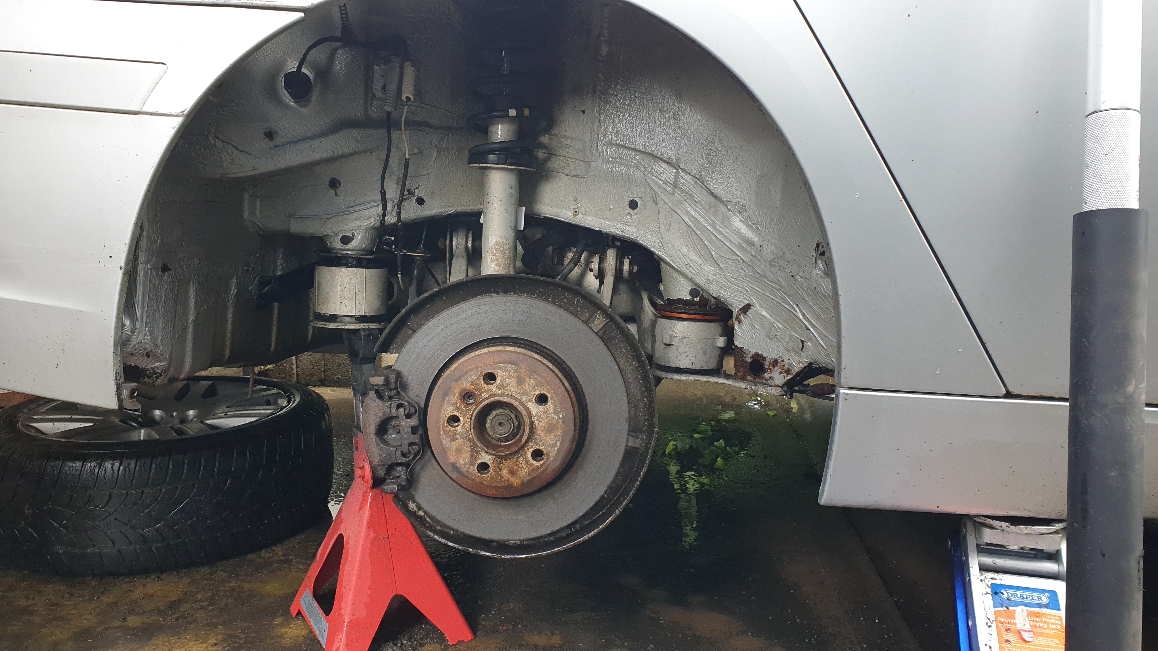

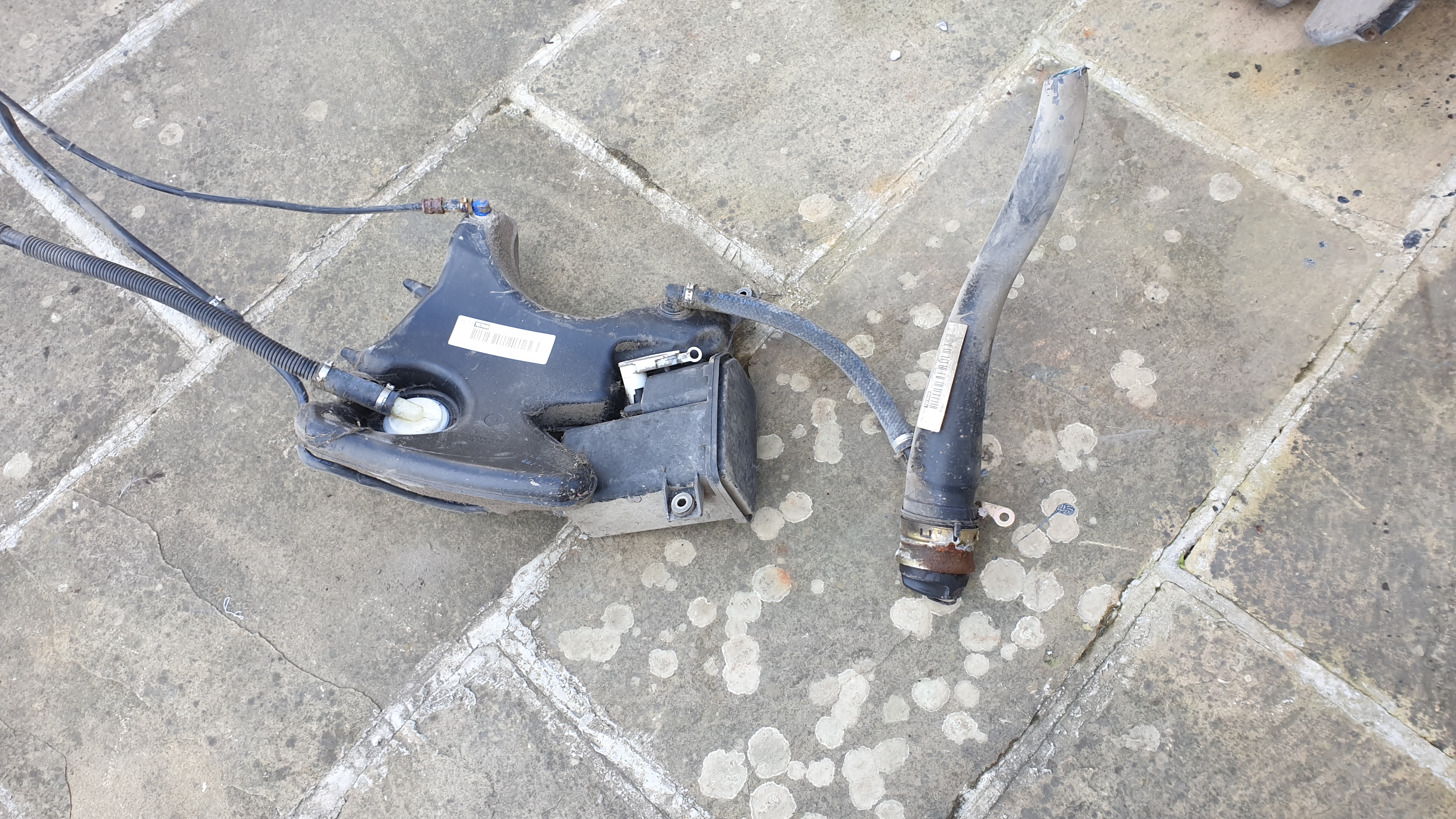

In today's SuperYacht adventures we cut the cord on the old fuel system, powerwash several kg of dirt out of the wheel well and get a donation of an EU Model 3 charge port and ecu for some CCS fun:)

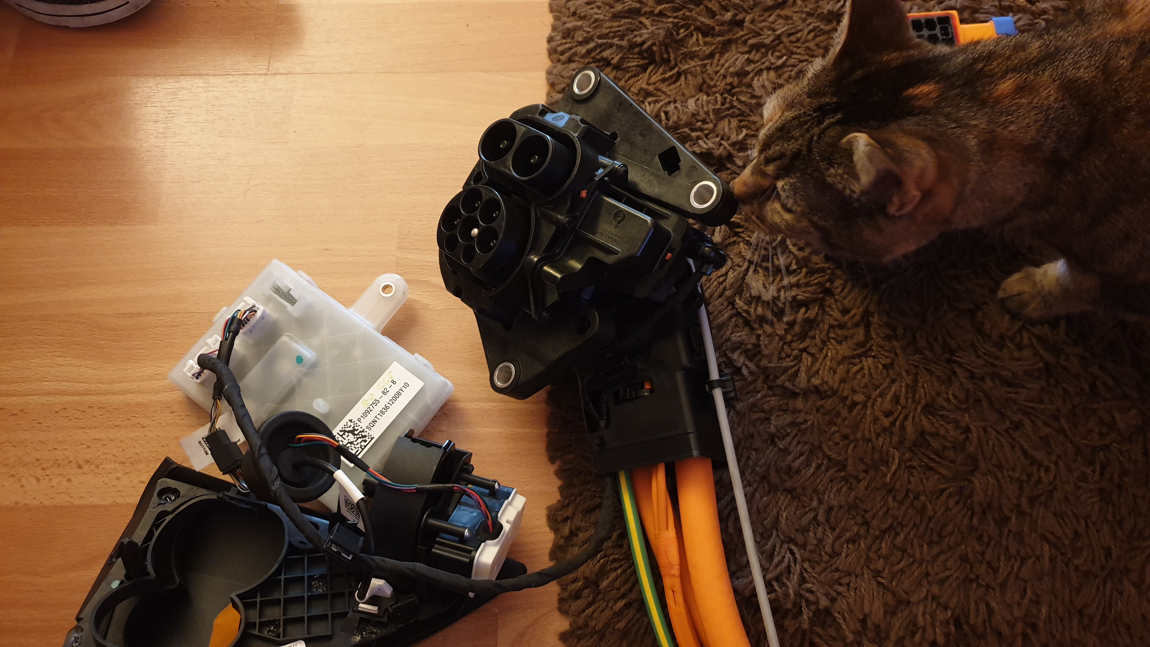

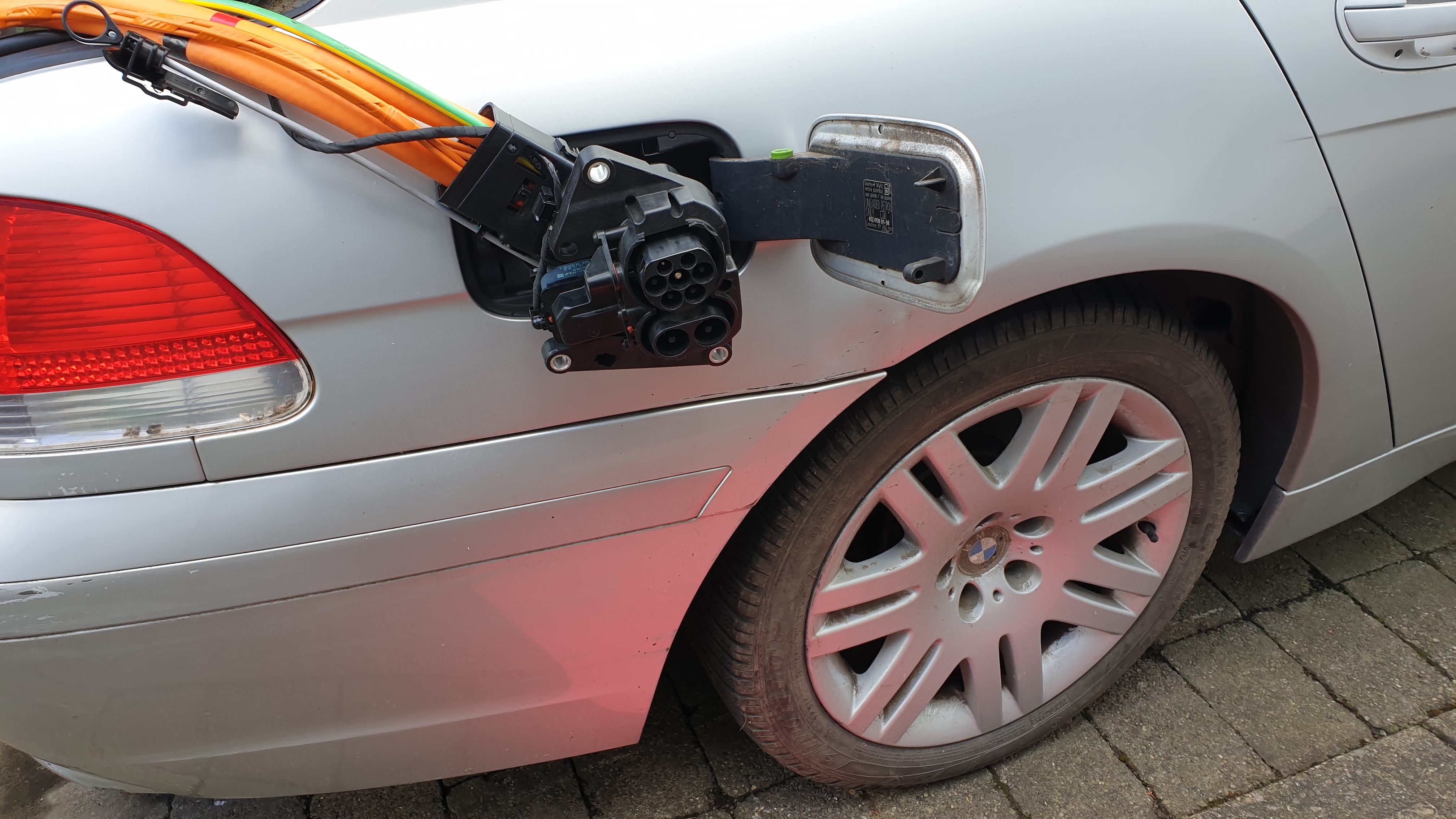

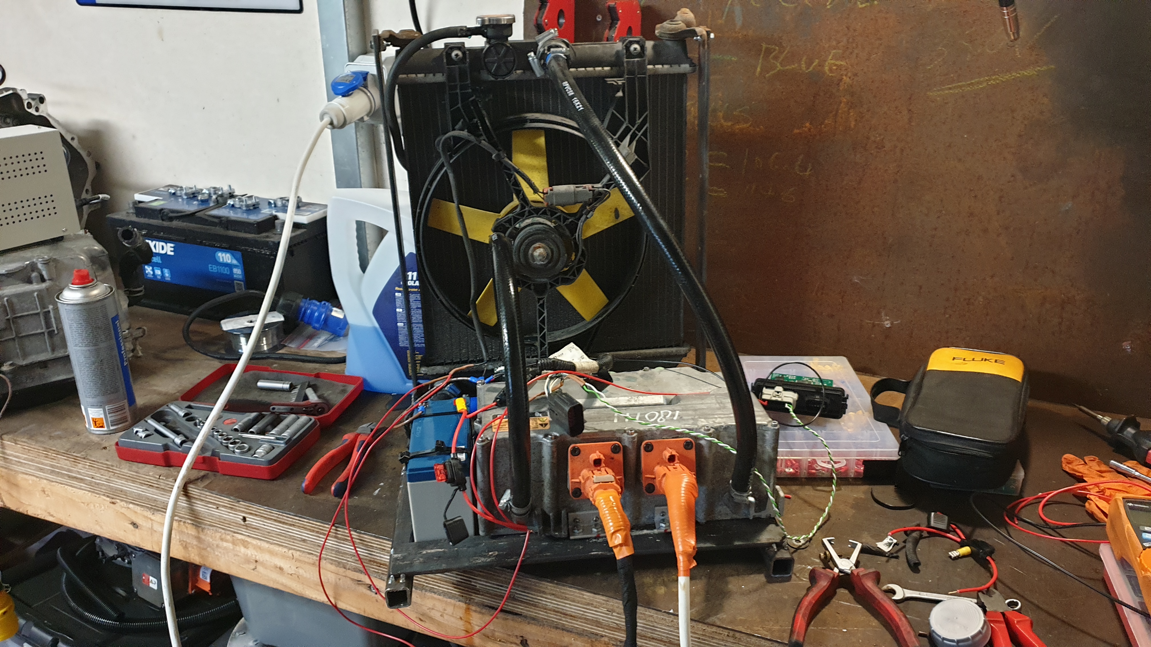

Now for the simple part : force feeding a Tesla Model 3 EU CCS charge port down the filler neck of a 20 year old 7 series.... :twisted:

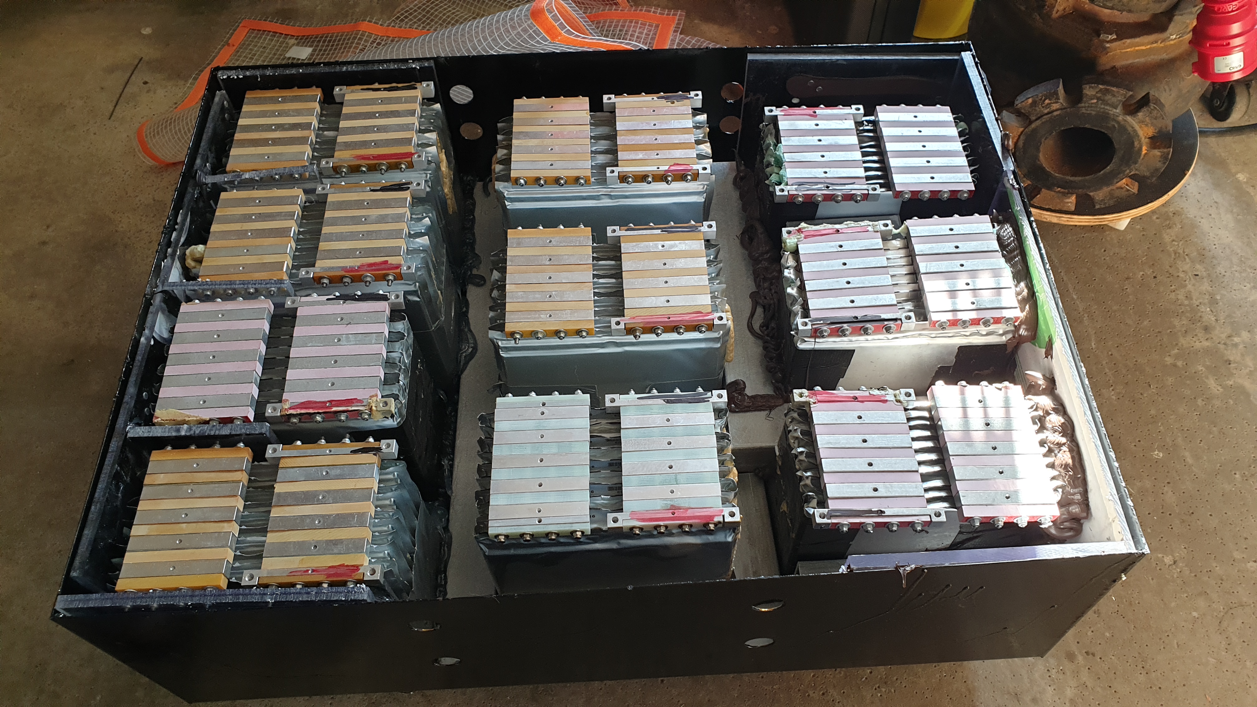

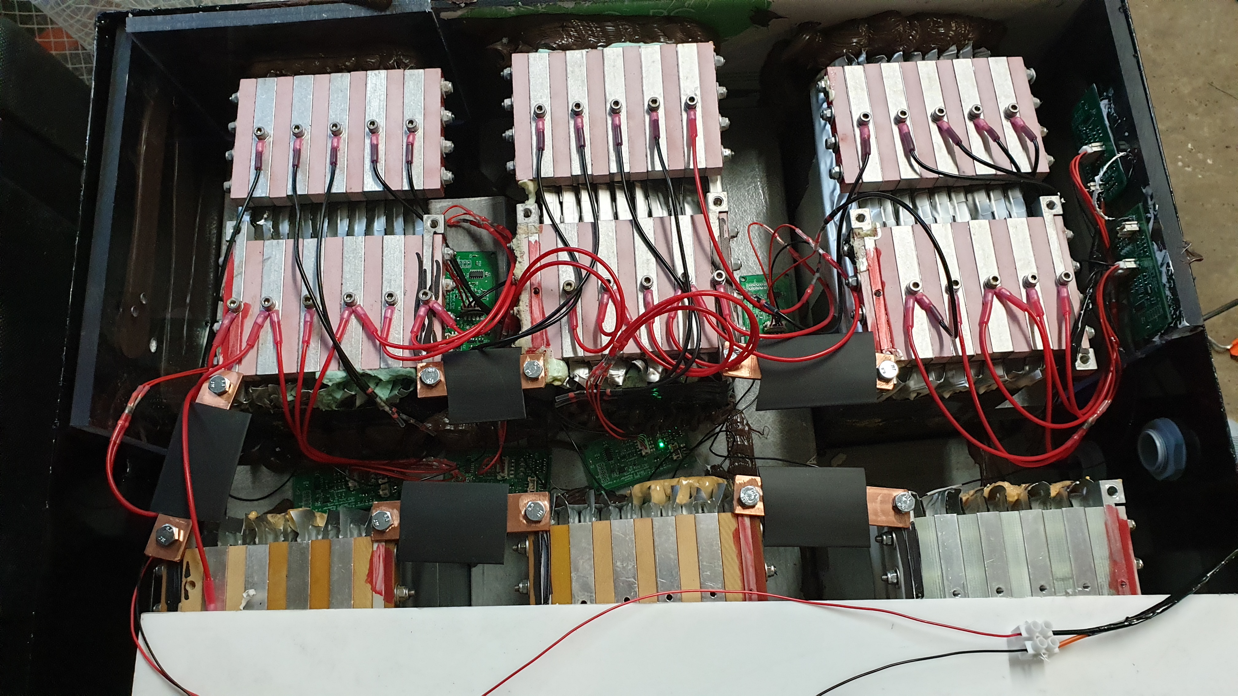

In other news the front battery box assembly is done. Getting my head around the OI bms now. Pro tip : trying to compile 8 bit avr c code with a 32 bit arm compiler is a bad idea :D

Jack Bauer wrote: Fri Oct 16, 2020 9:15 am Now for the simple part : force feeding a Tesla Model 3 EU CCS charge port down the filler neck of a 20 year old 7 series.... :twisted:
I hope the US version fits a little better than that..I'll be honest, I didn't measure the E46 opening before going down this path. :)
Jack Bauer wrote: Fri Oct 16, 2020 9:15 am In other news the front battery box assembly is done. Getting my head around the OI bms now.
What is being used to compress the cells together? Don't prismatic cells need some help staying in the correct shape?
Jack Bauer wrote: Fri Oct 16, 2020 9:15 am Pro tip : trying to compile 8 bit avr c code with a 32 bit arm compiler is a bad idea :D
:D :D That made laugh quite a bit this morning.
Hopefully we'll get this thing charging rapidly. (See what I did there? :))

I thought fitting ChaDeMo was hard, but this :o Though for some reason I think you will force it in anyway :D

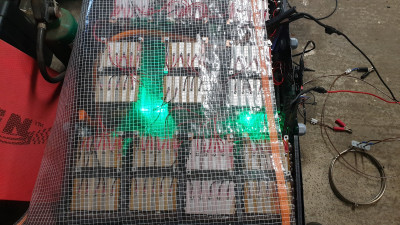

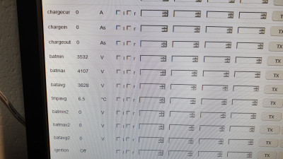

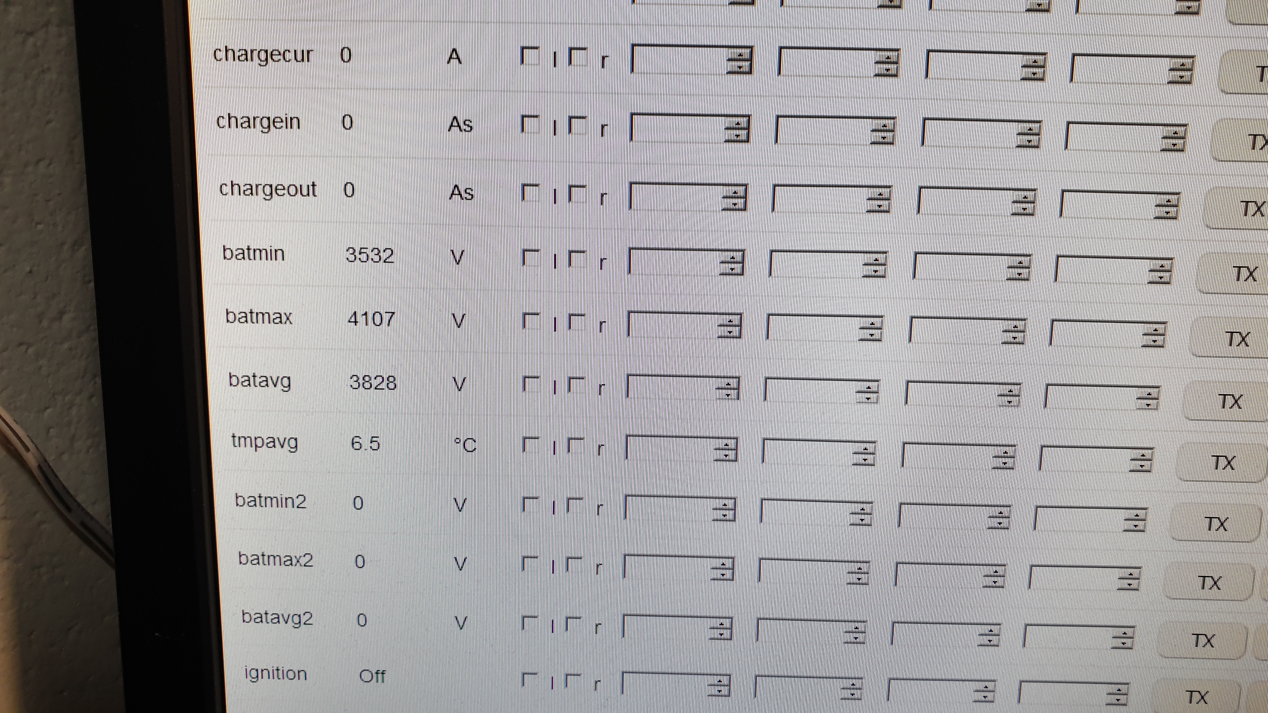

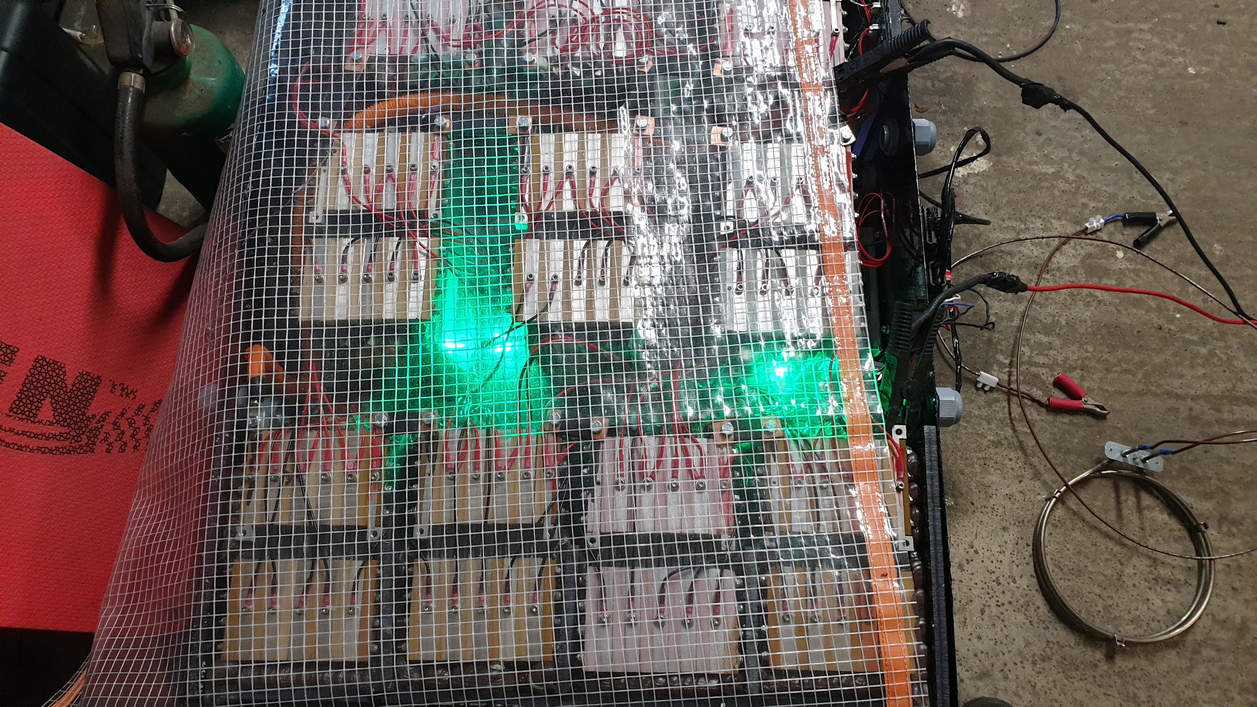

First success today with the Openinverter bms. 8 of the 25 boards fitted and talking in the front battery. Can't wait for the youtube comments when they see me working away with bare hands, no flash suit and no $$$ orange tools :)

Jack Bauer wrote: Thu Oct 29, 2020 2:00 pm Can't wait for the youtube comments when they see me working away with bare hands, no flash suit and no $$$ orange tools :)
Just tell them you have developed "internal resistance" to electrons... :O

I have a question on your new battery pack, are you planning on running those cells all in series? Or were you going to parallel the front and back boxes?
I'm kind of hesitant to parallel strings of cells, but I'm also a little hesitant to reconfigure my Kokam cells away from the 10s1p modules they came in.
Posts: 4005
Been thanked: 1130 times
Re: The SuperYacht BMW E65 7 Series
Front and rear packs will be in parallel. 100s in each pack so 100s2p.

That's interesting, I was lead to believe that parallel strings are best to be avoided. But I'm not going to argue, seemed a shame/lots of effort to undo the work that went into those 10s modules!

Smith Electric trucks used Valence batteries in parallel. Separate fuses, bmses, and contactors for each string.

I always thought that the not in parralell thing was only to be avoided where the packs would have different capacities , whereby one would discharge faster than the other and you would get current 'sloshing' back and forth between the packs whilst the voltages would try and settle.
However I by no means an expert so I could be wrong. :D
Edited, not completely correct, parralell strings must essentially independent with own contactors etc.
Added Orion pdf on subject

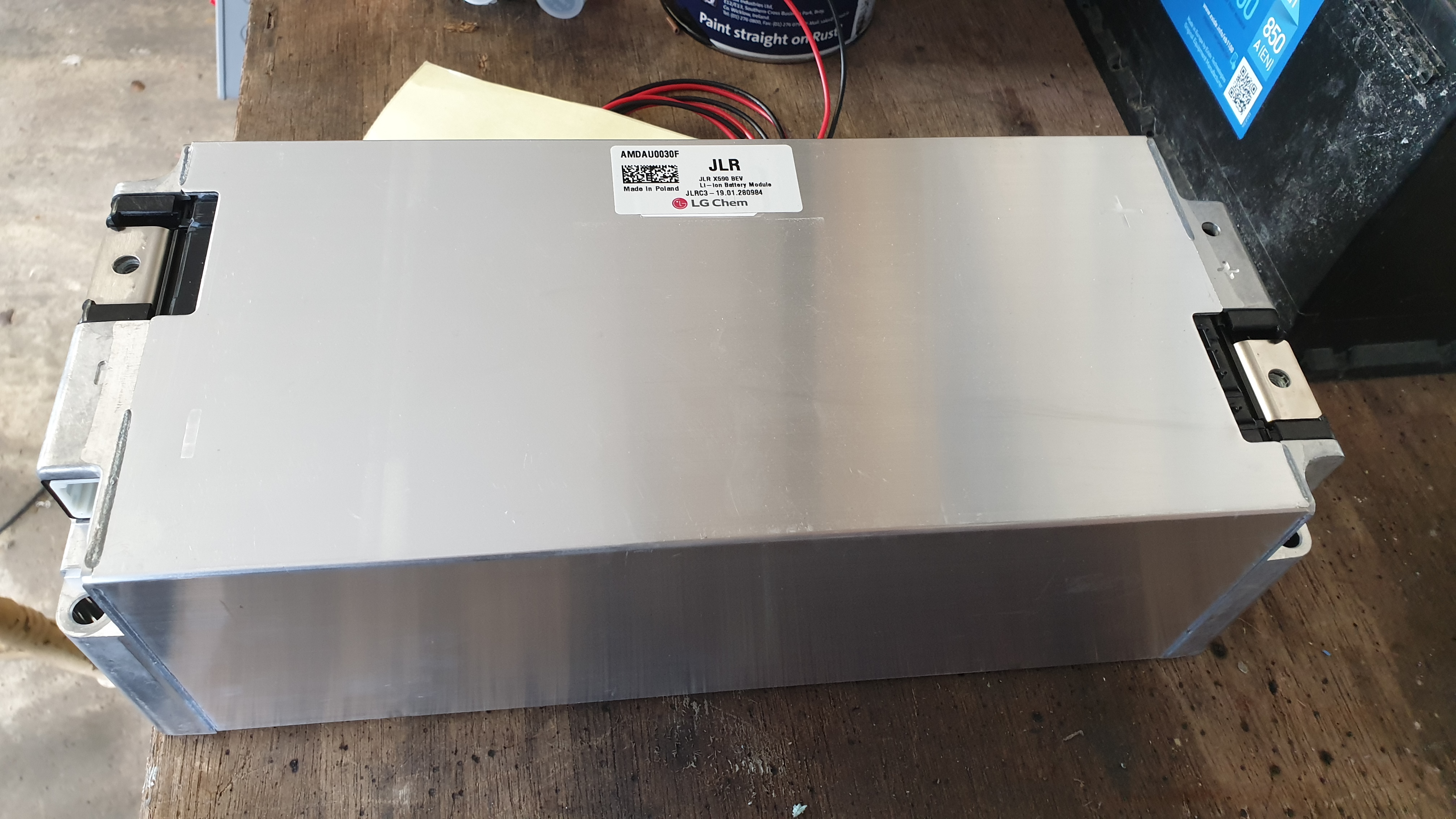

Got some new battery plans for the E65:)

Nice looking modules Damien (Jaguar I-Pace?). I wonder if you can fit all 36 modules in E65. That would be awesome.
