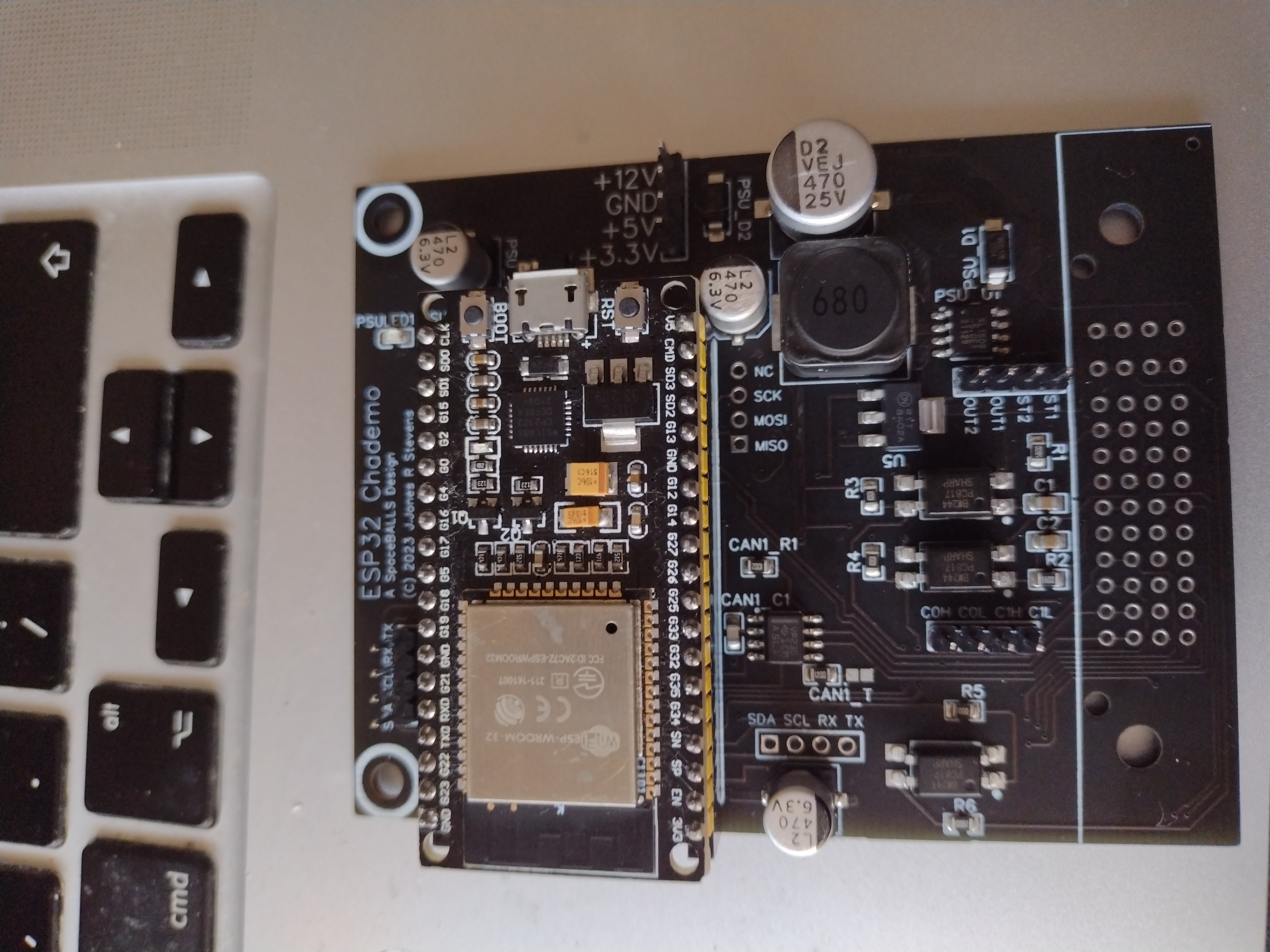

Are you using your own shield and Due for Chademo charging? I had a look at it but struggled to figure out how to use the PCB building service.
Have you any links or videos that would help explain the process?
- Posts: 1884
- Has thanked: 91 times
- Been thanked: 517 times
Re: VW - Beetle 2003
Is the video of the day.
@alibro, I am currently using the Due shield, but working on a standalone ESP32 port with Dues getting very expensive recently. Just need to debug a few more issues but might be a better option than the Due shield

Due is working fine. I think I have an old populated Due shield board if you want it? I'm just wanting to move away from the Due and ESP32 everything.

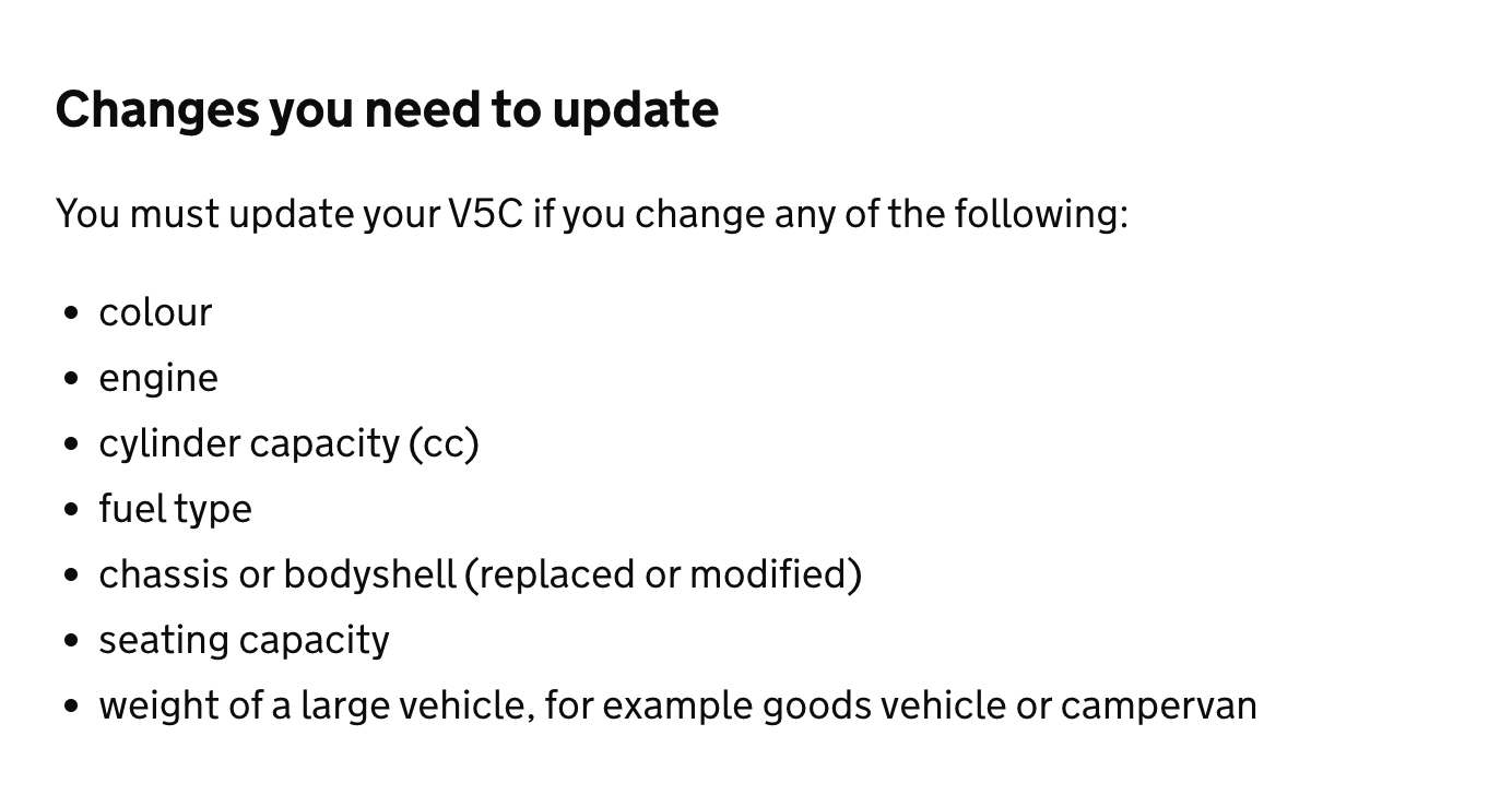

Hi, Has your Beetle been seen by DVLA now? Have they allowed you to change the fuel type to electric?
I have a 2002 3dr Golf MK4 TDI that I love dearly (apart from the stinky engine) and have been hanging onto it with an ambition to convert. But last year at fullychargedshow a company that does EV conversions said DVLA won't allow the fuel type to be changed for a vehicle registered after 2001.
- Posts: 1884
They've inspected it maybe 12 months ago now I think. They've not updated the fuel type and continue refusing to do so.
I've written to my MP multiple times, been in The Telegraph and a couple of other publications. Fully Charged weren't interested in covering it. Quentin Wilson keeps saying he's writing to the DVLA, I've been told the Office for Zero Emission Vehicles are also writing to them.
Since EVs are going to be taxed l, I've again written to my MP to seek for this issue to be addressed at the same time. I've asked for it to be referred to parliamentary review. No response.
DVLA won't budge without been ordered to do so, I don't have funds to taken them to court. So I've given up trying. I just pay tax as a petrol and point the stupidity out if anyone interested.
So they have a rule that you need to change fuel type but they don't do it?
What? If you change from petrol to diesel engine they would?
I don't get it, it clearly says in that picture that it must be updated.
Strictly speaking the battery box test has not been specified anywhere, there is nothing on the mot that requires it either, but probably a piece of mind they want before before testing it and if your not 1000% sure about your battery box would be highly advisable.
Dvla's stance currently is that a 2001-2017 tax class (co2) is set at manufacture and cannot be changed, because fuel type is linked to tax class therefore it cannot be changed, which is stupid as I have had a petrol car turned into an alternative fuel car (LPG) in the past.
In 2024 the current exemption will be removed and at least the fuel type can be changed from petrol/diesel to electric.
Zero ev claim to be doing work for DVLA on standards for an electric car tax class (conversion) however as they have a commercial interest in making it a closed club (similar to you have to be a uklpg installer to get fuel type updated) I remain sceptical what benefits this will actually give us ...or if they even listen to thair advice and create something totally bonkers.
As I have stated in other threads to make sure your car wouldn't be heading to the crusher:

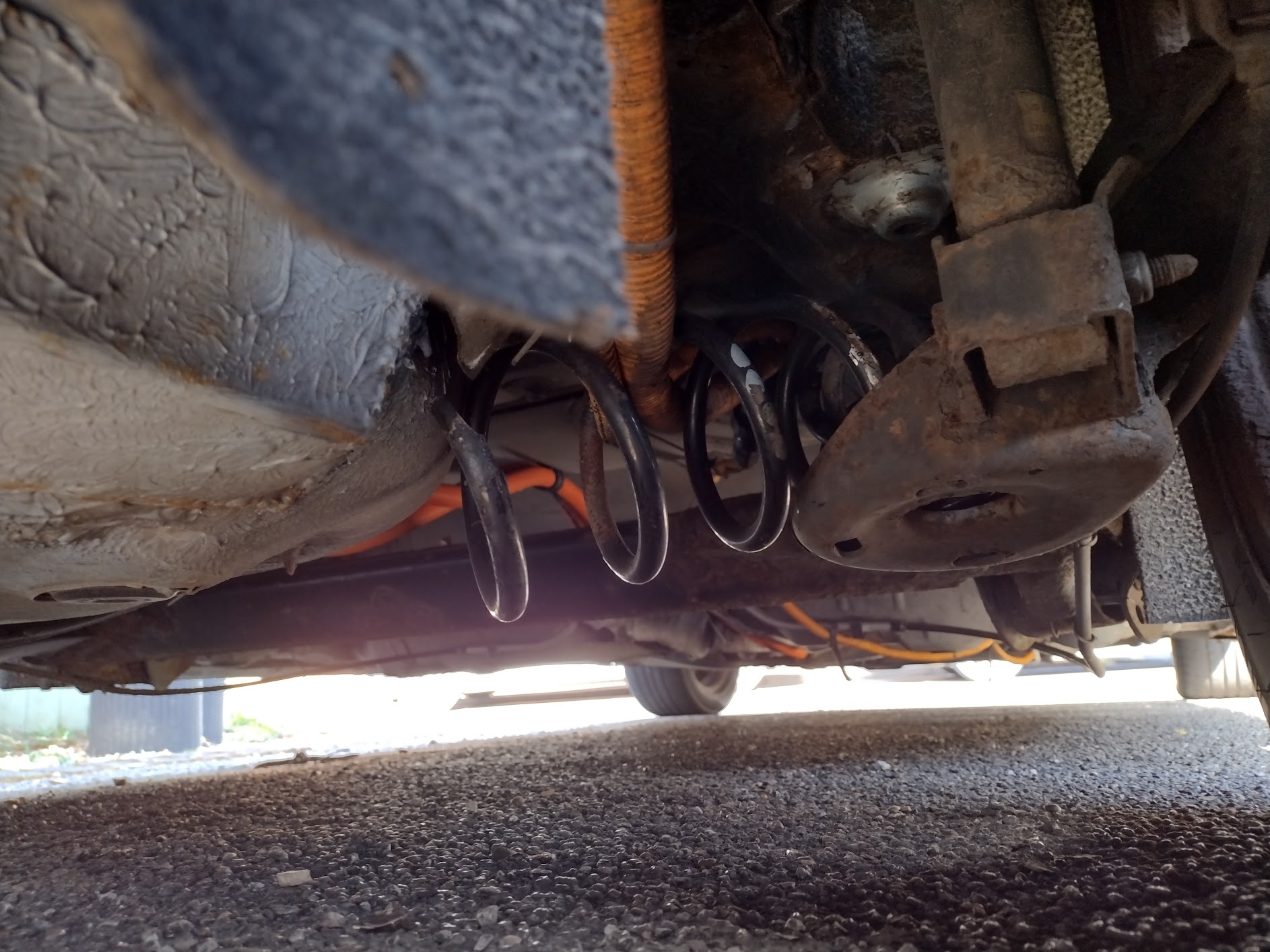

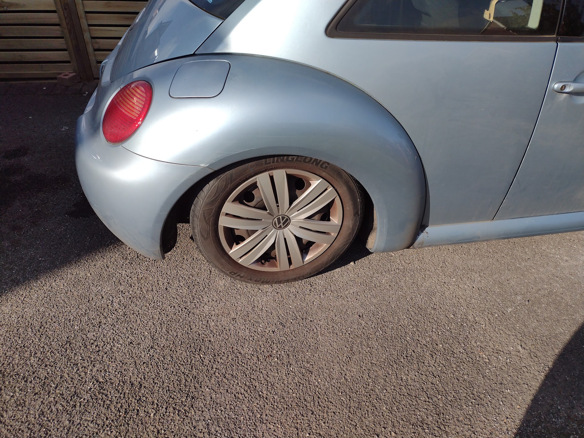

Cars been lowered
Unfortunately it wasn't desired.
I heard a clunk when I set off then the ride was pretty terrible.
- Been thanked: 1913 times
Wow, how did that happen? Did it take out that HV cable?
- Posts: 1884
No idea, I'm assuming it's rusted and snapped. Not had a good look yet.
