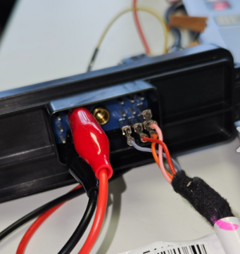

If understand correctly you are using the original cables but only one slave module connected, without modifications to the cabling? That will result in no rx-tx top loop. You would need to to a loop-back where the next module where do be connected. Or connect all slave modules as per original wiring.
Or have you already made this modification and there is another error?

Is my circuit for the MAX17841B chip correct? On page 1 of this tread there was a PDF document linked by you named "BMS.pdf". And your circuit is different than mine. Im using Manny's PCB listed on page 5 of this tread. I did a loop-back as listed in the "CMC devices" document attached to a earlier post of mine, is that way correct? I still haven't got it working.
Im using all original OEM cables without modifications to the cabling.
Re: Kia Niro BMS
Posted: Mon Nov 10, 2025 5:20 pm
by manny
To use the code with one module you will need to change the number of modules in the code.
The wiring needs to be looped. If my notes are correct.
If you connect the module to the first connector on the chain. Than in the second connector you will need to link. pin 1 and 9 (white and green) and pin 2 and 7 (brown and yellow).
Good luck.

How have you done the loop-back? Please take close-up pictures.
Also, is the pink wire broken or is it just a funny angle?

Yes I have done a loop-back and wired it to the BMS like Manny said, the pink wire is just at a funny angle
Ignore yellow wire on BMS PCB, that just for resetting MAX17841B chip

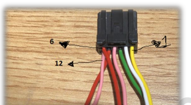

To me it looks like your pinout for the loop-back is wrong?
From the CMC documentation:
And looking at your loop-back:
Seem like loop-back is connected from pin1 to pin9 and pin2 to pin7?

I used the info in this thread to wire my E208 modules for dev work on the M3MAX bms
https://openinverter.org/forum/viewtopic.php?t=2465
Do not get confused by the connector orientations.
I based my software off of BMS_test_OI.ino found here on the forums somewhere.
