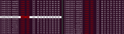

Re: Tesla Charger alternative firmware
Does increasing iaclim while charging break a GEN2 charger?
I was charging at ~16A DC @ 360V at a public charge point, ~29A AC.
Then I saw that iaclim was slightly lower than what the charge point could do and increased iaclim while charging from 29A to 32A.
The charge dropped off. Reconnected and I was able to charge for an hour after, but udc fluctuated*, then dropped out altogether, with only 1.5kW in 50mins delivered.
I think the DC wiring was fine, uaux is still showing at 12.62V, so DCDC was still on, and car drove home fine. Measured the cable from DC bus to charger today and had 0 Ohm resistance (under no load).
* = see video: https://youtu.be/6NOqiOUGcFc

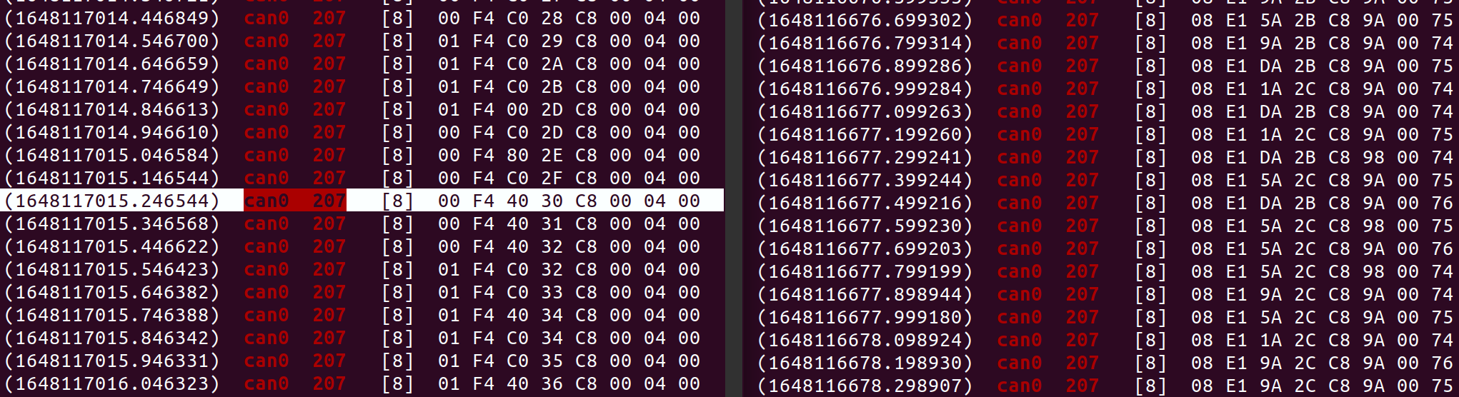

I just captured a CAN dump back to back with the now presumed broken charger and a working one on the bench.
hwaclim remains 0 for the presumed broken one.
according to this post:
0x207 32 to 40 (I hope I counted right):Jack Bauer wrote: ↑Tue Feb 02, 2021 6:25 pm 0x207 is the module 1 line status message. Available line current is in bits 32 to 40 as a 9 bit unsigned int with a scale of 0.06666. On the gen3 this will report as a little under 24A at power up and around 13 A on the gen 2 at power up.
working: C8 9C
broken: C8 00
Firmware:
working: 1.09R
broken: 1.10R
I suppose I have learnt my lesson to not change that param during charging, unless something else is afoot. I did change idcspnt before and that wasn't a problem, but maybe that was already wrong.
Any other thoughts?

Ok, one more idea: I have the wet charger here that still charges on one module and that can be sacrificed.
I can set CAN up to be dumped continuously and then we can stress it and see if we can get it to break while capturing?
