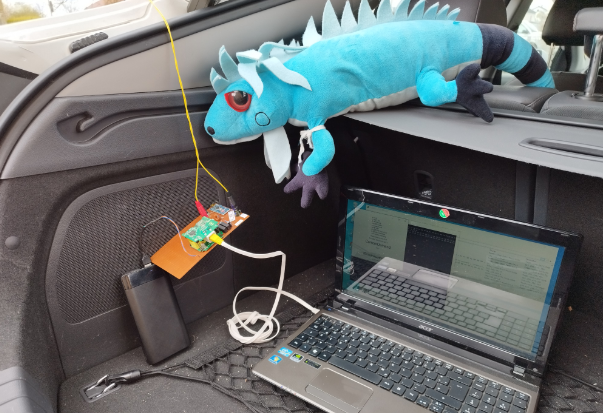

Two good news and a bad one.
Bad news first: The PowerDeliveryRequest, which is ignored by the Compleo, seems to have a format problem. At least, the message of the Ioniq is two bytes longer than the message of the pyPlc. On first look I did not find the relevant difference in the content. The short (pyPlc, fail): 809A0201E224253E54D0BA513222800A0800. The longer (Ioniq, ok): 809A02004080C1014181C2113222000006C00000.

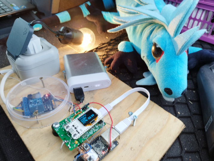

Good news one: The ESP32 variant successfully passed the light-bulb-demo on alpitronics charger. Used johus "screwed on wood" design
Good news two: While trying to understand the PowerDeliveryRequest issue, I gave a try and pretended a precharge to my Ioniq car. Without any physical voltage applied to the DC pins, just sent a simulated rising EVSEPresentVoltage to it. And: Baaang!!! The car closed the contactors. I have let it run for several minutes, the car does not run into timeout. Good basis to try to draw energy out of the car.

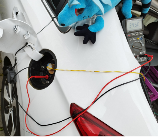

Went to a 50kW Tritium Veefil with the newest pyPLC. It seemed eager to give me voltage. This is a different charger brand compared to what I was testing on previously.
The HV terminals weren't connected to anything except the inlet voltage measurement board, which was sampled every 5 seconds (search for the "inlet_voltage=" lines)
Attached are logs, this time including the pcap log. (pcap is zipped as the forum doesn't allow attaching .pcap files)
To me it looks like the charger overshot the voltage by a huge margin (as there was no load whatsoever) and then ended the session because of that. Is that correct? Thanks in advance if anyone decides to look through the logs to see whether something's still subtly wrong.
I'm going to go ahead and start plumbing the HV.

The EVSEPresentVoltage should be the same as the physical inlet voltage. If not, I guess something is wrong with the HV wiring or measurement.
The contactor shall be closed when this sequence is reached:
[55058ms] [PEV] PreChargeResponse received.
[55059ms] [PEV] EVSEPresentVoltage 245.0V, U_Accu 246V
[55059ms] [PEV] Difference between accu voltage and inlet voltage is small. Sending PowerDeliveryReq.
Maybe this is not implemented correctly, I was focused on the lightbulb-demo only in the past. You could add the logging of the physical inlet voltage at the same place, and check, whether all three voltages (TargetVoltage, EVSEPresentVoltage, physical inlet voltage) are the same. If this is fulfilled, the end of precharging is reached, we shall close the contactors and send the PowerDeliveryReq.
