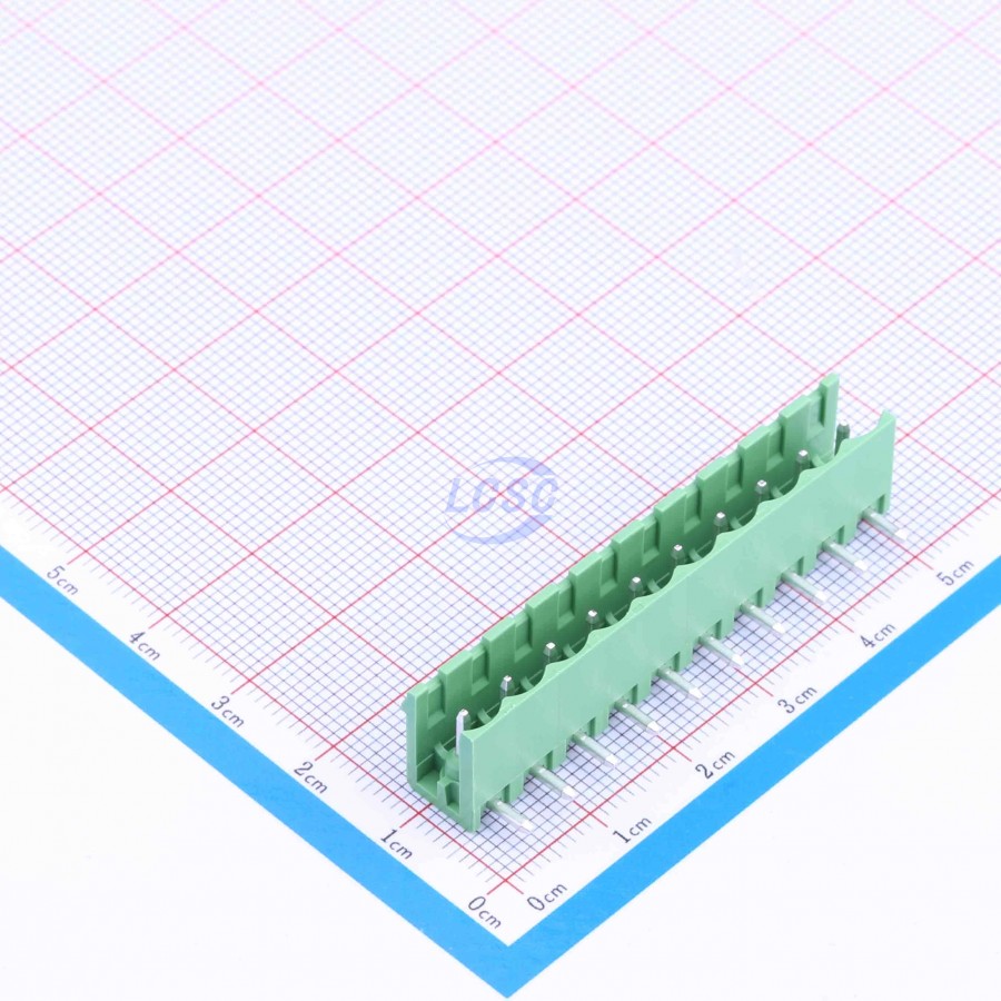

I've bought two of 2EHDR-10P and two of 2EHDR-6P
Pins are 1mm thick so I have some doubts if they fit into holes, as my board already populated and Damien used twin sockets I can't identifie, and pins are covered in solder so I can't say thickness of pins.

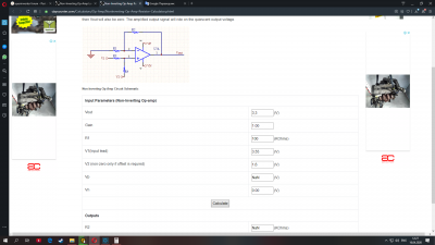

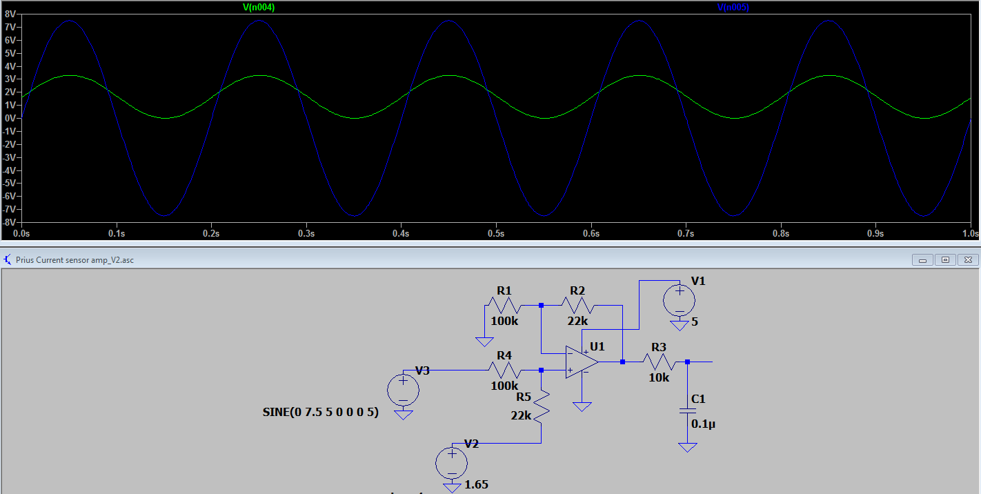

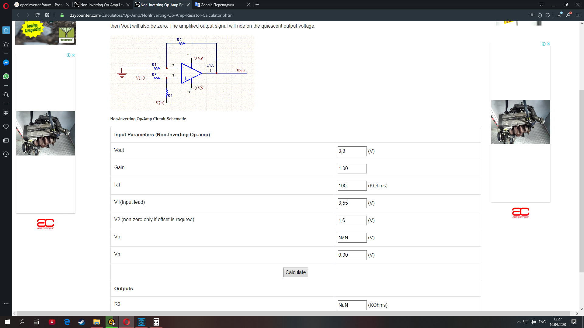

SciroccoEV wrote: Thu Apr 09, 2020 9:09 pm Once again; Bipolar, ie voltage output is both positive and negative, 25mv per amp.
And just to try and keep the length of this thread down; https://daycounter.com/Circuits/OpAmp-L ... fter.phtml
For example, I'm going to feed to inverter no more then 200Amps.
According to Johu's equation of DC to AC current => 200/1.41=142A at one phase.
And according to your quote: 142*0.025=3.55Volts. So inverter will show me no more than +-3.55 volts and it is Vpp=7.1V
We want to convert a 7.1Vpp signal to a 3.3V signal so the gain should be 1/2. We can choose........
And from this one I can't use your calculator, as it only says "NaN" to me every time :cry:
Yes, I'm this far from electronics...
Can someone please explain me, what I do wrong and write me the rest of the equation?

The Prius Gen2 current sensors are bipolar 15Vp-p, not 10V or 7.1V. Use whatever you like as the 1.65V reference, what is critical is the OP amp output does not saturate as in the case of FOC accuracy of the current input is important to the control algorithm :

konstantin8818 wrote: Thu Apr 16, 2020 4:23 pm
kiwifiat wrote: Thu Apr 16, 2020 4:16 pm The Prius Gen2 current sensors are bipolar 15Vp-p, not 10V or 7.1V. Use whatever you like as the 1.65V reference, what is critical is the OP amp output does not saturate as in the case of FOC accuracy of the current input is important to the control algorithm :
Thank you very much!
If you plan on using the schematic make sure you change C1 to 1nF, the cutoff frequency with 100nF shown is too low.
