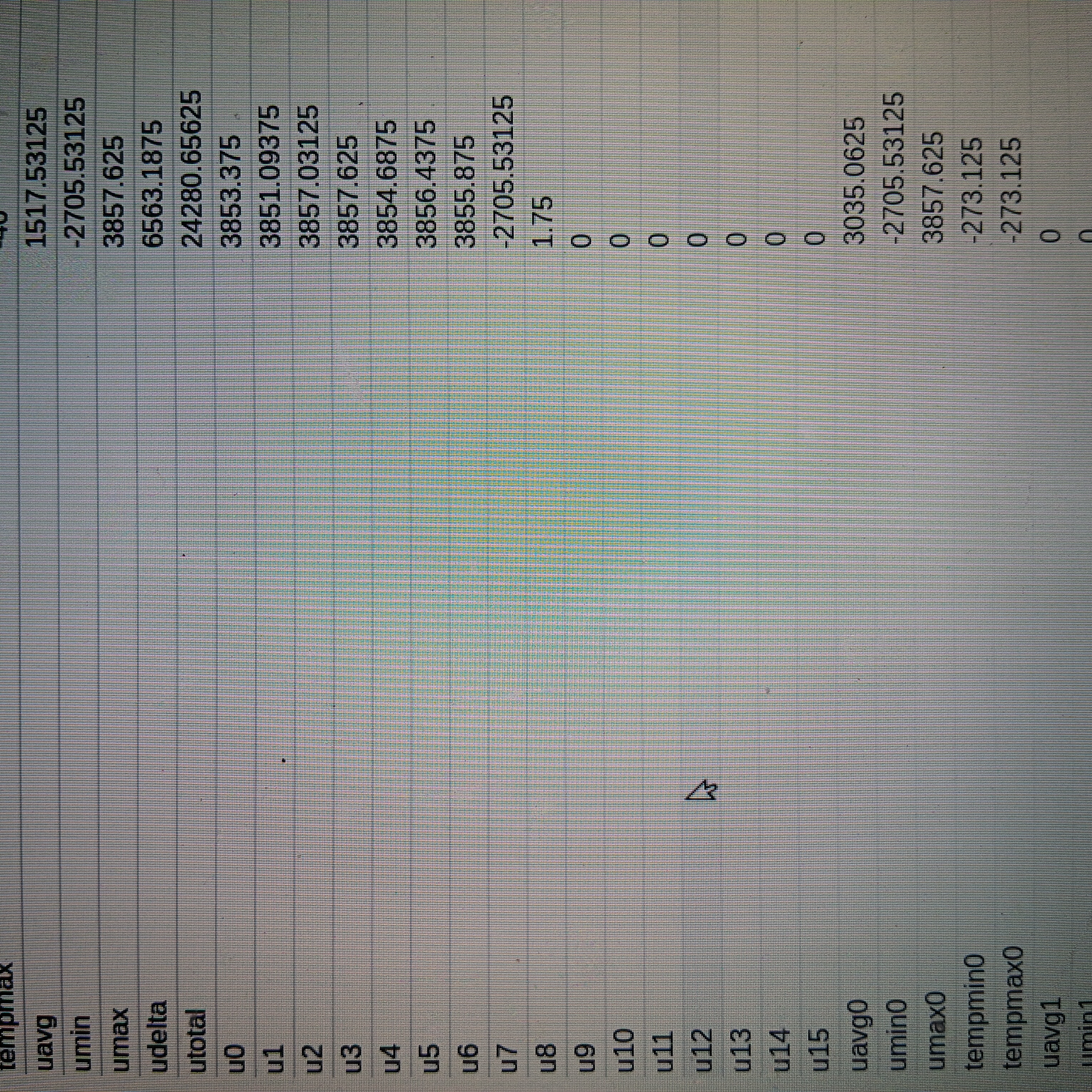

I finally got around to testing my BMS boards today. After updating them all one by one to the latest firmware 0.20B (when I tried doing multiple over CAN it bricked a board and or stopped communicating with others and required the bootloader and firmware flashing using an STLink again).
So, things I've noticed on my 9S bench setup. Whatever the last module is, has a negative reading of around -2.7V, show below (cell 8 or U7 in this example but occured whichever cell was last)
2nd the spot values shows total cells as 16 regardless of the number of channels selected in params. This also is the same for opmode which shows RunBalance despite balancing being switched off. fixed by deleting JSONs and Bins in files.

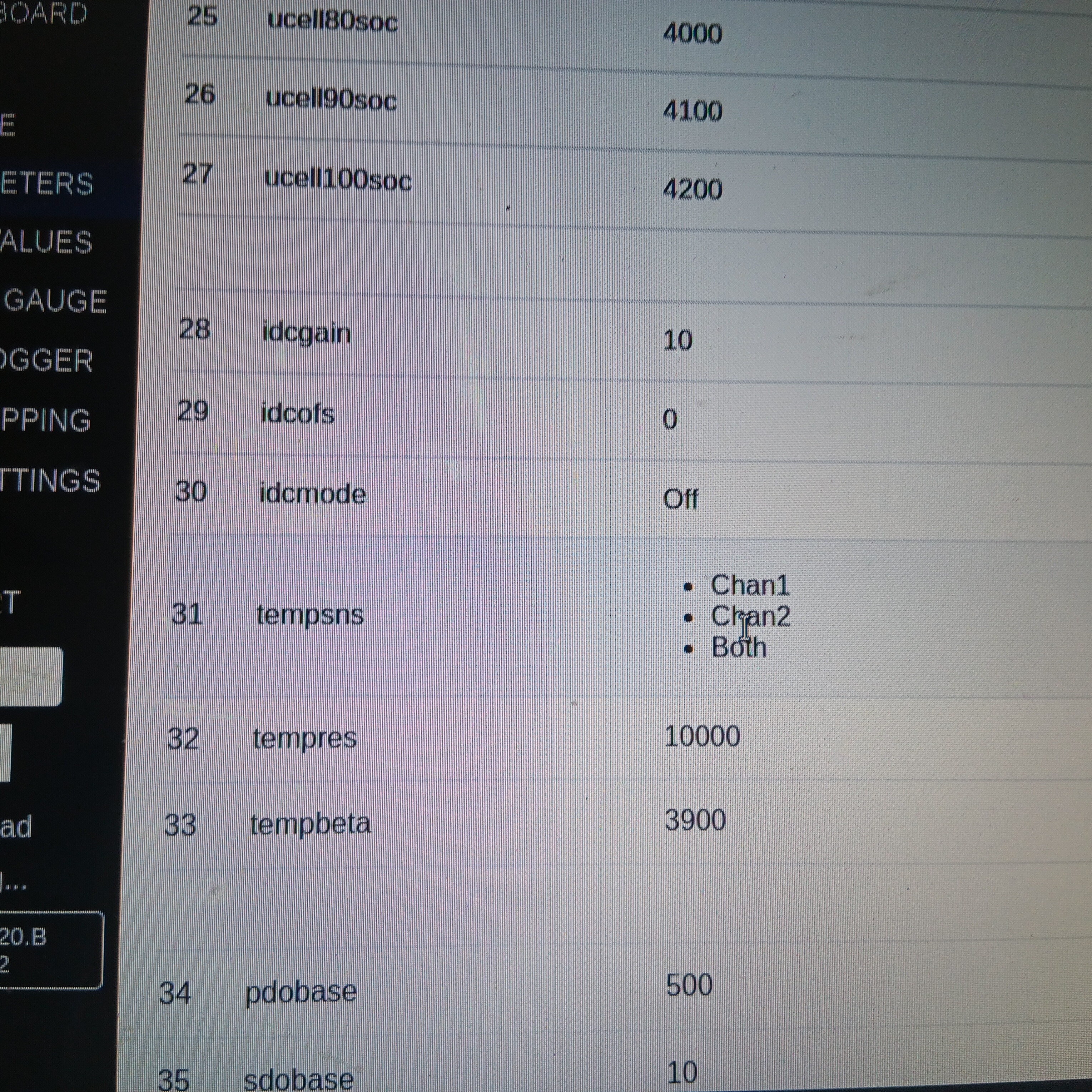

Lastly, I tried to connect one of the temp sensors but the sensors on my modules have 2 wires each. I tried one to gnd and one to the tempS1+ input and also both to twmpS1+ and TempS1- but neither option resulted in a change in the temp values in spot values, this may be related to not being able to select a temp sensor from the drop down (see below)

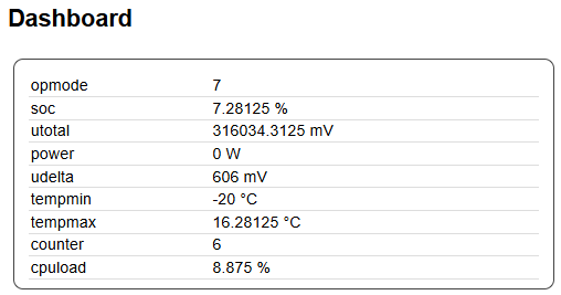

Oh and lastly, the dashboard never updates.

Oh and another one, the dropdown to select temp sensors doesn't work, (see image below) nor does saving parameters for me. I've deleted all the JSON files. fixed by deleting the binary which now also fixed the total totalcells issue in spot values and doesn't seem to want to force balance all the time. Other issues remain

If you only connect 9 cells you have to set numcells to 9, save and power cycle
tempsns loaded the previously saved value of -1. Go to dashboard and write "set tempsns 0". Then you get the dropdown back. But this only lets you select if 0, 1 or 2 sensors are connected. The sensor itself must be NTC and must be parametrized with tempres (resistance at 25°C) and tempbeta (coefficient from data sheet).
By default balancing starts 60s after power up or in fact 60s after idcavg settled below 1A. You will see opmode changing to RunBalance

Any idea on why the last cell is showing as a negative?
Re: balancing, I have balancing turned off on parameters, should this stop RunBlanace showing at all? it's a little confusing if not.
Been thanked: 1918 times
Re: Switched ADC BMS
Jacobsmess wrote: Thu Jan 30, 2025 12:38 pm Any idea on why the last cell is showing as a negative?
Is there anything connected to that input? The first unconnected input always shows a negative number, the subsequent ones show 0.

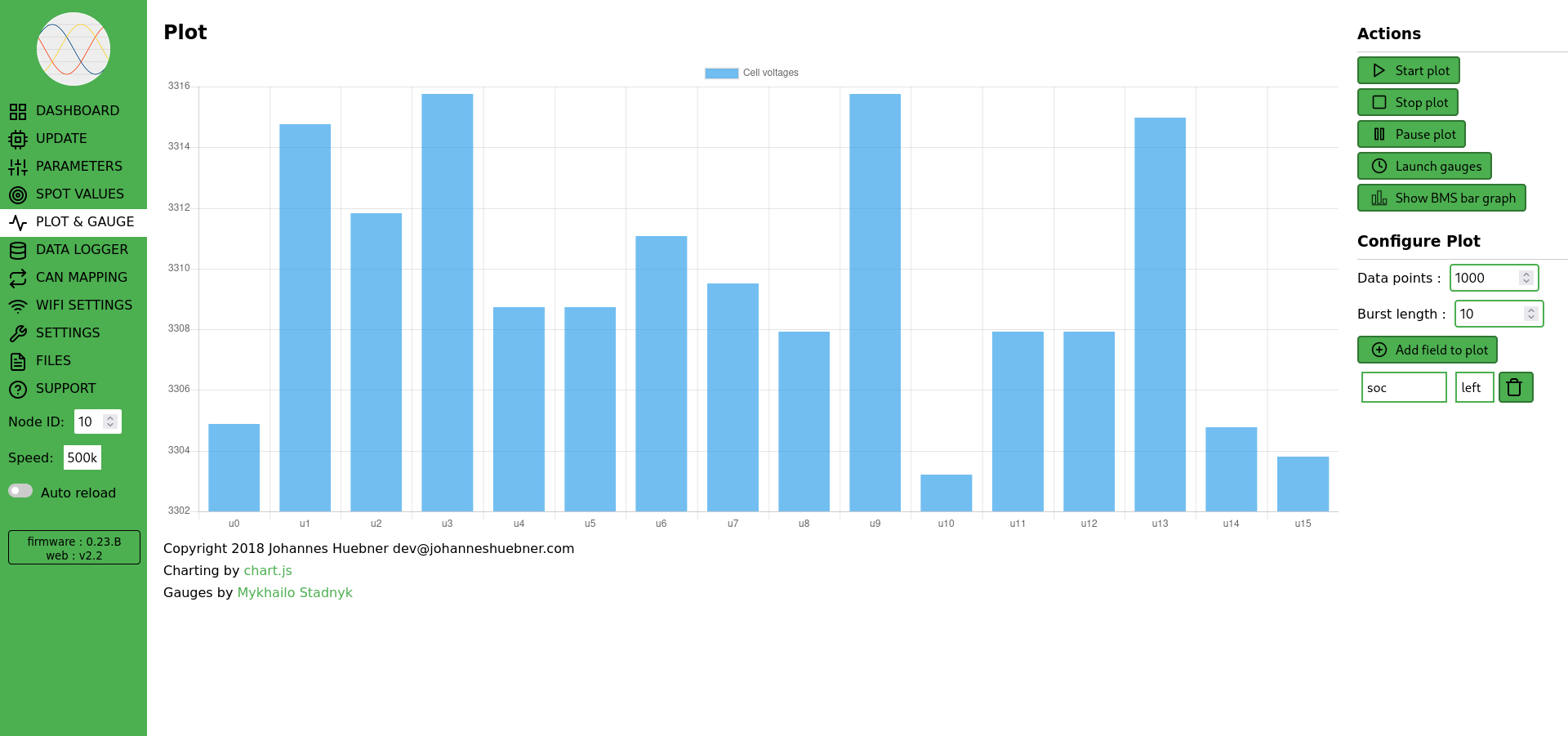

I added a simple bar graph to the web interface. https://github.com/jsphuebner/esp32-web ... f67db59e21
Can be found under "Plot & Gauge" by pressing "Toggle BMS bargraph". Thanks to Patron Phil for the symbol 👍
Would be cool to extend it to sweep across all sub modules

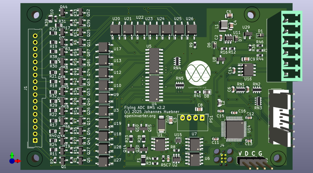

May I ask regarding the production files - any other bodges I may need to do apart from the gate pulldowns between V 2.0 and 2.2?
Just that.
The change from 2.0 to 2.1 was reverse polarity protection of the 12V supply and a constant 3.3V supply for Vbat. You can't bodge that one in I'm afraid.
From 2.1 to 2.2 the pull-downs were added and R9 lowered to 100 Ohms

Without seeing the schematic it is hard to visualize what constant 3v3 for Vbat means in this context, my guess is if I supply constant 12V - 2.0 with bodged pulldowns and R9 would still be useable?
I hope to order my "BMS manager" tonight on JLC, so just wondering if I have some chance of not having to excessively worry about the usage of 2.0 apart from my own assembly mistakes.
I have published the latest manufacturing files on Patreon now.
