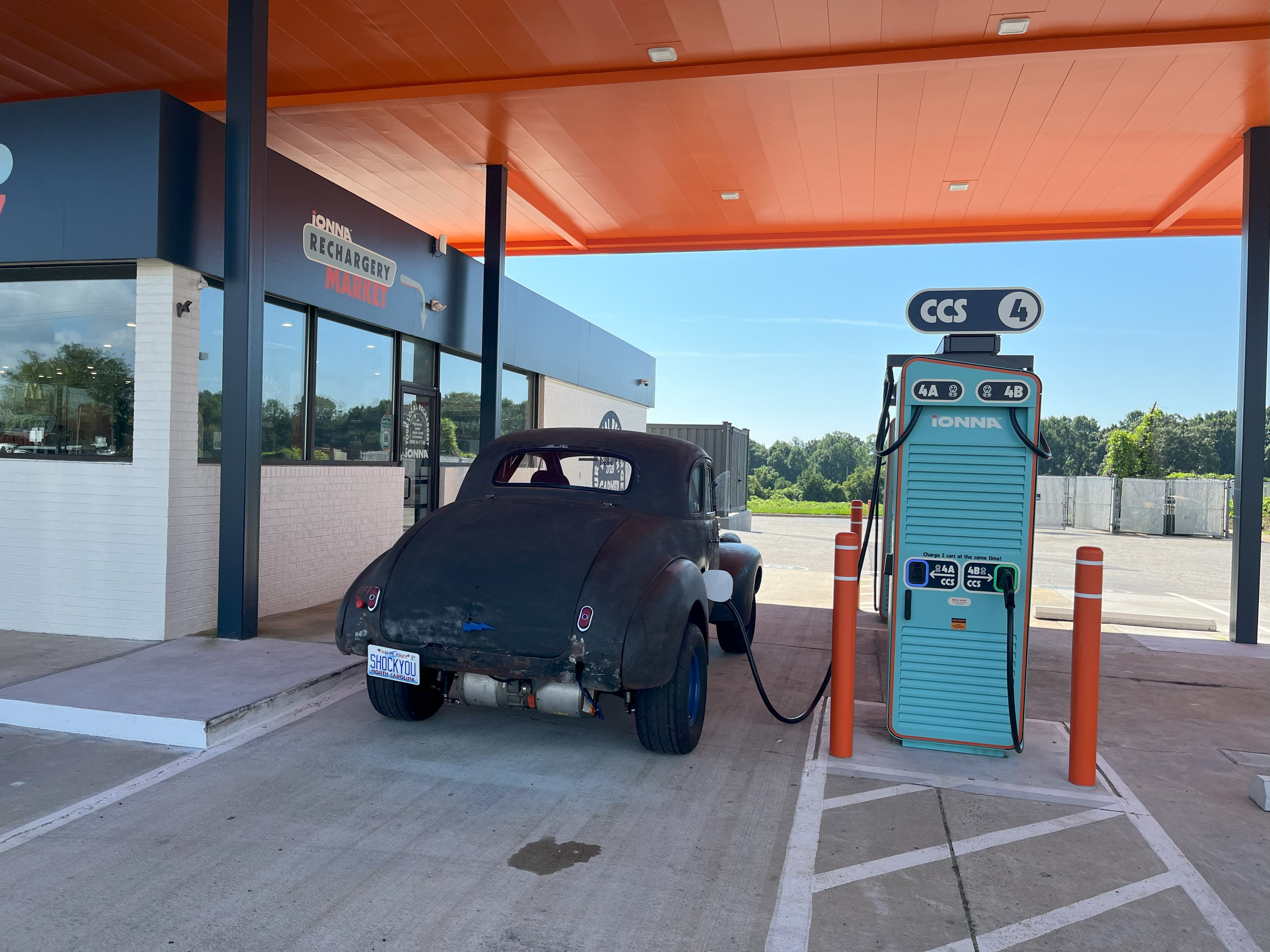

Got the inverter swap done last night. Left the drive unit in the car and just dropped the suspension enough to pull the inverter out, which can be a bit of a pain but is less of a pain than dropping the whole drive unit.
Only had time for a quick drive down the street to make sure everything worked, hoping to do some tuning this week and maybe a track test next weekend.

Paul, when you built this car did you weld the rear sub frame in or is it mounted on the rubber bushings? I was thinking about using your same suspension swap on some GMs with a 4-link. Thanks
P.S.Mangelsdorf
Posts: 1049
Location: Raleigh, NC, USA
Has thanked: 221 times
Been thanked: 256 times
Re: [DRIVING] 1940 Chevrolet with Tesla Motor
Post by P.S.Mangelsdorf »
dbc105 wrote: Mon May 05, 2025 11:20 pm Paul, when you built this car did you weld the rear sub frame in or is it mounted on the rubber bushings? I was thinking about using your same suspension swap on some GMs with a 4-link. Thanks
The forward two bushings are in place, the middle point is bolted to the car's frame.
However, I don't recommend using this solution. The subframe prevents the drive unit from getting as high up in the car as it should be, leading to weird axle angles and the combination of a tall ride height and low hanging drive unit. Also, the GTO rear suspension is known to have camber issues (and no real adjustment) and I have had issues with that.
A better approach might be using the GTO hubs and trailing arms with custom mounts, rather than trying to use the subframe like I did.
If I was to build this car over again, I'd probably go with a de Dion style axle. In fact, I'm working on designing one for the next race car, which I'll be pairing with a parallel 4 link.
