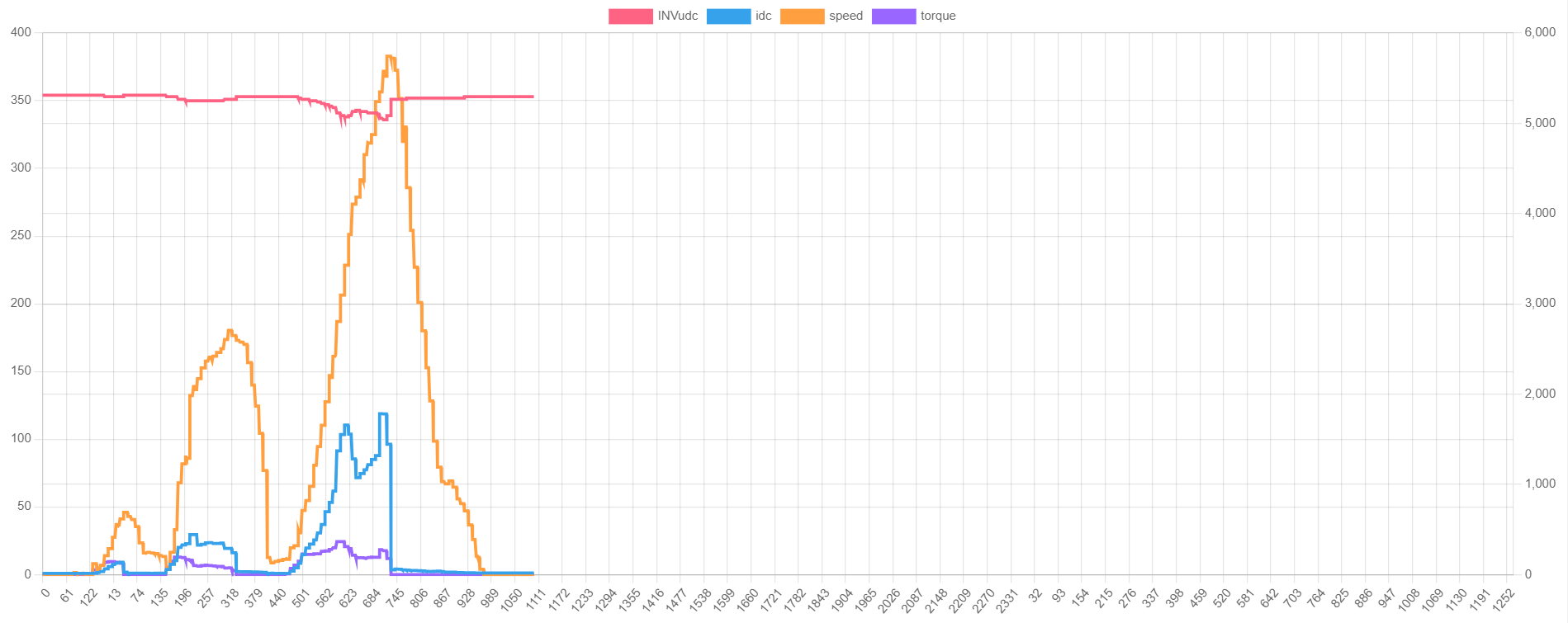

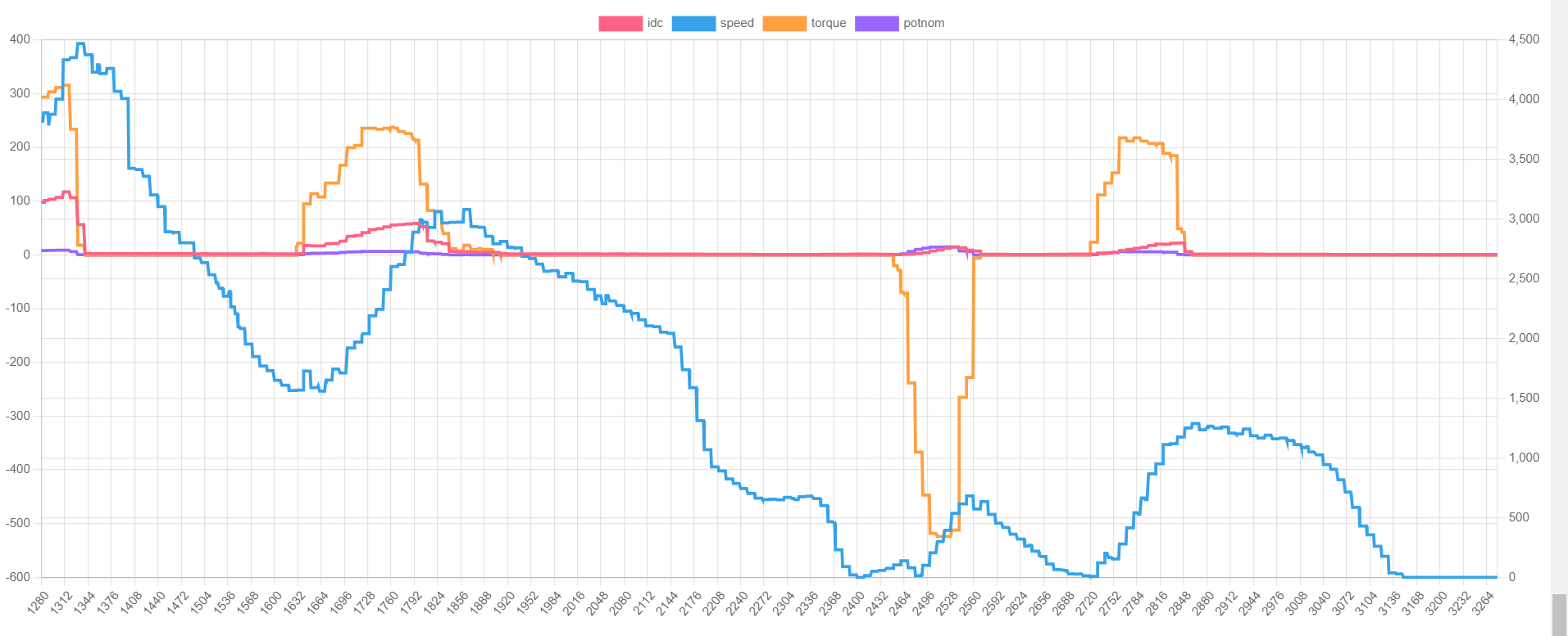

Well now I don't have the rattling coupling to confuse matters I did some more test runs today before the rain came in again
the results are interesting but confusing
there's a cut towards the second part of this run

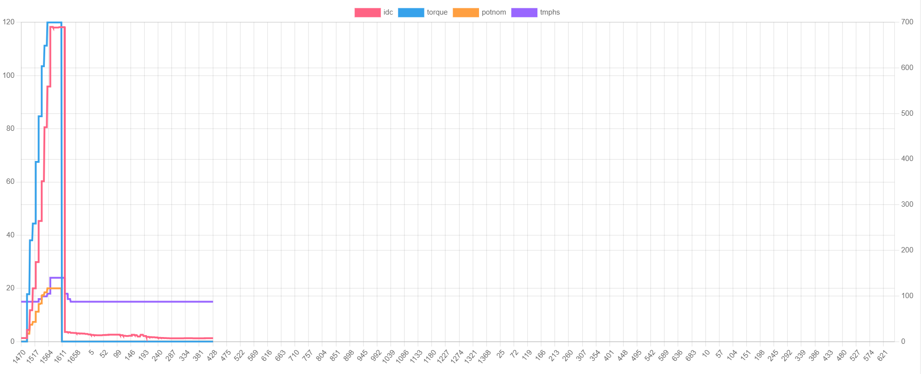

this run I used minimal throttle no cut
this run again minimum throttle no issues

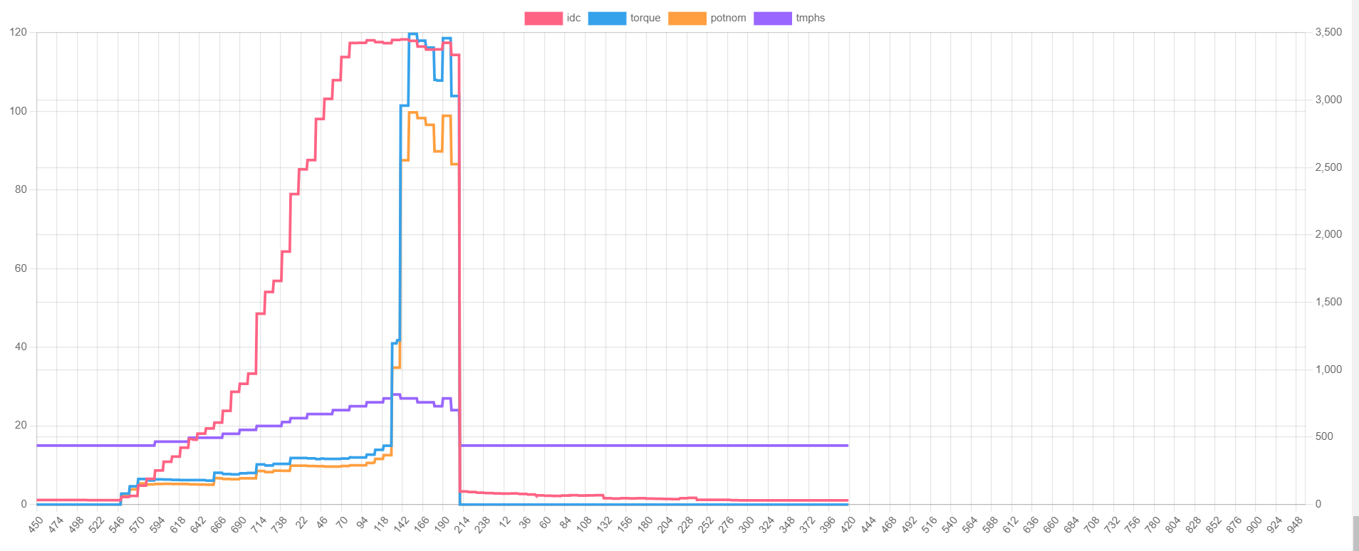

here you can see a cut poss 2 (I didn't feel the first one) with a more aggressive run

so anyway I have no idea what to make of most of this but the cut is still there. I've taken the inv volts and speed out of the later plots as they dont seem to be connected to the cuts also no matter how hard you push it current does not exceed about 120A
Re: [WIP] BMW Z3
Posted: Sun Feb 25, 2024 1:38 pm
by tom91
Note how in the 2nd to last plot, your "torque" request jumps but IDC does not increase this possibly highlights the fact that the command being sent is not fully correct.
Looking at this you can see there is no change from your roll on PotNom to it jumping from 15% to nearly 100%. I would hazard a guess scaling or byte positioning is not 100% correct. Possibly offset by one byte as the torque is transmitted as 16bit across two bytes.
Best way this could be fixed is logging an IS300h :) or just trying all sorts of random hunches until you get lucky.

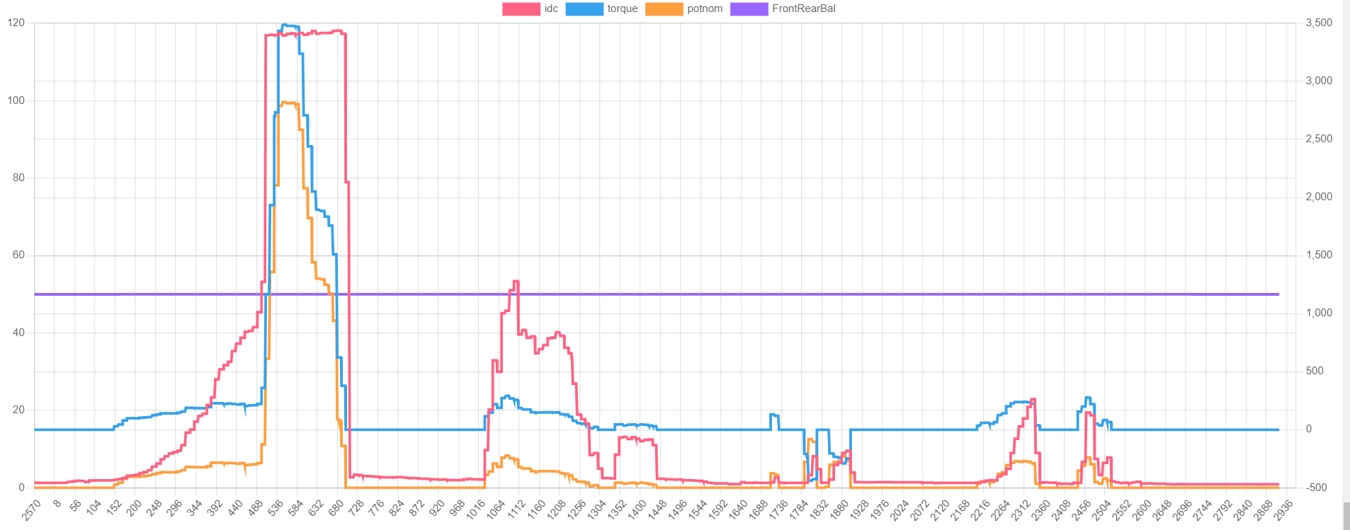

trying to get as much data as possible while the weather holds
(I plotted the front rear balance in the first couple just because I didn't know what it was and wanted to see)
there is a cut just after the 2nd half of the first plot
all the rest of the plots were pretty good as long as I'm really careful with the throttle once it's moving I can floor it with no issues

it is still very clear there is a bit of lag from potnom/torque request to when it pulls current.
The vast discrepancy of torque actually being generated/power draw vs the "commanded" torque is crazy. 'Potnom of 25% yields roughly a 800 torque request which can yield the max draw of 110A.
Would it be possible for you to do a run with the following:
1. Throtmax : 20%
2. Throtmax : 25%
3. Throtmax : 30%
This should allow you to floor it and just pull consistent requests, I would want to see the current build over time and the differences between the three.

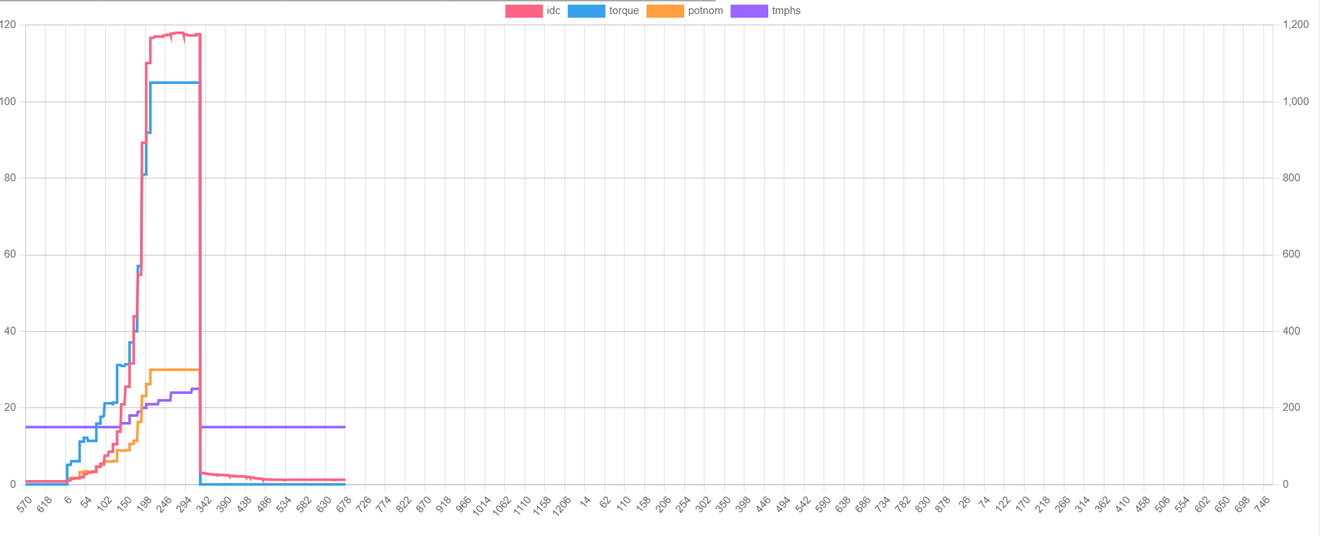

not 100% what you asked for but my neighbours are getting fed up with me driving up and down the road
20%
30%

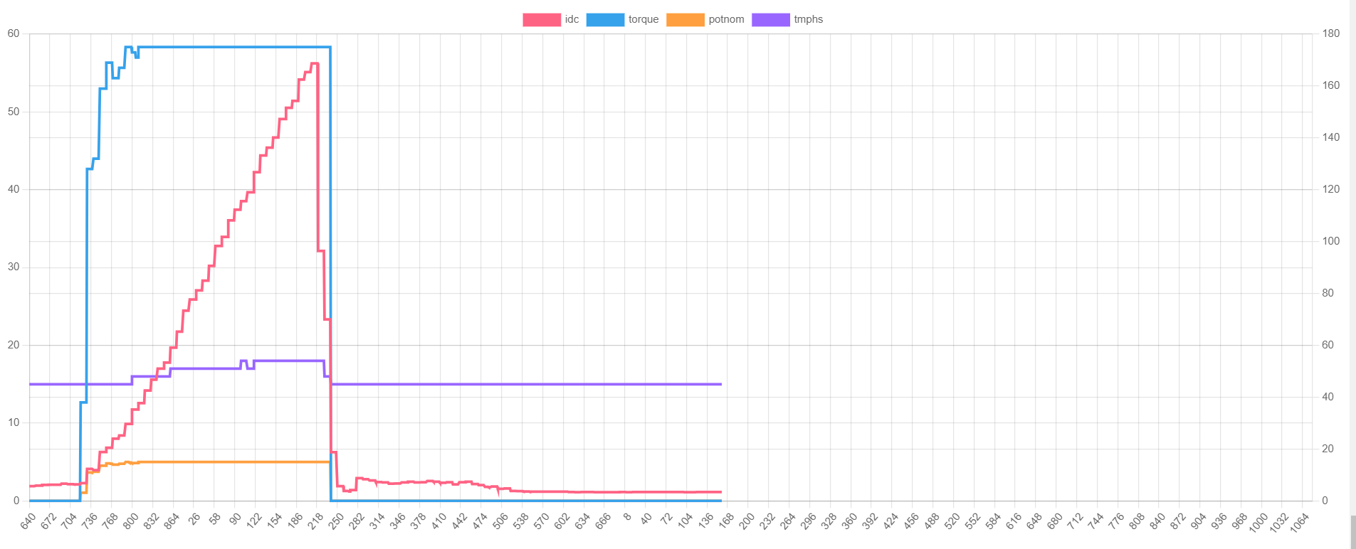

15%
This last was at 5% throtmax and was very rattly I think that my badly worn diff is contributing

andybpowell wrote: Wed Feb 28, 2024 10:53 am not 100% what you asked for but my neighbours are getting fed up with me driving up and down the road
These are perfect, what variable is on the right axis only the torque?
Re: [WIP] BMW Z3
Posted: Wed Feb 28, 2024 11:50 am
by andybpowell
tom91 wrote: Wed Feb 28, 2024 11:25 am These are perfect, what variable is on the right axis only the torque?
yes just torque
Re: [WIP] BMW Z3
Posted: Wed Feb 28, 2024 12:19 pm
by tom91
So currently you are hitting +/- 110-120A consistently, has your voltage been dropping and you not charged when doing tests over the past week?
It is very likely that you are hitting a discharge power limit.
