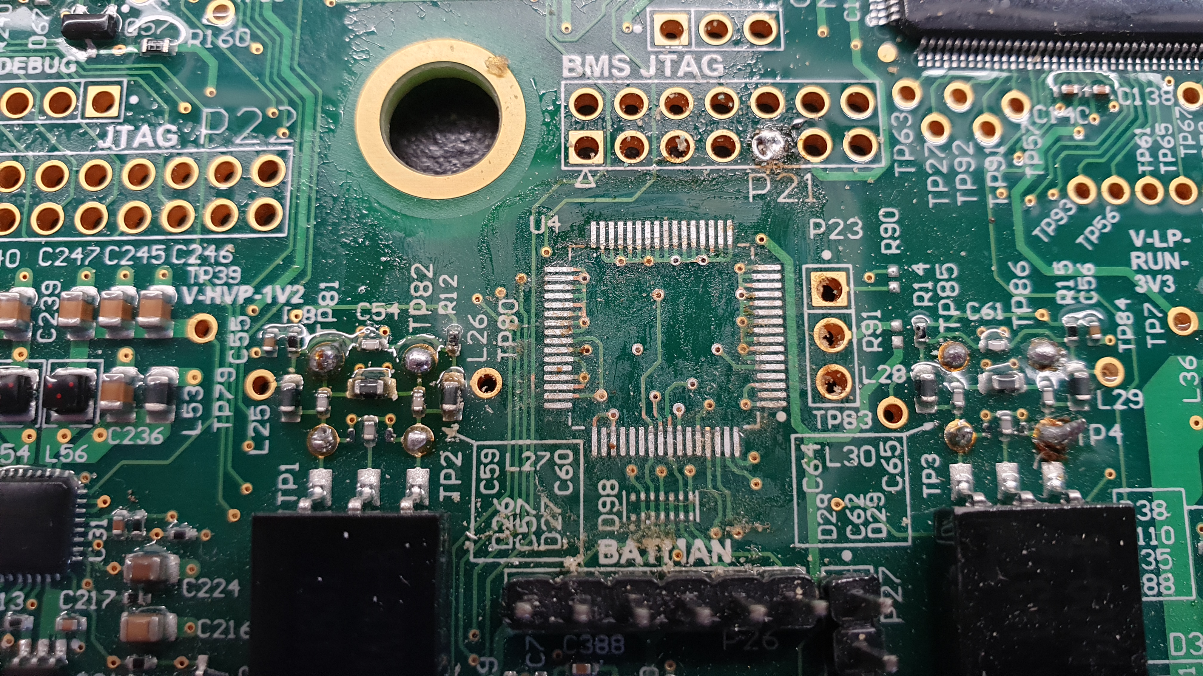

Re: Tesla Model 3 Battery Hacking
BatMan Forever................
EVBMW_BMS_V1 - Schematic.pdf
(277.68 KiB) Downloaded 1104 times

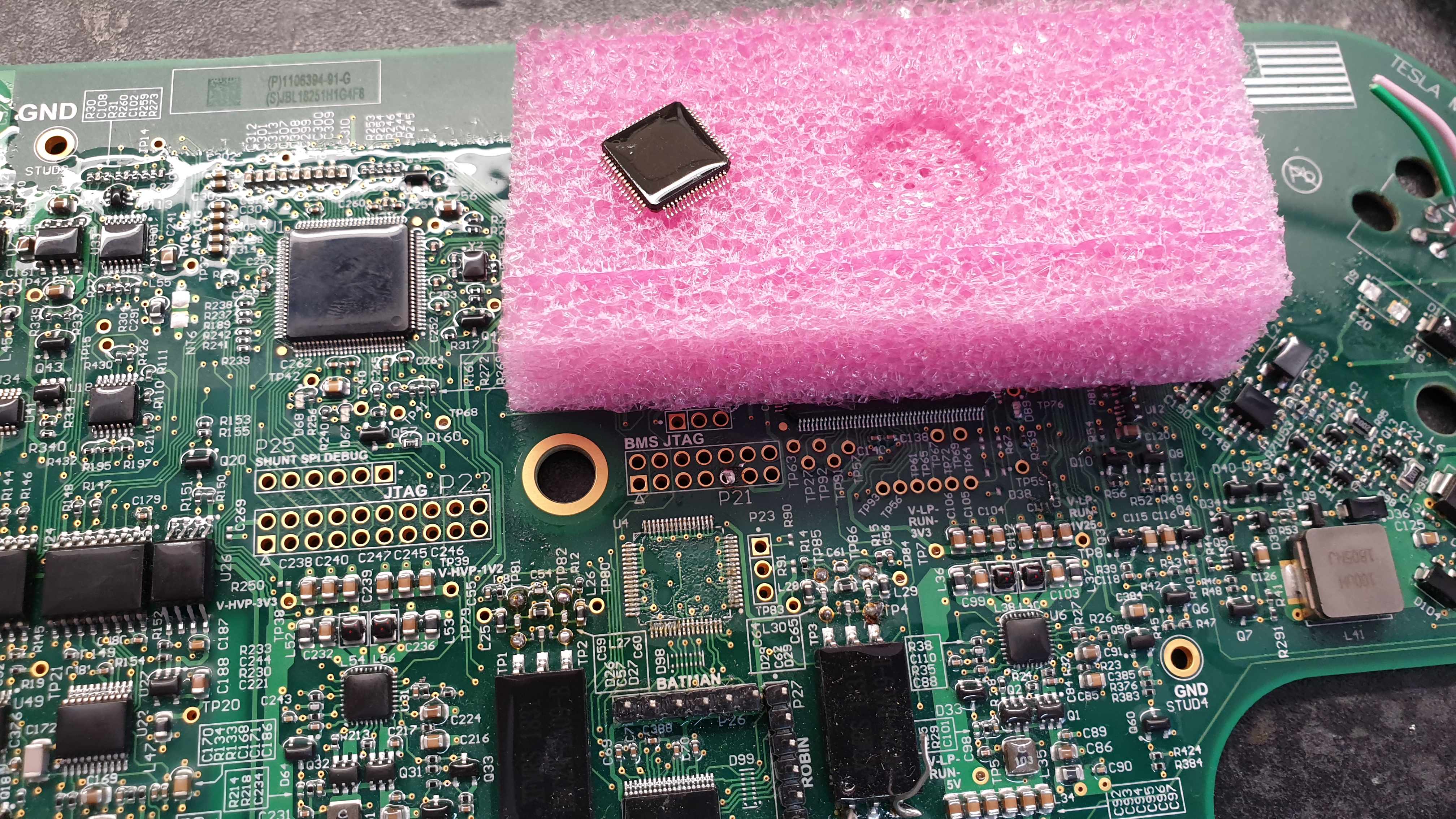

Jack Bauer wrote: Sat Sep 12, 2020 1:14 pm BatMan Forever................
:D
More like BatMan-be-gone?
Posts: 3663
Has thanked: 11 times
Been thanked: 344 times
Yeah now to clean up the pads and work out the rest of the pin connections:) In case anyone is guessing the aim here is to transplant the Batman into my own design and see if will work as a Tesla iso spi controller. No i'm not giving up on the fpga that is still in the pipeline I just need a solution asap for the guy who loaned me the battery.
Looking at the pinout I did earlier almost all the pins are pulled to ground on the hv controller. I suspect one or two of those put it in "Batman" mode. I'll verify this by pulling one off a slave board once I get some pcbs. Might be a useful source of those chips as a lot of people have been pulling off those boards to use 3rd party bms.

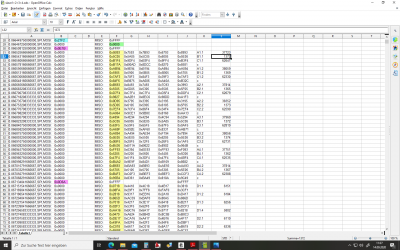

Post by collin80 »
Just a note, the code posted so far posited that 0x0E would request temperatures. That's wrong. Those values aren't the temperatures. Temperatures are found in 0x0D instead. Both 0x0D and 0x0E are requests for ADC data though. I think you'll find that the six bytes returned per module from 0x0D are temperature, voltage reading, temperature, each 16 bits. So, T1, V, T2. The V I think is used to double check that the voltage matches the other readings. It's seemingly a redundant reading system. I'm not getting good results with decoding that voltage just yet. In theory it was supposed to be just like the others but scaled up 10x. Doesn't seem that way to me with my pack.
The proper CRC for 0x0D is 0x6A.
Now, the readings you get for temperature are raw ADC readings from a thermistor. Anyone who has had the "pleasure" of dealing with such knows that it kind of sucks. There's non-linear response there. As luck would have it, the firmware has a table for looking this up. The first value is the ADC value and the second is temperature in degrees centigrade but scaled up 10x and with a 40C offset. So, 0 is really -40C, 250 is really -15C, etc. For instance, I have captures where the reading I got was 0x129E. That's close to the entry for 550 so divide by 10 and subtract 40 and you get 15C. If your value falls in between entries you have to interpolate or just plain use the nearest value and call it good. Chances are you don't really need more than 5C accuracy anyway. The pack is either too cold, just right, or too hot. Anything else is merely for your amusement. But, in theory you could get 0.1C accuracy for temperature readings.
0x01B7, 0

collin80 wrote: Sun Sep 13, 2020 7:21 pm Just a note, the code posted so far posited that 0x0E would request temperatures. That's wrong. Those values aren't the temperatures. Temperatures are found in 0x0D instead. Both 0x0D and 0x0E are requests for ADC data though.
I cannot agree with you on this point. When heating with a hair dryer, the values ​​of 0x0E were the only ones that changed significantly! I'm not sure about the scaling. It seems that there are 1/10 steps in degrees kelvin with a starting point of 160 degrees kelvin. At 1360 this results in a temperature of 23 degrees Celsius. In the screen shoot, the temperatures are marked with B1.1 to B4.2.

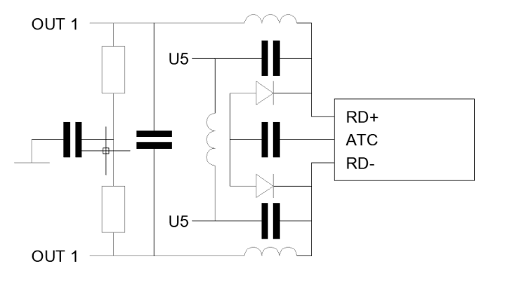

So little more progress. Got the board layout done. In theory this thing could take to M3 slaves, M S/X slaves and any slave that uses CAN. Still to do is reverse engineer the little filter circuit on the chip side of the iso spi transformer and double check the pinout now the batman chip is removed.
(274.97 KiB) Downloaded 1066 times
EVBMW_BMS_V1 - PCB.pdf
(168.61 KiB) Downloaded 1001 times

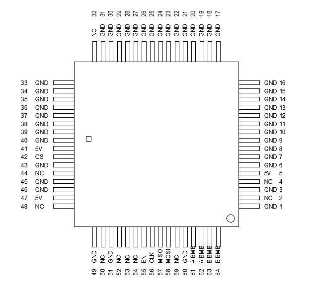

Thats great thanks. So updated the Batman pinout. Seems we have a connection to BOTH the BMB transformers! and a 2k7 pullup to 3v3 on the miso line.

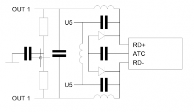

Cap connected to atc = 200pF
Inductor between U5 and U6 = 43uH approx

Jack Bauer wrote: Wed Sep 02, 2020 1:26 pm Some initial reverse engineering on the "Batman" chip on the hv controller. Pinout up on the repo :
https://github.com/damienmaguire/Tesla- ... pinout.ods
Next move is to harvest the little guy. I also noted some interesting RC networking going on around the pulse transformer primary.
Please check again "Enable". I think it's on 55 not 54. And 47 is 5V, not GND.

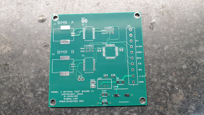

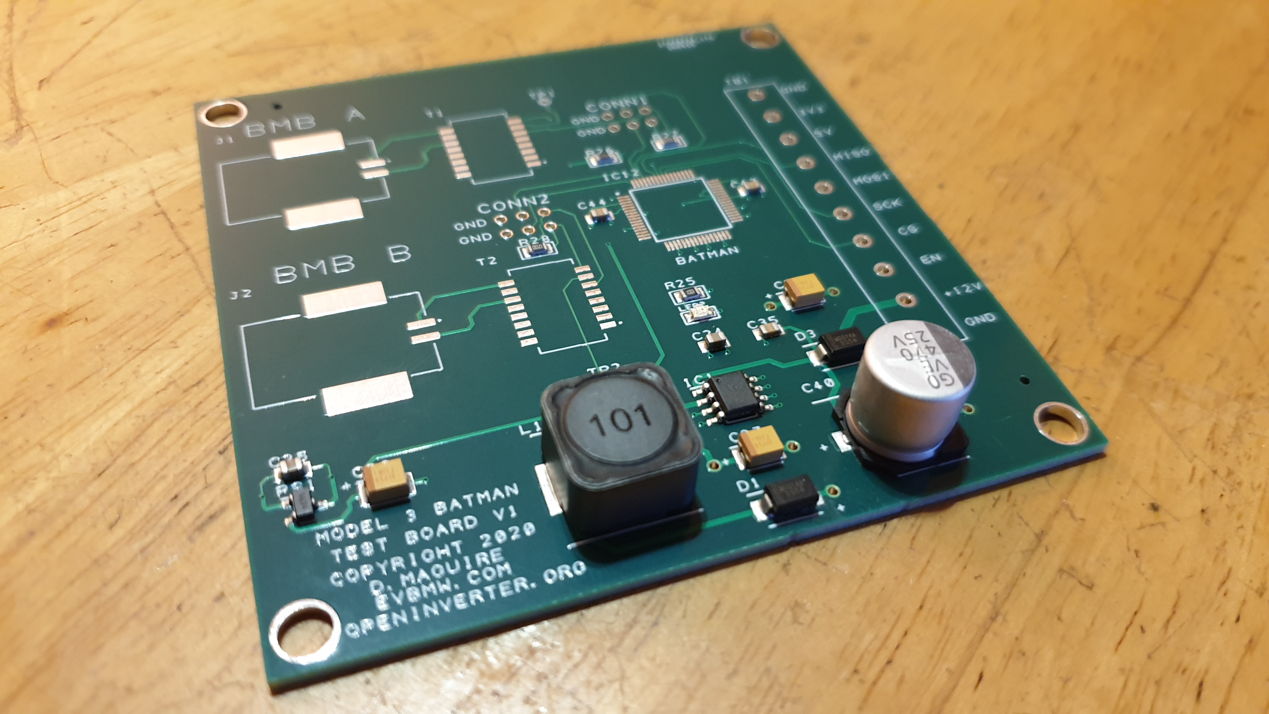

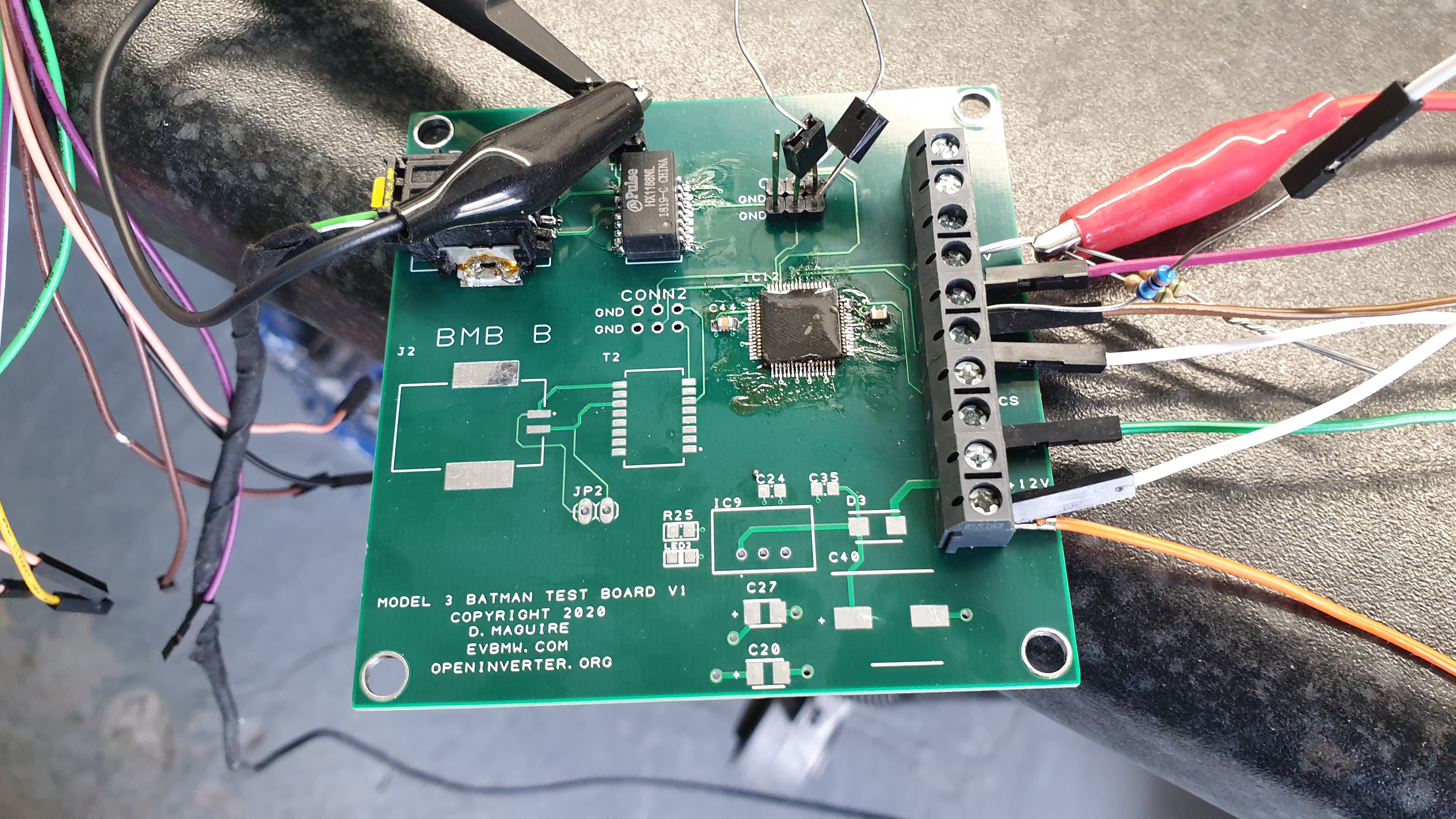

Decided to throw together a simple test / breakout board for batman before going with the full design. Up on Github for those interested :
https://github.com/damienmaguire/Tesla- ... n_Breakout
Posts: 3663

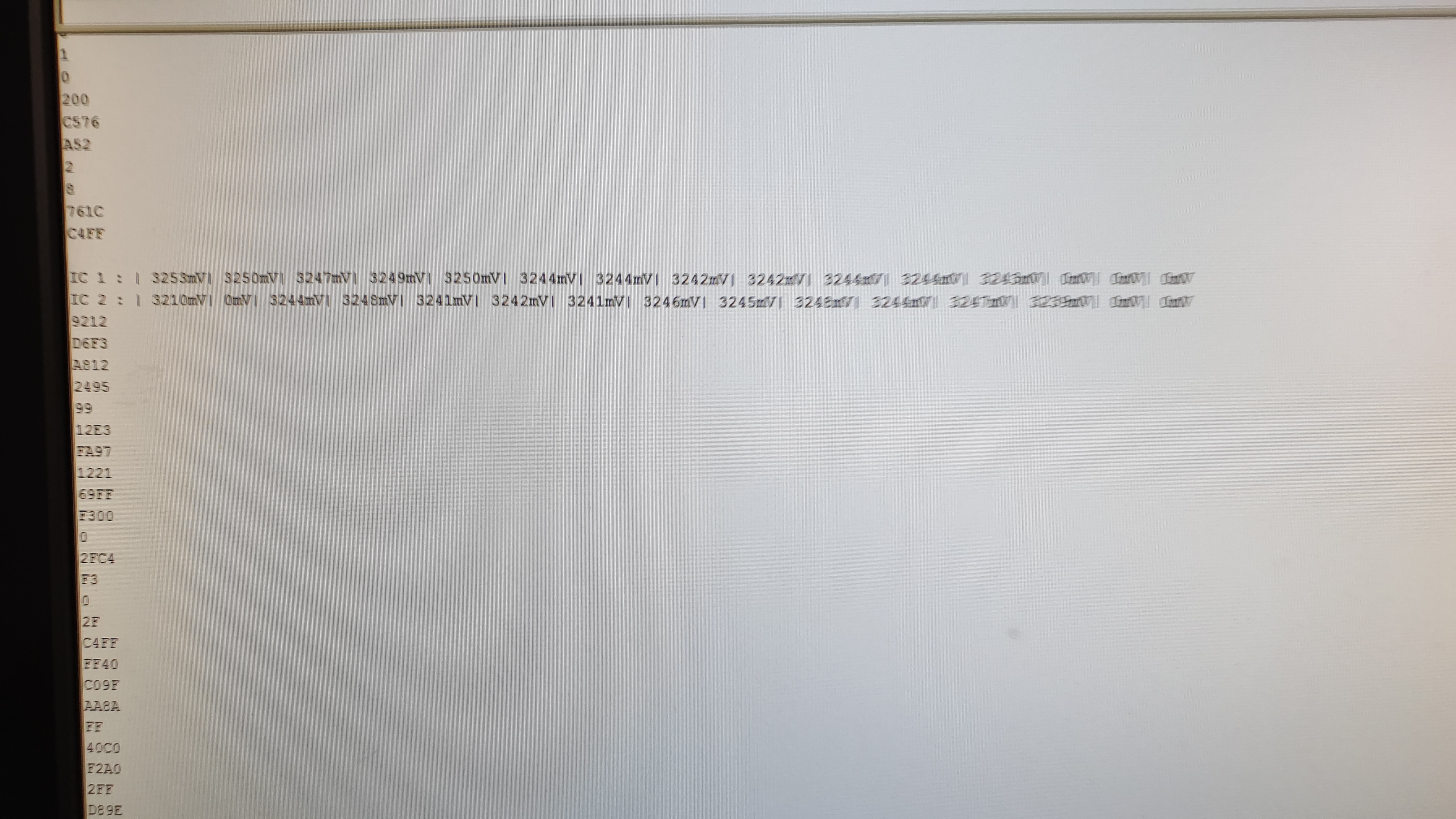

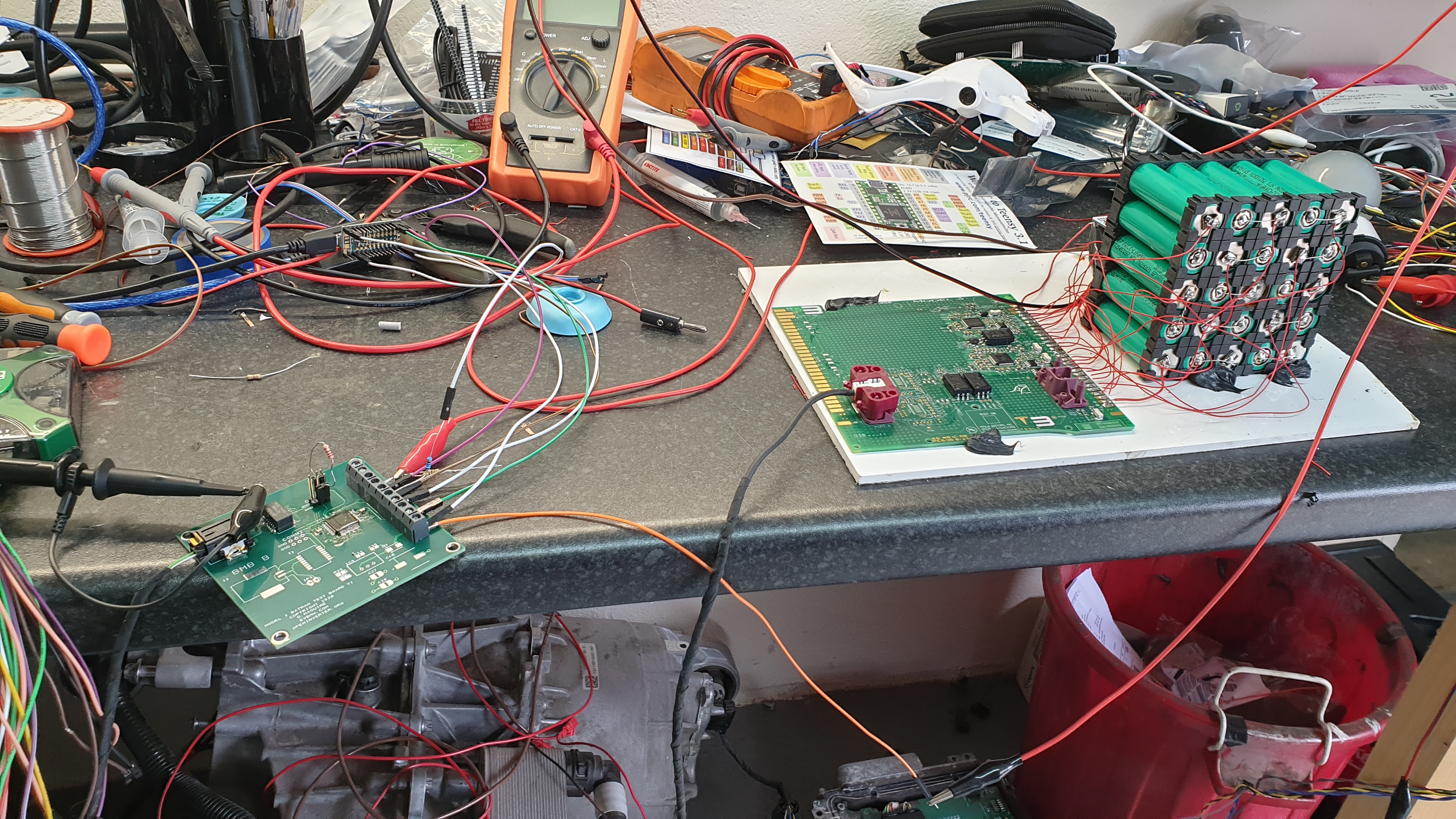

Well I'm pleased to announce success with the little test board. Of course it has a few problems. I had a pin at 0v that should have been at 5v but managed to bodge it. Then turned out miso and mosi were flipped. Getting very clean isospi out of the little generic ethernet transformer and just a 120r resistor on the primary side. Running Tom's code on a Teensy and reading from my little bench battery just fine.
Next thing we need to know is will the "batman" chips on the slave boards work as transcievers. I've had a bit of a struggle finding someone willing to give me some m3 slave boards. Good news is a youtube viewer has stepped up and we should have a few boards to play with shortly. In the meantime I'll clean up the test board and publish the designs. Then we'll pull a batman off a slave and see what happens....

Updated schematic with corrections from today.
batman_test_v1 - Schematic.pdf
(82.67 KiB) Downloaded 1108 times
New dev boards arrived for batman. Will see what happens when we pull one from a slave board and drop him on here.
