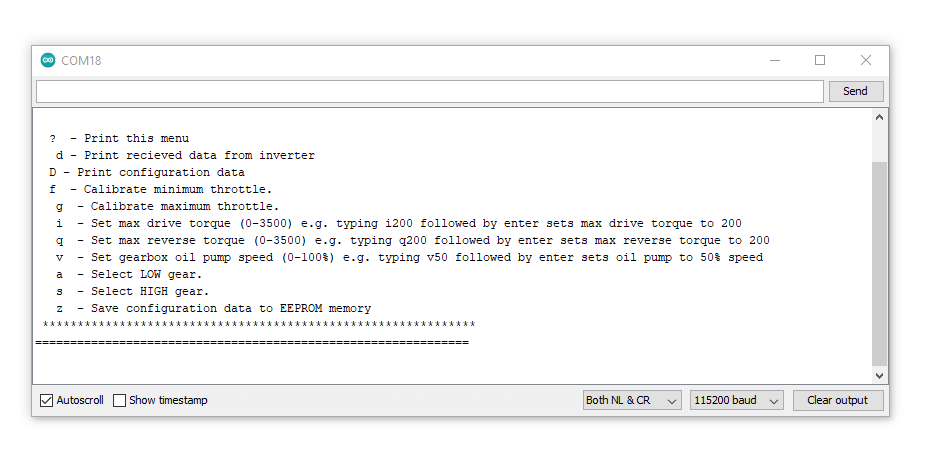

Interesting observation/question:
I'm running my inverter on a 60v bench power supply ATM that only puts out about 3-4amps. I've noticed that ever since I locked the input shaft on MG1, I can only give it a little throttle or it bogs down and drops voltage to the point that it almost stops spinning at all. It seems to go just as fast as it did before up to the point that it bogs down.
I never noticed this before I locked the input shaft, and honestly, can't think of any reason locking the shaft would make any difference. Before I locked the shaft in place, it would only spin so fast on 60v of course, but it didn't bog down if it gave it more peddle. Has anyone else noticed this while using a bench power supply? I'm still waiting on the car to come back from paint/body.

Of course, locking down input shaft engages another planetary gear set. It adds just enough extra load to bug down your 4A power supply.

PatrcioEV-ATX wrote: Sun Jul 04, 2021 3:00 pm Interesting observation/question:
I assuming you are using gs450h_V3_user software.(or something close to it)
In the serial monitor play with the max torque setting (option i and q) for both forward and reverse.
Start low, say i50 and do 100 increments.
I noticed when bench testing the the high numbers would bog down the motor.
