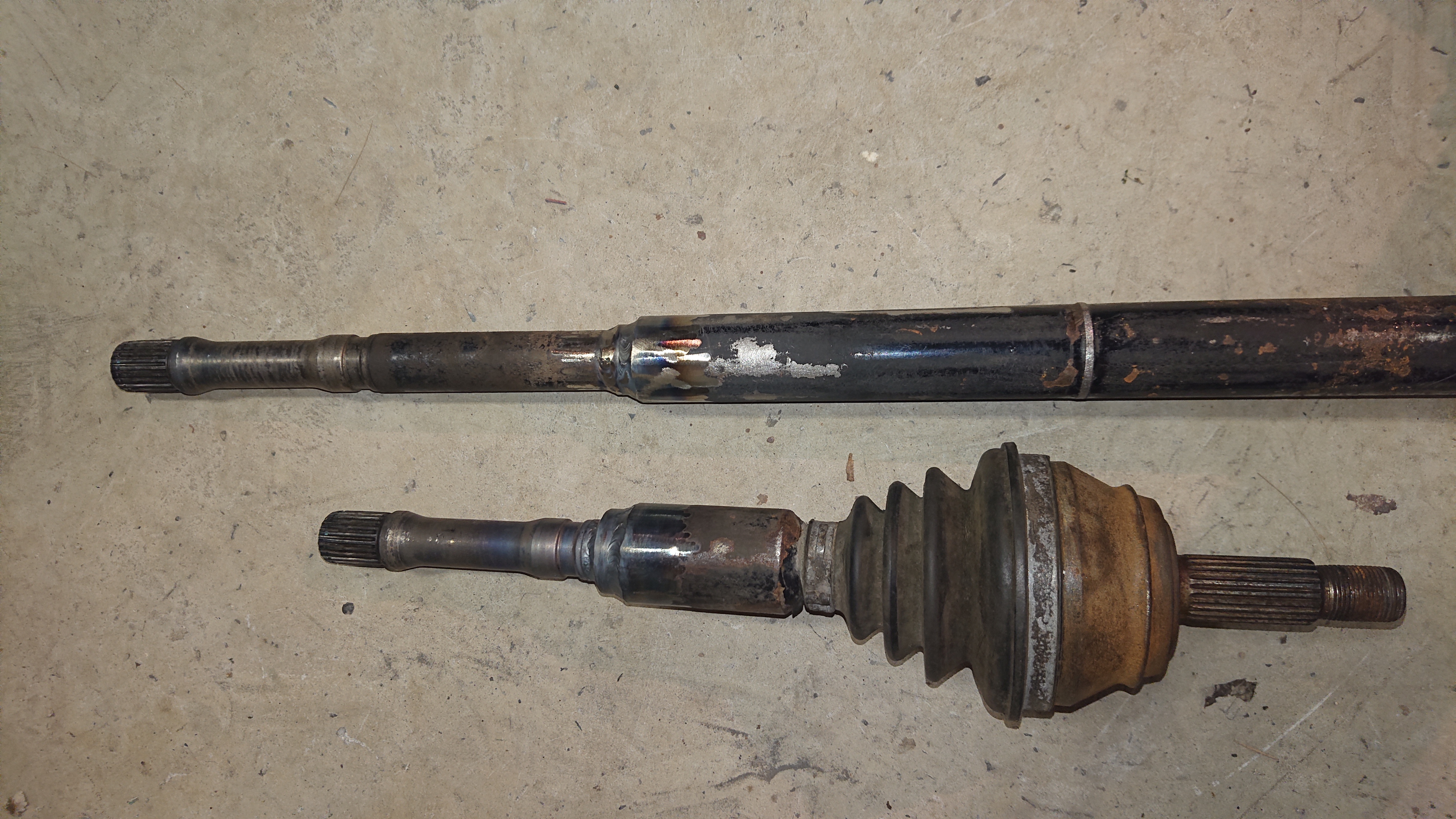

johu wrote: Sun Aug 07, 2022 12:02 pm That didn't work too well... The handbrake is all crusty and won't release and was stronger than the glue. Car was still on ramps. I knew what would happen - at some point the ramps just shot forward. Just didn't expect them to puncture my Loctite cleaner bottle :(
No gotta get the whole thing out, clean it properly and glue again. If it don't hold up get a driveshaft made
As it is not shrink fit i would advise against glueing. I think your best bet would be to bevel the larger shaft edge on a lath and drill two 8mm holes into larger shaft spread some 10cm apart 90deg shifted relative to each other.
Then find a good welder who can make a circumference weld first and then fill both spot welds.
Then you would need to put your shaft to lathe to balance it; or you can fit a rubber damper to it... they used to do that in the past for dynamic balancing and it works somewhat :). I think rear Outlander shafts come with rubber dampers...
You could also temper the shaft at 400deg or similar for some time to relieve straess of welding... technically correct term is normalizing :). But that would be worth if you would fit your shafts to some high power conversion...

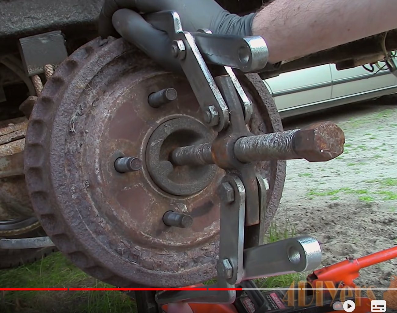

Todays result: driveshaft will go to Poland :)
I spent many hours renewing the rear drum brakes. Had to cut the one drum apart because it wouldn't come off.
With that done I drove the car up the driveway. Parameters still need a lot of tuning, it drove quite jerky with a tendency to over current trips. At some point some transient broke the glued sleeve again, so now I will have it made professionally

I got a local turner to make a sleeve between the solid and hollow shaft, and then went to another company to get it welded up. No one around where you live? I told them what I was building and they were all ready to help. I even mentioned them in local news, which helped too... Just a thought for a quick turnaround.

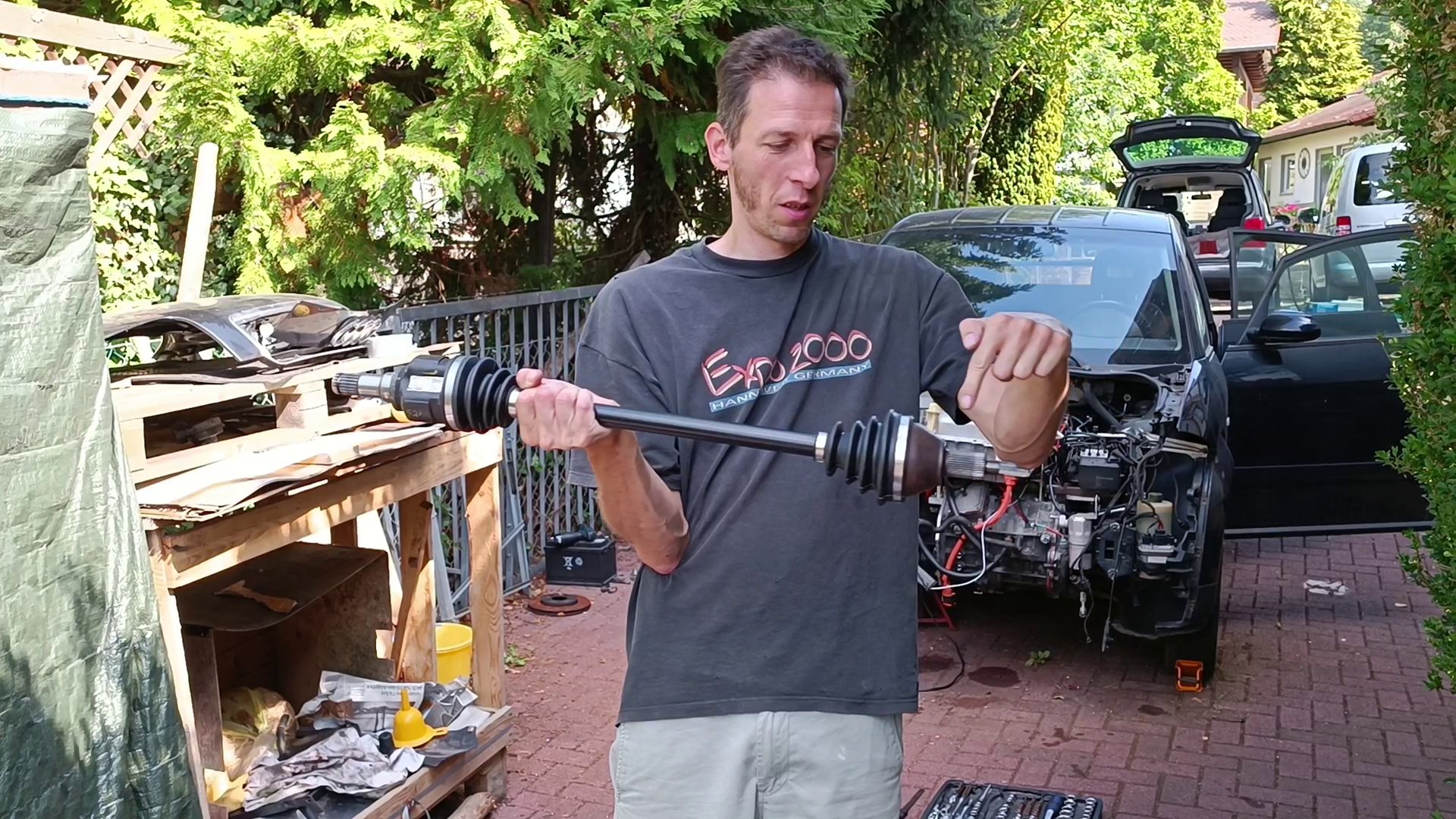

In a similar vein to what Ctwidle posted, I think this approach is a bit more DIY friendly and nearly as good:
(Sorry, language in video is a little crude, but the guy probably knows his stuff.)
The approach probably wouldn't work well for the hollow VW shafts in Johannes's case, but for general use, I think the approach looks sound.

Ctwidle wrote: Sat Aug 13, 2022 10:06 am Before i had my beetle gearbox rebuilt i was considering having half shafts built to join the beetle hubs to the Outlander diff. I approached a local engineer who specialises in preparing high powered race cars. He was not keen on an annular welding between a sleeve and a shaft due to the need for normalising the heat induced stresses. His proposal, which i haven’t seen on here before, was to cut the sleeve at angles to increase the length of the weld and spread the area of stress. I hope my attempt at PAD (paper aided design!) demonstrates the technique.
Yes this technique works similarly to my previously described welded holes after circumfverence weld. As torque acts in 90deg relation to force applied you are extending your effective handle on the shaft and thus material sees less peak torque at the joint. Its all about torque distribution.
You could also make a V shaped cut in the larger shaft on both sides which would effectively act the same...

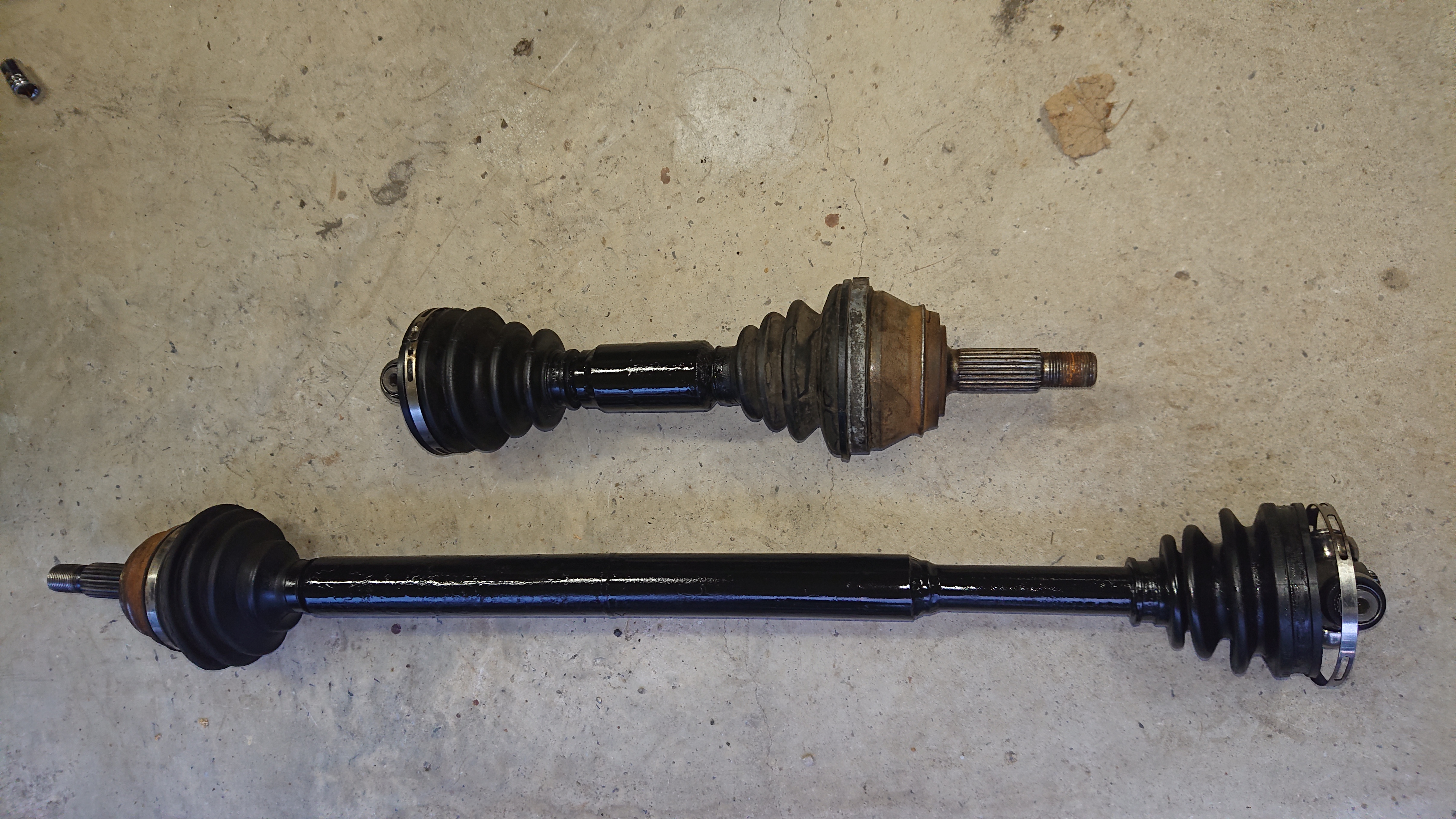

Finally a big update here.
Thomas came over to Kassel and we worked away on the Audi. Properly mounting 12V battery and various other housekeeping.
We also test fitted the A/C compressor
To our surprise yesterday the drive shaft from motomax showed up
Of course we put it right in and then assembled the car again
Then it was time for a test drive. It doesn't like low speed and low throttle but once at speed it drives very smoothly. We were going to go onto an extensive drive when we remembered there is no oil in the gearbox. So drove back to the driveway and filled it with some generic transmission oil. After the 3rd bottle it started leaking out from the left shaft seal :x
And today Damien tells me that it needs special "WS" oil otherwise the enamel of the stator is eaten over time.
Anyway, very happy with the results and very impressed with motomax. More extensive test drives have to wait until the oil and seal woes are fixed

johu wrote: Thu Aug 11, 2022 3:53 pm ... Had to cut the one drum apart because it wouldn't come off...
Oh god, our very early prototype had a drum that was badly seized:
pulling technique on YouTube <-- this is what I did back then. The twisting big bolt in the middle there didn't work for me, I used a car jack to rip it the drum off with an improvised grabber similar to what he has in the video there.
I am sure "real" mechanics have endless stories about this stuff.
