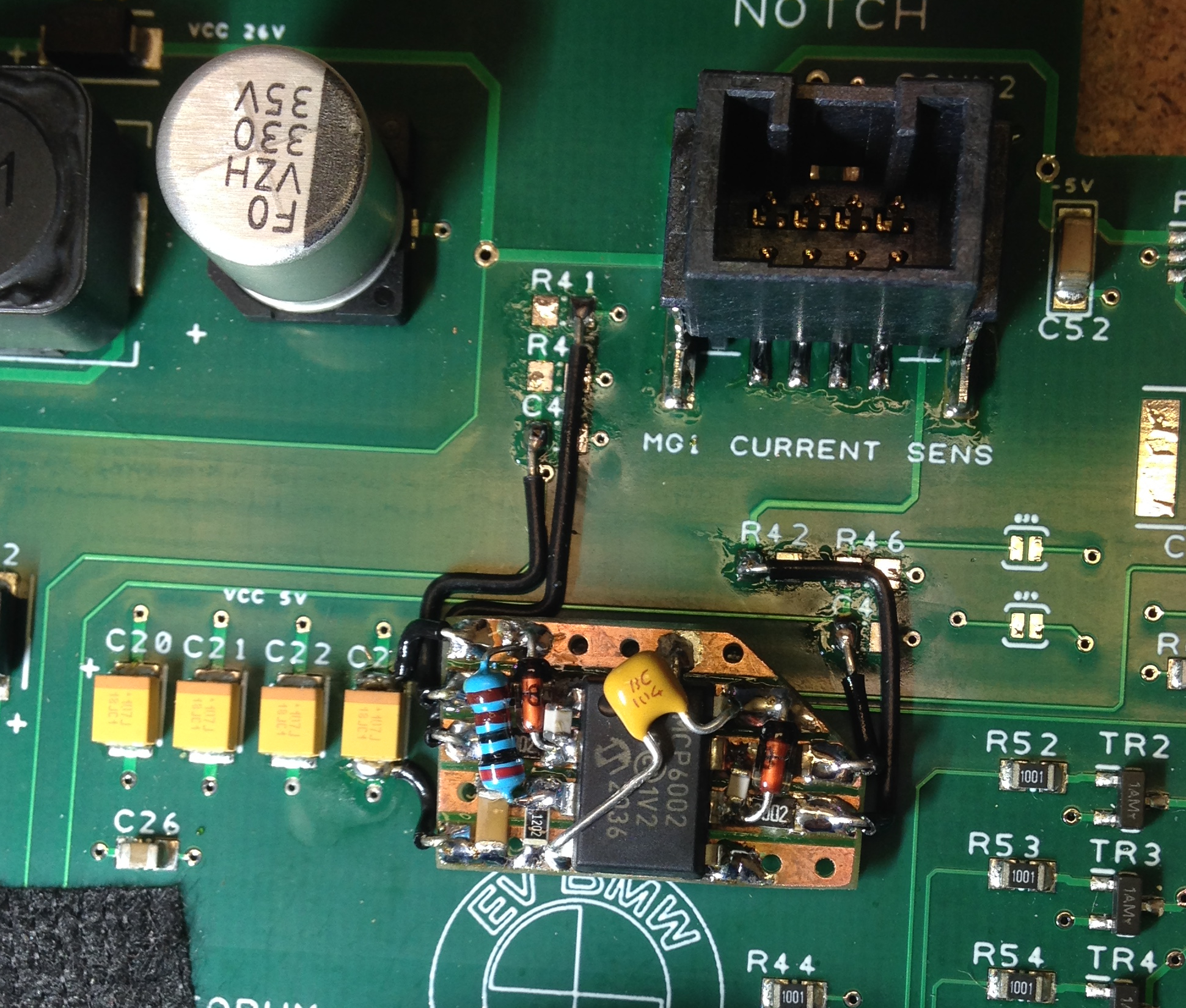

I have now added a op-amp circuit instead of voltage division on MG1 current sensor output. This removes the 2 time damping and adds a 2,5 time amplification so in total 5 times the voltage at the 328P and a max measurable current of 50A.
MG1_IL_Amp.pdf
Schematics of added circuit
(18.79 KiB) Downloaded 946 times
The result is a more stable current and PWM from the charger. This is with the original code concerning the PWM.
Compare the before and after change.

BTW, I think I finally understand the SW regarding PWM and how the current is treated and processed. Really brilliant work celeron55!!

Regarding the filtering capacitors (C3 and C4) I would go a bit higher, like 68-100pF. I only had 36pF or 1nF at home...
I think it is better to set a input current limit rather than setting a output current limit as I have now. The reason beeing that the input current is measured were as the the output current is calculated using the input current and the input and output voltage. This will adds more variables as the input voltage moves a bit as well. I'm going to test this but my FTDI cable gave up on me so will have to wait until I get hold of a new one.

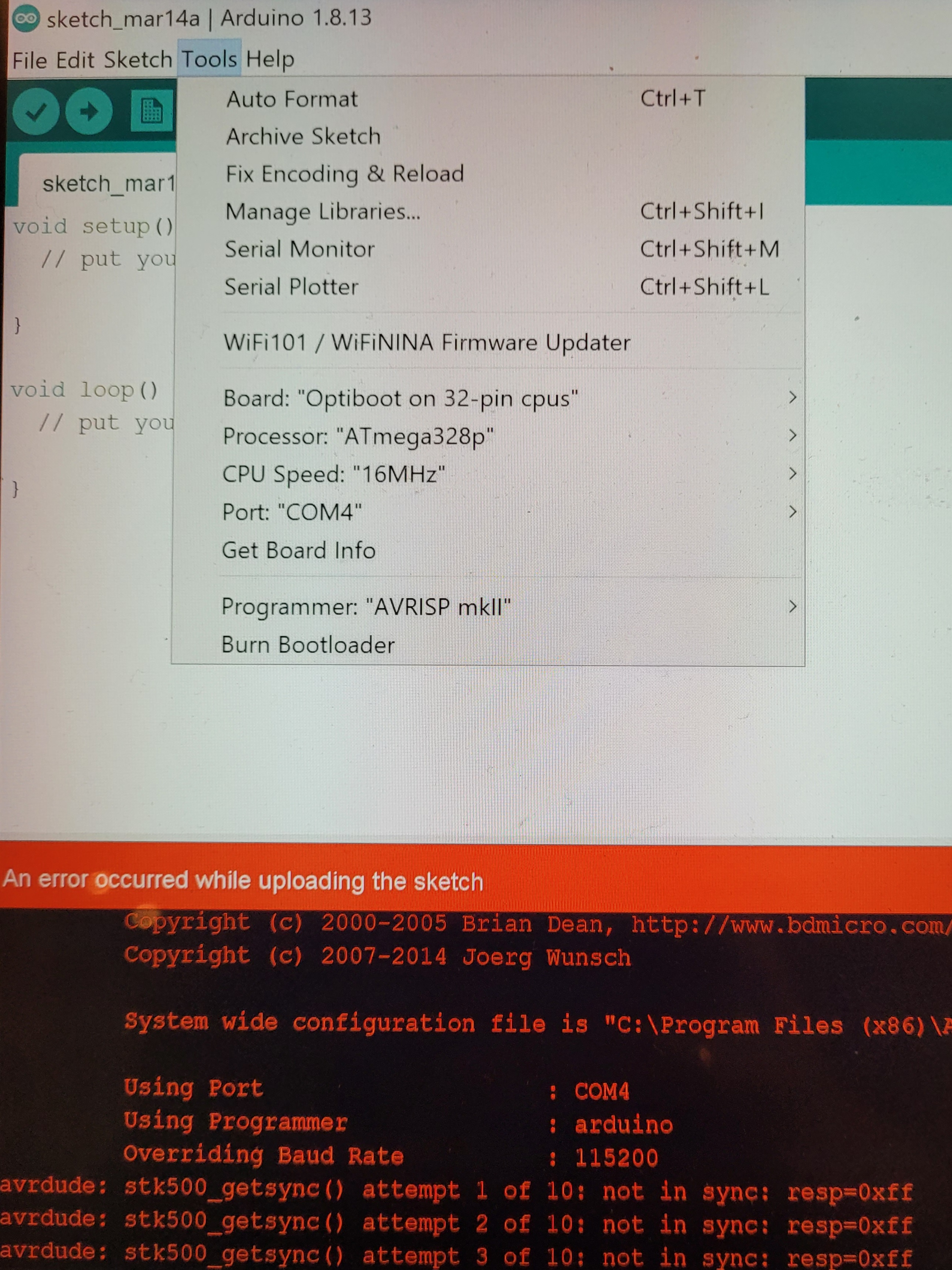

Hi, lots of advanced discussions, great! But do we have some descriptions for actually getting the code into the 328p? Nothing here: https://openinverter.org/wiki/Toyota_Pr ... p_Firmware, and I'm having trouble and probably not setting stuff up correctly :-)

Do you have a bootloader on in the 328p? Did you buy the logic board as a complete kit from EVBMW then there should be a bootloader present.
Then, in Arduino IDE, you need to select board: "Arduino Nano". There are some notes in the beginning of the .ino file that describes this.

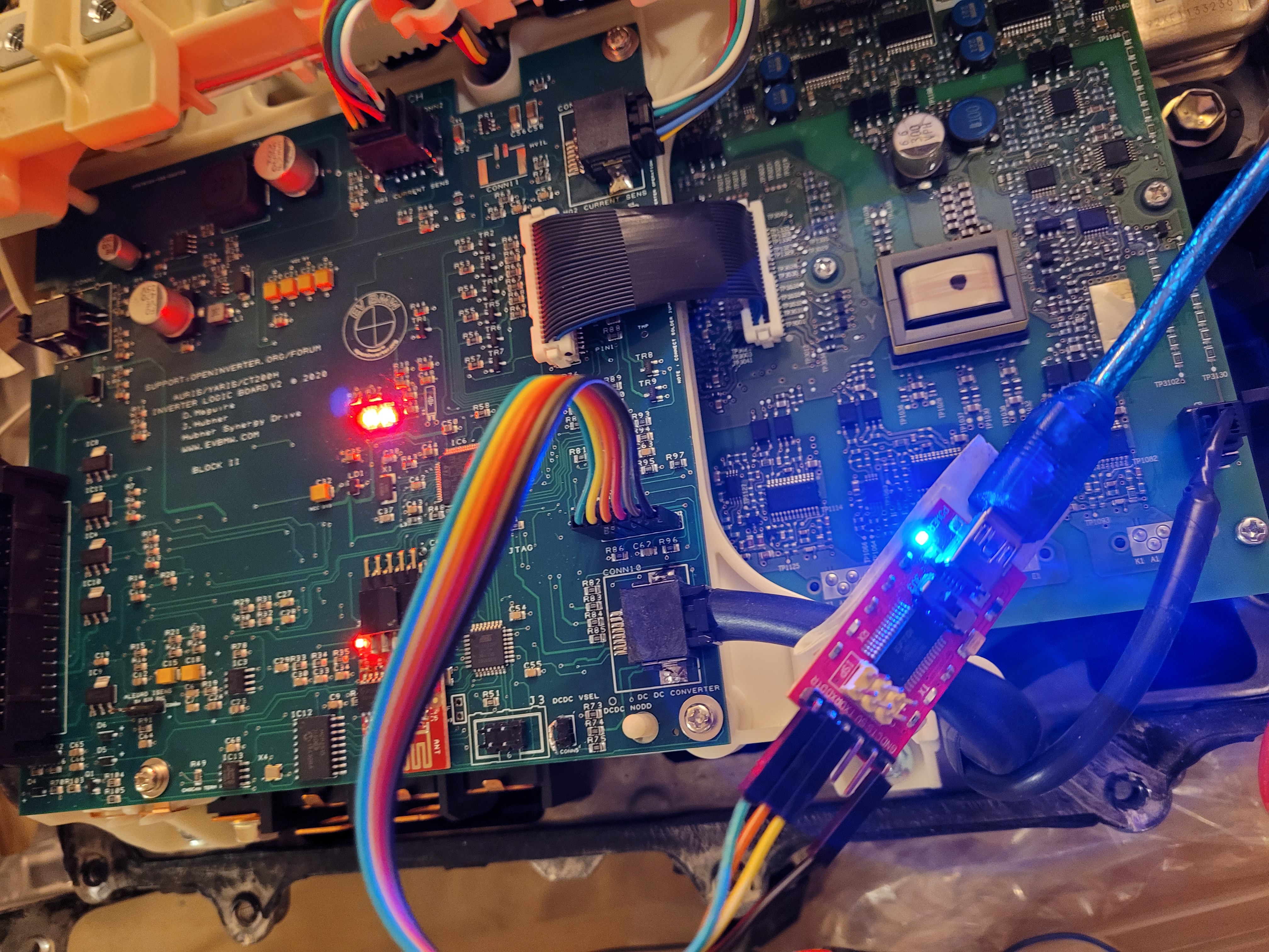

glink wrote: Mon Mar 15, 2021 7:26 pm Hi, lots of advanced discussions, great! But do we have some descriptions for actually getting the code into the 328p? Nothing here: https://openinverter.org/wiki/Toyota_Pr ... p_Firmware, and I'm having trouble and probably not setting stuff up correctly :-)
I think you have the programming cable in the opposite direction, the gnd (black) should be facing the center of the board and not the edge. The silk screen (white text on the board) should read "blk" where the gnd goes.
If none of this works, try swapping rx and tx on the programming cable.

Crap, was laser focused on the "5V" on the silk screen, but that just tells "FTDI 5V"...stupid me not measuring first. But same thing, not working still, but now I maybe have fried some parts of the 328p...well Damien, maybe another order coming soon...
Thanks, Bexander, that definitely was one issue. Have also tried not crossing the TX/RX just to try it, but expect them to be crossed. Have some other FTDI boards coming also in case there is an issue with that part of the equation.

There are 1k series resistors between connector rx and tx pins and 328 so you should... be ok. When I program I used a FTDI cable with the pinout as per stock so I expect that you should have the same pinout from your FTDI-board and hence not crossing TX/RX should be the way to go.
What is happening when you try to upload, with board set to "Arduino Nano"?

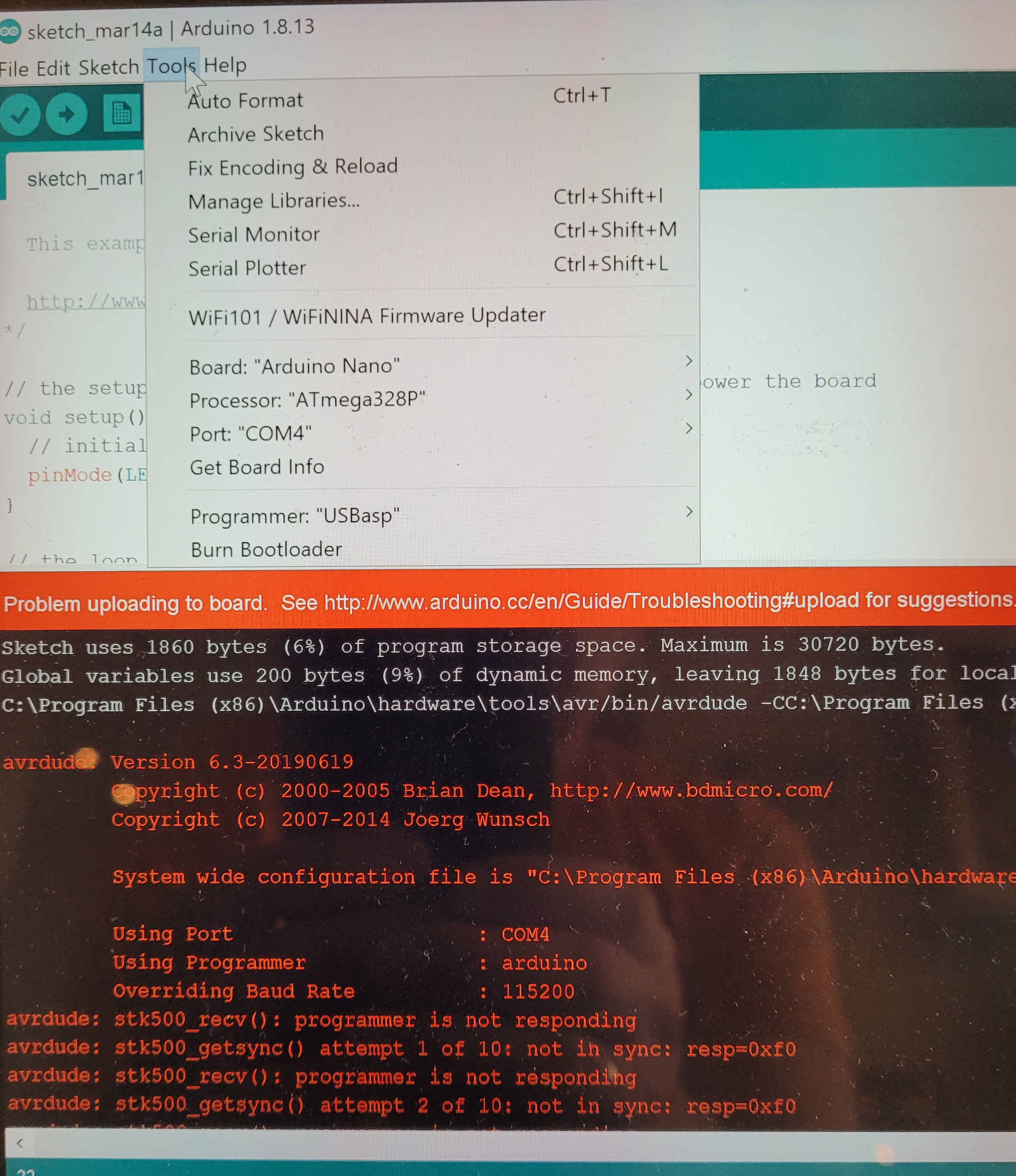

Sweet, maybe the FTDI board never worked. Tried with different baud rates, same...also traced the rx and tx pins to the 328p
Here is what is happening:
Isaac96
Posts: 656
Re: Gen 3 inverter converter control software
Post by Isaac96 »
0xf0 - at least you're getting a response. Is the board resetting properly? And have you tried the 'atmega328p (old bootloader)' option? They changed baud rate a year or two ago...
EDIT Also be sure you're using the right COM port, COM4 is suspiciously low.

Thanks for having a look, have tried the old bootloader option also, afaik it only lowers the baud rate. I have tried all baud rates down to 9600 from the command line. The RX led is blinking at each retry, so some kind of communication is going on. Resetting happens after the upload, right?

Hmm... Reset should happen if the board is built 'properly'. Is there a manual reset you can try?
glink
Posts: 30
Joined: Mon Mar 15, 2021 7:02 pm
Post by glink »
Isaac96 wrote: Tue Mar 16, 2021 9:15 pm Hmm... Reset should happen if the board is built 'properly'. Is there a manual reset you can try?
For now, the culprit imho is the FTDI board. Uploaded a sketch with the Atmel ICE, but still no serial I/O. Until I get a new FTDI board I will program using the Atmel ICE, but it's a bit more cumbersome.
