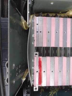

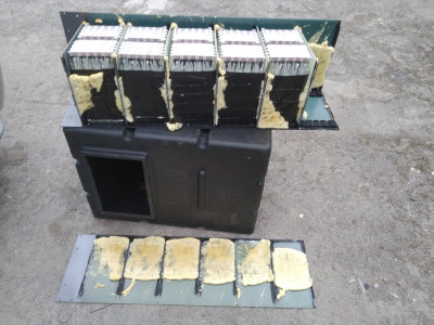

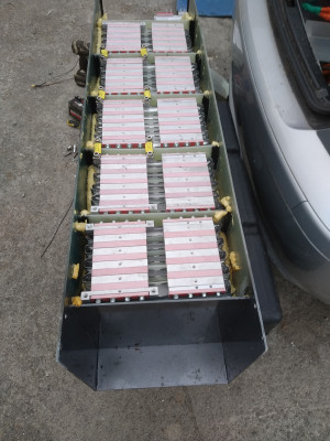

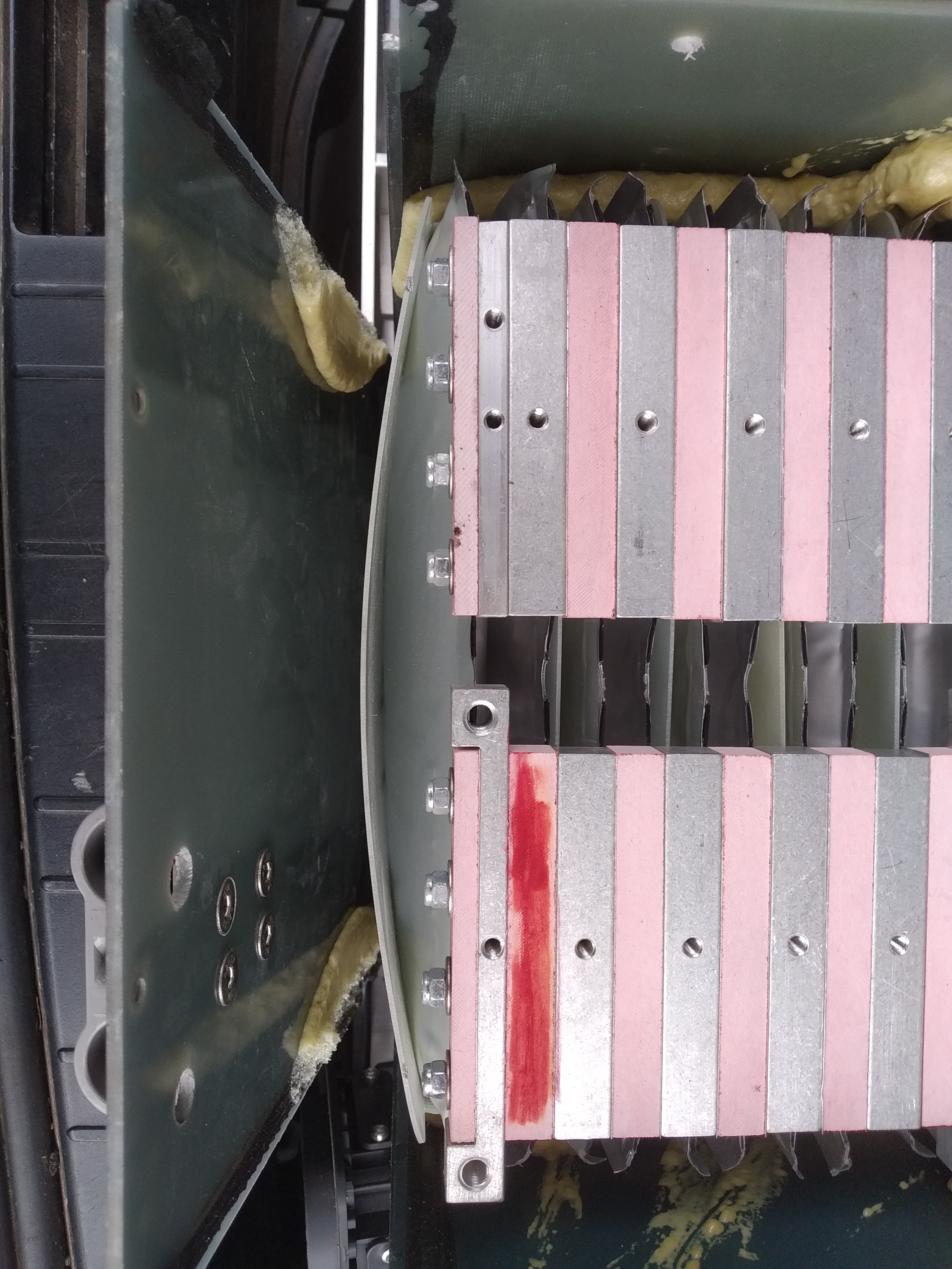

Today I got some time to work on the battery box in the rear. One of the packs seemed to have a large voltage sag when loaded. I checked through the cells and found a few dead or swelling cells. Bad cells were removed and replaced with some spares. Next task is to work on a new battery box for the rear and get the bms parts for the rear cells.

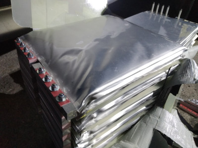

I found the same thing with my Kokam modules that were packaged loose on the pallet. I was hoping the cells in the box would be in better condition. Not to worry, I have spares as well.
- Posts: 3795
- Has thanked: 166 times
- Been thanked: 412 times
Re: The SuperYacht BMW E65 7 Series
Me too. I have my Kokams wrapped tightly in stack of 8s and laid on the flat side. Someone knowledgable suggested this to me because electrolyte in LiPo is supposed to be in gel form and after long use in vertical position it could flow down and cause lack of it near the tabs where cell could start to overheat and dry up. Then it can die suddenly...
But Kokam have some strange protection mechanism it seems. They have copper dust between layers and in case if layers overheat that dust solidifies it creates a direct path from one tab to the other in effect taking the cell out of the pack.
Same thing happened to me last year. I was driving my Pug at 130km/h with Kokam pack at 96S and i heared a loud bang from the back. But my car still had power! Of course it smelled of solvent... There was significant voltage drop in the system. But i could get home still 30km away
Later i opened the rear box.
Good safety feature!

That's interesting to hear. So we should probably aim to store/use these cells on their flat sides then? I'm just starting battery box design(its not design, its deciding how big a box it will be) now and it was going to just be 8 modules vertical in two rows. Might think about changing that up a bit now.arber333 wrote: ↑Sun Apr 18, 2021 10:30 am Me too. I have my Kokams wrapped tightly in stack of 8s and laid on the flat side. Someone knowledgable suggested this to me because electrolyte in LiPo is supposed to be in gel form and after long use in vertical position it could flow down and cause lack of it near the tabs where cell could start to overheat and dry up. Then it can die suddenly...
Were your cells vertical when that one popped?

Interesting , was wondering about the vertical mounting especially without cell containment. I am contemplating making a 3d printed spacers for packing cells that can be joined together and provide some support for the cells and would make it easier to fix them within battery boxes.

That could be a good idea. I was just going to have them pretty close together as per the original boxes they came in, Maybe use expanding foam as well if there is any excess space. My idea was to try and make the battery boxes with minimal modification to the modules.

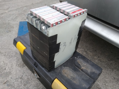

Did some work on 3d printing modular battery spacers/ cases that snap together and then can be be bolted together and keeps cells fixed in place an make them, easily mounted. Once I have them fully tested and figured out I will share them for anyone else with ease cells.

I would also love to hear more about your battery spacers/cases as I bought 4 modules of similar Kokam cells, just have been too afraid to touch them so far! I'll watch with bated breath.LRBen wrote: ↑Tue Apr 27, 2021 12:10 pmThat would be great!paaa wrote: ↑Mon Apr 26, 2021 7:18 pm Did some work on 3d printing modular battery spacers/ cases that snap together and then can be be bolted together and keeps cells fixed in place an make them, easily mounted. Once I have them fully tested and figured out I will share them for anyone else with ease cells.
Mine feature the 40Ah cells not the 53Ah cells, but they've been cased up exactly like JackBauer/paaa's...

For rear two boxes , I seem to have 20ish bloating or starting to bloated. That means about 20% bad.Admitedly one cell bank sagged substantially and tanked a few others.
