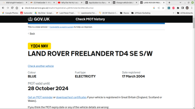

New fuel status on gov.uk site. :)

How?
Well done BTW.
Re: #Driving# Freelander EV With Gen1 Leaf electrics and EVBMW VCU
Posted: Sun Oct 29, 2023 7:23 pm
by Alibro
Bigpie wrote: Sun Oct 29, 2023 7:14 pm How?
Well done BTW.
Thanks mate, must be the MOT guy did it. The system is different here so maybe that's why.
BTW how did you get you're V5 changed or have you?

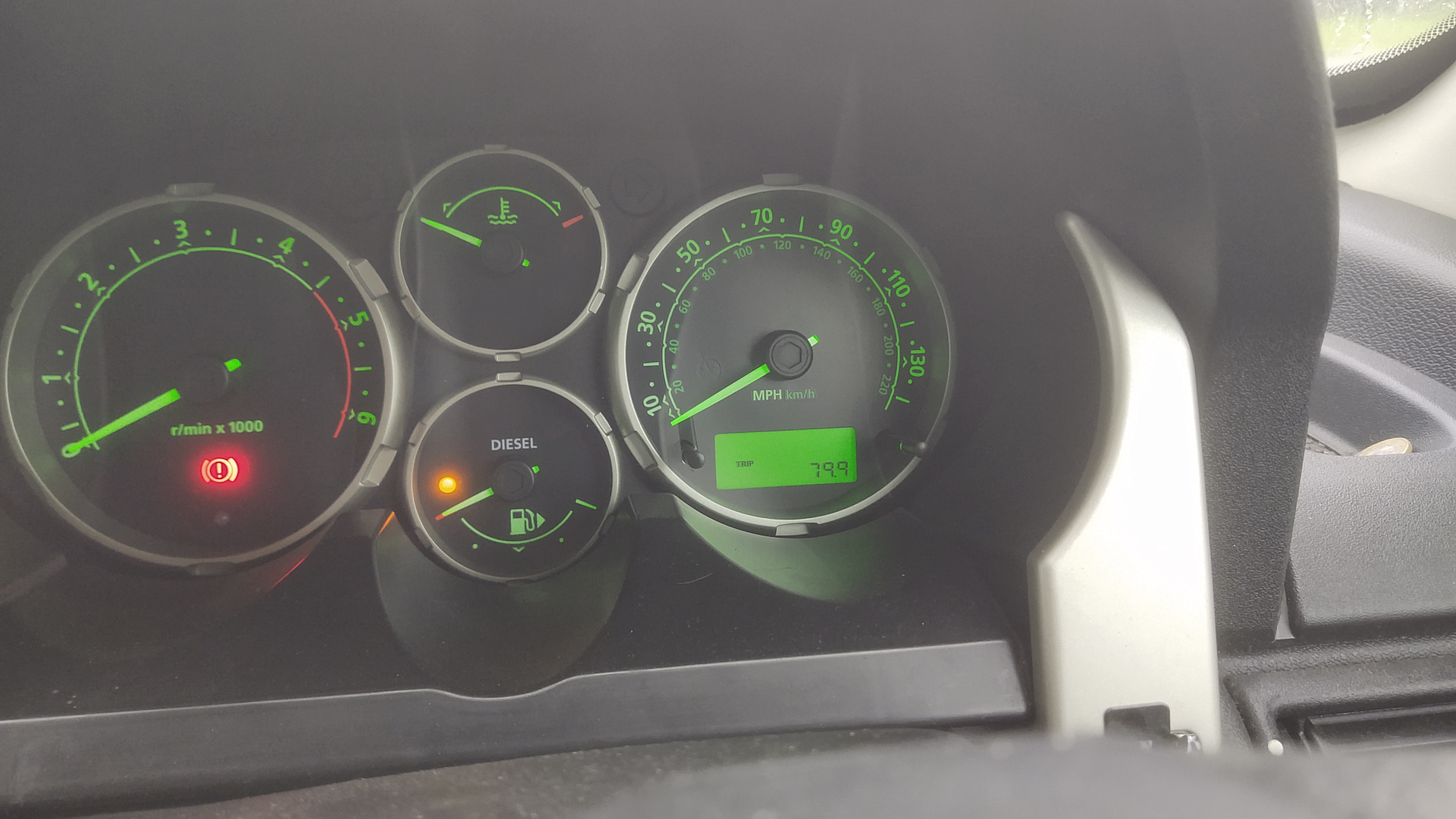

A new toy arrived during the week.
This is the main reason for getting an Android Head Unit.
If you look carefully you can see the latest achievement. :D
I managed to get the Pack Voltage showing in the VCU web page with just a tiny change to the sketch.
I still haven't managed to get the shunt working so no current or power but at least now I know the SOC. ;)

I still haven't managed to get my Leaf heater working but Thankfully I got heated seats, a thick coat, woolly hat and heated gloves. 😋
The windscreen fogs up easily tho and I still have to figure out why the heated windscreen isn't working but in the meantime I have ordered one of these.
https://s.click.aliexpress.com/e/_DmwsmfF
On a more exciting note, now I can see the Pack Voltage I decided to take the car a little further than before to test the range and at the same time drive it onto a weigh bridge.
In the last week or two since the last full charge I had driven 50 miles on small back roads around home while testing different changes, so the pack voltage had dropped from 400V to 352V. These were not easy miles as there was lots of start stop and hard acceleration involved.
As the weigh bridge is 15 miles from home I figured it would be a good test and hopefully well within my theoretical range of around 100 miles.
Here are the results
