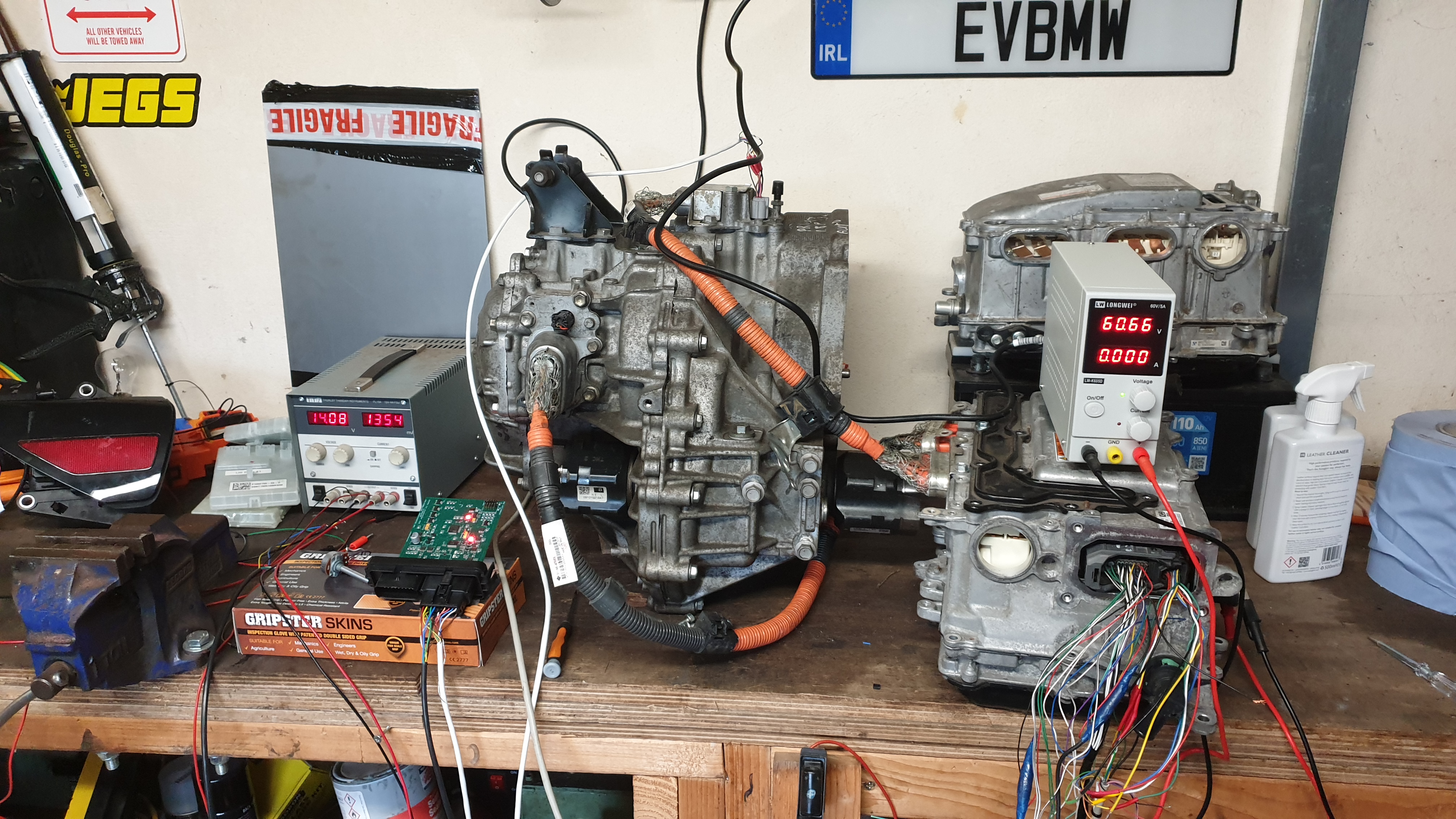

V3 prius test bench all set. Just add software:)

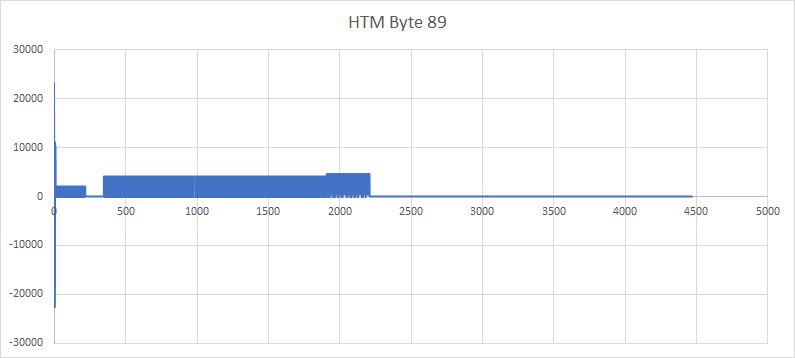

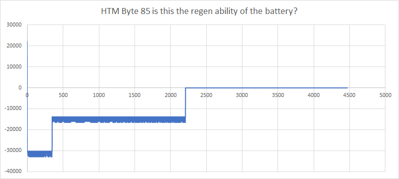

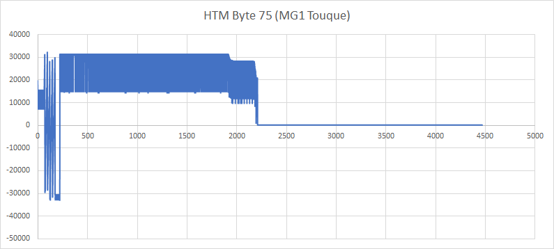

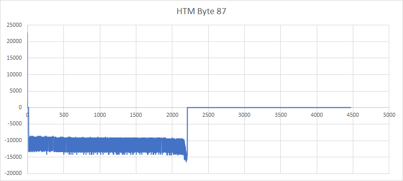

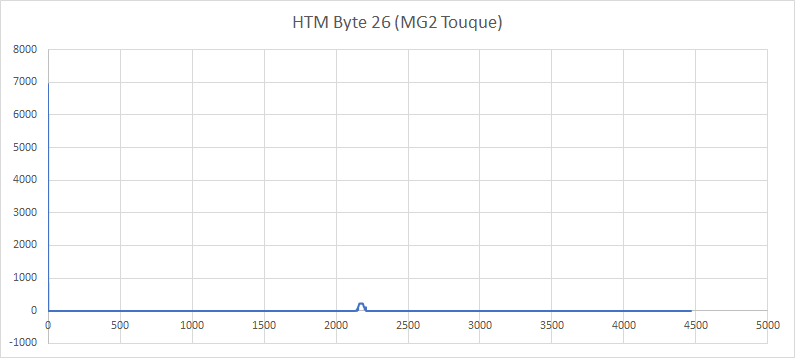

I'm working on it now. I've found 3 possible locations of battery data, in around the end of the data stream, see attached files.
Also attached what i believe to be MG1 and MG2 torque commands. I believe I let the car out of park to just roll forward hence the blip on MG2.
Dilbert

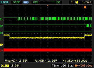

Prius bench test 1 : New software loaded up. Can see htm and mth on scope. Getting and invstat ON on the wifi but no life at all from the inverter and no response to torque commands. Going to lookup the wiring diagrams and see if there is a shutdown or enable line I'm not seeing and then grab some captures with the logic analyser.
Dilbert
Posts: 410
Location: Dublin, Ireland
Post by Dilbert »
OK, that's a good start, it means it is exchanging the frames and for the incoming mth data the checksums and data length must be correct.
Are you seeing the DC bus value (you probably don't have a battery connected) coming from the mth data and into GS450HClass::dc_bus_voltage? I don't think it is being taken into a param yet which you can easily read. In one of the runs I had recorded I'm thinking some of the bytes were moved on by 1 column, but this was the mth data.
They are definitely doing the same thing where they put the torque commands twice into the htm message. Also the MG1 torque command to start the engine is in location 75/76, but when driving the vehicle i'm seeing MG1 torque commands down in 5/6 (same as GS450H).
I've a good bit of data in excel which i want to review. I'm wondering is there a heartbeat counter added or similar, which we would need to mimic.
Oh just saw something, uncomment out line 396 // inv_status--;
I think we are constantly sending the setup data!

Ok will try that. Here are a bunch of logic analyser captures. Both from the bench rig and a few bare logic boards :
https://github.com/damienmaguire/Prius- ... erial_Logs
Posts: 4003
Been thanked: 1125 times
Ok did the code code mod. Didn't seem to change much. Here is a capture :
https://github.com/damienmaguire/Prius- ... .logicdata
Posts: 4003
Just might be worth noting its a ct200h inverter I'm using but I have "prius" logic boards that I can swap in if we think that's an issue.
