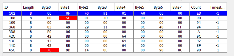

Now two dumps are attached below, I don't know the charger internals I am looking for, can someone see if there are signs of spikes in Amps or tell me how to look for them?

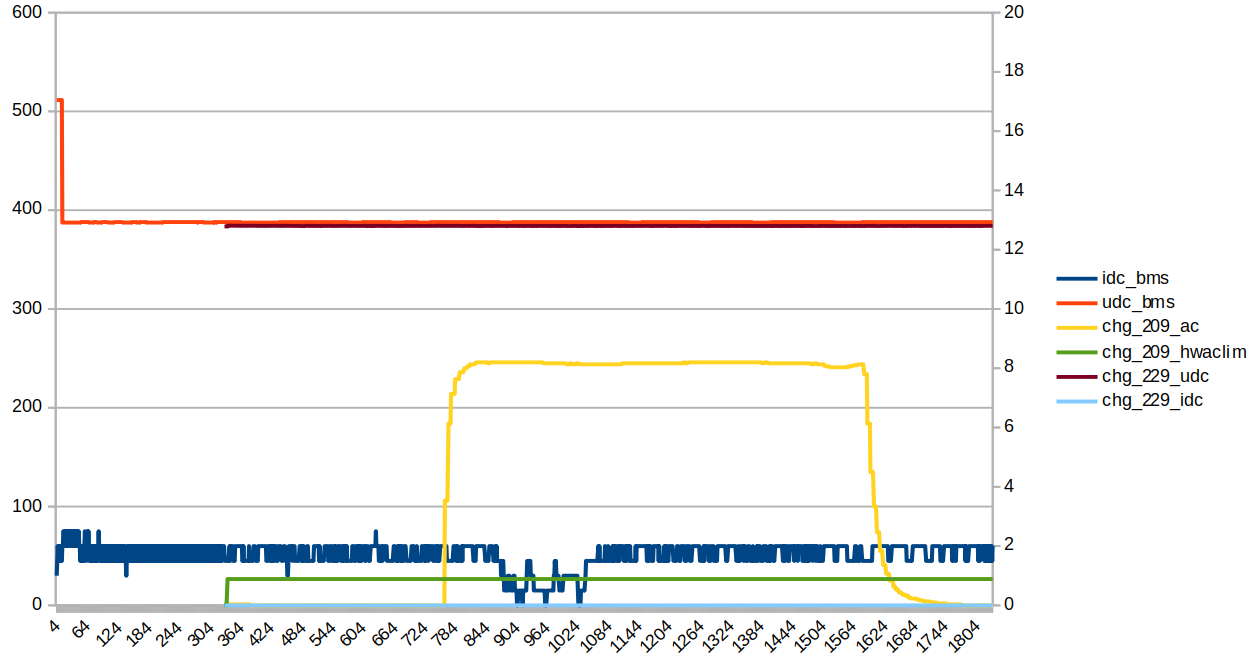

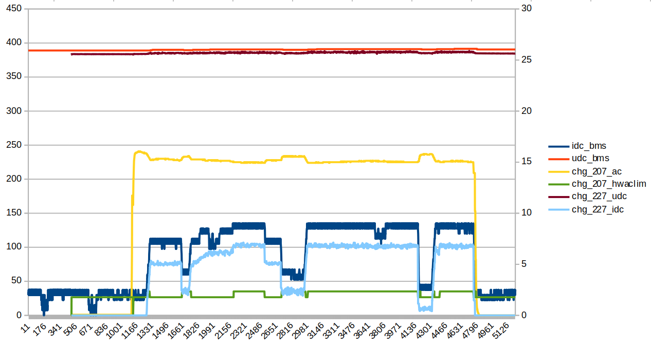

Yes, of course, Amps destroy it when trying to charge at low voltage.
Now, I parsed & plotted the messages the charger sends.
Working Broken Some thoughts:
- Nice to see: AC voltage drop from 240 to 226 as soon as there is a load (expected)
- BMS reports ~6 Amps (8A - ~2A noise in the data). The individual phase only reports ~2A, so is it charging on all phases? So odd! I need to set it up again and check chargena. My understanding is that 22B, 229, 227 report dc voltage and dc current for the three phases, I would have expected one of them to match the BMS and the other two to be zero.
- I can't actually tell from the CAN messages what is limiting the broken charger: hwaclim in 209, 20B and 207 looks good to me in the broken log as well?
- the idc_bms noise changes at some point in the broken version, I wonder why.
Maybe I will look very stupid here soon, but I can't figure out why yet!

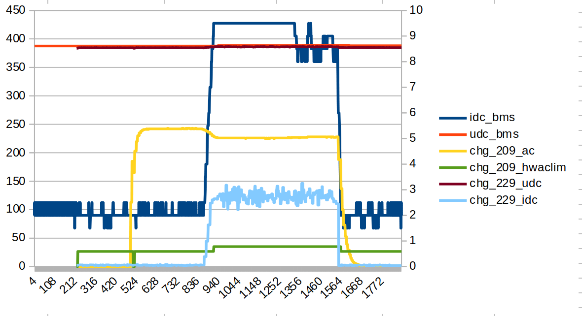

Edit: Another one, this is where I changed the setpoint a few times during charge (idc going up and down visible). In this one I only had messages from one phase as I expected before.
changing current limits

Hi Johannes, finally getting to try out this update - if you remember I needed the auto 3-phase capability (thank you for adding it!) and I also want to use CANBUS to control the charger (so, J1772 wires not connected to the charger).johu wrote: ↑Thu Jul 07, 2022 4:32 pmIt's kind of scattered along the thread here. It has the digital input for signalling 3-phase availability, it's got a new CAN module which improves accuracy, it no longer forget CAN messages (a bug that was introduced after the official release), charge current calculation in 1-phase mode was fixed and finally a parameter was introduced that lets you delay the start of the charge.
So if you don't need any of the new features and yours runs fine, you can skip the update
The charger works, stand-alone, with cancontrol off and J1772 wires connected.
However I have no success getting the CANBUS messages to have any effect. On my Candaptor I can see messages from the charger, and from the BMS (my 0x102 message, sent at 100ms interval).
On the charger I have cancontrol on, enablepol high, and the enable pin is pulled high.
I have the termination link closed (it is at the end of the line). The total can resistance is 60R
On the web interface it shows canenable=0, enable=0, state=off. Nothing happens.
How can I debug this please?
