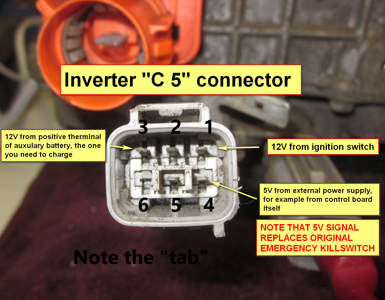

- konstantin8818
- Posts: 290
- Location: Minsk, Belarus
- Has thanked: 2 times
- Been thanked: 10 times
Re: Toyota Prius Gen 2 Inverter Controller
Thank you for the update with capacitor.
For now I'm planning to test Damien's board with my ACIM motor which currently runs under curis 1236. I want to see what difference prius inverter can do. So all I need now is to wait untill my contactors arrive.
I've got no prius transaxle yet, but I've got Lexus MGR. I want to run it with Johu's board and for that I need that current sensor signal converter. As well as BUS voltage sensor signal devider.
- konstantin8818
I can't see any changes in wiki. Can you please show it here, wich wires goes where?

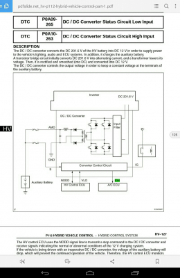

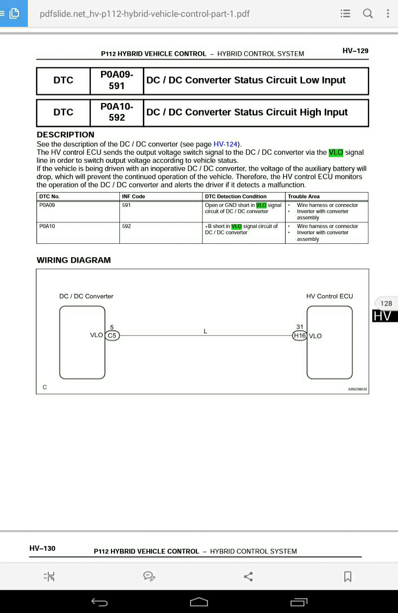

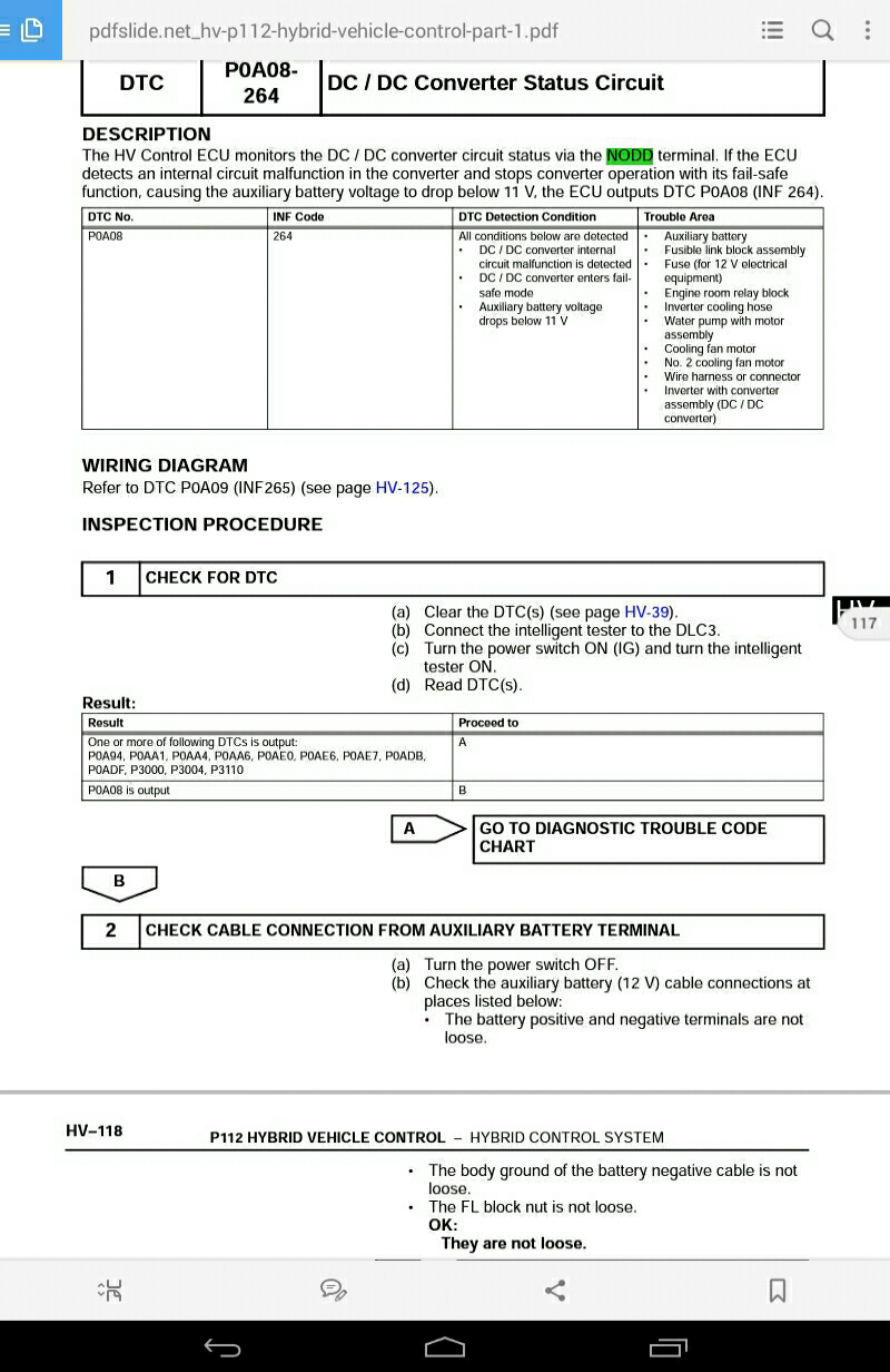

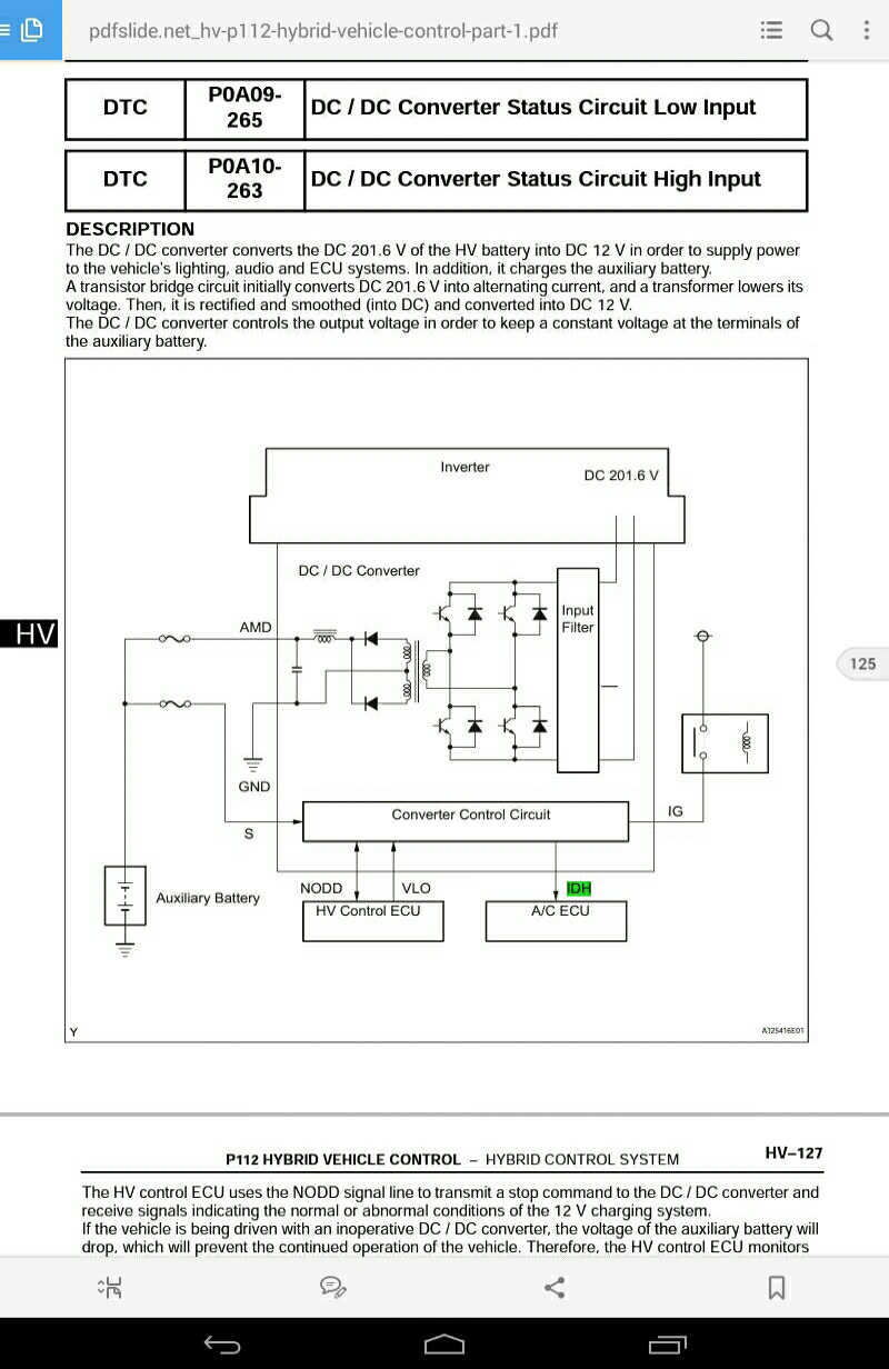

Trying to upload a few pages of what I found. Is there a way we can share the Toyota manuals or it's illegal? For now just trying to upload screen shots of C5 connector signals.

NODD and VLO are the ones giving me a headache at the moment because I don't have anywhere to test them.

Not sure if uploading the manuals is a good idea, better link to an existing source. Some excerpts should be fine though.
Is there any info on the part number of those control input connectors for the DC/DC converter (and aux inverter)?
Any info on the 2 pole connector for power, next to the 32-pin one?
Any info on the aux inverter in general?

- Been thanked: 5 times

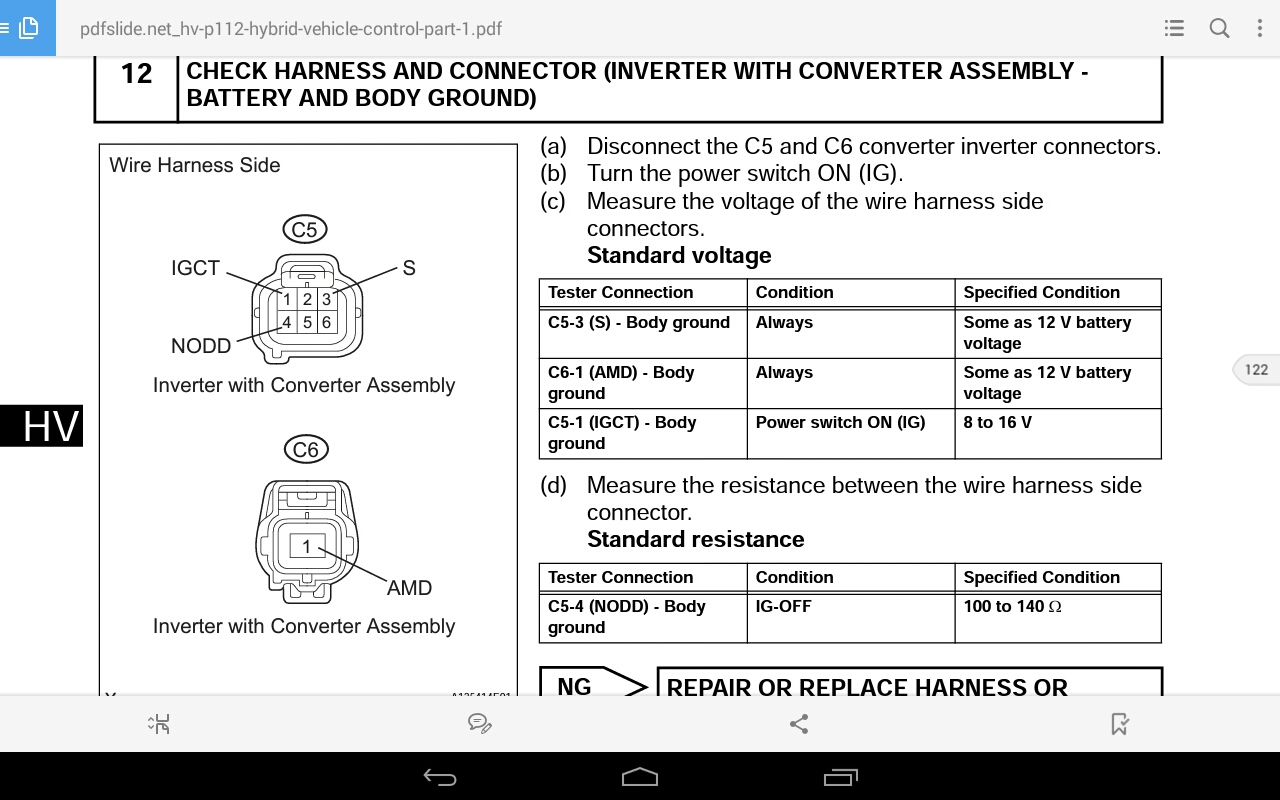

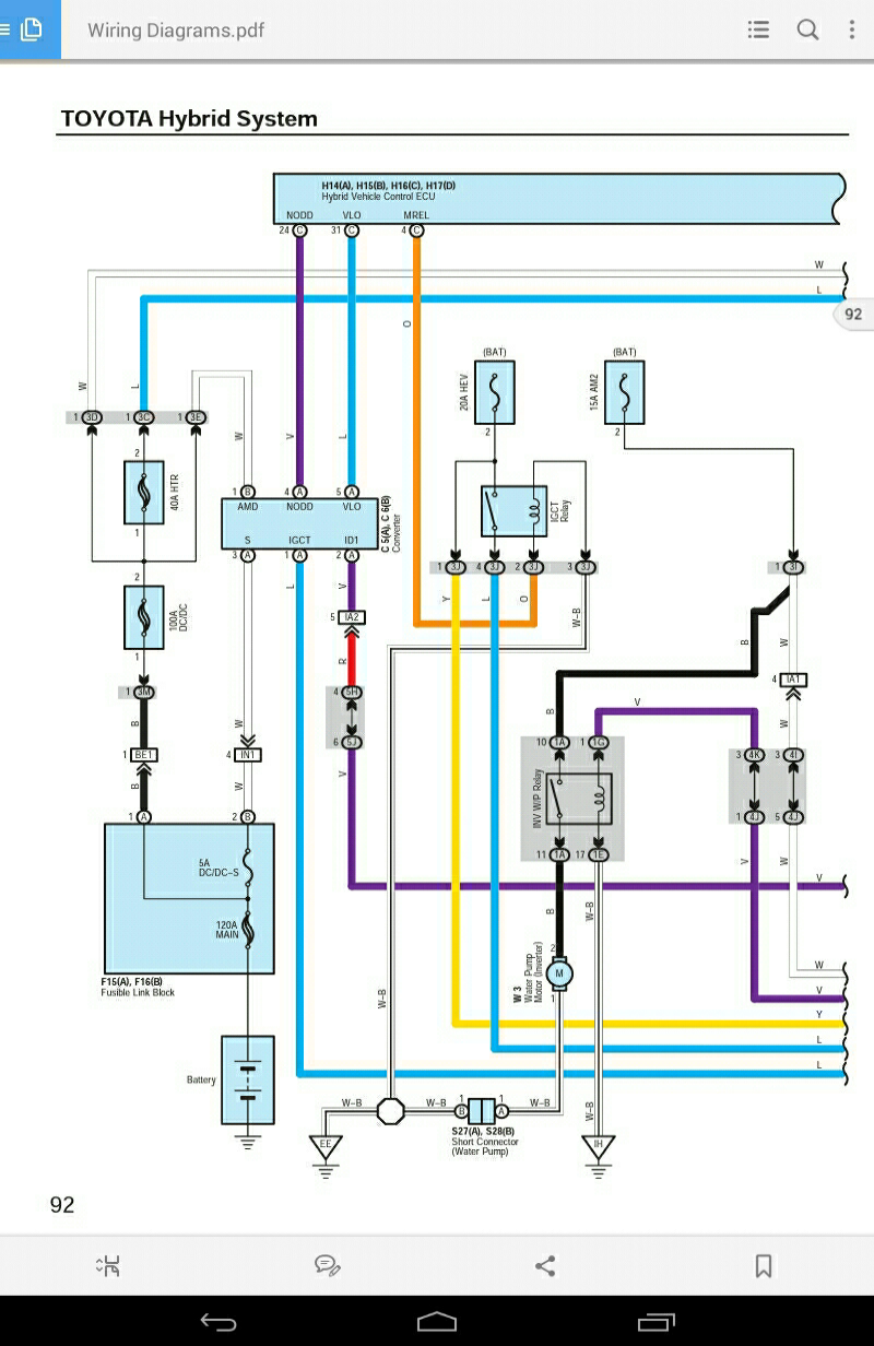

I attached a photo above with the pin map for the 12v DC-DC system, the p/n for the C5 connector shell is 90980-11034 and for the C6 90980-11963. Those are the only two external connections needed for the DC-DC to function. It is able to supply 100A of "12v" power, so should be fused accordingly.
That is THE 12v enable circuit for the internal inverter / converter systems, completely unrelated to the DC-DC converter functions, which is convenient. Connector p/n is 90980-11148, Red to "12v", black to Ground (vehicle common B-), draw is pretty low, will measure it and report when I get the damned blue-pill running.Any info on the 2 pole connector for power, next to the 32-pin one?
Voltage output is between 13.2v & 15v nominal, depending on the voltage applied to the C5 #4 terminal. 5V results in 15.2 no-load volts, but I will be testing the loaded output in the next few days.Any info on the aux inverter in general?
There is also a lid interlock connection, I plan on using that to complete the GROUND for the HV relay coils

- konstantin8818
- Posts: 290
I could try to upload this picture to wiki.
If I understood correct, one 12V supply is monitoring one coming from battery and the other one is from ignition relay
I have both 12v wired to the "Ignition" circuit, there is no voltage monitoring on either wire from the documents I have. NODD (pin #4) and VLO (pin #5) are "responsible" for voltage conditioning, but VLO is not needed or even useful for our purposes.
Current draw is on my list to do
, but 2A protection should be more than adequate.

- konstantin8818
- Posts: 290
I believe there is a reason why one connector is hooked up straight to battery. Maybe converter itself monitoring voltage even when ignition is switched off.
Remember, this device works with engine OFF to supply 12v to vehicle loads in the factory configuration and it would be unwise to do so in an EV conversion. I suspect the B+ connection is related to that ability, but there is scant documentation in the book.

- konstantin8818
- Posts: 290
Fair enough. I'll change picture on wiki right away.ZooKeeper wrote: ↑Fri Apr 17, 2020 5:09 pm Reading the book, there is no reason to connect any C5 terminal to B+ because the signals from other modules are not available. It should not hurt anything, but it is easier to connect one 12V Ign wire to two terminals, than to run two separate wires from 12V Ign and B+. In the end, it's a "serving suggestion", no harm either way from what I can tell.
EDIT: changed picture, also updated pictures of inverter's externals and internals

- Posts: 1083
- Has thanked: 479 times
- Been thanked: 312 times
Heh, well, other than losing your mind, fewer wires is better for the rest of us :p
I've updated the wiki a bunch. I added notes about it having the AC compressor inverter (wasn't sure Gen2 had that). And I cleaned up and rewrote much of what you guys added. Please check it for stupidity, I only minimally understand the context.
Also, the image Konstantin uploaded is now obsolete (no pin 3 required), and also the writing on both of those images are almost impossible to see. I almost didn't notice the black writing. Larger and yellow if possible (just to be consistent with pin numberings above).
Random thought... what happens if your 12v battery is dead, and your HV battery is connected? You can't turn your DC-DC converter on, to have 12v, without having 12v, no?

- Posts: 15
- Joined: Sat Feb 08, 2020 11:31 am
- Location: South Africa
Pin #1 is labeled IGCT and is Ignition on according to this attachment.
