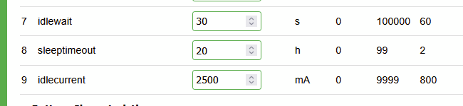

Johu -I wanted to ask - is there a reason why BMS waits for IDLE status to start balancing? I'd like to balance during CV phase as well. Any gotchas why not to do it? Theorethically now if I set idle current to 3.2A - a bit above CV current, it should enter idle and do balancing, haven't tried yet.
I have a large 200mV delta I need to tackle so now thinking of how to do it best, without resorting to wallwart external power every time I get a big delta.
I have added 3 more params and logic to the code which may be useful for others, maybe worth implementing on mainline?
Edit - or maybe idlewait was already there
