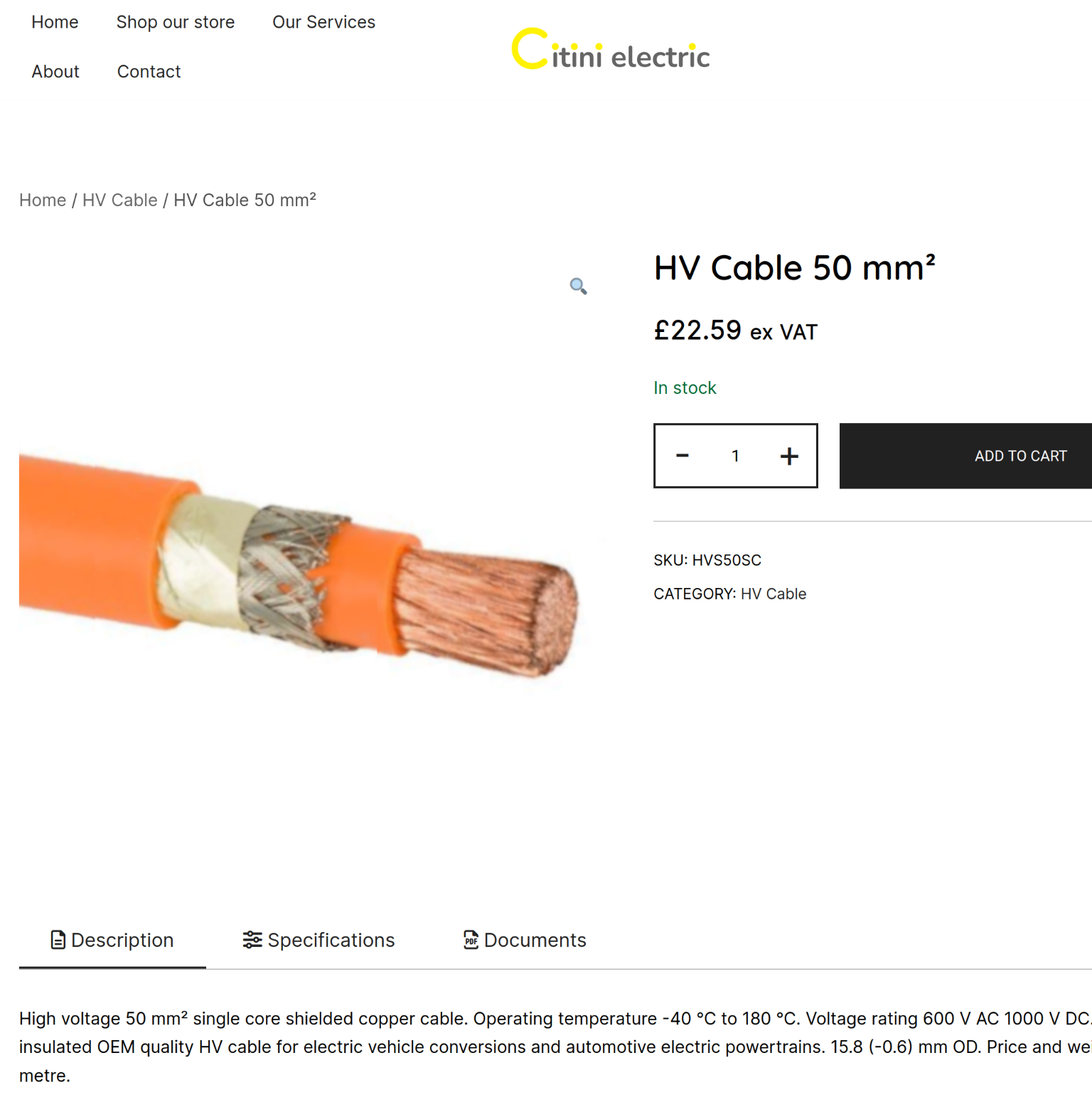

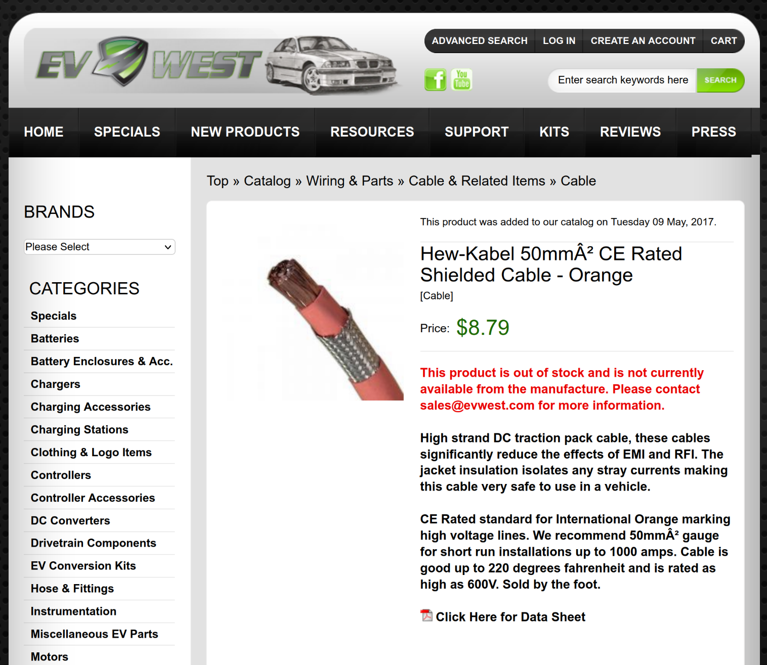

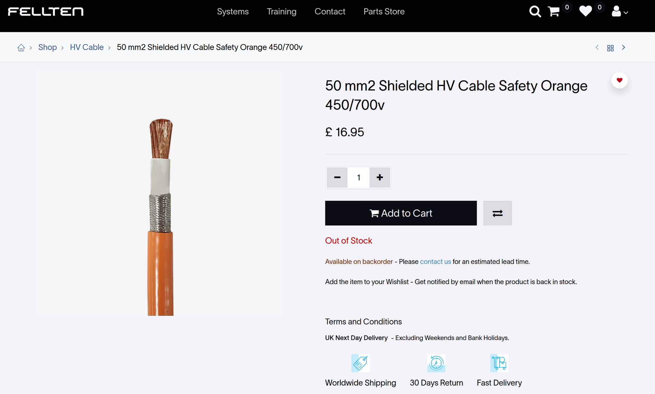

50mm2 shielded cabling
Post by asavage »
I'm in the US, and I'm having trouble finding a supplier for 50mm2 shielded cable in orange with a 600v rating.
I've found a couple of retailers overseas (UK), but they're either out of stock or don't ship to the US.
Note that I prefer not to substitute 1/0 AWG for 50mm2, though if a supplier of shielded 1/0 AWG can be found, perhaps I'd reconsider.
https://shop.fellten.com/shop/hvc50mm-5 ... ategory=55
https://citini.com/product/hv-cable-50-mm2/
In the US:
https://www.evwest.com/catalog/product_ ... cts_id=466&
Where do you get yours?

Shorter question: where to buy shielded cable, 50mm2, from the US.

Over at viewtopic.php?p=56019 I asked if the DCFC leads needed to be shielded. OEMs I've seen (BMW, Tesla) use shielded leads from the charge inlet, but I would think that there wouldn't be significant EMI while charging -- unlike the leads feeding eg the AC drive inverters. I posed that question on another forum as well, but didn't receive anything concrete in return.
I've decided to spend the extra coin for shielded cables anyway. If the OEMs are shielding the DCFC leads, they probably have a reasonably good reason. I think unshielded leads for the DCFC runs would work OK, but I'm not 100% certain, and while the cost difference of shielded vs non- is real, plus the effort to install EMC cable glands and use a metal HVJB rather than plastic, it's not so large as to foul the project.
Color marking of the leads is a separate issue. When purchasing cable, make sure it's rated for 600v AC/1000v DC, not residential wiring stuff, or low-voltage marine/automotive, which is 60v DC max. And the color is immaterial for those of us in the US, as we don't have to have our conversions/additions inspected as do some of our European counterparts: we can have any color cables we choose; they are required to use correct jacket colors and HV warning labels.
After hours online attempting to find retail sources of shielded 50mm2 cable that can be shipped to a US address, I just now ordered 8 meters of Coroflex FHLR2GCB2G 9-2611 from https://eveurope.eu/en/product/coroflex ... aat=50+mm2 (datasheet), which ran USD$313; I've just emailed them to see if they'll refund the VAT ($52), as it appears that export goods may not need to charge VAT. [later: they did refund the VAT :) ]

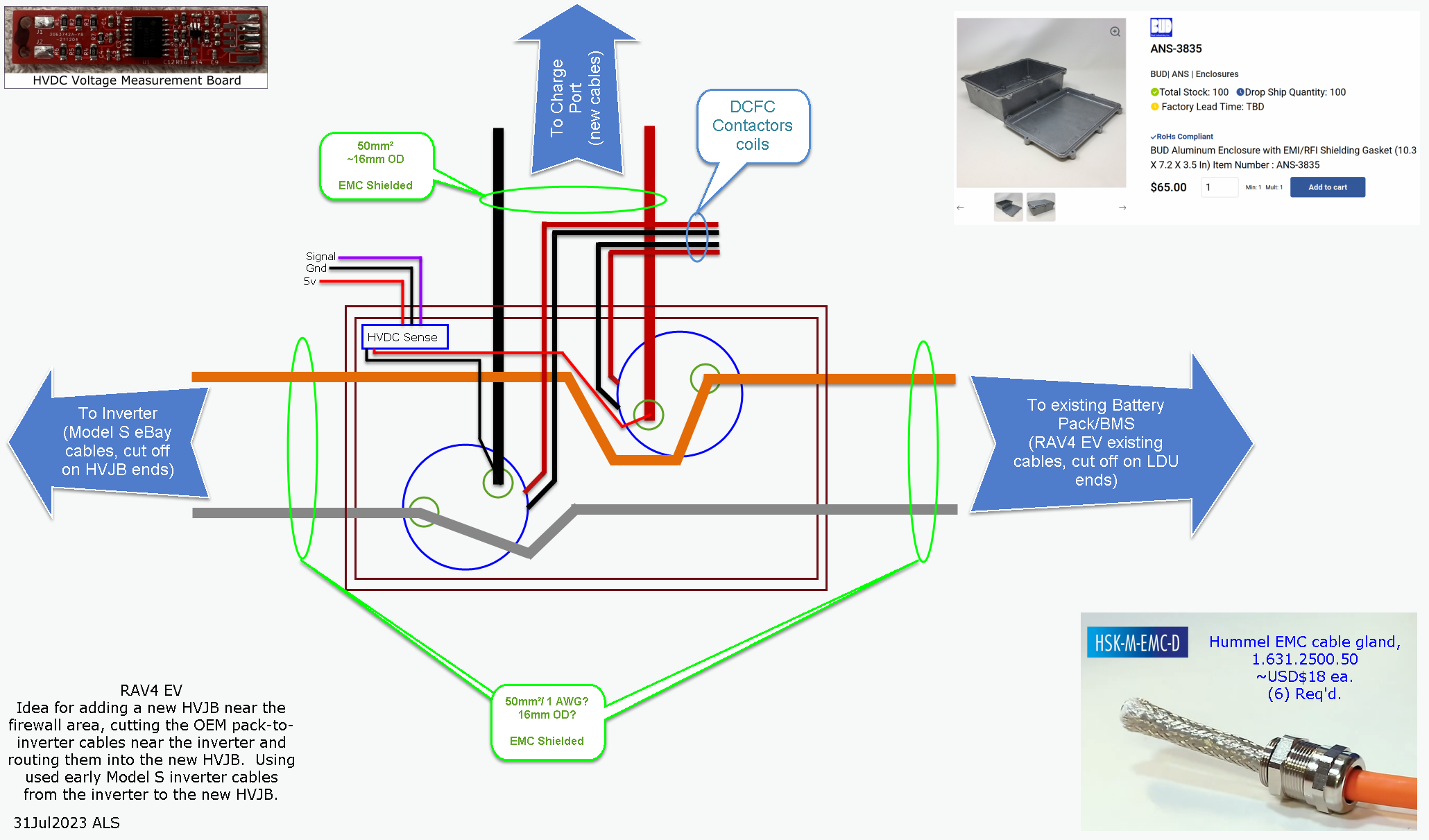

Post by alexbeatle »
asavage wrote: Mon Jul 17, 2023 4:00 pm ..... Here's a teaser:
I think you should consider a pre-charge circuit....
asavage
Posts: 385
Has thanked: 369 times
Been thanked: 119 times
Post by asavage »
The pre-charge is already handled by the Tesla BMS, which in Tesla fashion is integral to the 860 lb. HV pack assy (represented by the right-facing blue arrow in that diagram above).
This project is modifying an existing OEM EV, to add CCS1 DCFC, so I'm integrating with a lot of things that already exist. The challenge ahead is configuring a MiTM "golem" to spoof the OBC's CAN comms with the BMS and the rest of the vehicle.
By comparison, adding an inlet port, cables, contactors, HVJB, and the PLC comms are a well-trod path.

I used the shielded 1/0 AWG from EVWest but I didn't have a supply issue at the time I bought it.

I ended up buying from EV Europe:
https://eveurope.eu/en/product/coroflex-flexible-orange-battery-cable-shielded/
I've got 8m/26'/USD$313 that arrived on my doorstep in the US, seven days after ordering.

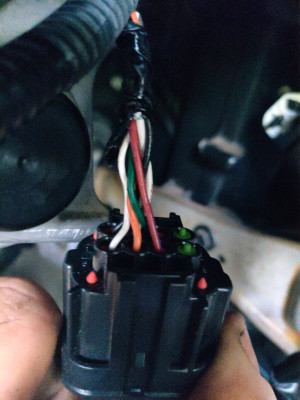

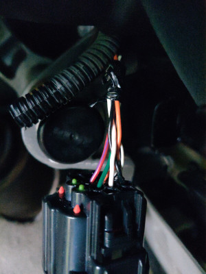

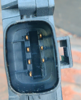

Post by Proton »

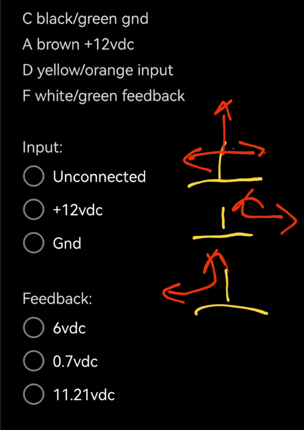

I already used successfully my Nissan Quest 2008 Throttle pedal.
Based on the Connector numbering I used pin 3-5-7. Pin 4 and 8 are not used.
1-2-6 Black - White - Orange
3-5-7 Green - White/Black - Red/Blue < ----------- the one I used.
PIN 1 - Black
PIN 2 - White
PIN 3 - Green - Negative -
PIN 5 - White/Black - Signal
PIN 6 - Orange
PIN 7 - Red/Blue - Positive +

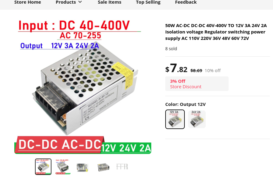

I am going to use a DC/DC converter TDK like the mentioned here.
I know i can start it without 12v battery, but could someone confirm it has upper voltage to 397vDC and if it is possible to continously work without 12v battery, so avoid to install 12v batt in my conversion ?

chentron wrote: Mon Aug 14, 2023 12:12 pm I am going to use a DC/DC converter TDK like the mentioned here.
thanks
The question I would ask is... how do you turn any of your systems on without a 12v source? How would you start an ICE car with only an alternator? To get your 400v supply, you need to switch relays, close contactors... which needs a 12v feed. There are multiple other reasons you need a 12v battery. Having a battery prevents inrush current from damaging other components. The likes of BMS, inverters, etc need perm 12v feed (KL30) before the ignition (KL15)

Post by chentron »
the source for 12v is the TDK DC converter. It connects directly to the main circuit in the car. I have other 12v circuit that only goes up when I power on the principal key, feeding my openinverter v2.
I could install a small 12v battery for absorb inrush currents if it is absolutely needed, but that is why I asked opinions of what is doing other people, because without it I am not missing anything in my old basic `99 car.
cookie6000: I am aplying earth(pin - of TDK dc converter) to pin 1 as you said in the original info from 2 years ago, but the DC converter doesnt stop. Is there some trick to disable ?
EDIT: I solved about disable this tdk dc converter. Pin 6 (not pin 1as specified cookie6000) is the one to disable the dc converter.

chentron wrote: Tue Aug 15, 2023 11:52 am the source for 12v is the TDK DC converter. It connects directly to the main circuit in the car. I have other 12v circuit that only goes up when I power on the principal key, feeding my openinverter v2.
I had the same conversation with Lars about the enable pin for him on his TDK. Mine was Pin 1, his was Pin 6. After bench testing, I could never get Pin 6 to act as the enable and Pin 1 is the one I have used all this time with no issues.
Re the 12v, sounds like you are all ok as your using the cars 12v battery. You just need that feed to power the enable relay in charge/discharge modes. Simples!

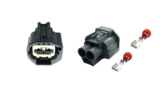

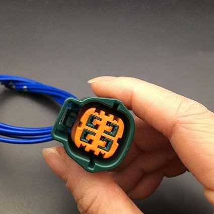

Post by Proton »

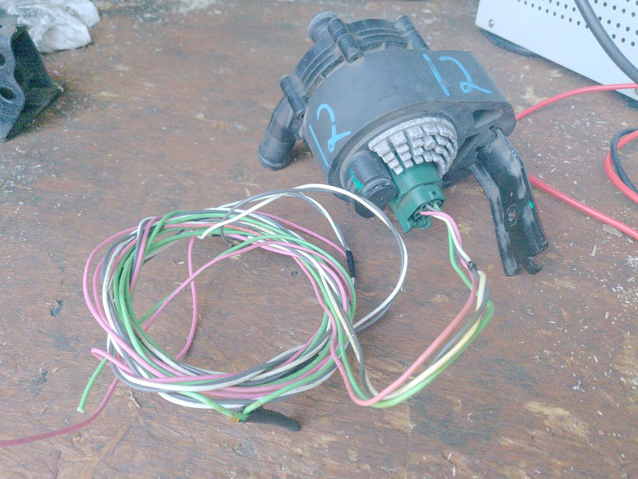

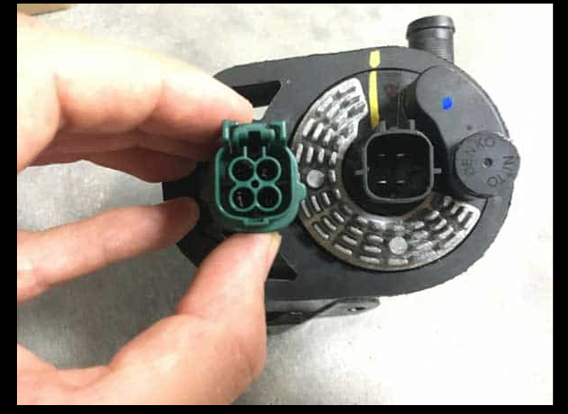

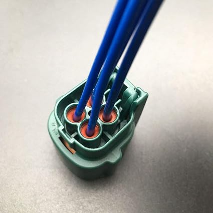

This connector from Nissan fits the Tesla water pump.
https://www.amazon.com/gp/product/B07Z5 ... 120L&psc=1

Post by asavage »
Proton wrote: Tue Oct 03, 2023 8:29 pm This connector from Nissan fits the Tesla water pump.
Yes, I noted that last year:
viewtopic.php?p=46064#p46064

Post by Proton »
asavage wrote: Tue Oct 03, 2023 8:45 pm Yes, I noted that last year:
I see now. I just used the connector I had on my Nissan before and looked it up online.
This is mine from Nissan

Post by Alibro »
Both companies use the same pump. I posted a way to control the speed of it here.
viewtopic.php?t=2906
Alibro wrote: Tue Oct 03, 2023 10:21 pm Both companies use the same pump. I posted a way to control the speed of it here.
I harvested very similar pumps from Ford Focus Electric and using in my build. Connector and controls are the same. Current draw at full speed (measured with PWM in floating) - just over 3A. Don't know if the flow rate is the same, since the current draw is half of that for the Tesla pumps - reported 7A by lars.

In the Ford Focus Electric the valve behaves different. Here're my finding:

For testing, It can only do 40W to 50W
40V to 400V DC to 12V DC
https://www.aliexpress.us/item/32568050 ... pt=glo2usa
Input : DC 40-400V Output 12V 3A
AC 70-265V
Input DC voltage (V) Output DC voltage (V) Current (A) Power (W)
36V 12V 2.00A 24.00W
48V 12V 2.70A 33.60W
60V 12V 3.20A 43.20W
70V 12V 3.50A 48.00W
84-400V 12V 4.00A 55.20W <------------------------------

I just found out the P/N of the UP32 vacuum pump connector
You can get it on aliexpress
https://de.aliexpress.com/item/10050017 ... pt=glo2deu
Male 7282-5596-10
Female 7283-5596-10
