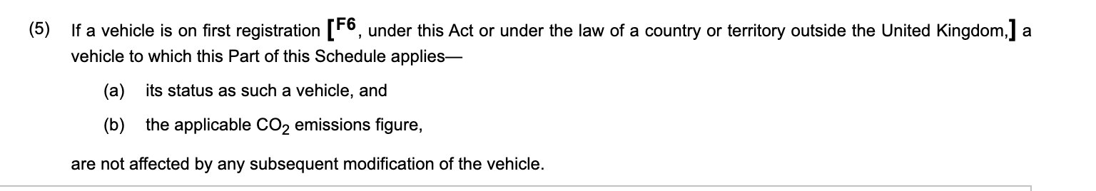

That's a definite no. The legislation very clearly states that if a car has a CO2 emissions figure recorded at first registration, this figure is NOT affected by subsequent modifications. You can install a V12 or the world's most efficient engine, and the tax will not change. This is in fact the very thing that the DVLA believe prevents an EV conversion from being zero rated for tax.
The relevant legislation (which refers to cars with a CO2 emissions figure):
If a vehicle is on first registration, under this Act or under the law of a country or territory outside the United Kingdom, a vehicle to which this Part of this Schedule applies—
(a)its status as such a vehicle, and
(b)the applicable CO2 emissions figure,
are not affected by any subsequent modification of the vehicle.

As catphish says. That is THE argument they're using to deny us the re-classification when converted to EV.
Since an ICE powered car is NOT an 'exempt vehicle', it IS then covered by Schedule 1 and hence cannot have its original emissions figure changed. A restriction I completely understand as that would open the door to anyone claiming their car now produced fewer emissions and they should pay less VED. That would be IMPOSSIBLE for them to implement. However, it was clearly never meant to prevent a car being converted to electric propulsion, hence becoming an 'exempt vehicle' and thereby NOT subject to Schedule 1 at all and that whole "cannot change emissions" statement is rendered irrelevant.
However they are still wrong, due to the exemption. Fundamental logic dictates that a positive and a negative results in a negative. DVLA are distorting/misunderstanding that to mean such a combination results in a positive and that is NEVER true.

Could it be DVLA are basing their decisions on the first registration of the vehicle after manufacture ?
Here is a link for the actual - Vehicle Excise and Registration Act 1994
https://www.legislation.gov.uk/ukpga/1994/22/contents
I can't see anywhere which says:
"If a vehicle is on first registration, under this Act or under the law of a country or territory outside the United Kingdom, a vehicle to which this Part of this Schedule applies—
are not affected by any subsequent modification of the vehicle. "
Can you post an exact quote & location of the section the DVLA are using to suggest VED can't change?
Re: Registering and changing tax class of an EV conversion in the UK
Posted: Mon Mar 21, 2022 11:38 am
by catphish
SuperV8 wrote: Mon Mar 21, 2022 10:26 am Here is a link for the actual - Vehicle Excise and Registration Act 1994
The quote is exact. It's from Schedule 1, Part 1A (5).
Posted: Mon Mar 21, 2022 11:52 am
by Bigpie
SuperV8 wrote: Mon Mar 21, 2022 10:26 am Can you post an exact quote & location of the section the DVLA are using to suggest VED can't change?
https://www.legislation.gov.uk/ukpga/19 ... /1/part/IA
