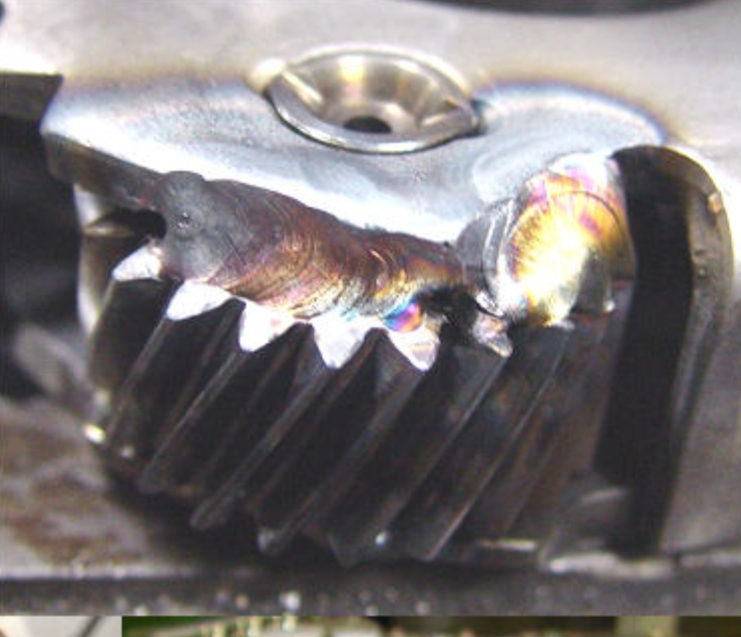

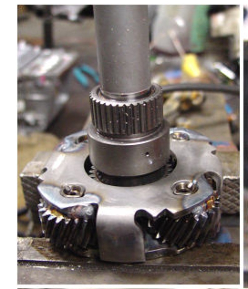

MattsAwesomeStuff wrote: Sat Oct 04, 2025 6:47 pm Again, verbally describing things that you might have verbally misunderstood is challenging to diagnose.
Take pictures. Maybe you welded the wrong thing?
Like I said. I welded the planetary gears. But after careful examination after disassembling the transaxle again, I noticed that the sun gear was sitting a bit high, hence maybe the reason why things got stuck after assembling. I removed the thrust washer that sits inside the planetary gear and allows the sun gear to rest on it. I then oiled the sun gear and put it back in and hammered it a bit for it to slide and mesh with the welded planetary gears fully. Reason for removing the inside washer was because I feel its not useful anymore because the sun gear and the planetary gears all now rotate together so there won't be any friction inside the whole assembly. After this I put everything back together and my shafts are rotating again.
Below I attached pictures of welded planetary gears. Not mine but they show what I also welded.
Thank you.
T1Terry
Posts: 66
Joined: Sun Feb 04, 2024 5:55 am
Has thanked: 22 times
Been thanked: 25 times
Re: EV Conversion using prius gen 2 inverter/transaxle
Post by T1Terry »
Good point, might be worth installing the sun gear and maybe even assembling the planetary set into the ring gear, before welding, at least the first tack on each planetary gear to the carrier, that way teeth alignment will at least remain once the planetary set is welded up.
At this point, confusion sets in for me. MG1 will now be spinning at the same speed as MG2, so very little of that low RPM MG2 hp/kw is going to be assisted MG1 hp/kw, but all the MG1 torque will be available, so that's a plus, at around 50mph, MG1 is going to reach it's peak of 10,000rpm so all 57hp/38kw from MG1 will be added to MG2 ..... but MG2 can't spin any faster that 10,000rpm now because MG1 is locked to it, and faster will over speed MG1 .... So what was really gained? A drive system that can hold 50 mph better because of the added input from MG1 ..... but the max speed is still limited to 50mph .....
viewtopic.php?p=31602&hilit=list+of+Pri ... les#p31602

T1Terry wrote: Tue Oct 07, 2025 12:33 pm but the max speed is still limited to 50mph ....
It is a Gen2 transaxle, at 60 mph, if I remember correctly it revved lazy at 4000 rpm or so. With the OI logic and sufficient voltage you can make it go 80 mph or more.
Without the gear welded MG1 will overspeed.

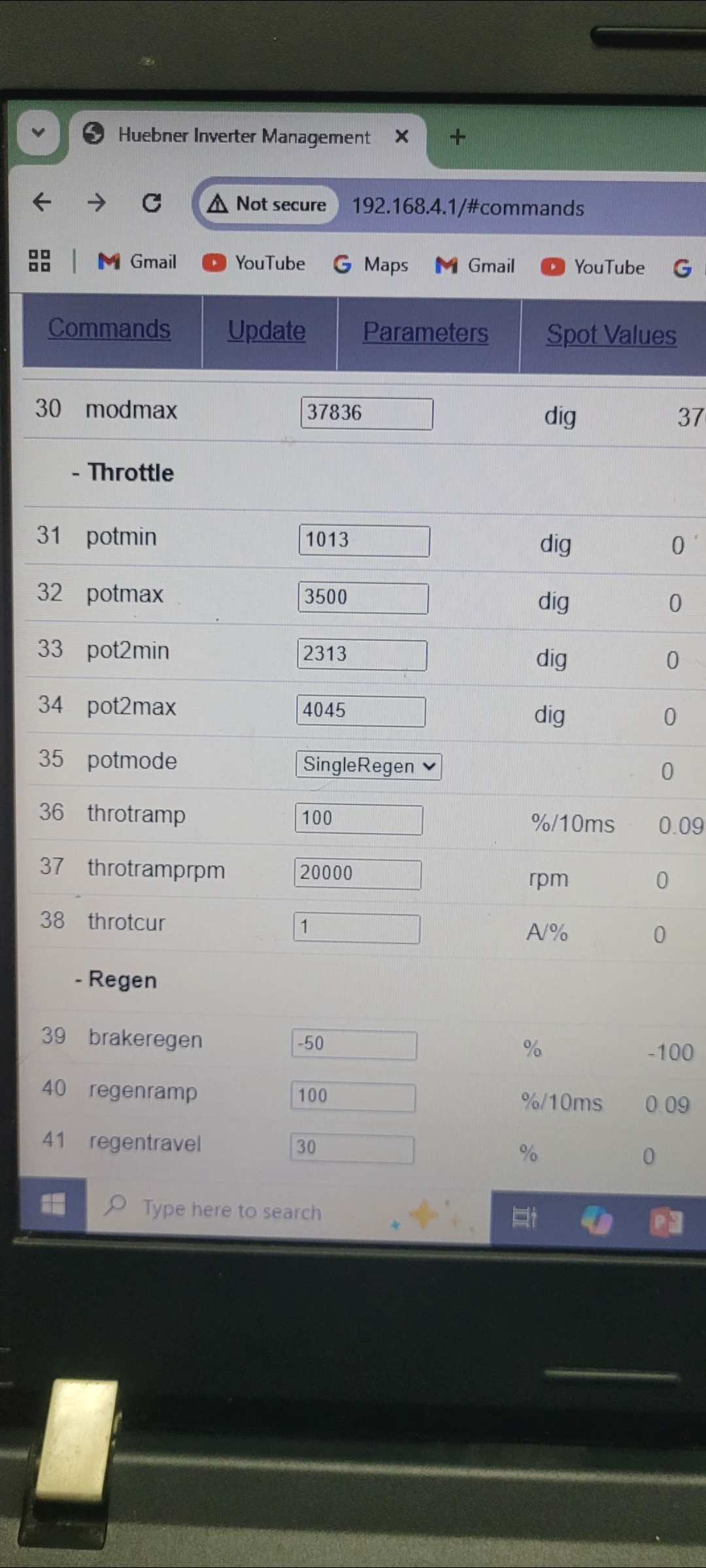

RetroZero wrote: Fri Sep 19, 2025 5:29 am Is it possible to load throttle parameters in graph form?
I don't have the figures in front of me, but vaguely remember setting throttle. From what I remember:
There are 2 potentiometers.
Pot is for 0 to 4095 (digits)
Pot2 is the reverse 4095 to 0 (digits)
Setting Pot: note value when NOT pressed (example 500) - set your min value LARGER than this (example 550).
Now press throttle completely & note value (example 4500 - set pot max to LESS than this value (example 4200).
Pot 2 is done the same, except its the reverse of values because it reads in the opposite direction 4095 to 0.
Plot your graphs.
What you are trying to create are values where when no pedal is pressed, Pot is at 0, with a slight margin of play. The same is done for potmax.
I'm home this weekend and I'm back to throttle calibration.
I was following the above given instructions . So before pressing the throttle I got pot 963 and pot2 2013. When the throttle was fully press both pot and pot2 gave 4095.
So I did the math exactly as instructed above. Well maybe those numbers from Retro were just examples but I used them as per. The only difference was when it comes to potmin. I put in 3500 since that's the max parameter.
Then I went to throttle parameters and please see attached screeshots of how I loaded the new numbers. For pot2. I had to interchange the min and max values since retro mentioned that for pot2 its vice versa, so I wanted to make sure that i got it right in order to see which configuration works but none of those worked.
The results I got was that when pressing the throttle when it's halfway, the motor jitters, it does rotate but jittery rotation. When I continue pressing the throttle to its full capacity the motor then stops jittering and comes to a stand still. Please not that this results were same even before I changed the parameters, like when I first connected the pedal I did press it to see what will happen and this jittery rotation was the same.

I'm only half paying attention, but have you gone through the procedure Damien showed in his video for how to set up SynchOffs properly?

MattsAwesomeStuff wrote: Sat Oct 18, 2025 5:57 pm I'm only half paying attention, but have you gone through the procedure Damien showed in his video for how to set up SynchOffs properly?
Yes I did Matt, I have my syncoffs set to 10120 like Damien showed on the video.

voti wrote: Sat Oct 18, 2025 6:35 pm Yes I did Matt, I have my syncoffs set to 10120 like Damien showed on the video.
As Retro pointed out... just making sure you aren't blindly choosing 10120. Damien showed the process everyone should follow because all units are different. It was not him demonstrating how he found the "correct" value for all Gen2 Prius's and that everyone should use that number.

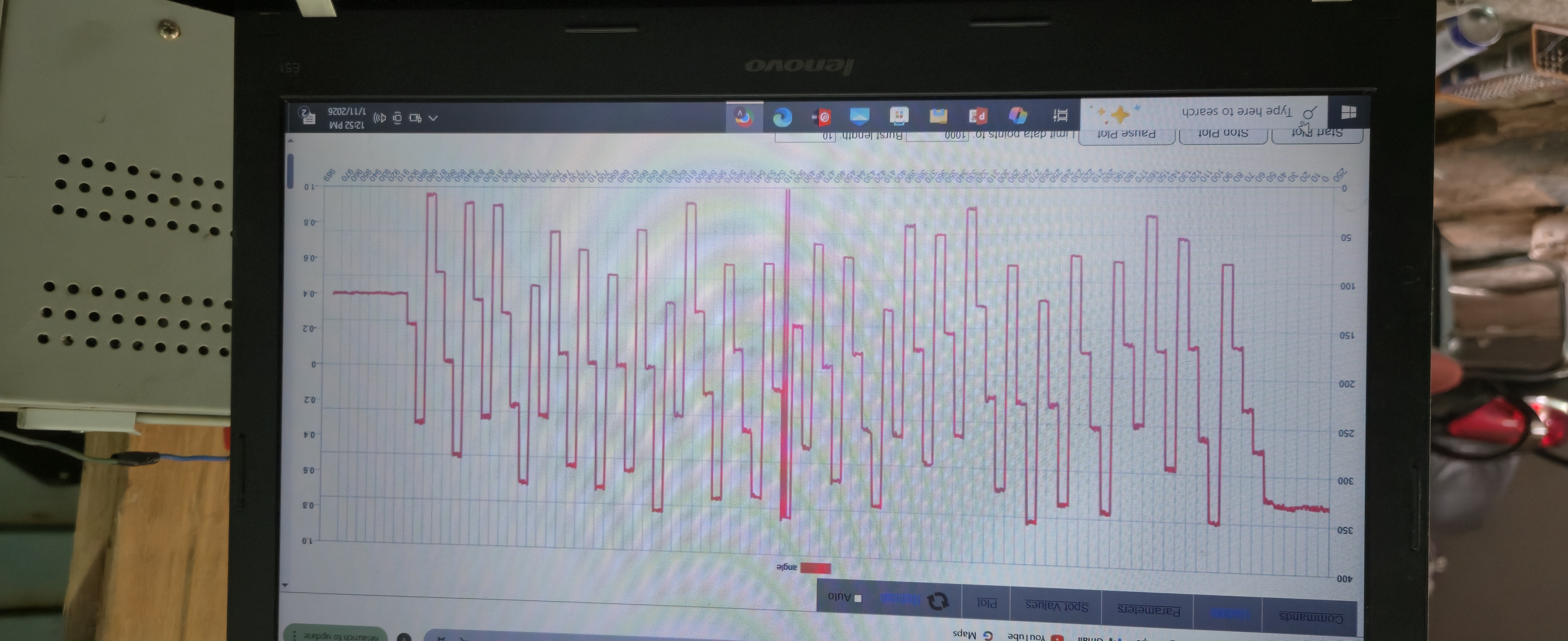

Posts: 135
Joined: Wed Oct 02, 2024 12:35 pm
Has thanked: 19 times
Been thanked: 15 times
Post by voti »
I'm home this weekend.
So liek I said that I'll go back to resolver testing before continuing to throttle calibration and setup. What I noticed is that after taking the transaxle apart to weld the planetary gear set, I lost my resolver connection. When I plug in the cable back on the transaxle, either I get varying angles or no angle at all. Just now I set automatic refresh and unplugged my resolver as it was stuck to 0°. When I lugged in it again it started showing way to many angles; 48°, 75° , 180°, 336° you name it. When I restart the inverter and reconnect the resolver cable, it's back at 0°.
At some point I was able to have the angle at around 98° and when I proceeded to the resolver plot test and reotayed the transaxle by hand with the HV disconnected, the graph didn't change but it showed this waveform that fluctuated continously. On another test also, when I started the flot it just jumped from 0 to 360 without me having to rotated the shaft. This 0 to 360 pattern also was continous and like I said it just jumped to these plot without me having to spin anything. I watched Damien video to troubleshoot what was going on, all I found as that Damien did mention that just a behavior means hat I should stop because something is wrong, only problem is he didn't say what that problem is or how to solve it.
Anyone with knowledge on this please come to my rescue

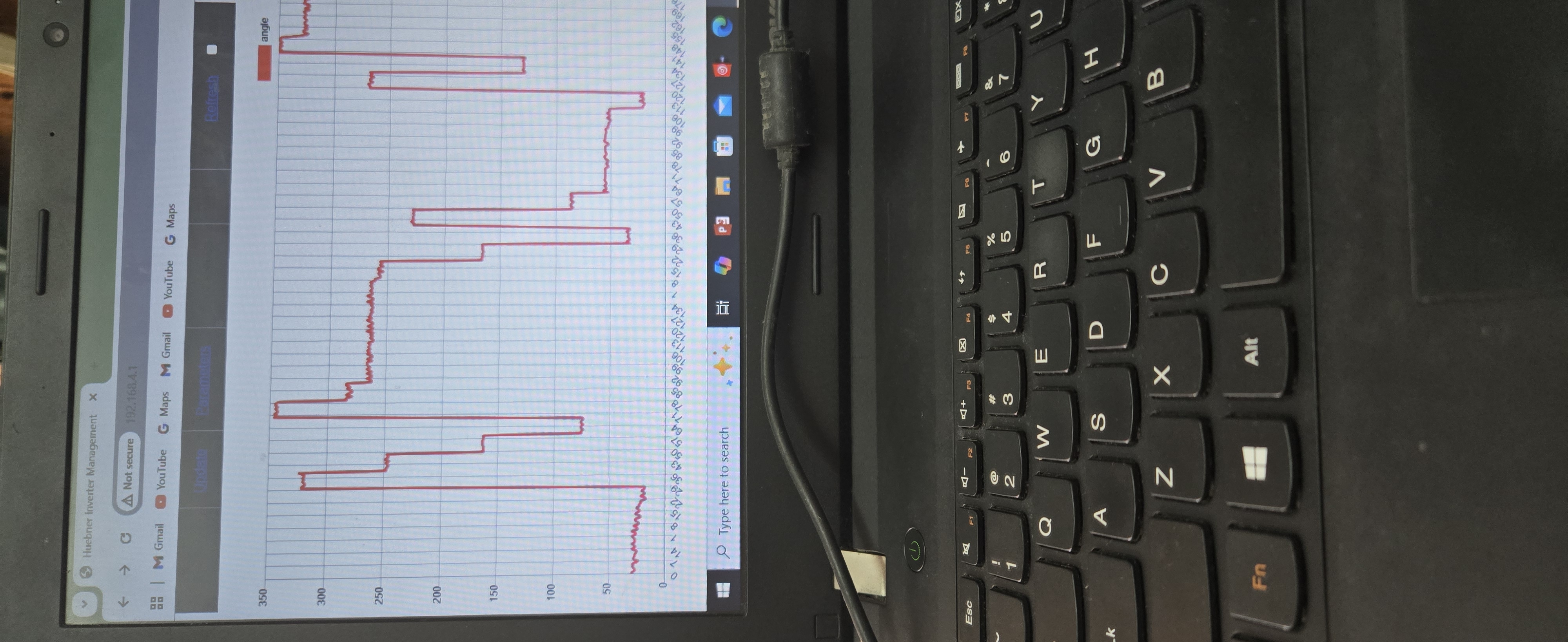

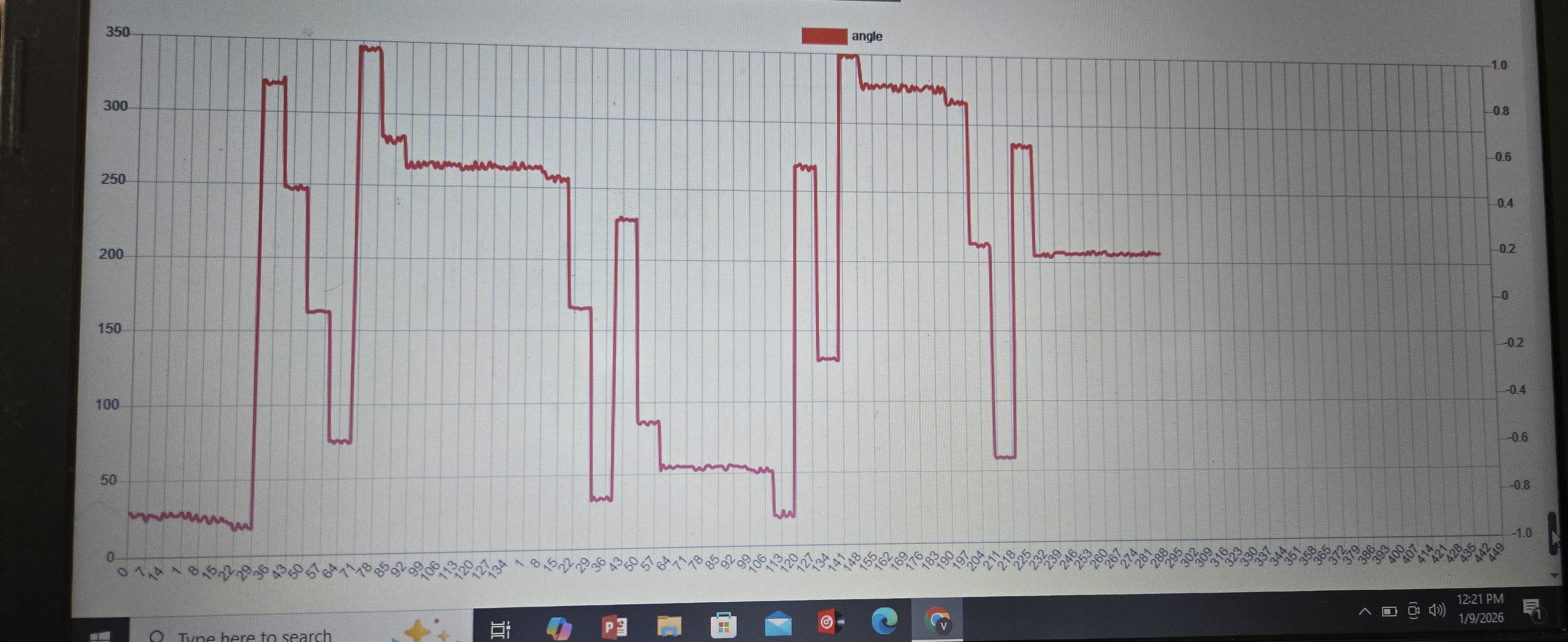

voti
Posts: 135
Post by voti »
Im back at the workshop and working on the electrical part of the car. I reconnected my resolver cable and followed all the steps to test for resolver feedback. I've posted my screenshot below of the graph I got when testing.
Is this plot ok. I think I hit 360 but the 0 im worried about it
RetroZero
Posts: 947
Location: France
Has thanked: 643 times
Been thanked: 64 times
Post by RetroZero »
That does look more promising. What did you do? It looks like you have to stop at some moment when doing rotations as there are longish straight lines at similar points. Is this correct? Try to do 2 or 3 smooth revolutions without any stopping and plot again.
voti
Posts: 135
Post by voti »
I prayed 😄. I disconnected the resolver and reconnected everything afresh. I'll try doing the 2 or 3 rotations at once because now I was spinning by hand and I'd go maybe half a circle or 3/4, I couldn't get one clean full rotation. I will buy a vise grip for that

Truly appreciate you taking the time to write this.
I bought the vice grips and tested again today. Please see the attached picture.
Plot your graphs.
Should I move on to this step now?
